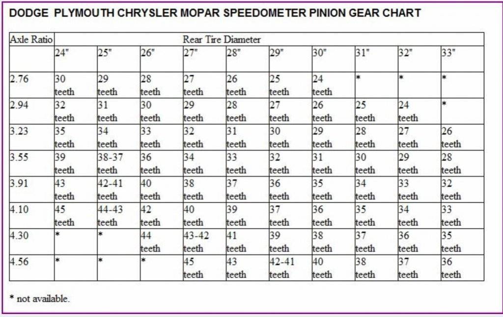

You can buy a reasonably priced commonly available tire in the size of your choice and buy a $35 speedometer gear.
Remember this is a 65, so speedo gears for 65-older are unobtanium (last I knew anyway). And I spoke with the owner of 'famous' A&A Transmission a month ago and he is contemplating (but struggling) to find a cost-effective way to re-pop these gears.

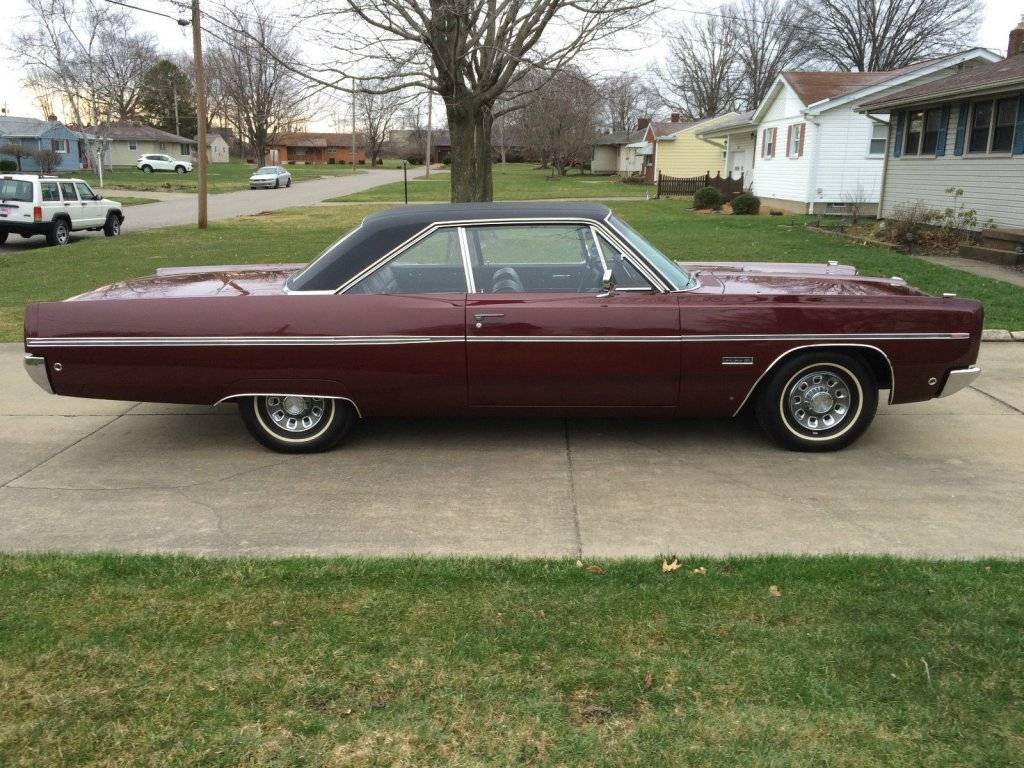

225/70/14 on my Fury. I thought about going with 15 inch tires with the road wheels but I found my 14 inch Magnum 500 wheels and that is the look I always wanted so I kept the 14's. The car rides and handles great. These cars weren't meant for hard, high speed cornering anyhow. View attachment 72835
Gorgeous! That's "the look" I'm looking for. With the recent purchase of my car, the seller gave me a set of 14" painted (silver/black) magnum 500's with the stainless trim rings. They have Cooper Trendsetter 215/75r-14's on them with good rubber left, BUT the whitewalls are on the inside. Perhaps I should spend the $40-60 to get them turned around and balanced.
Are these wheels in your photo the painted (silver/black) magnums with trim rings?
Thanks, Bob

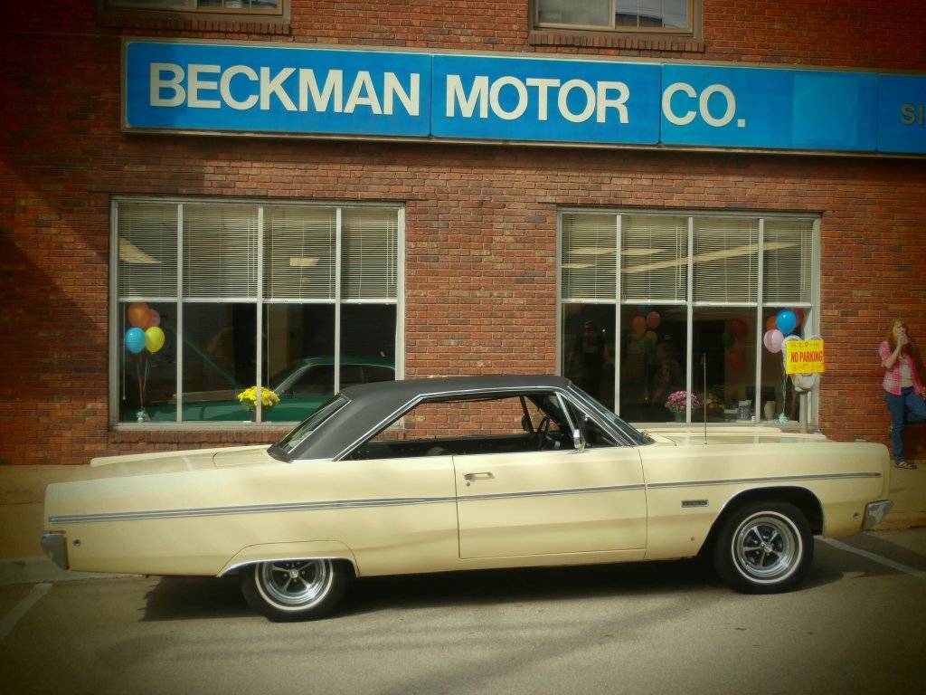

PS...photo of my car with same roofline/skirts as yours. Really would look good magnums like yours.
