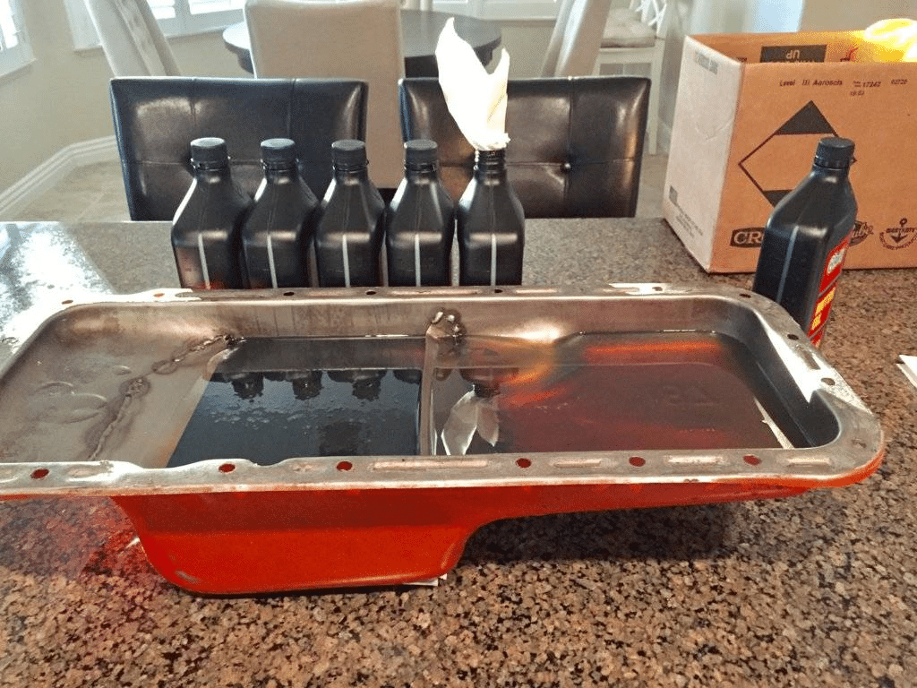

187 oil pan capacity test.
thanks for all the feedback, yeah not trying to over anaylize this, LOL, just wanted to feel this out. My main concern is that I have a Melling HV oil pump so thats why Im running alittle extra oil just in case i suck the pan dry. I dont rev the car to crazy so I'm prolly good either way.

BAD69 - I have a 669 oil pan on a '68 383 and I've read these are identical to the 187 pan - do you have the original dipstick for your pan and can you tell me the specs. Tip to add mark, tip to full mark, tip to lip at top of tube? I have a chinese aftermarket stick in mine I have little confidence in..any info /comments appreciated

From the original post, 6 quarts covers the baffles on his 187 pan. Not sure how much good the extra quart does, or if it is just creating unneeded windage. Are you running a 187 pan? Baffles?
First was just a stock pan, don't remember if it was a 187 but c body is c body. Then with windage tray. Now my turbo oil drain modded pan has custom baffles. Not that it takes alot of capacity, but I have 6' of feed line and 5' of oil drains for the turbos as well
mine was uncovered of the line with a fast take off even with a windage tray. an extra 1/2 quart did the trick.
