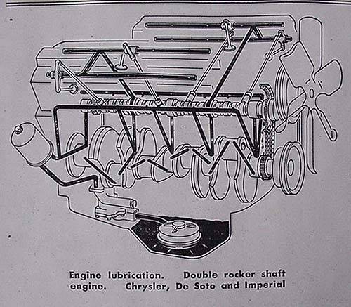

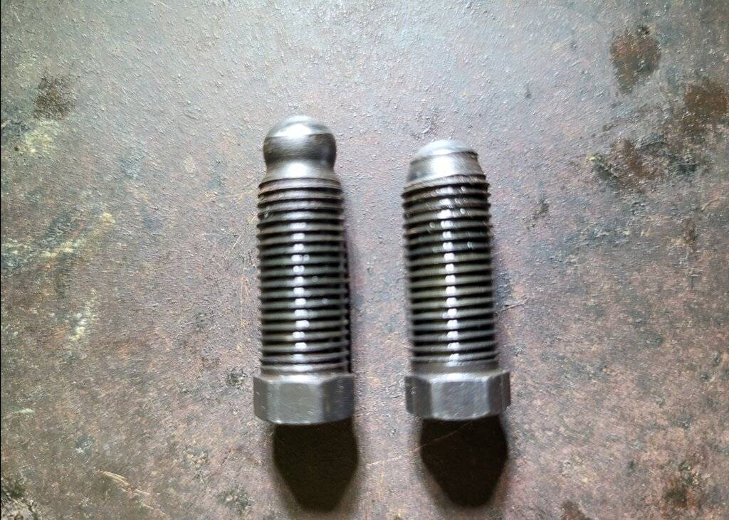

Ran into a snag while setting the valve lash. There appears to be an oiling issue. Very little oil flow, if any, to the rocker arms. Things were very dry up top, and a couple lash adjuster screws were worn so much that they had no more room for adjustment. New ones are on order, although obviously I've got to get to the bottom of the oiling issue 1st. I've got a pretty good idea what is wrong, but any suggestions would be appreciated.
I'm leaning towards believing this is a cam bearing issue...not sure if they can be installed incorrectly? Anyone know if a LA 318 cam bearing is different than a Poly 318?

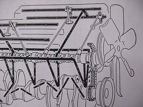

Engine Oil Flow

Thanks @Xenon for that info...here's a post that I found from a Sweptline forum while searching, sounds promising.
The dangers of being the second person inside an engine... I have no technical input, so I offer my sympathies...
No worries Jeff, we will get this resolved. So far I'm enjoying the hunt as I become familiar with this Poly engine...for example I've never adjusted lash before. At this point its been a positive learning experience. No matter what, things will work out :thumbsup:
Is the photo in post #57 your engine? If so, it appears well oiled. Depending on the type/weight of oil used, the temperature of the engine when it was shut off and how long it sat before removing the valve covers, rockers can appear "dry". Sliding the rockers on the shaft or starting the engine with the covers off can "tell the truth". Since the adjusters are damaged, are the sockets on the pushrods OK? What oil pressure do you have? Just some thoughts.
