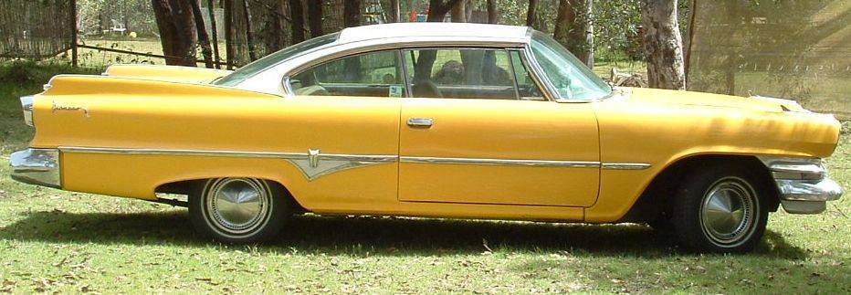

SOLD 1960 Dodge Senaca
This one needs to be saved. Very cool car! Wish I could grab it. Other then some metal work, and paint. Look pretty good.
My old car...
Oh forgot to mention, at one stage I had a 392 Hemi in this thing, it marched!
