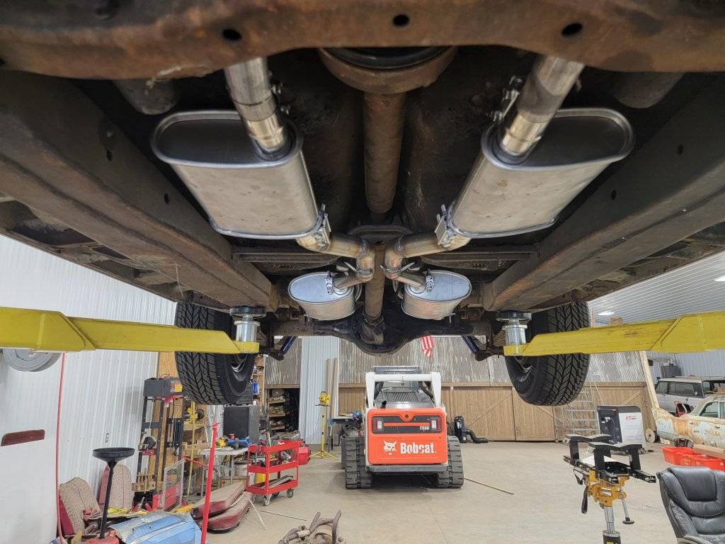

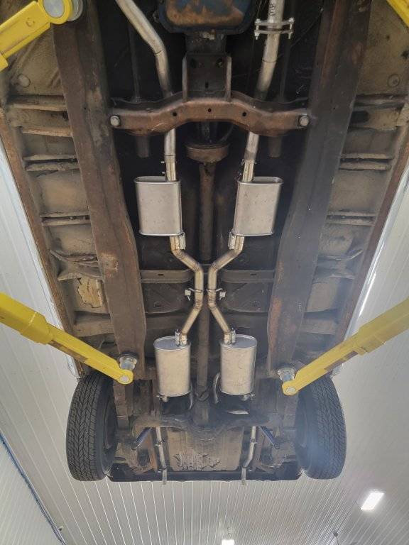

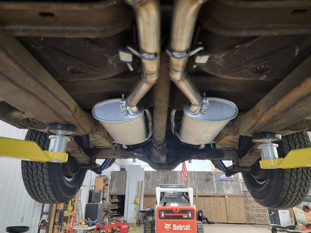

Just to update I bought the cheaper $750 system, but the price went up now.
Over all the fit from manifold to resonator and tail pipe to muffler was good. But the mids from resonator to muffler would not fit at all. I don't know if they bent then wrong or if there spec sheet is wrong. I called them and they were very willing to make new ones and correct the problem. But it is pretty hard to do from 1000 miles away and try yo explain or draw a diagram. So I bought a mandrel bent kit and just make my own mods.
