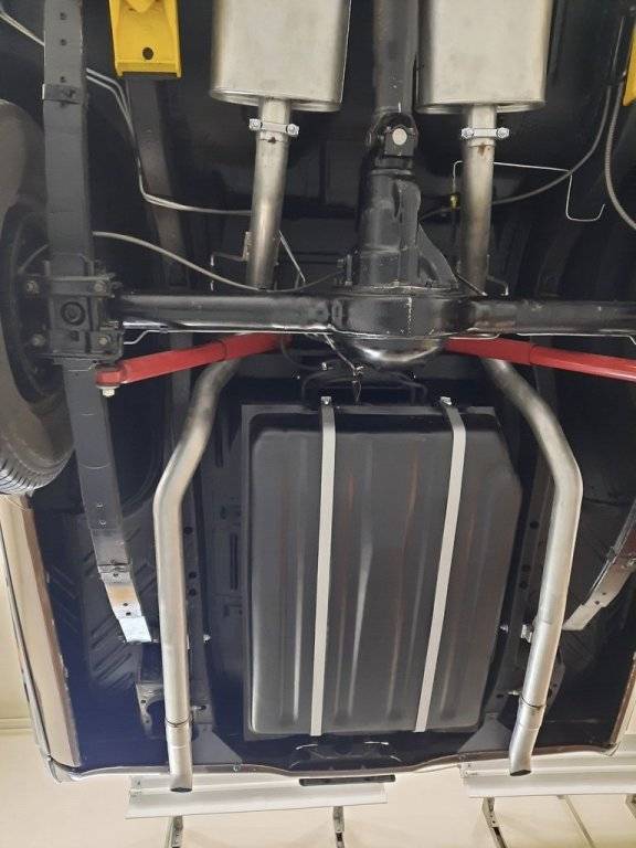

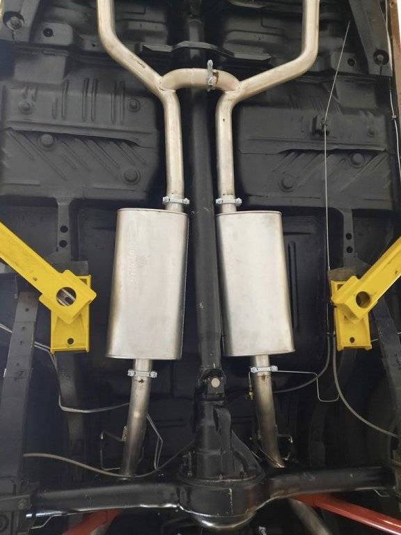

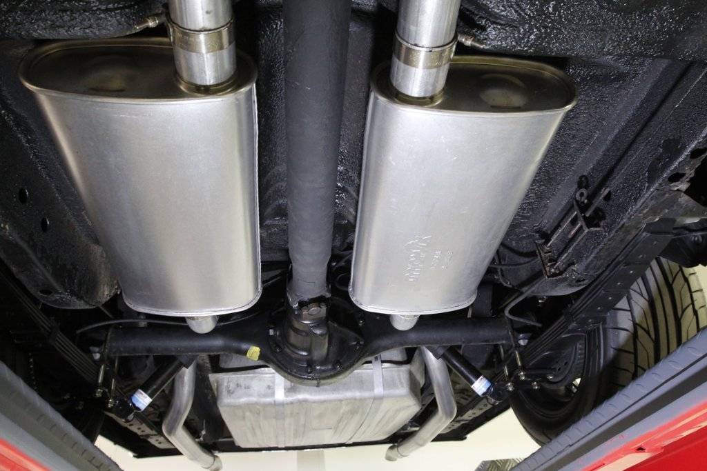

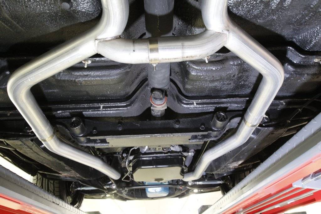

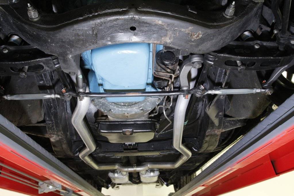

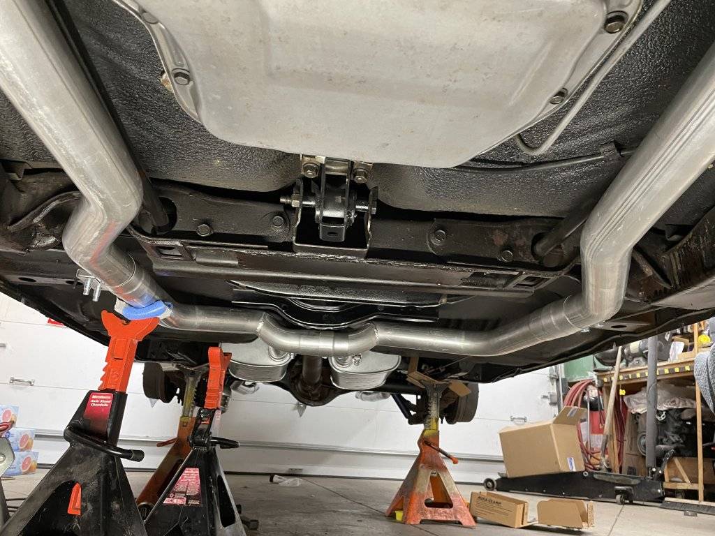

My dual exhaust installed without any mods or drilling to the Imperial, it went very easy with lots of room.
Here is a link to my install and a few photos of a 69 300 a 72 NYer and a 73 Imperial.
