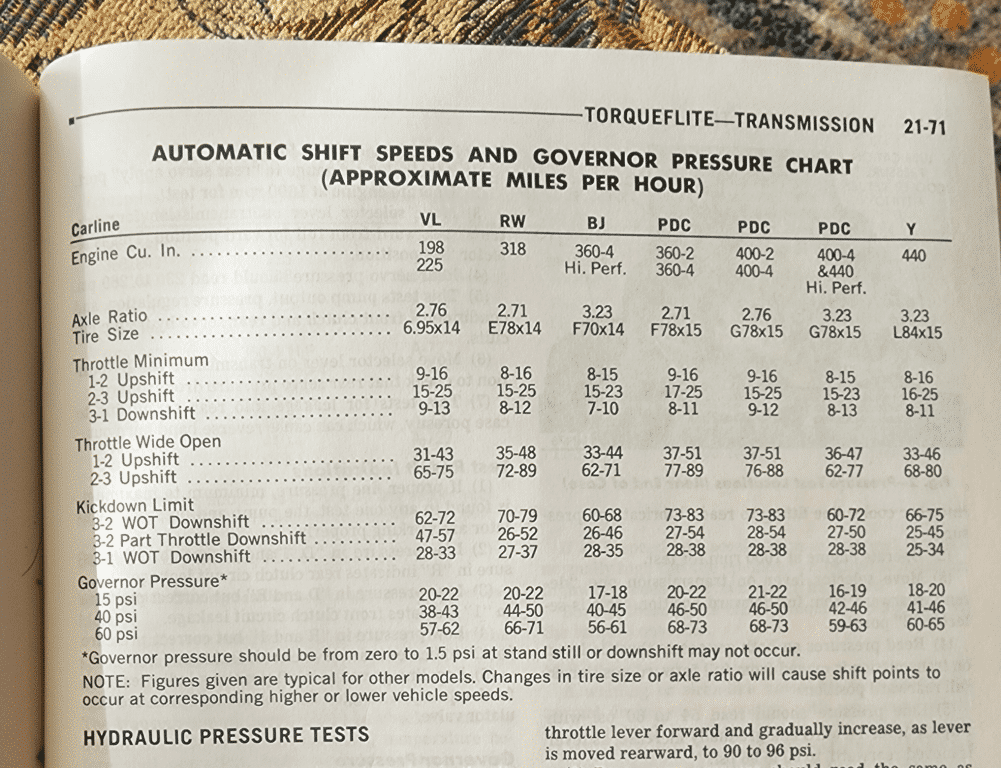

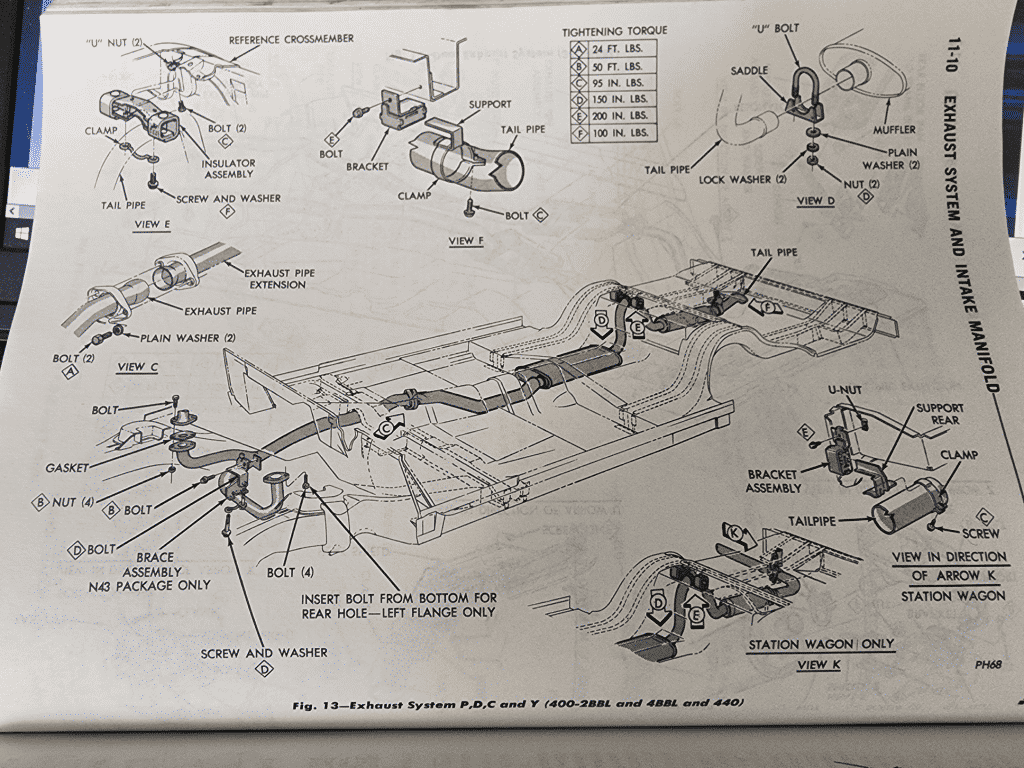

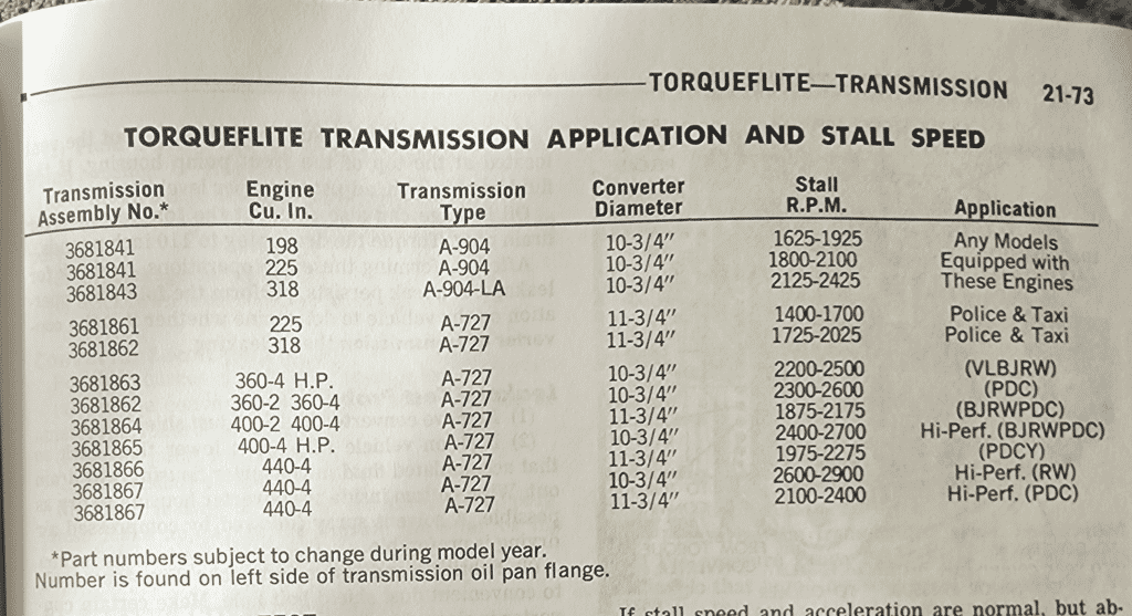

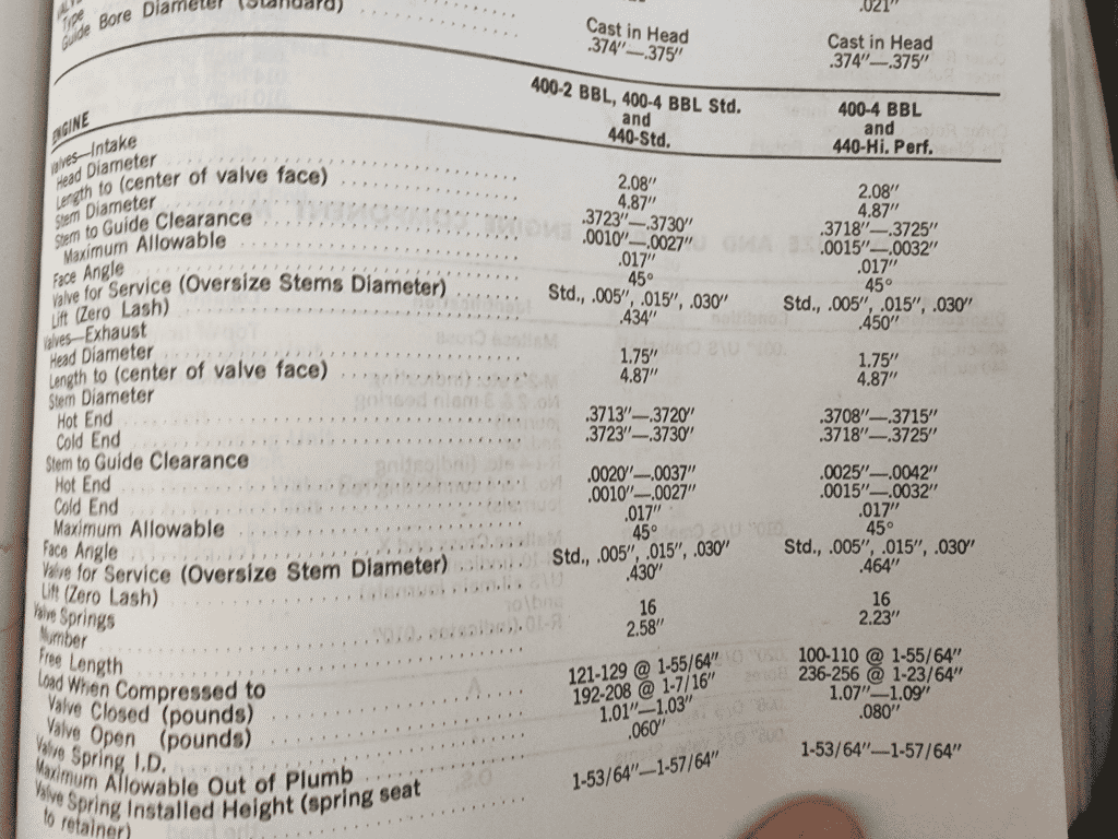

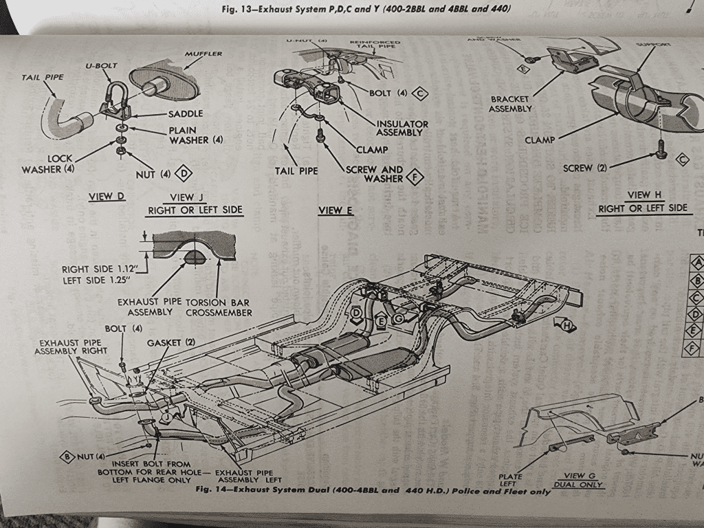

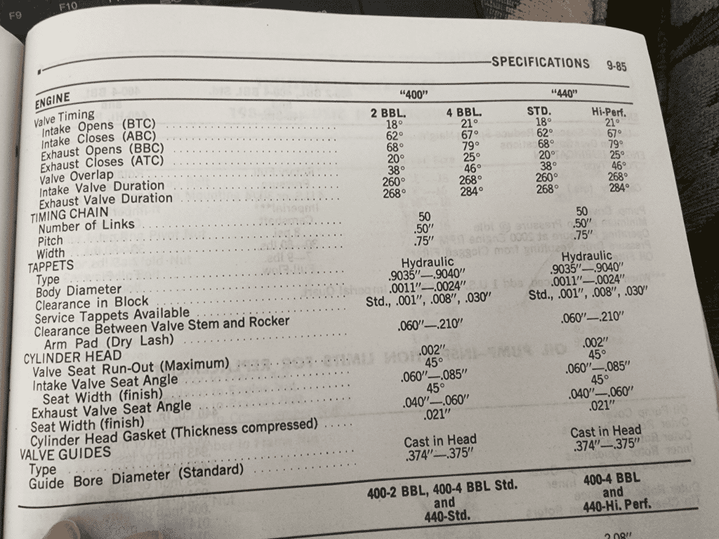

here some pics from the 74 chrysler manual showing some 440 & 440HP spec differences and the exhaust layouts of single & dual 440s

1972s had Holley 4160s, 1973s had ThermoQuads.
Now, look over in the transmission section and see if there are any stall speed specs. In the '78 FSM I have the stall speed specs look like something out of a drag racer's dream.

When I got a '78 FSM, which was ATF oil-wicked, that was the first time I recalled seeing factory-spec stall speeds in detail. Knowing that, in general for similar applications, that the 10.75 would be higher than the 11.75 converters. But when I saw those factory 440HP stall speeds hit right at 3000rpm, I was shocked that they were that high. Especially as everybody perceived they needed an aftermarket converter for their "hot rods". BTAIM
ONE other reason that I figured out these looser converters might be needed, from what I read decades ago, was that in the decel parts of the IM240 driving cycle, the looser converters would not inversely-load (as in keep engine rpm higher during decel modes, letting it return closer to idle speed during engine braking times) the engine, making it a bit easier for the engines to get past their emissions testing. Possibly @saforwardlook might have something to add to that subject?
Now, these looser converters ALSO can make it more difficult to drive the cars for best highway fuel economy, too, especially IF the highway cruise speed rpm is below the stall speed of the converter. Back in the 1980s when all of the OEMs were having "parts warehouse clearance sales" to the dealer network, I scored a '79 THM350C transmission assy for my '77 Camaro, knowing that (at that time) a good THM350 overhaul would be about $200.00. I got the '79 Z/28, Corvette L82 spec trans assy (with converter) for that price. Which had the lockup V-6 converter in it. I had already observed that Z/28s had a looser converter in them than a normal 350 did. Those Z/28s also had 3.42/GR70-15 axle-tire size combinations, too, whereas the normal 350 Camaro would have 2.56/FR78-14 combinations. In order to get more ground clearance for the front valence panel, I put P225/70R-15 Z/28 take-offs on my car, so it ran 2000 rpm at 62mph. With that looser converter, it required a steadier foot on the throttle to get close-to-prior highway mpg figures (in the time of 55mph national speed limits!). I still do not have the converter lock-up hooked up.
When I was looking at '76 Cordobas, I wanted one with the 400HO motor, but also wanted a 2.71 rear axle ratio rather than the standard 3.21, for a couple of highway mpg more. PLUS real dual exhaust with no converters under it. But that dream was not to happen, NOR finding very many, at all, cars with that combination, W23s, and bucket seats, either. BTAIM
Back to the above charts. Notice the difference in 2-3 WOT upshift speeds for the 440-440HP compared to the normal 400-440 WOT upshift speeds. This will probably be due more to the differences in rear axle ratios more than anything else. 3.21 (usually) on the HP and 2.45/2.71 on the normals. Seems like the non-HP engines had stall speeds a few hundred rpms nigher in the '78 list, with the HPs being about the same as the '74 list?
Thanks, @marko, for posting the transmission specs pages of the '74 FSM!

One takeaway from seeing these charts is how do they compare to calibrations of converters in the earlier years? The numbers presented seemed unusual from my experiences with earlier model Chrysler engine calibrations and given that these engines were greatly detuned in terms of compression and power output (no thanks to the "lean burn" garbage either) plus even higher mass of the formal vehicles at least, these numbers are suspect for application to earlier vehicles....................
I would suspect that the torque converters from the 1964 and prior era were tighter than the '74+ specs. "Tighter" with respect to their quick response to throttle inputs than similar Ford or GM vehicles. It was noted that for the '65 model year, Chrysler allegedly loosened their torque converters a bit to decrease "Idle Creep". CAR LIFE magazine tested a '65 Satellite 383 4bbl in this respect, at a drag strip, clocking it at 7mph through the traps.
