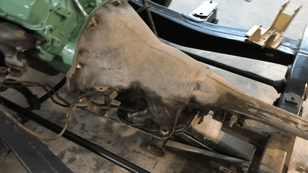

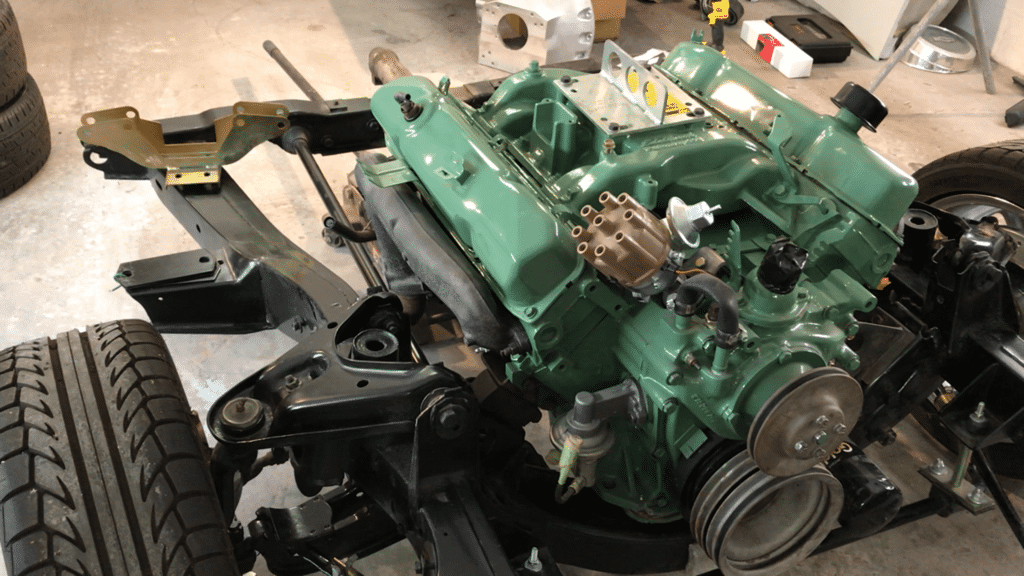

I know it's been a while, but some big things are happening!! The Tremec was delivered in the middle of December to the dealership where the car is located. It's over 100 miles from where I live so I only get to work on it a weekend or two a month. I do almost all the work to the car during the summer when schools out. I've started the install and here's some pictures as well as a link to a video on my YouTube channel. I'll be keeping you guys in the loop as well as the people on YouTube. I don't have a lot of subscribers yet, but there's always someone looking for ideas or guidance on a project.
https://youtu.be/bFe7PkFqw6U

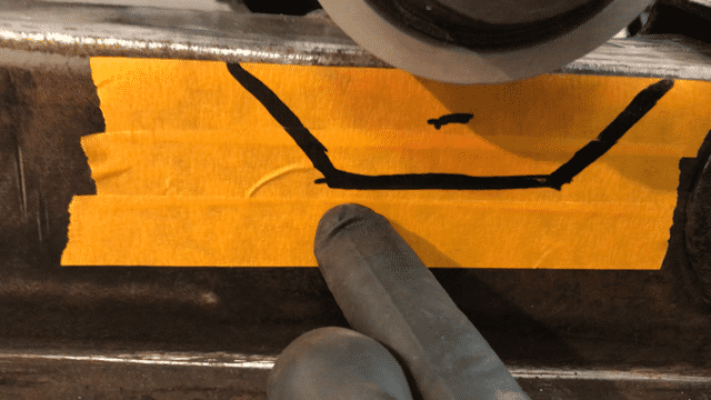

OK, moving on......Here's some pictures of the progress.
Here's the bottom of the cross member. You can see the bottom of the new top plate, the heavy mount area, and the nuts on the back side used to bolt the metal mount on.
After I cut the front off to fit, I bent the bottom lip down some and rolled the sides in. Once I weld it, it'll plenty strong

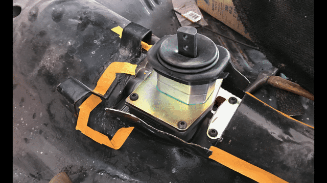

The first hole in the floor. The frame is bolted in and the trans is against the floor. I have 1/4 inch spacers raising the trans that I'll be removing. I want to make room for the trans with them in (plus extra of course). I have it marked with tape to show some areas of concern. At this time I think I might cut a large section of the tunnel and raise it to what I need, or maybe make a new tunnel, not sure yet.

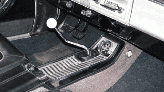

Here you can see where the shifter is. I purchased the piece from SST for the early B-body that allows a shifter to come up through the correct hole on the left. Not sue if it'll work on a C, but it looks like it will. The trans is only 1/4 inch too high for sizing, but it looks like the console needs to be raised a little with the tunnel. If I raise the tunnel, the console mounts go with it of course. Could work.
This is a picture from SST website. It's an early B-body (same console as a C) with their kit that includes everything to go from an auto to the manual Tremec. The shifter comes through the floor in the same place as it does in my car. This is why I purchased the adapter for the shifter.

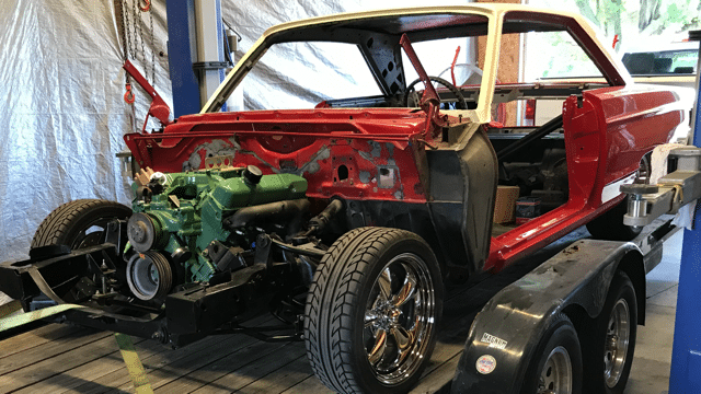

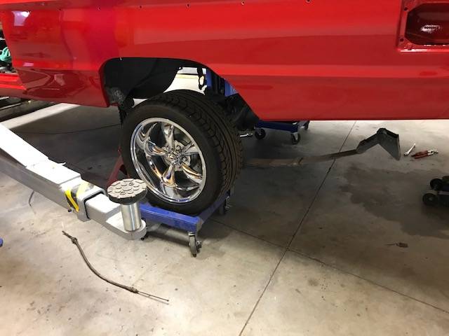

Hi guys, There's been a lot happening! I still need to do more editing with the videos I made through the summer and up to now, but here's some still-shots from those videos. I made A LOT of purchases through the summer and I'll get into those in the next post.

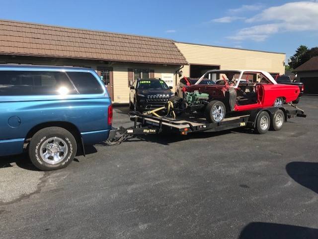

On my way from the dealership (Mark owns it) to another friend's shop (Mike owns that shop - There's a video on my YouTube channel of his shop and the pair of '66 Chevelle's he has)

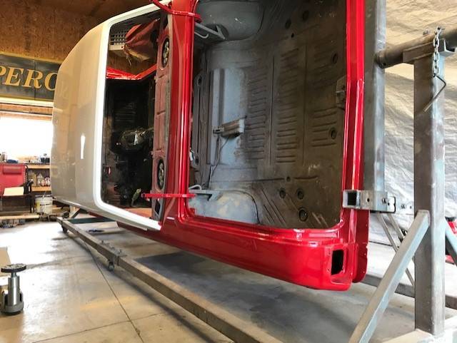

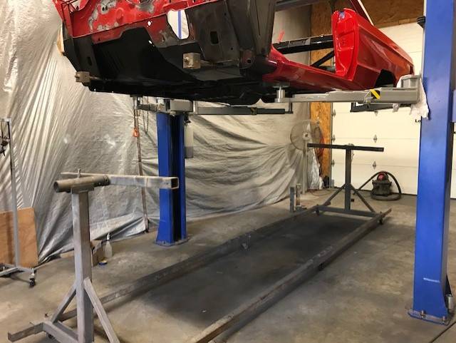

Getting it ready for the rotisserie.......
And here it is......
This was a little intimidating, mounting a painted car up and turning it from side to side. It went so well and how could I turn down the offer to use Mike's rotisserie and shop to complete this. While I was helping him work on his Chevelle, he asked if I'd like to put my car on it when there's time and room to do so - that was an easy decision!!!! My car could have never been done to this level without the awesome friends I have. I'll show you guys some of the cars I've either done or helped out on through the years. It goes both ways, we all work together really well!!

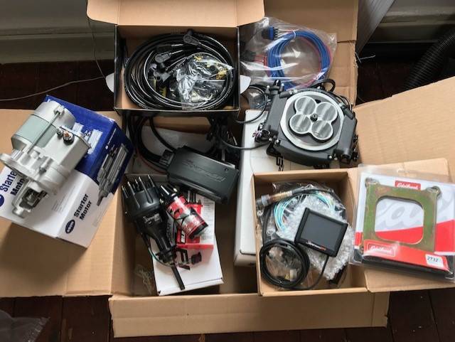

Here's an awesome box of goodies......
I ended up going with the Holley Sniper EFI with the complete ignition system instead of the Fitech kit I've mentioned before. I don't know about you guys, but I've had a list (wish-list) for years (owned the car for over 41 years) and change things as I research which items will be best for my needs. As I researched gauges, I found that Dakota Digital had the options I wanted (cruise control, automatic lights with dome fade out - I think 18 options can be added) and an option to connect with the Sniper unit, not the Fitech. I also liked the fact I could get a complete ignition system with the Sniper instead of mixing parts.

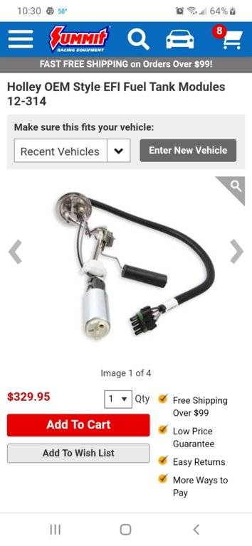

Patches66fury, you mentioned the Holley OEM style pump setup and I'm looking into it, but at this time it looks like this one from Aeromotive is in the running. One of the Rod Shops I've been purchasing things from recommended this unit because it's dependable and quiet compared to some others.

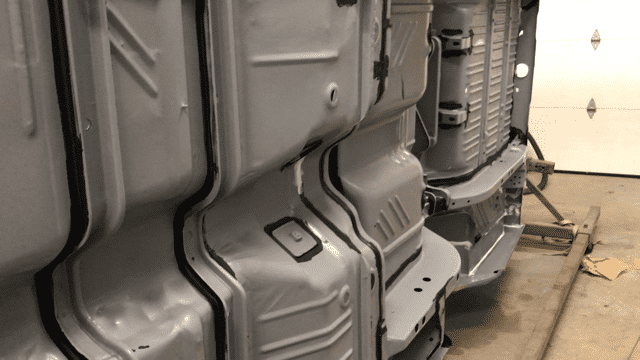

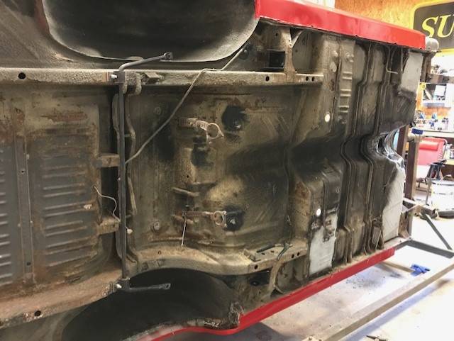

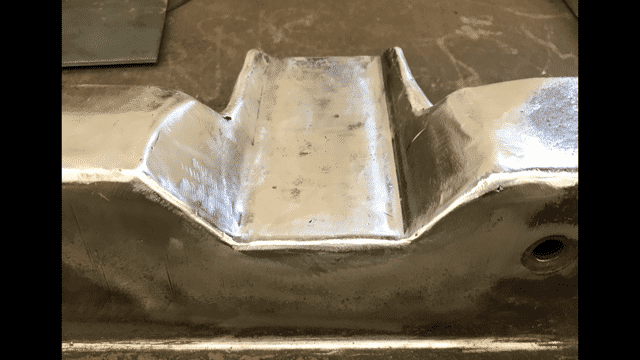

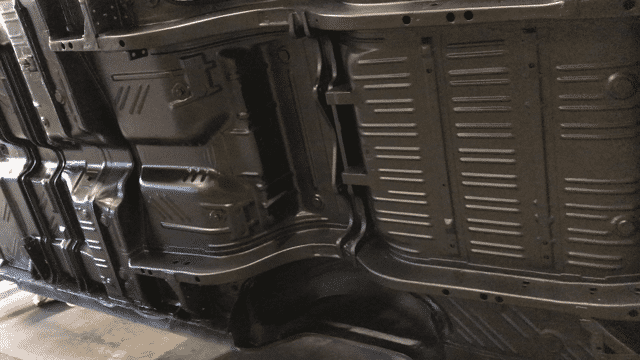

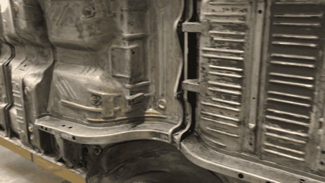

I've been finishing some things up and starting other parts of the build. Here's some pictures from the undercarriage job....

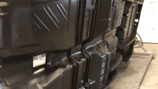

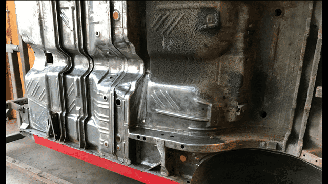

Here's the bottom after wiping it down with metal conditioner.
If you're interested in watching a video of this, here's the link.

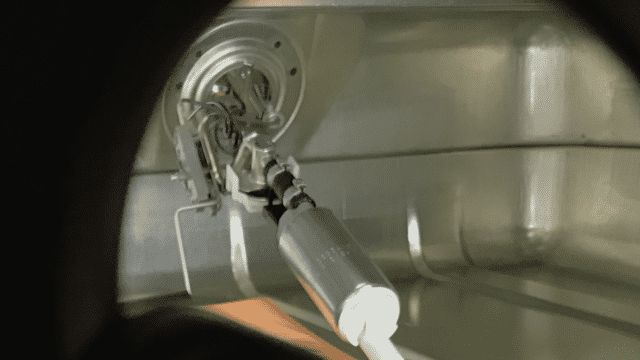

I almost purchased the fuel pump I mentioned the last time I replied to this post, but I just didn't want to cut the new tank. As I researched the options I kept coming back to an in-tank pump from Holley. Started out with one for a Chevelle because it has similar dimensions. After that I looked up a pump for a friend's '70 Road Runner (B-body) because he's thinking about EFI. I've had his tank and sending unit out and I remember it looking a lot like mine. Before I ordered it I jumped on this thread to checkout the pump you mentioned - it turns out you were right!!
Now the great news, it fits without adjustments. Checkout the pictures of the inside of my tank with it installed. Just awesome!! I hope the hydromat relaxes because the float will contact it, not hard, but it does. I'm going to take it back out and try to make the pump hold the hydromat flat on the bottom, that might help the float clear it.
At this time the only thing I see that's different is the fuel line coming out of the tank, it turns up. Won't know if that's an issue until I install the tank. I have 3/8" stainless fuel lines and still need to purchase the high pressure hose/clamps as well as a filter. I'll post more about it when I get that far.

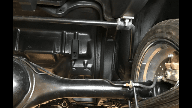

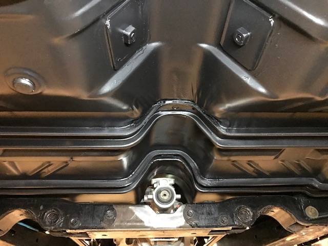

Here's some info and pictures of the last day on the rotisserie. I installed the new leaf-springs and tubular upper control arms. I have a new steering box and will install it after I pull the engine/trans out of the frame - for the last time I hope; it needs to be altered a little and it'll be easier with the engine out. I also need to paint some parts and install new mounts.

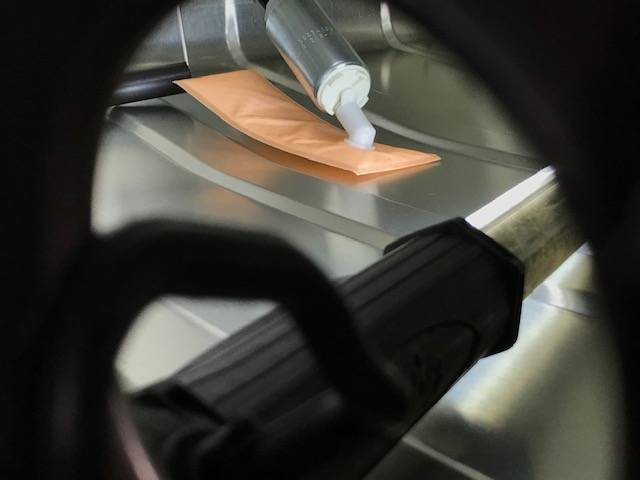

Applied the sound deadener to the roof first......
Here I'm taking it apart.....

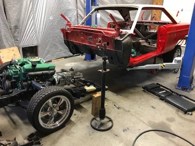

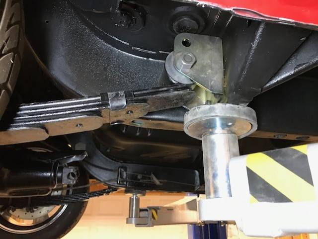

I didn't get pictures or video of installing the frame and the rear springs/differential, but it's all coming back apart. I have the frame back out now so I can installing the a/c and paint the firewall. The springs need to come back out because I didn't have the special grease for the urethane bushings with me. I'll have pictures and video during final assembly.
I hope the rear sway-bar doesn't interfere with the TTI exhaust.
The springs are an inch and a half drop from stock and firmer to match the torsion bars. The spring mount will allow it to sit another inch lower if needed for the right stance.

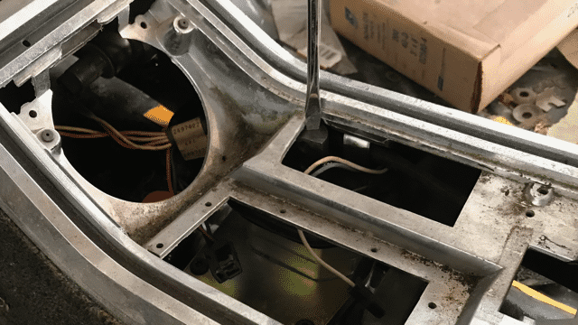

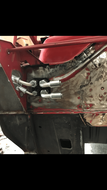

Here's a teaser for the a/c install. Some of you will understand what was needed for this to be possible, others will get it when I'm finished and post the progress.....
