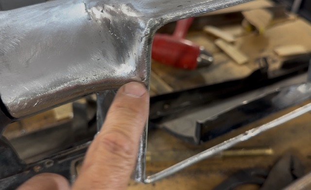

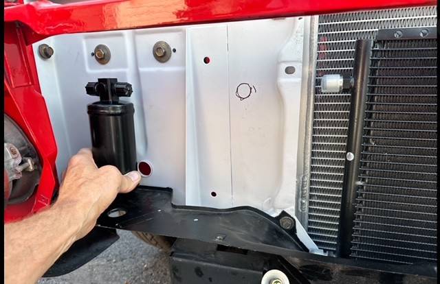

Here's an update on the Fury. I have a large BeeCool radiator installed in my car. It has two 1 inch cores and BeeCool advertises that it will cool better than a four 1/2 inch core radiator. It's supposed to transfer heat better. You'll see in the first photo the core is partially covered.
I cut the original edge off and then cut 4 1/4 inches off. Moved the original edge back. Here you see it clamped in place.
I used a piece of the metal I cut out to fill the gap made from moving the original piece over. Here you see it all welded up.
And here you see it primed and installed. After I finish installing the a/c condenser, hoses, and drier I'll remove it for paint. It's the last of the paintwork. You can see the whole radiator core is now available for cooling. I think it'll look like a factory support when I'm finished, well, maybe not to the people on FCBO :)

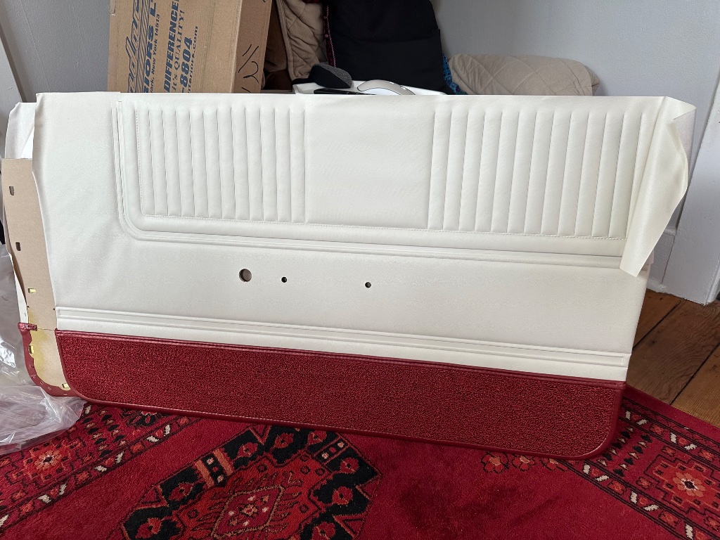

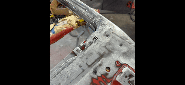

Then it's on to the interior. I'm going with something that was never offered, ivory and red. It will match the exterior and look like the factory offered it. That comes with a price though, Legendary Interiors charged 25% more for custom orders and it adds months for them to complete it. I have everything at this time, including the seat-belts. I'm putting 3 in the back seat and I added 3-point belts in the front for safety. I have the nuts welding into the roof now. I think the factory already planned to install 3-point belts because the holes are already there. I ordered the 3-point belts for a 1970 Road Runner and they fit well. I was in a friend's RR and I liked how the belts can be placed in the clips above the door glass when I don't want them hanging down. When I start installing the interior, I'll show what's going on right here :thumbsup:
what's the deal with that door panel? is that something Legendary made up for you? their site shows no c body door panels...

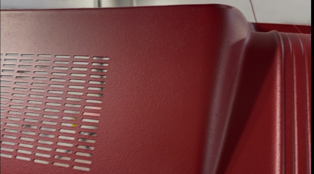

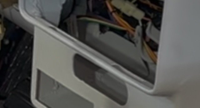

I went through Pro Fit Auto Interiors and Parts. I ended up ordering everything from them (front seat foam, seat covers, door panels, headliner, arm rests w/red pads, seat belts, and chrome door lock knobs. I'm probably missing something, but you get the idea. If you go on their site you'll find the interior for our cars. There was no problem getting a custom interior, it is completely stock appearing as you can see on the door panel. The seats look amazing in these colors with the chrome strip!! As you can see on the box behind the door panel, it was shipped directly from Legendary to me.

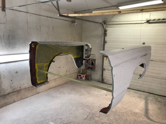

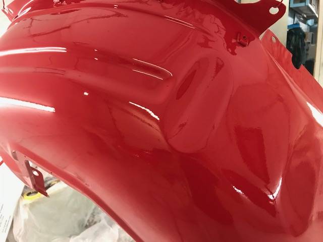

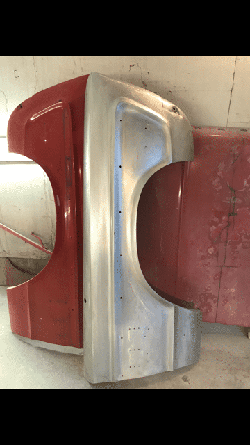

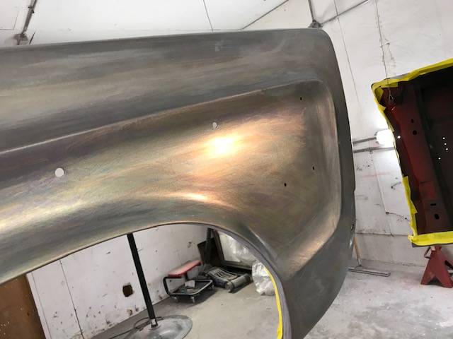

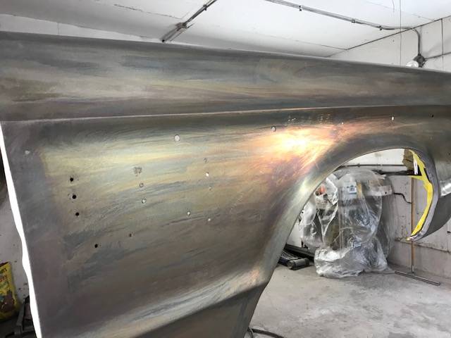

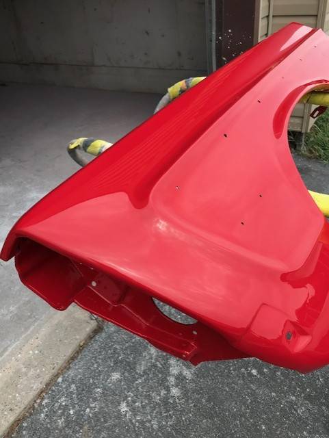

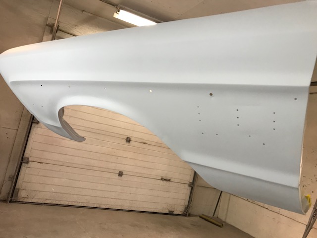

The metal conditioner makes the fenders look that way.

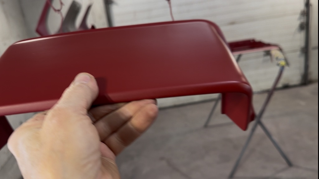

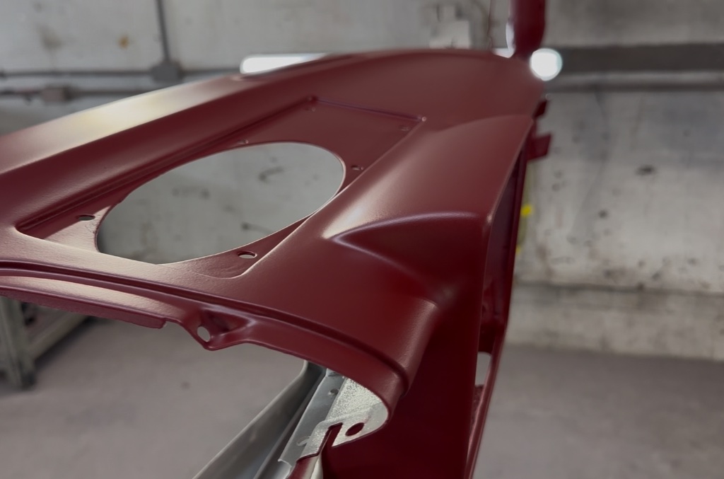

Ready for paint...

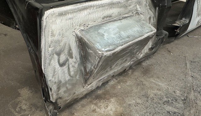

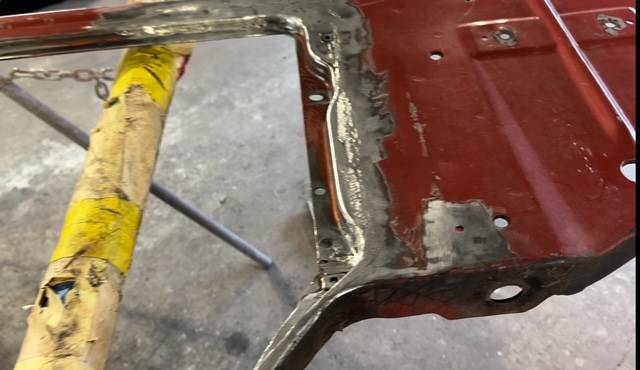

I put a dent in this wheel well for the A/C and heater hoses coming out of the firewall.

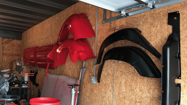

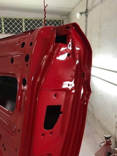

After I finished painting the parts, I hung them to keep them safe until they were needed. Some of these parts hung here for 2 years.

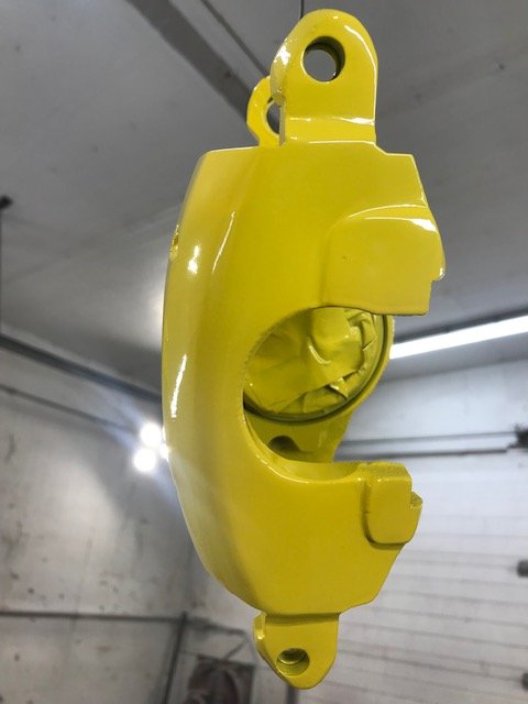

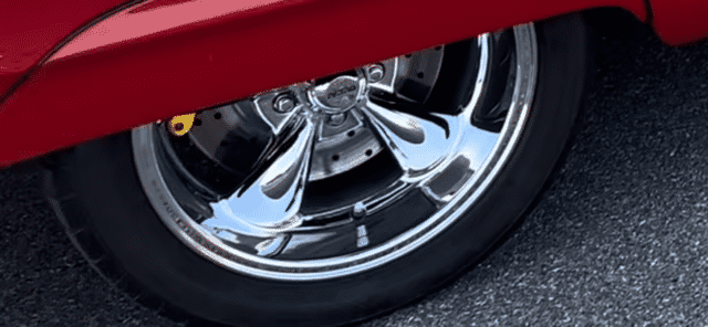

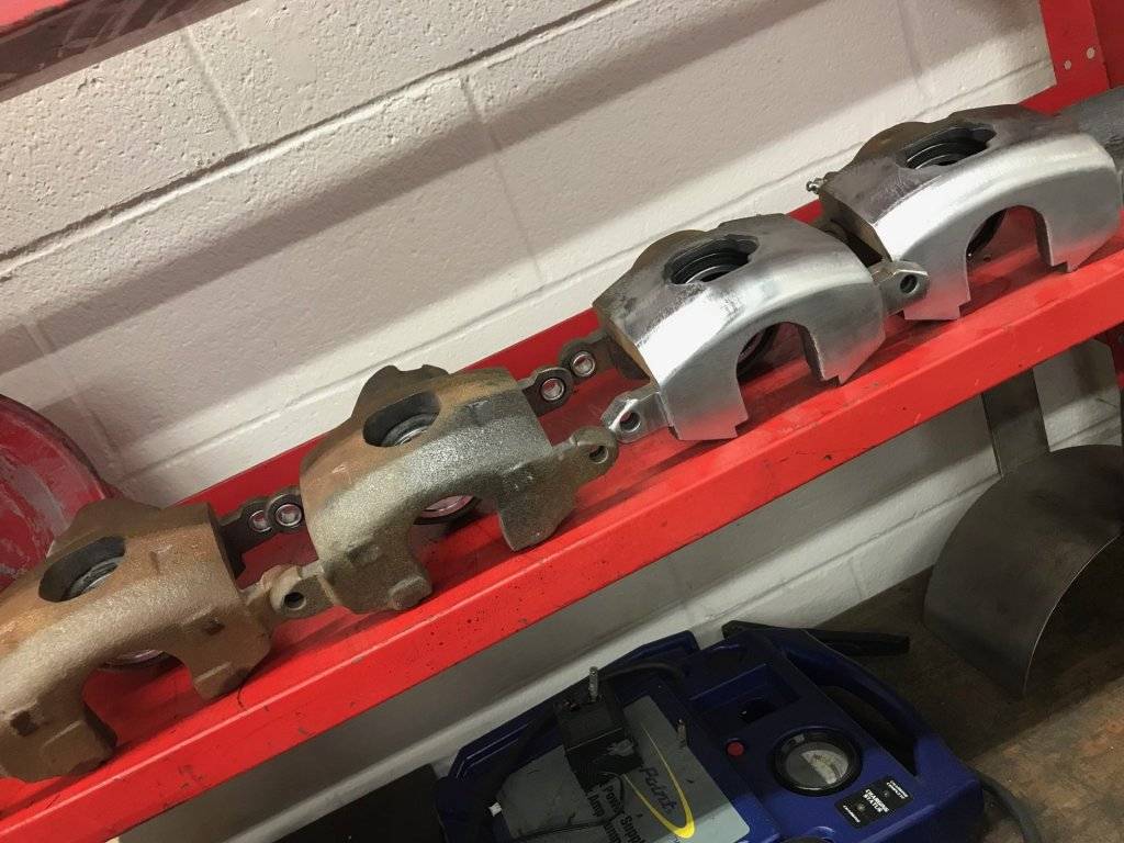

I used a grinder and then sanded the calipers smooth before epoxy primer then yellow caliper paint. I've finished off calipers like this before and it's worked well, so I hope it works again for me.
I purchased the complete brake kit in December 2016. There were no other kits available at that time, well, at least that I could find. I've driven this car several miles in a large parking lot and a couple miles on a private road and they feel amazing!!
I went with yellow for the contrast, so far I really like them, if that changes they'll be a different color.
I planned on going with 17 inch wheels, so I was able to use the optional 13 inch rotors, I like how they fit inside the wheels.

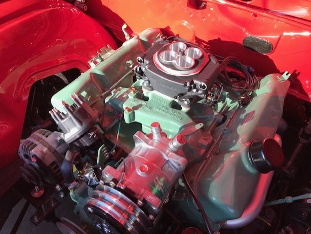

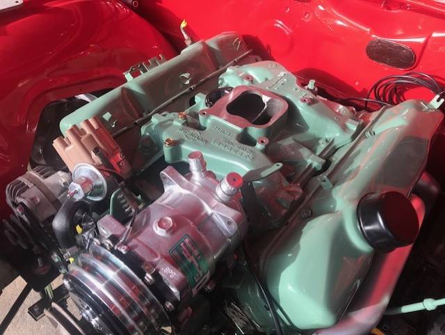

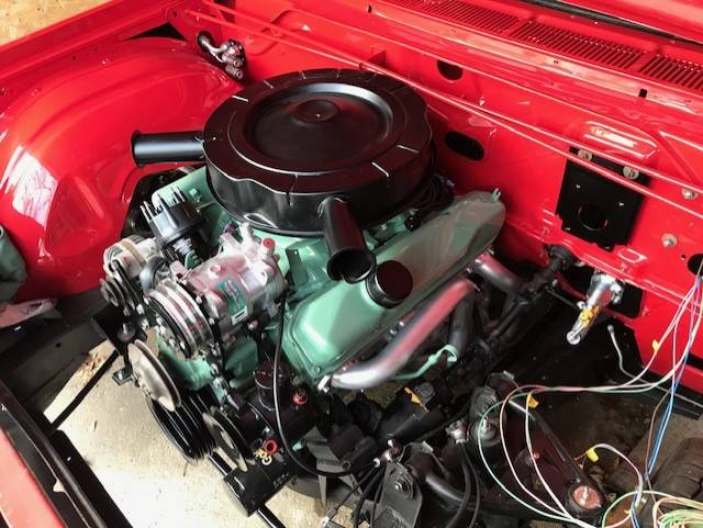

I was unable to use the Edelbrock Performer 440 intake because the air cleaner would have destroyed the hood liner and possibly hit the hood. I had to remove some of the divider between the barrels on a stock intake for the Holley efi. I purchased the stock molded hood liner and it'll be fine now.

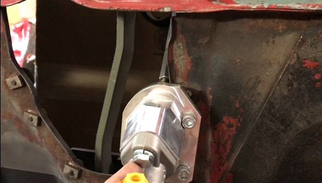

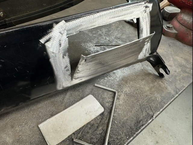

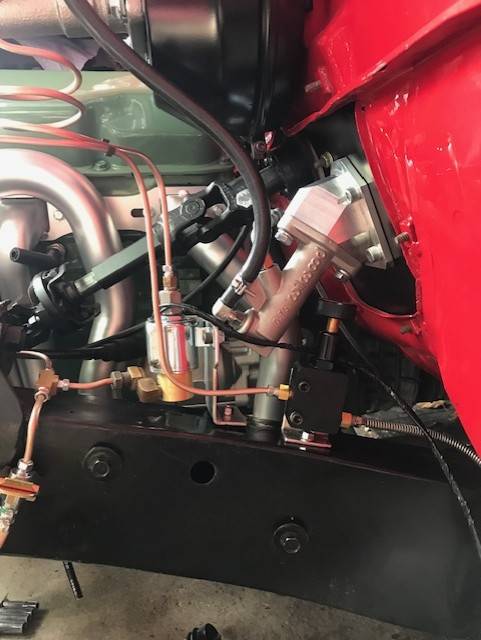

In this picture you can see the proportioning valve for the rear brakes, the hydraulic clutch is finished, the line-lock is in, and I haven't made the spark plug wires yet. With the wheel well in, all of this is out of the way and doesn't really look out of place. I have to reach around the clutch master cylinder to adjust the proportioning valve, but once it's adjusted, I shouldn't need to mess with it anymore. It's not hard to get to and I like how hidden it is. You can also see the larger plate that fits around the steering column and has the clutch master cylinder mounted to it. I made the edge of the opening match the factory opening and welded the factory square nuts where they needed to be.

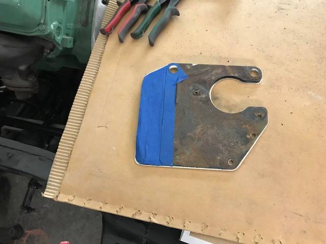

This is why I had to enlarge the opening.
The blue tape was what I used to make the template for the new 1/8 inch aluminum plate.
I've made changes all over this car, some pretty significant, but I always try to make it look like the factory would have made it. Obviously, in my eyes and we all look at things differently.

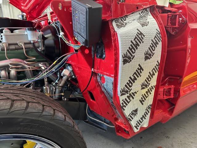

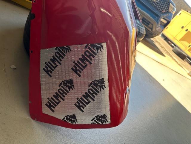

Here you can see the cruise control box from Dakota Digital. I didn't want it under the hood where it would be seen. There's several settings that need to be made when I start driving it, but after I make them, I'll install the outer wheel well and it's hidden away and in a safe place. I used sound deadener everywhere.....

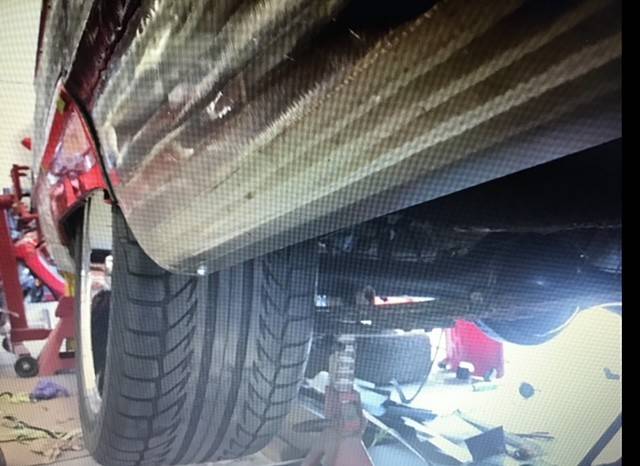

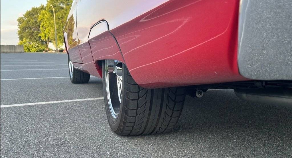

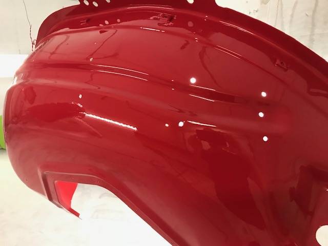

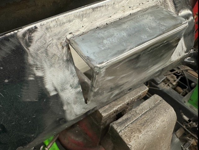

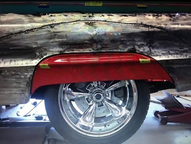

I think I made the quarters in 2017. They fit like a glove, the skirts fit as they should, and all the lines are correct, even the one that fades out above the skirt.
I wanted the rear tires to fill the space between the springs and skirts. A 9 inch wheel with a 1/2 inch + offset was it. I don't like the low profile of these tires and when I'm close to having it ready to drive, they'll be changed to a tire a little over an inch taller. It's a shame that these tires have aged out, they're over 6 years old and will not stick to the road nearly as well as new tires.

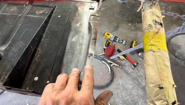

On November 7, 2018 I made a post on page 1 of this thread. I mentioned that I got my pedals (for the stick swap) from a '65 SF convertible and that I'd mention it later, well, it's much later........
The car only had around 40,000 miles on it and had been sitting in a salvage yard since '70 or so I would guess. The top was half way up and the material was gone.........for a long time! It still had one of the SF moldings and I also got it. The car was really stripped down. Nothing but the frame from the firewall out. The dash, column, pedals, front seats, and console were still in it and you can imagine what they looked like. When I stepped on a seat, it fell about 3 inched to the ground. What was really odd about this car to me, was that it had a 3 on the tree. The console had a plate without an opening for a shifter, the lid (not really an arm rest - not high enough) was there, but in bad shape. I had never seen this before, or since then. I had to chisel the section of firewall out that the pedals were fastened to and pull them out the front, there was no way to get the bolts out. There was no booster or master on it, so I didn't know at that time if it was power or manual - later I found out it was manual. At that time I didn't know there was a difference. I had to use the mount for my brake pedal and make some other changes and it works like it should. I found this car when I was there getting parts for another old car. This was summer in 2006. I have seen pictures of a '66 Fury with this console and column shift, but never a '65. Are you guys familiar with this setup?
