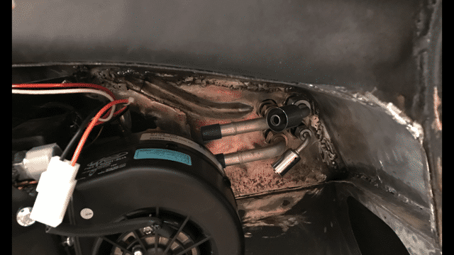

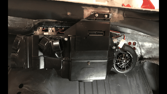

Hi guys!! Yes, it's been a while!! It seems like that's the norm for me. Here's an update on the a/c install. I almost sent the kit back and got a different one. I really didn't want to cut-up the factory air box. After looking at some of the other kits, I didn't see anything that would have been any better. so here it goes...............
I posted a picture of the bulkhead fastened onto the firewall in the last post I mentioned the a/c, here's what it took for that to happen.

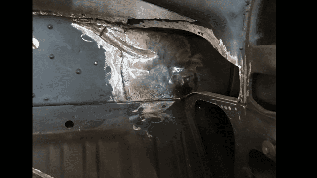

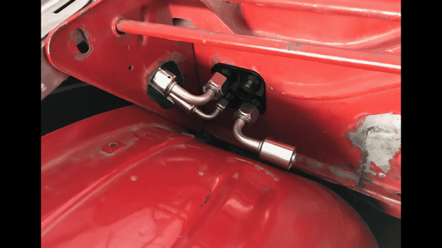

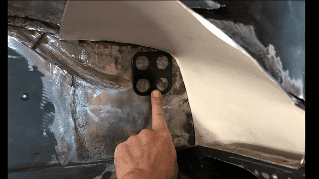

I thought it would be a much cleaner install if the a/c lines went out through the wheel well area and back in at the front.......
The heater hoses will still be able to fasten to the valve cover!!
I think I might run hard lines instead of hoses everywhere. Use hoses only where they need to be, at the engine.

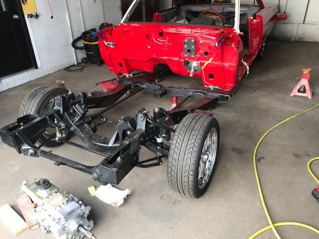

I hope my build can help. I know if I had it to do over again, I’d have done some things differently. Schools almost out (less than a week!!) and I’ll be working on my car again. The past couple months I painted a friend’s ’70 GTO Judge convertible clone. He’s going to build it like I’m doing mine, lots of updates.
I want to pull the Tremic TKO (didn’t even have oil in it yet) and install a TKX this summer as well as have the car assembled. The engine made more power than the TKO is rated for. Sure it’ll work, but every time I would “get on it”, I’d be concerned I was hurting it.

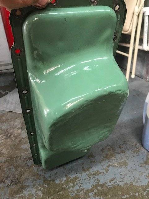

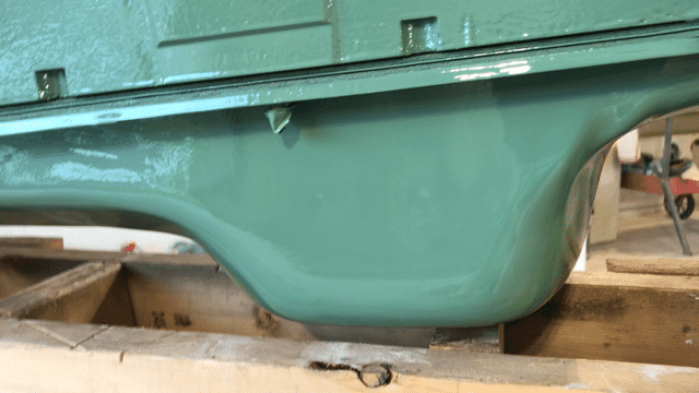

The first thing I did this summer was spend 3 hours taking the frame back out, picking the engine and trans off and separated them, that's really how long it took. The original oil pan wasn't in great shape and I dented when I used a block of wood and a jack to take the weight off the mounts to move it. To install the TTI headers and exhaust the engine has to be correctly located in the frame and it was off a little. I was going to pop the dent out, but I didn't like the scrapes and previous dent repairs I made before. The new pan is great!!

This is why I changed it.......
This is much better!!!!! Took 2 gaskets because of the windage tray.
NO, it's not touching the stand.

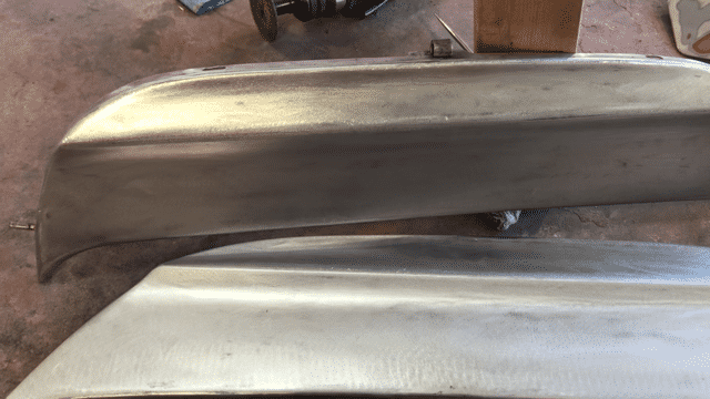

The skirts are original to the car and in like new condition, couldn't be nicer! The problem was that with 275/40 ZR17 tires on 17 x 9"wheels (13mm + offset), there was no way to install or remove the skirts at ride height. The body needed to be raised off the differential for the skirt release rod to pass between the tire and skirt. I added 1 1/4" to the rod and it works like it should now.

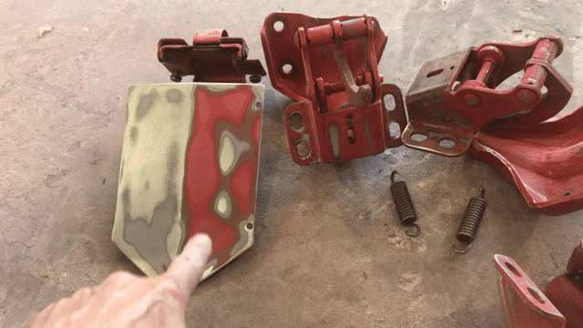

I finished stripping the fuel door before paint. Installed the hinge springs after the paint cured.
I was unable to find new hinge rollers, so i purchased bearings and had the roller and center shaft made out of stainless. Assembled them with new spring pins and they work great.
Stainless roller made to the outside dimensions of the stock one - then machined for the bearings and the shaft to go through it.
The bearings roll on this shaft.......
And the shaft is held in by these spring pins.

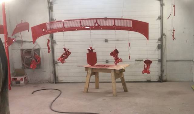

PAINTED!!!!!! Cowl panel, hood torsion springs, hinges, fuel door, upper grille support, a bag of new bolts (put holes in cardboard for them), and skirts.
