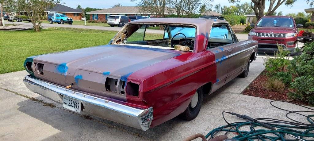

Now it's dried and I've seen it in the sun and the shade... The red buys it.

I have a few red cars, and I like them. However, the original paint on your car appears to be that sandy rose (lialac?) color that is so stunning on a C-Body. Is that the original color on your car? If so, I vote for that. . .
No. The factory color for my car is refrigerator white, with a blue interior.
Previous owner painted it Mauve, which is good but a hard color to get right, his painter managed to make it look like a bowling ball.
