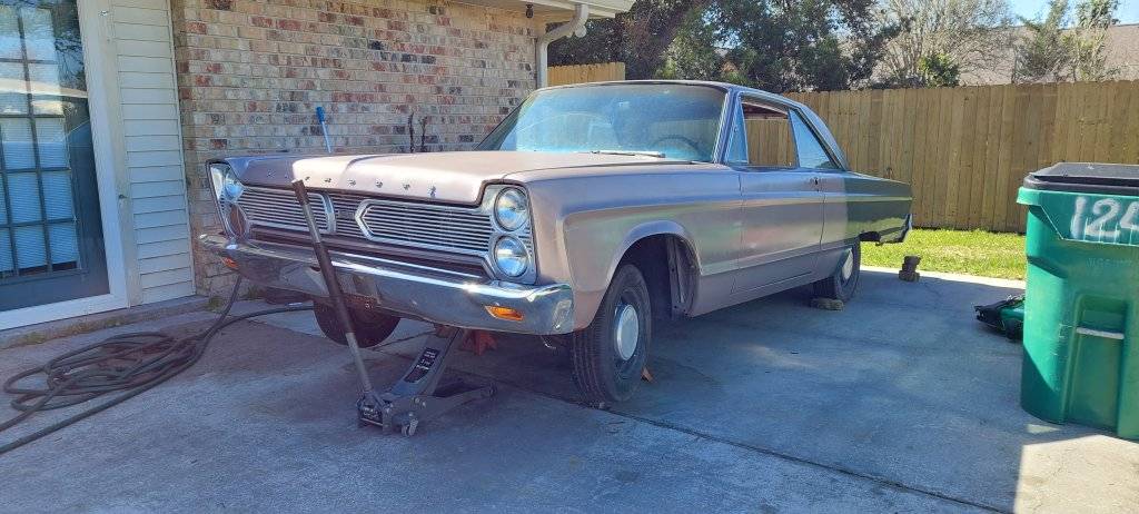

1966 Fury III - Unfinished Project
Engine is dry.

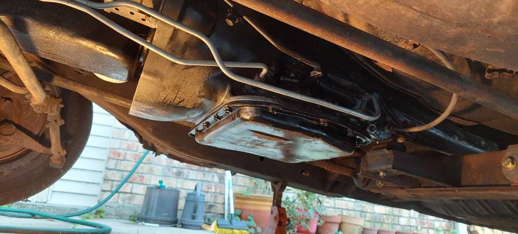

Transmission leaks like a sieve.
Looks like it's leaking from the selector shaft, at a guess I've overfilled it? Or is that a common 727 leak point?
Edit: yup, common leak point and apparently the 727 is bad for converter leak down which overfills the pan. Great. Engine and trans out for that task.
Rear end yoke is also trash, so that's gonna be fun to remove...

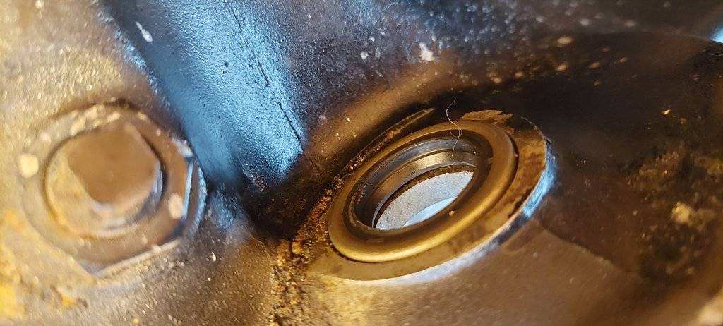

Decided to carry on with the gearbox seals.

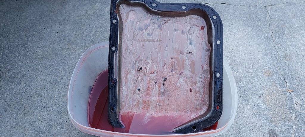

My transmission... It was full of mayonnaise and flies.

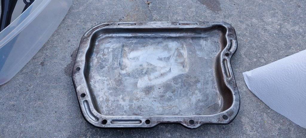

It got cleaned and the dents beaten out of it.

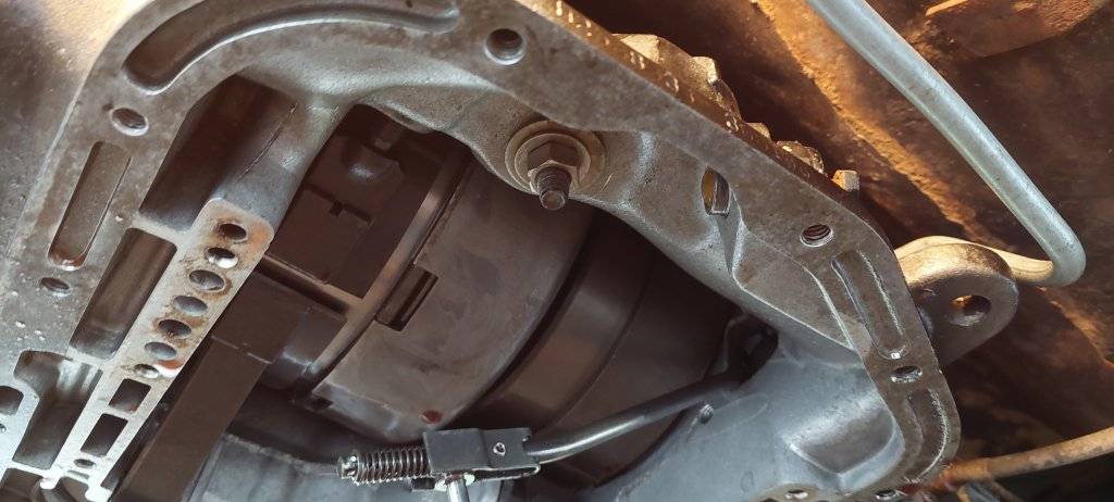

I need to drop the valve block and pull the gear selector. The smaller seal on the kickdown arm also needs changing.

Nice to see it cleaned up! Flies?? Odd...
When you get ready to reinstall that pan, peen the bolt holes outward to help spread the load of the fastener head along the gasket pan rail. I can see that a couple look like they're oh so slightly turned inwards, and may result in gasket leaks.
Yeah, it's got some that are pushed in. I'll push them slightly proud with the end of my ball pein hammer.
The seal feels like it's made from Masonite.

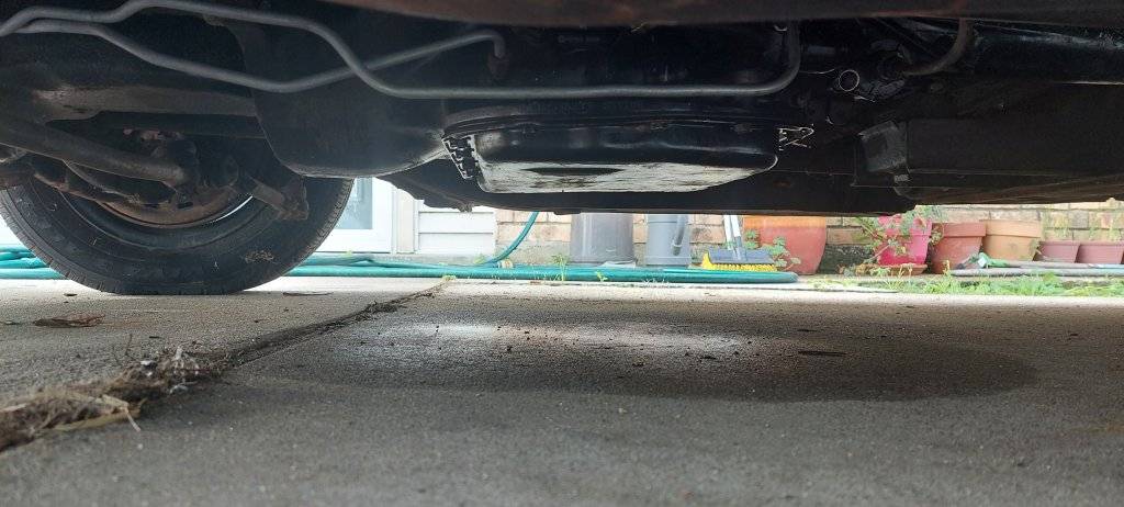

I think somebody did already. I straightened out the edges and base of the pan this afternoon. It's hit something going down the highway...
Nope, wrong seal
Seems that's listed wrong for the wrong transmission. Was hoping to get it put back together before the bad weather but that's not gonna happen now.

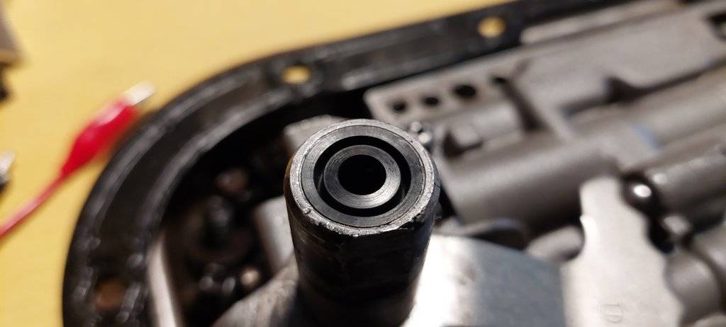

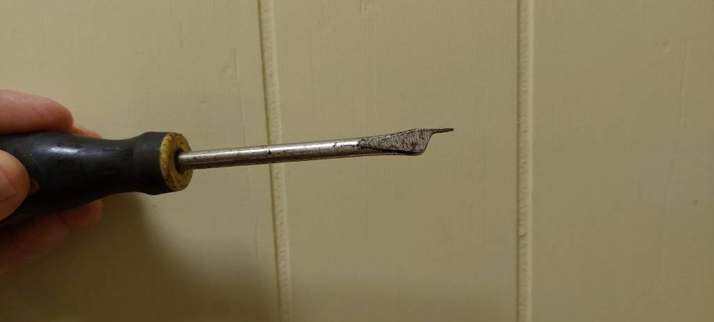

Gor the manual shift lever seal out. It was junk.
Carefully wound the new one down with washers and a bolt.
Naturally the back edge caught and it warped into a pretzel.
Put the new seal in. Straight this time.
Went in okay which is good.
Reassembled the rest of the valve block.
That works. We'll see if it leaks in the morning.
