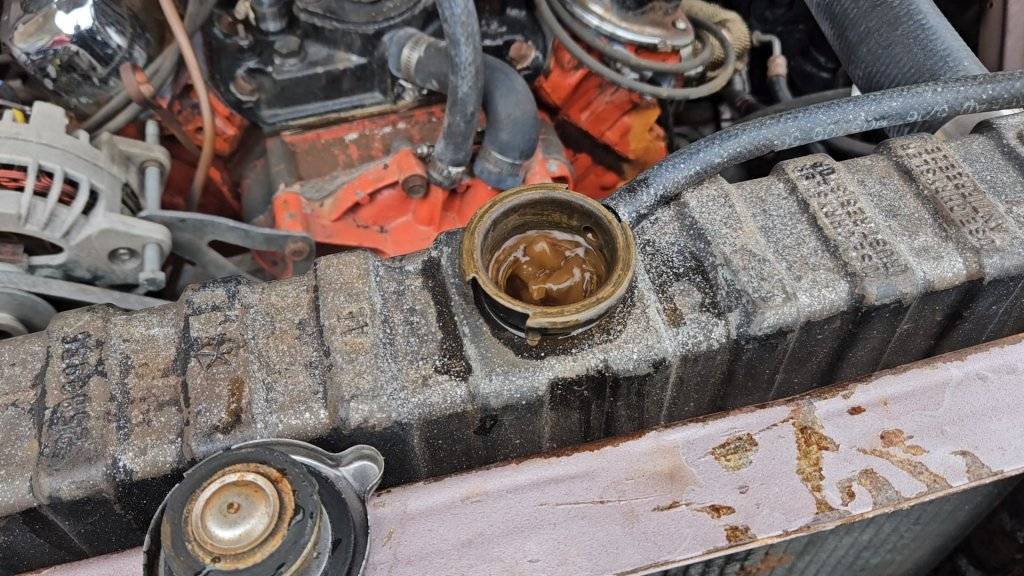

Took a look in the radiator and observed an unhappy volume of brown sludge, dried up after a week empty. Added some dishwasher soap, filled up with water and ran it unpressurized until it boiled.
Blorp. Drained and flushed repeatedly.

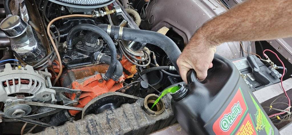

Just water for now but that's a lot better. No leaks, so it'll get some antifreeze to prevent it going all rusty again.

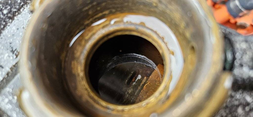

Seems that cleaned it out too well.
All the coolant ran away.
Ordered a new freeze plug set. Really need to pull the engine; running the front brake hard line will be easier and I've got some welding to do so, I guess the old heave ho going to happen again.
