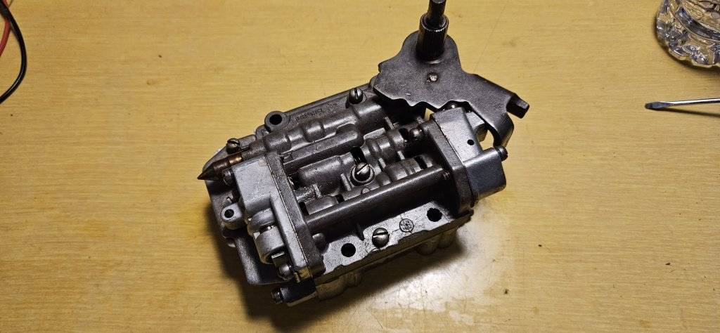

An early Detroit Gear analog computer module.

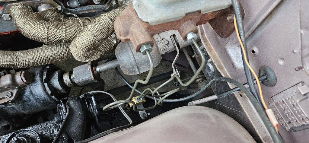

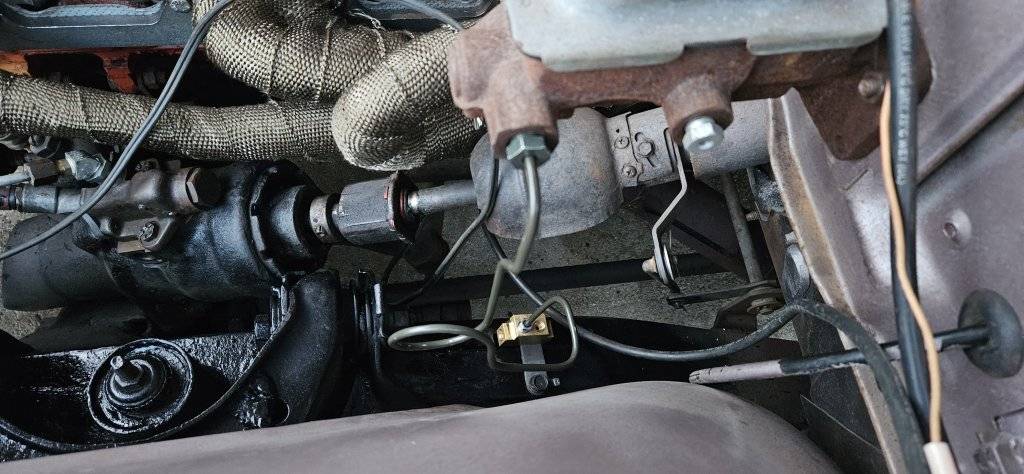

I went through a bunch of fittings trying to find the correct ones to adapt today's master cylinders to our original brake lines/prop valves. It's stupid....why does the brake system use THREE different union sizes?!

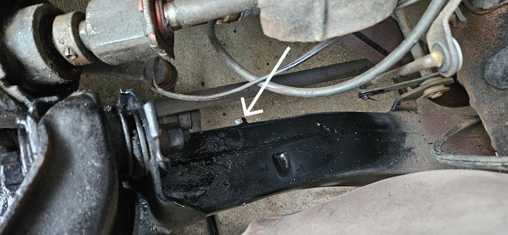

Same bolt and hole.I'm guessing that's the original mounting bolt for the single brake system pipe distribution block?
How y'all mounted the dual version from later models?
Phil
Thanks. This has a lug; i think I'll just cut it off, the chassis leg doesn't have the hole to position it.Same bolt and hole.
Those are 2 separate circuits in that block aren't they?...and another.

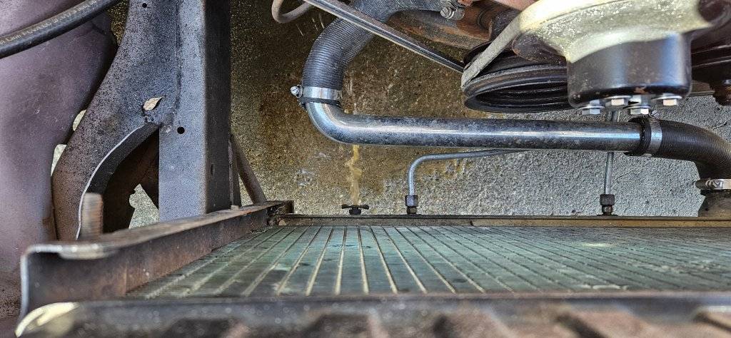

The next few need for the car to be jacked up. Ran out of light today.

There should be. One line to the rear that is split on top of the rear axle and two that run to each side up front.Those are 2 separate circuits in that block aren't they?
Yessir, there sure are. It's the later version than the car originally had. I prefer dual circuit brakes if the conversion is readily available.Those are 2 separate circuits in that block aren't they?
