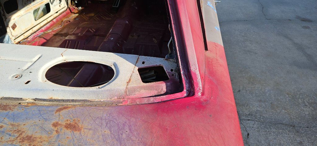

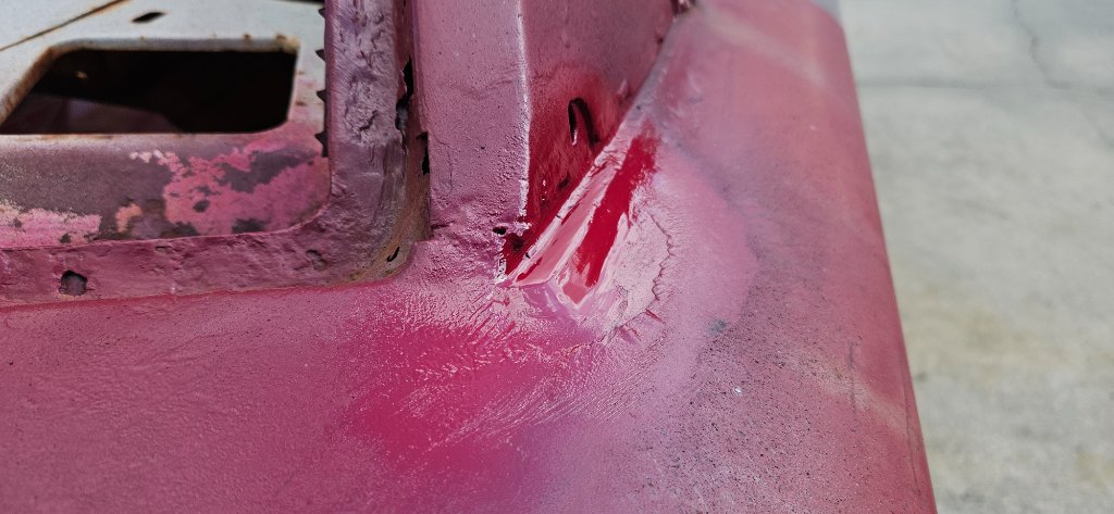

Dec 22, 2025 #741 Philip Andrews Well-Known Member Joined May 12, 2021 Messages 546 Reaction score 1,011 Location Larose, LA, USA Cleaned the welds up.

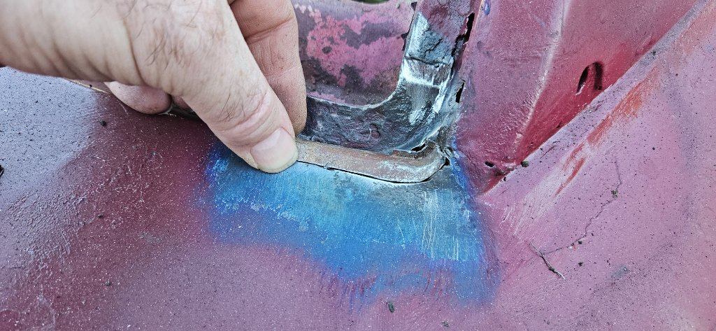

Dec 22, 2025 #742 Philip Andrews Well-Known Member Joined May 12, 2021 Messages 546 Reaction score 1,011 Location Larose, LA, USA Made a start on a replacement piece for the lower corner. It's a triple compound shape. Getting there though. These shall not be lead. They shall be steel. Much easier to fix when it rusts through again.

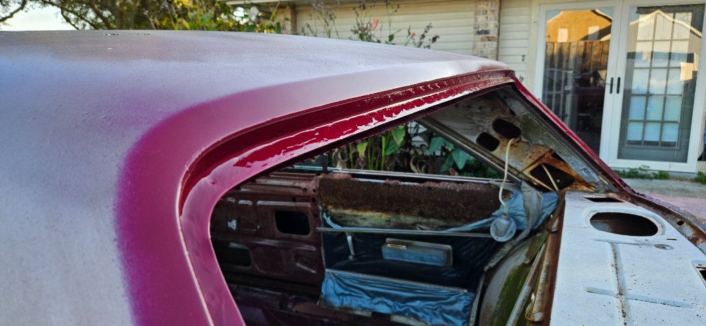

Dec 23, 2025 #744 Philip Andrews Well-Known Member Joined May 12, 2021 Messages 546 Reaction score 1,011 Location Larose, LA, USA Persuaded the rest of the screws along the top to undo, most of which were just rusted blobs of metal and needed hammer and chisel to unscrew. Cleaned the top of the channel. It's rusted in the stupidest places, like in the middle at the top. Guess the trim rubbed through the paint.

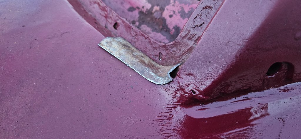

Dec 24, 2025 #746 Philip Andrews Well-Known Member Joined May 12, 2021 Messages 546 Reaction score 1,011 Location Larose, LA, USA Little bit of zip zip hammer zip. That's more or less the correct profile now. Need to tweak it a bit more yet but it fits pretty well. Phil

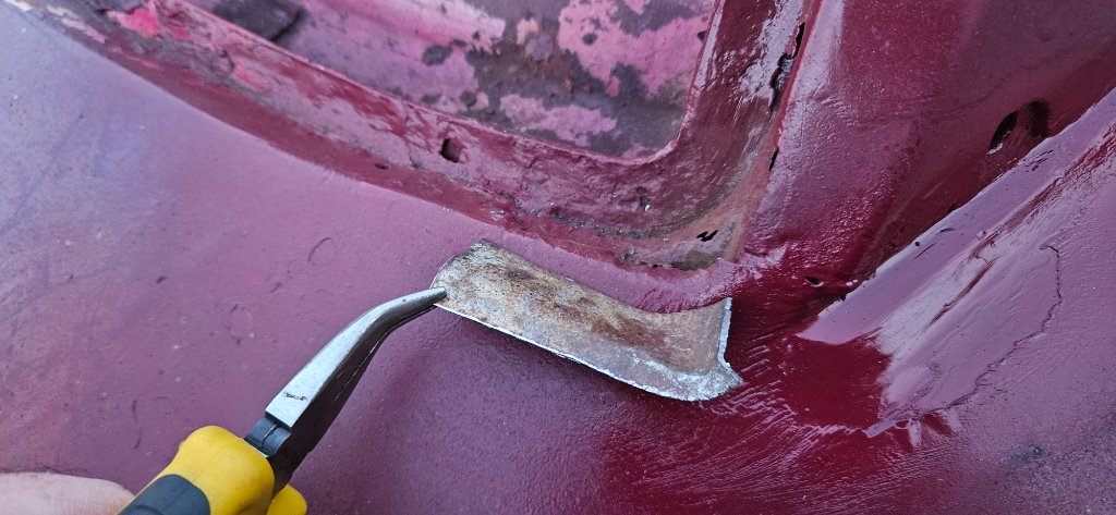

Dec 26, 2025 #747 Philip Andrews Well-Known Member Joined May 12, 2021 Messages 546 Reaction score 1,011 Location Larose, LA, USA Toom a moment to trim the rust back to good metal on the pillar and inset. Patched in the rust hole in the inner curve. Next up will be that square above it then the gasket lip. After that, I can rebuild the pillar and outer skin. Then, that's that corner done.

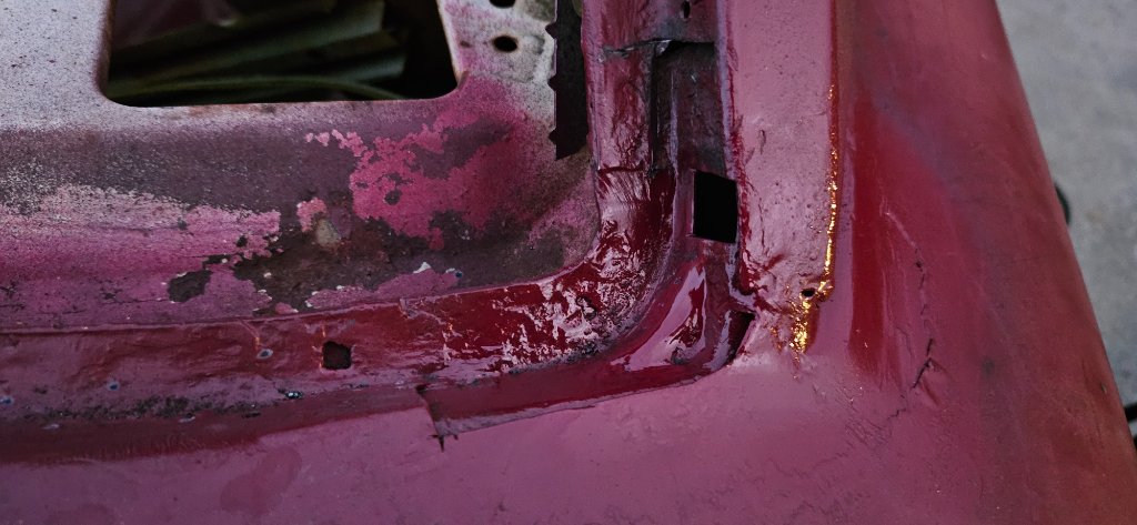

Dec 27, 2025 #748 Philip Andrews Well-Known Member Joined May 12, 2021 Messages 546 Reaction score 1,011 Location Larose, LA, USA There's a corner now.
