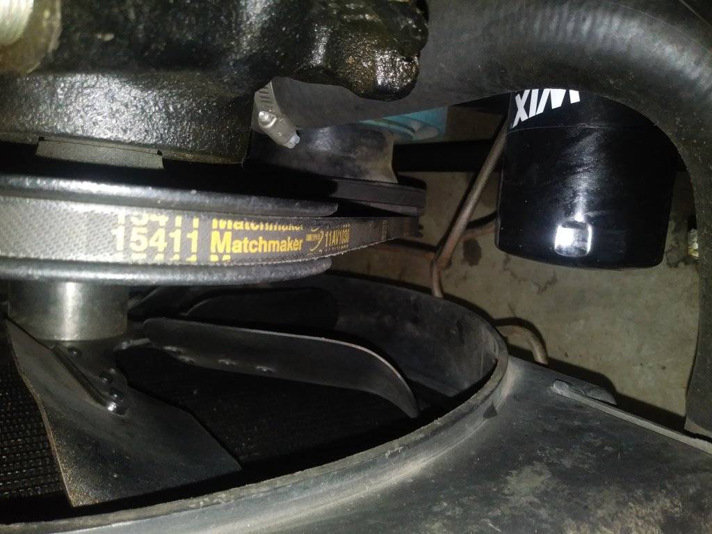

"I did 2 cars and speaking from experience both had to get a different belt.
I can look it up and provide the proper belt number."
Can you elaborate? was the belt too small? or big? and why?
Trying to get help from this forum....I got all these products from you guys but there's no installation instructions from the company and now finding out now I need a new belt, but got no idea why or where to buy that.
+unrelated questions that don't help me get this job done.
Might as well just bought stock replacement mount or rubber snub at this point.
Too big.
Had to get a smaller belt.
Cars in storage but will grab the belt number tomorrow.

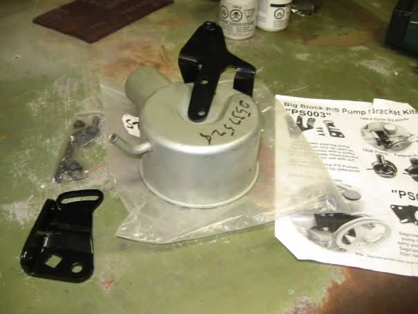

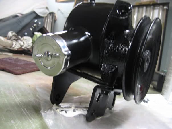

I no longer have the printed instructions but
hope these pics helps.
The square hole in the bracket is for a ratchet or breaker bar to tighten the belt.
Bolts that go through the water pump housing are wet bolts so make sure you use thread sealant or silicone to prevent any leaks.

Here is the belt..
15411 use this number at any parts jobber for cross reference.
Personally I use Continental belts which are actually Goodyear Gatorback belts.
They fit deeper into the groove and never had any issues with them.
Hope this helps..
right on
these help
i wouldnt have known what that square was for
