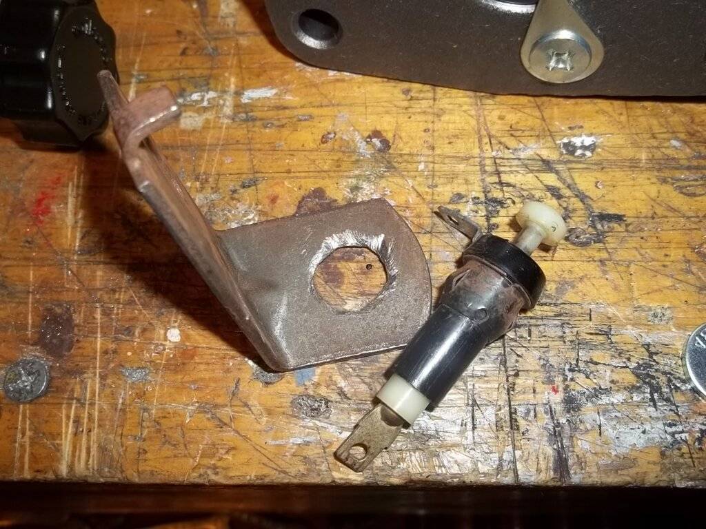

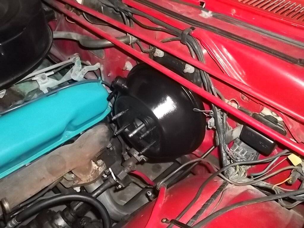

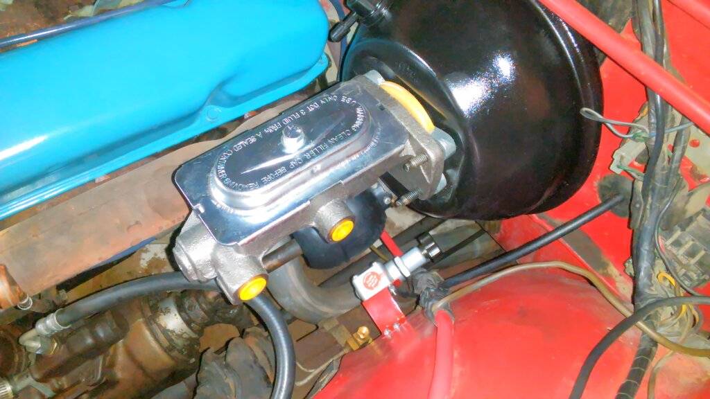

The booster is in. It was quite the battle but I persevered...along with the stoplight switch.
As you'll notice, the original switch was replaced by hacking up the bracket to fit an aftermarket switch. Less than stellar results, no doubt the work of of Larry, Moe, and Curly.
Booster...

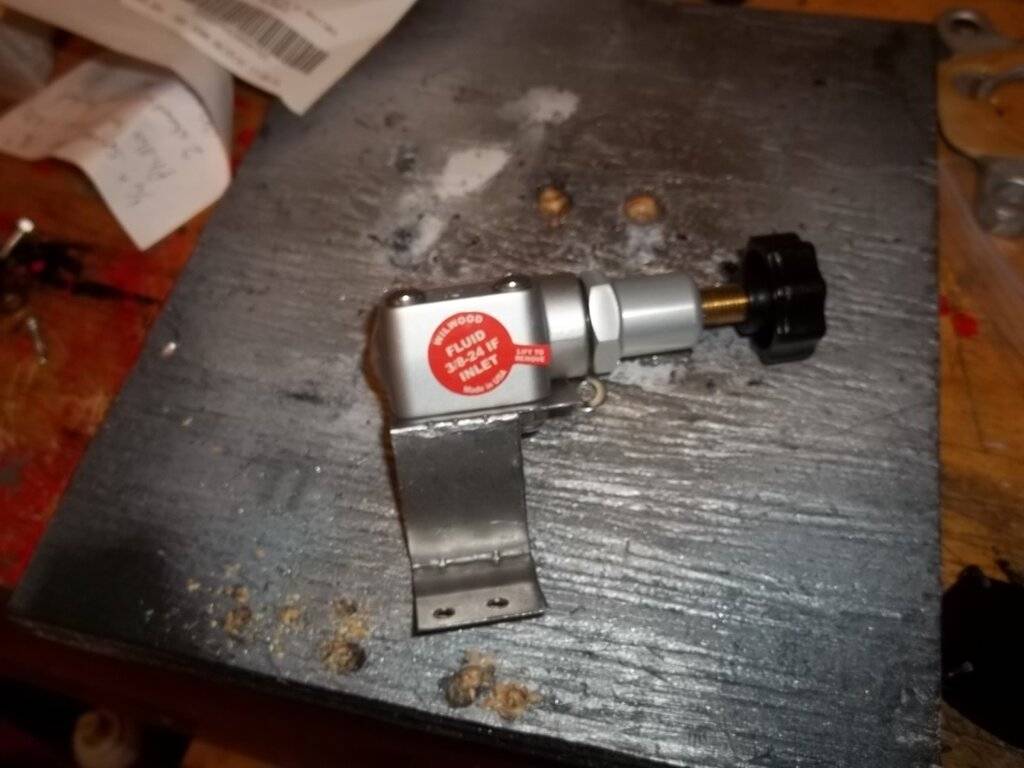

Bracket for the proportioning valve mocked up
Miz Ruby was a bit Ms. Rue today, she beat me up pretty good.

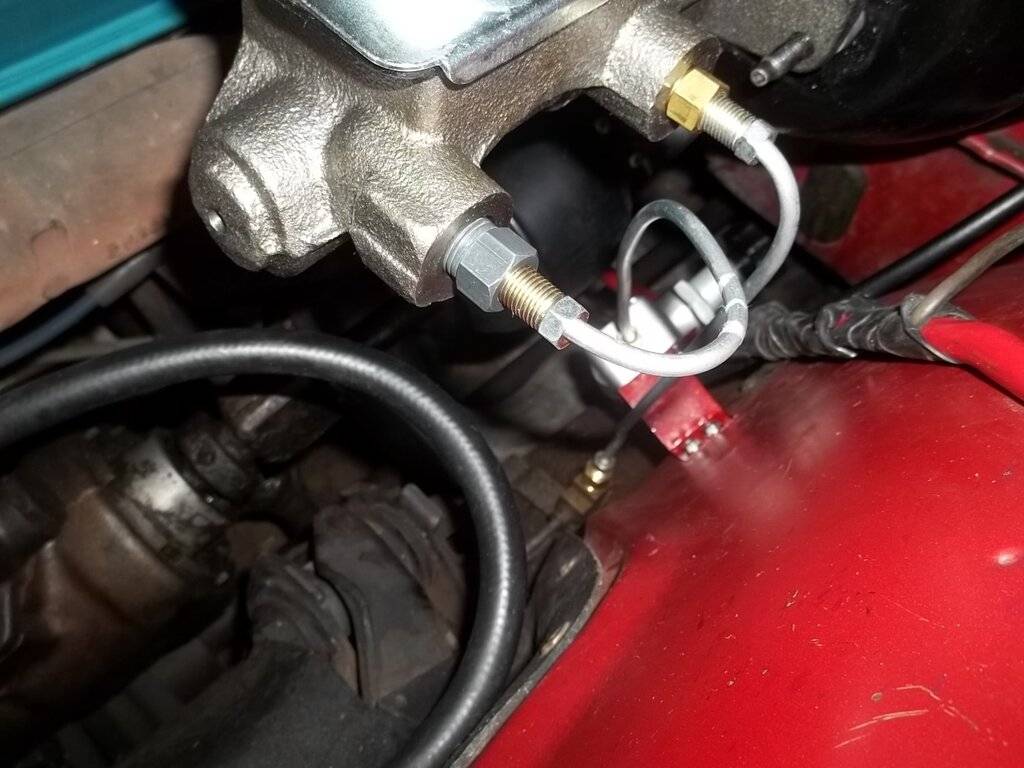

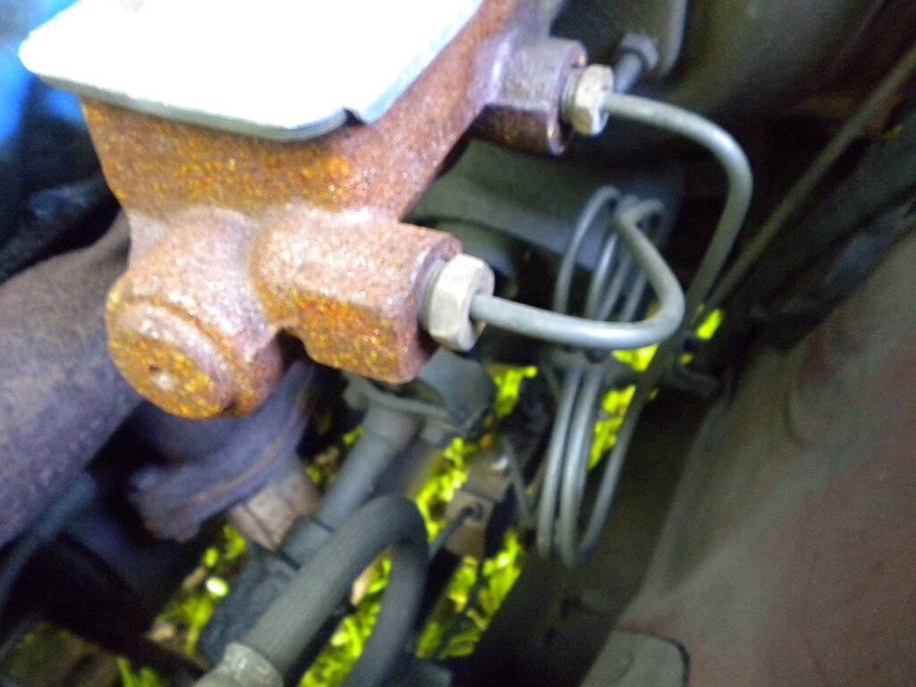

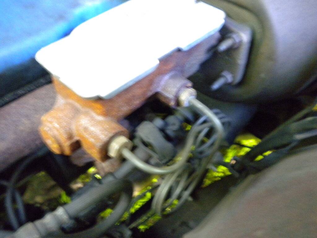

Brake lines are finished and the master cylinder has been bench bled.
I'm waiting for the help to come by and get this the rest of the system bled.
I sure hope the Chinesium casting isn't porous.
Booster...

Bit of a novice here. What is the proportioning valve for? I have a block on my car where the lines run into before going to the wheel cylinders.
You need to have a proportioning valve to get the correct pressure to the front and rear wheels. Our '66 cars had a simple distribution block since all wheels are in the same circuit.
It could be argued, for the sake of simplicity, that the proportioning valve is unnecessary. One such thread covers this... A Poor Man's Master Cylinder Upgrade.
However, because of the single distribution block flaw of locking all 4 brakes equally and the possibility of the vehicle "swapping ends" on certain surfaces when that happens, I installed the valve to cut some of the pressure off.
The valve will probably work better as the braking system itself is upgraded. Future plans include 11x2.5 rear brakes, asbestos (fronts first) shoes all around, and perhaps converting to front disc brakes from a '73 and up C body. The car goes just fine....well it could be just a bit quicker...but the brakes left much to be desired.
The single pot master cylinder is a death trap.
I believe the brake project is finished...but not without it's pitfalls.
Last week I was ready to sell the *****. Miz Ruby/Rue caused me to lose my cool.
The original rear brake line had a bit of a weep where it screwed into the prop valve. I couldn't make it stop. I lost sleep...but cooler heads prevailed and convinced me to try a couple of things.
This included slightly re bending the line, applying a couple of drops of thread sealant to the tube nut threads, and tightening the nut with a crows foot line wrench, to get just a wee bit more torque.
It seems to have worked. The line is dry and the master cylinder hasn't lost fluid.
How does the car stop? Amazing! At low speeds it is quick and even... without adjusting the proportioning valve I haven't locked the rears. It just stops...like right now! It instills confidence even as the skeptic in me wonders what might go wrong.
For now, it will /can be driven again. I do want to r&r the front brake hoses. They are dry and a bit stiff.

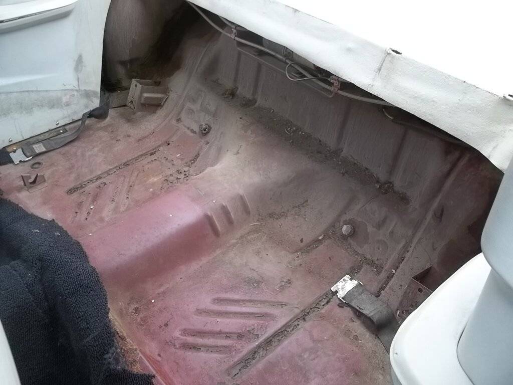

So today I ripped out the back seat. Obviously it needs a good scrubbing.

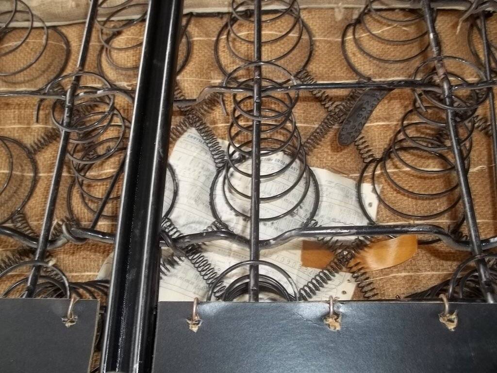

When I pulled out the back seat and set it on my sawhorses I got a surprise!
Unfortunately it doesn't appear to be Mz. Ruby's. Last 4#s of her vin are 3858 and the sheet is for 0685. It is for a convertible though...
This where the work begins...
After searching through build codes on the broadcast sheet, it appears that this particular seat back came from a car with a factory rear speaker.
Another non original part...and another mystery.

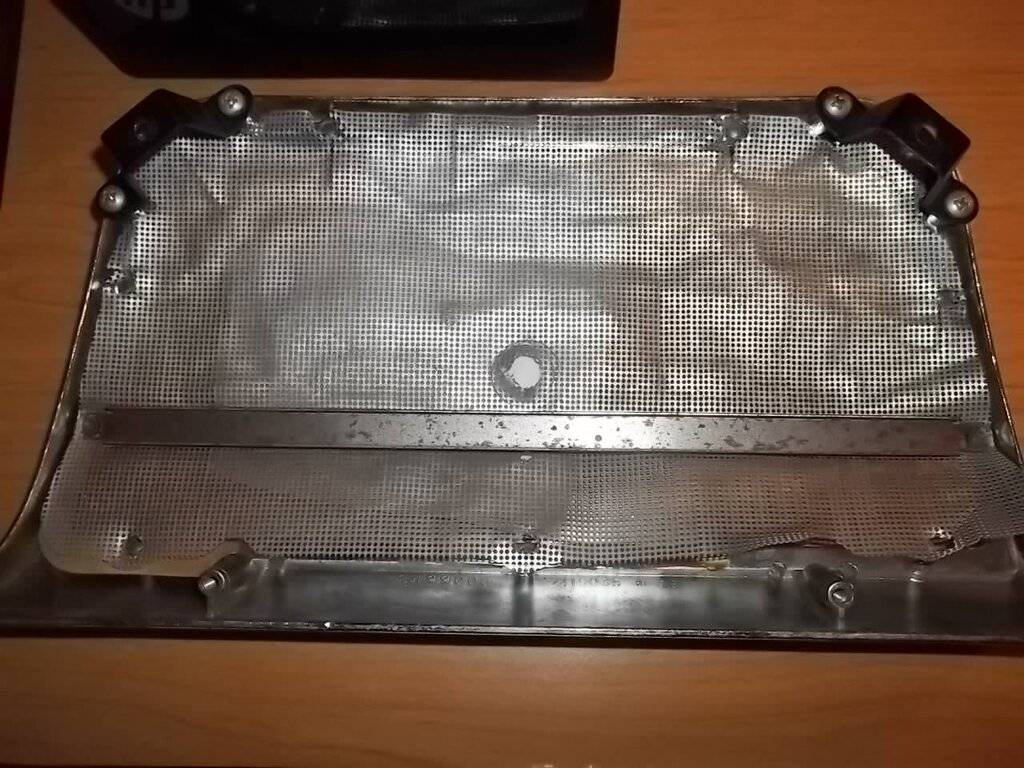

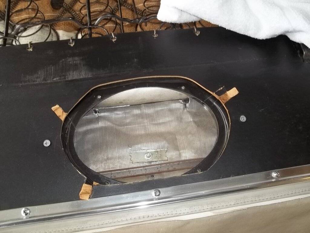

Anyway, I need to repair the grille, and as it was spot welded to the trim, I'm not sure how to fix it. I have a piece of material that can be cut to size, but not sure how to mount it.
Think I'll start a discussion in the restoration thread.

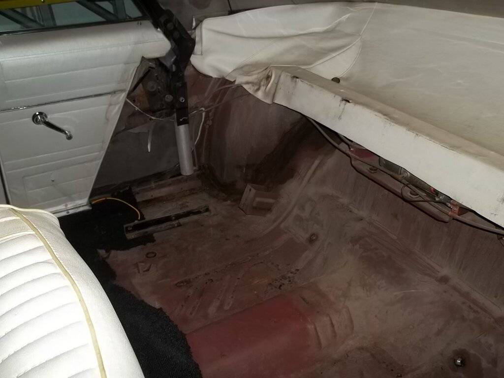

After dealing with a harsh February winter, it was wonderful to get Ruby home and start on the rear seat/top project.
All I got done was a morning drive and the side panels removed but now I can observe the cylinders while I work the top.
Doesn't appear to be any fluid in the lines and that's never a good thing.
You’re lucky to have the paper board backing for the seat/speaker
Mine were gone and I didn’t realize that it was paperboard until I saw this photo you posted here
Can you send me the dimensions and a full photo of it?
I can then make one
TIA
