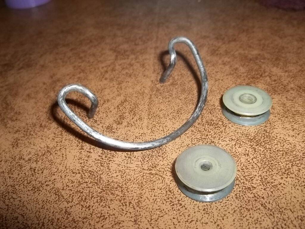

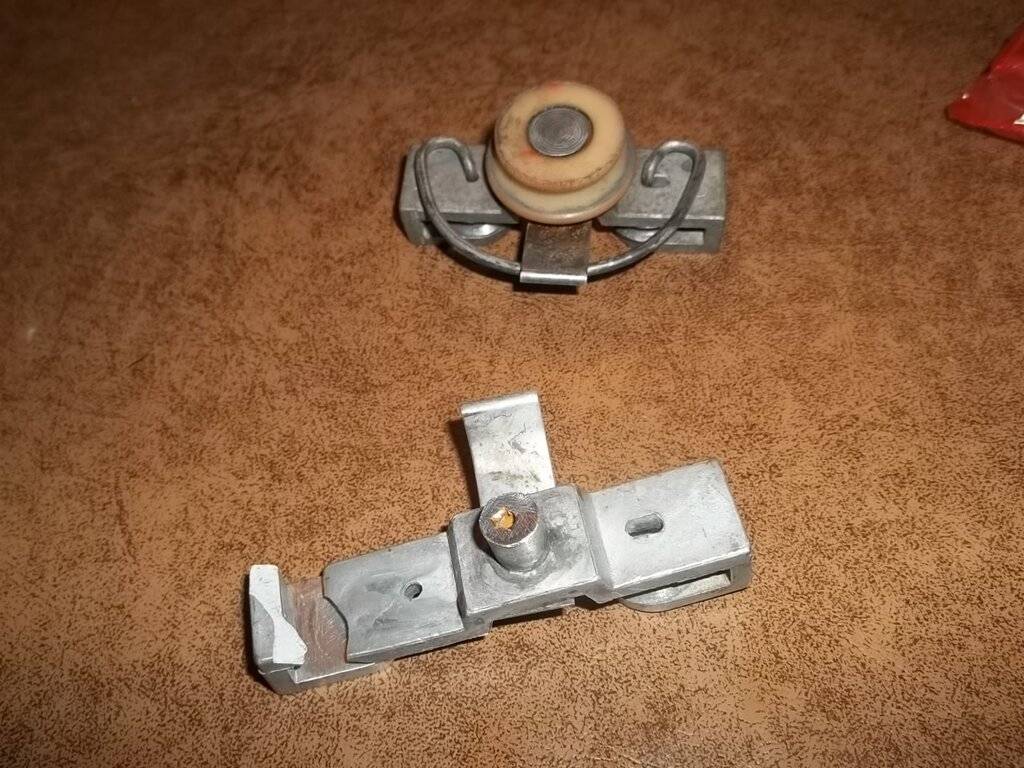

Mrfixit's excellent directions allowed me to carefully disassemble the first pair of rollers.
Casting is filed and polished, rollers cleaned and the spring re-bent so it won't cock the rollers when installed.
I need to unfreeze the main roller. I'm going to try something non invasive 1st before I grind and drill off the roller axle.

A little...er a LOT of K&W, and gently tapping ot the back of the axle produced the needed results.
The main roller is loose!
After coating every surface and the axle with dry graphite the unit was assembled and tested It works great, but the window frame track needs to be dressed and flattened so the roller has more traction.

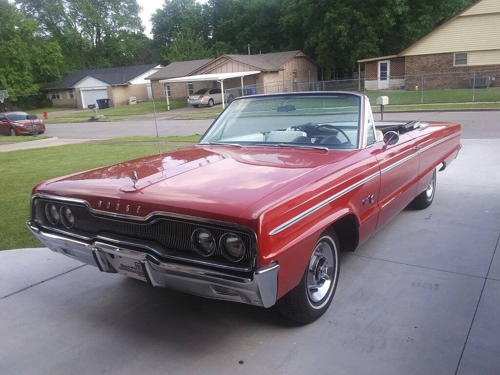

Brought Ms. Ruby home today and took a photo. Drove her around town and took the dog for a ride.

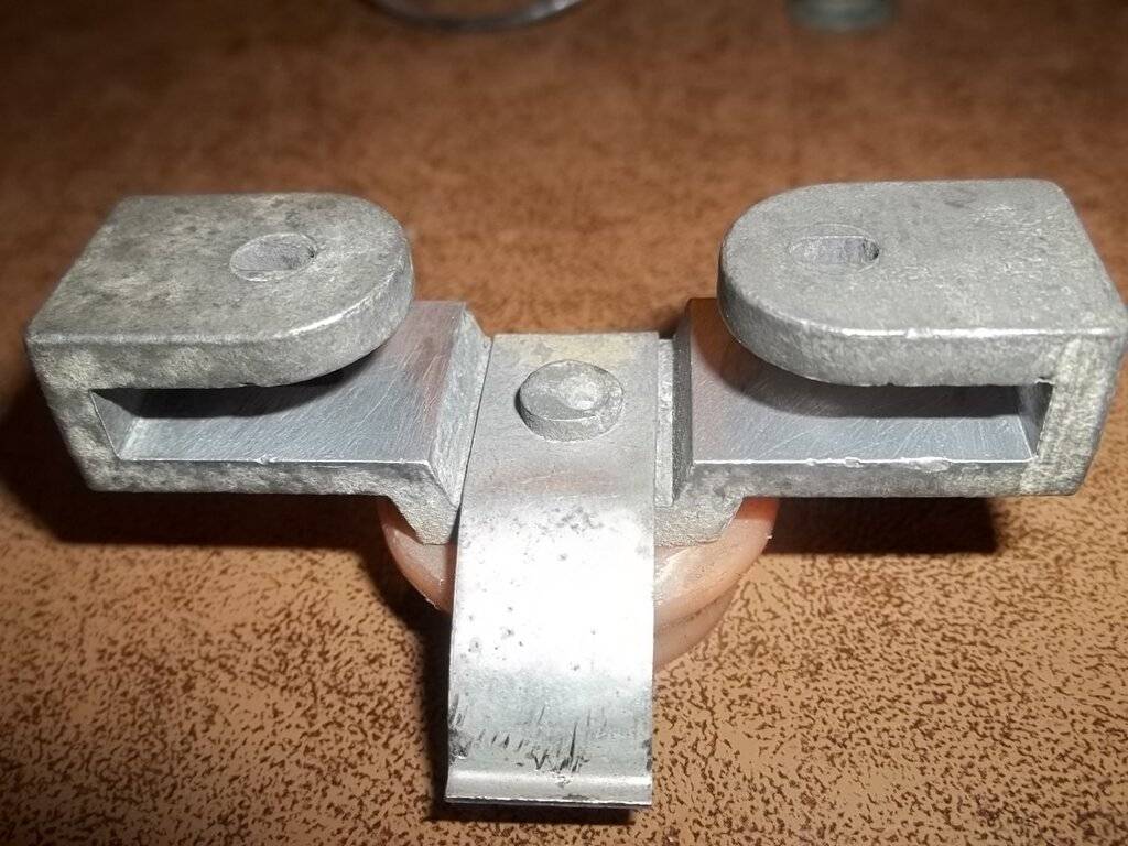

The good, the bad and the ugly! The repaired roller assembly and the mess.
The repaired roller has been tested on the front rail and the glass frame until it worked. I needed to file and sand the rails in the window frame until the main roller. The sides of the frame grabbed the main roller and the round edge in the track didn't provide a lot of grip surface. So I flattened the edge and sanded down the sides and removed burrs from the roller.
Again, following Mr. Fixit's advice (which I should've done at first) I drilled out the rivet end of the pin holding the broken extrusion and filed off the head. Popped right out and I didn't break the glass! The pilot hole is deep enough for a rivet, but I'll probably use a machine screw and a drop of loctite instead.

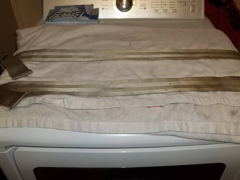

@David Grippin sold me a set of seat belts with the correct buckles. Finally, I have a matched set.
3 soakings and scrubbings later. Just have to dye these bad boys black.

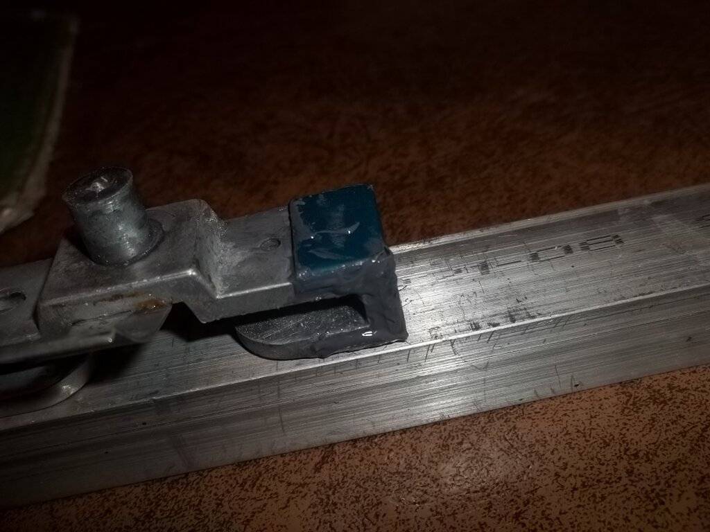

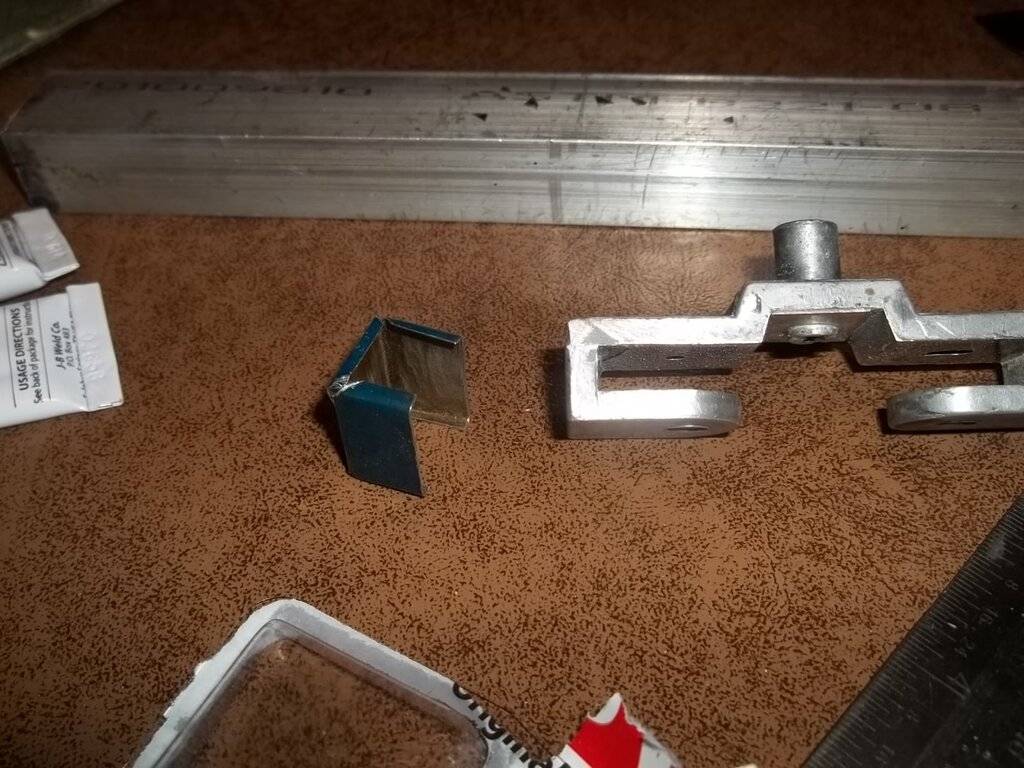

So after attaching the broken pieces of extrusion back together with JB Weld, I built a "cap" if you will, out of a piece of sheet brass and used JB Weld to glue it to the extrusion
A quick check shows there's no interference with the window frame, so it should function just fine.

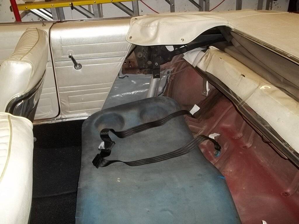

The interior panels were scrubbed, given a couple of coats of Herb's spray dye, and put reinstalled over some fresh moisture barriers made from a piece of discarded drop cloth, if cloth could be used for that term. New seatbelts were also installed.
The corner panels were also re-dyed, but I ran out before completing both. Herb's interior spray is good stuff.
I wasted too much spray on the back seat panel. It would have taken way too much to cover up the fiber board.
So I ended up stripping off most of the dye and priming the panel with several light coats of white primer. Then I'll wet sand that after letting it dry most of the week, and shoot the dye on. Should be fine.

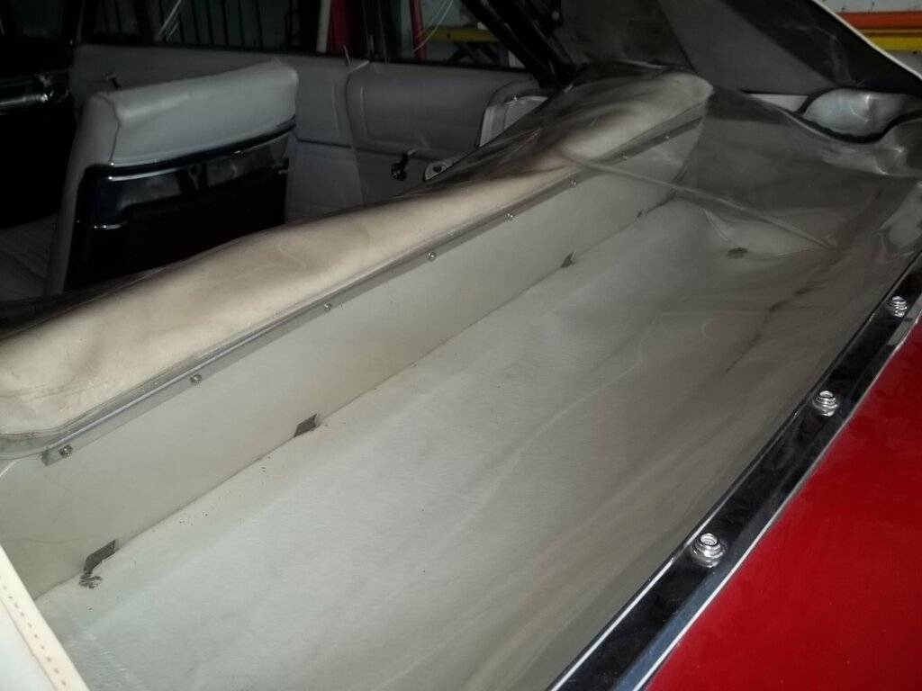

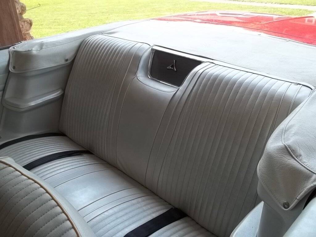

It only took me about 6 months but the rear seat is back in!
To think... this started as just a speaker grille replacement. Simple enough, right?
For those who may be curious how the rear seat panel turned out.
