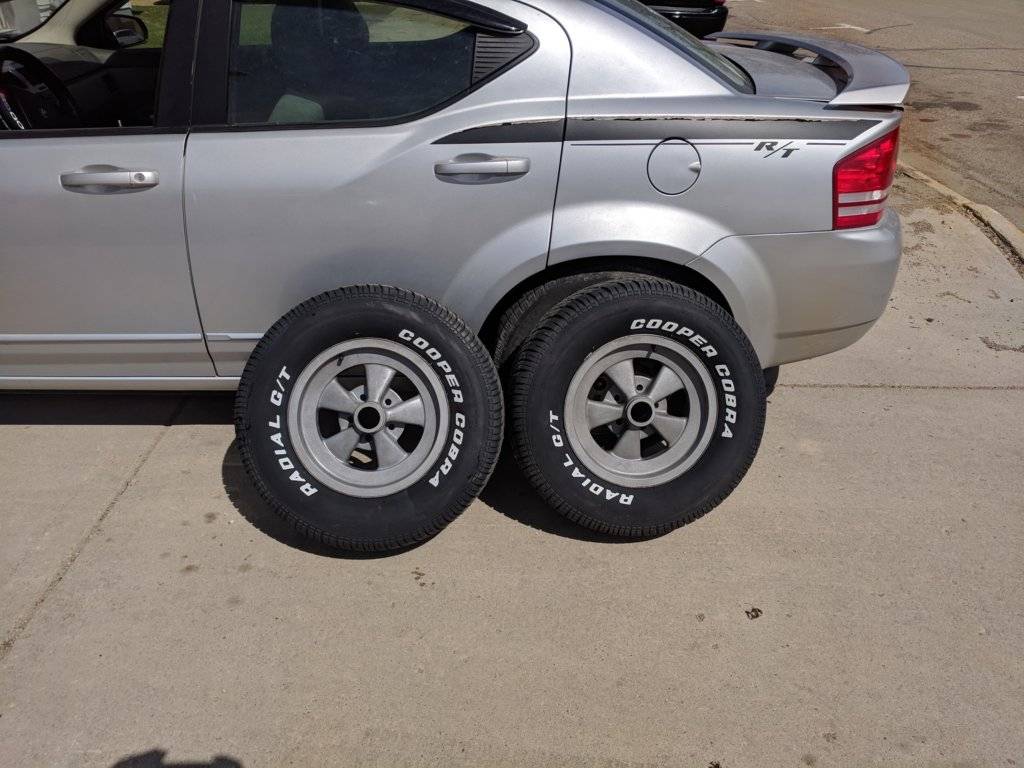

I can measure the rims on the grey car to verify my tire choice on the black car, and have the wheels ready to go on the car.

New shoes! 28" tire is pretty tall, but I'll have the rake I want.

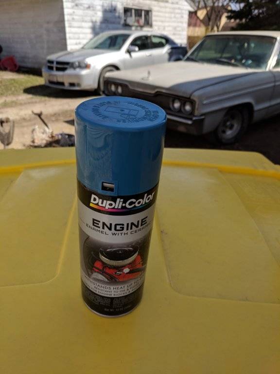

I also grabbed some paint for the heads and dampener, hope it matches closely.
It did say Chrysler on the label, sorry, no pic for now. I guess I could go to Napa, but wait, they have the same brand. Poo.

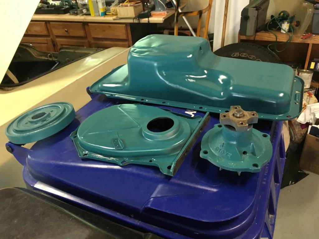

For 1966, you want Turquoise, NOT Corporate Blue. That color wasn't even around until 1969 on engines, and was across the board in th 1972MY. Just sayin'...
It's not as blue as it looks photographed by a digital phone in natural light. It's not the closest there is but it is close.
I did my sheet metal and intake with that. "Good enough for the gals I go out with" as they say.
I looked at it again after I posted that pic, definitely not the same color in person, close to the color the PO painted the engine.
I'm pretty sure my rattle can said Chrysler turquoise...or Chrysler green? I'll get a look at it tonight when I get home and confirm but I'm pretty certain the number was DE1619.
It was a nice match to where I cleaned the guck off the rest of the motor and CERTAINLY better than the Ford Blue that was used by the PO.

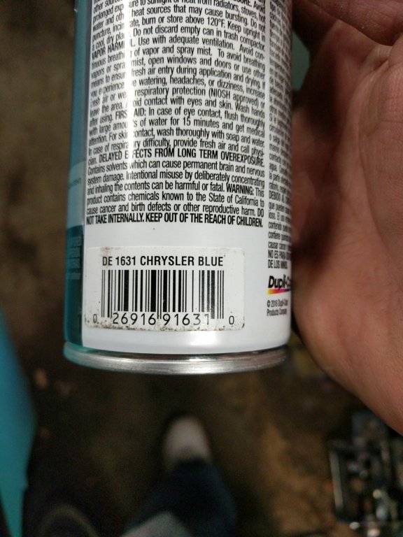

I got DE 1631 Chrysler Blue
I'll have to look at the engine and see if I need a different color. Shouldn't be hard to figure out. I looked at Dupli•Color's website and the difference is noteable between 1619 and 1631. I'm thinking I grabbed the right can, maybe? At the time it looked right.
They're definitely different ... unfortunately, I have no Idea what I have. The site lists 1619 as "Chrysler Green" and it looks to be the right color but they only have it as high temp paint which I know I didn't use...
Once again. . . Just go order the correct paint from Bill Hirsch:
AEROSOL ENGINE ENAMEL-hirschauto.com

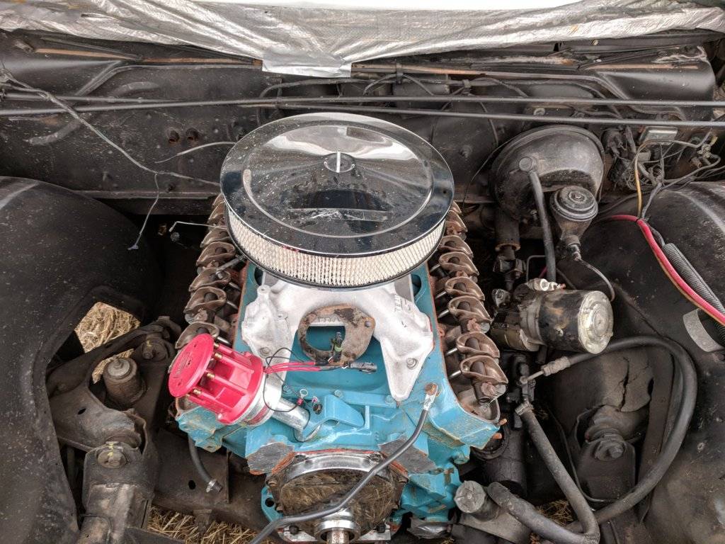

I'm trying to match paint on the engine. I'm not pulling it out to give it a shot of color, just the heads and dampener.
If the paint on the engine is original, the Bill Hirsch paint will be the closest match.
I doubt it, it's been rebuilt and the color looks more blue (the cap looks like the color on the block) than the turquoise. I'm pretty certain if I saw a can of 1619 it wouldn't match.
But thanks for the lead on the Hirsch paint.

Just so you know, the Duplicolor I used was indeed 1619 Chrysler Green. Not that you care as you're just trying to match what's there, but I thought I'd let you know!
