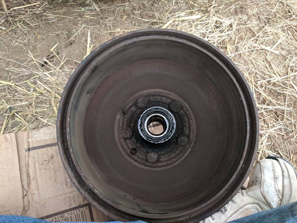

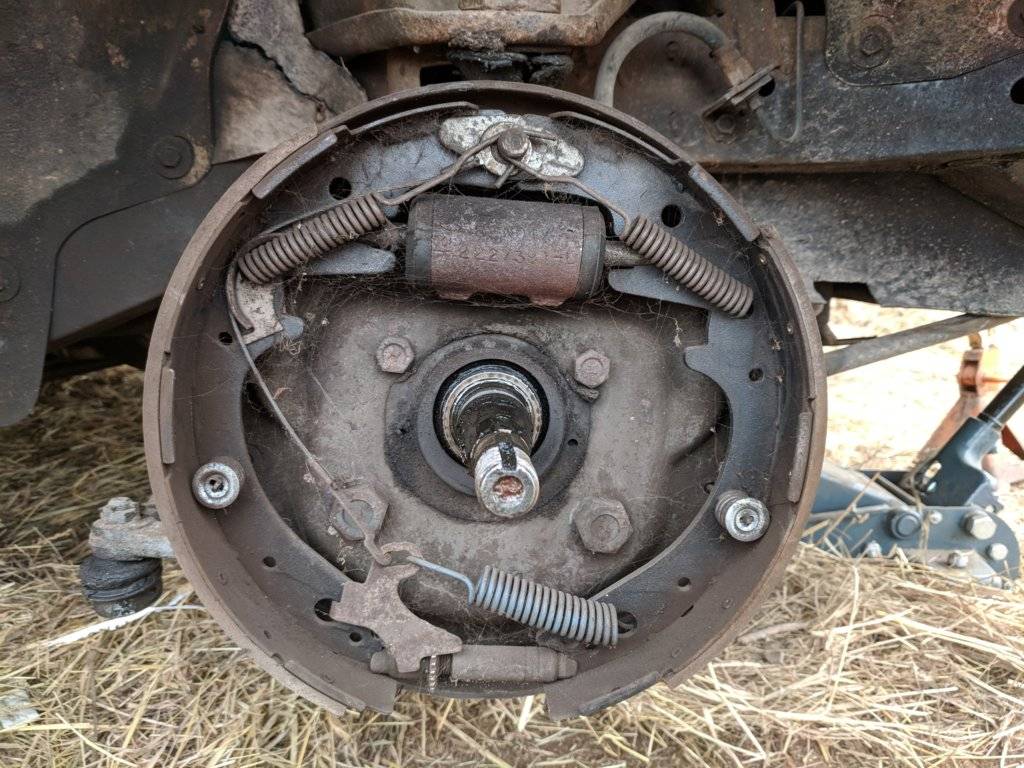

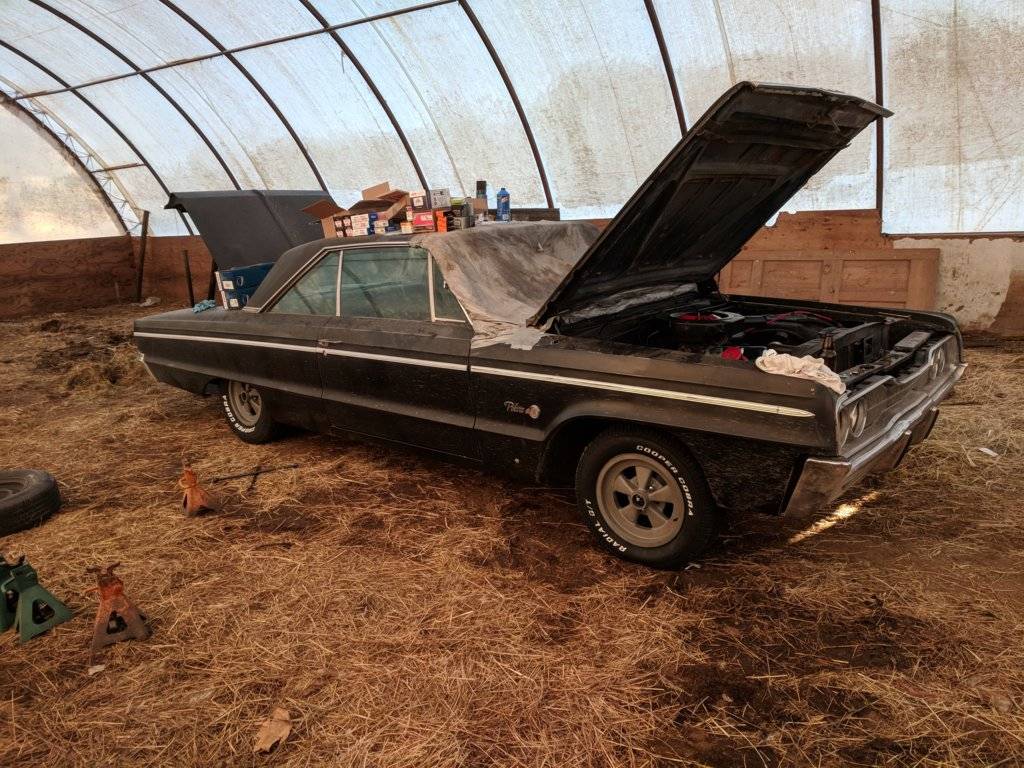

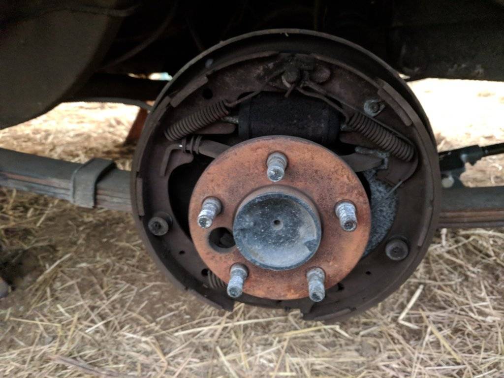

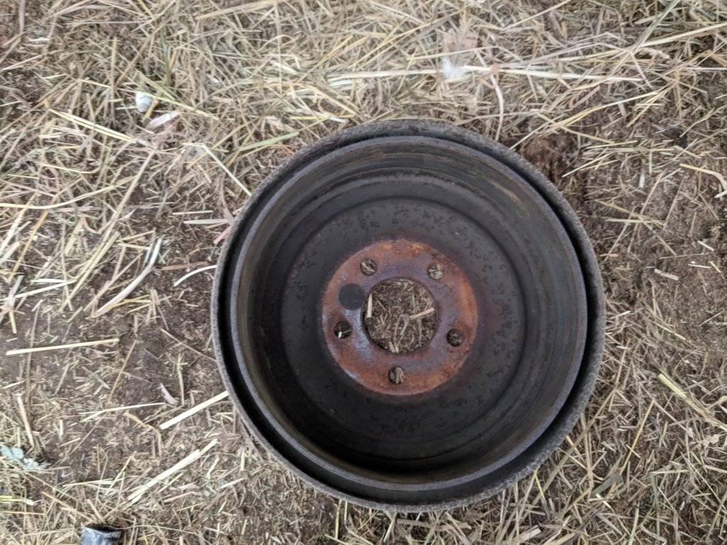

Got to 3 of 4 wheels, yeah half assed, but I don't have the correct amount of lug nuts so I did t bother with one wheel. I'll deal with it later. Anywho, the brakes look to have been replaced sometime and not used much, if at all. They were adjusted nicely and looked good with clean parts.
I think I'll wait til I get it home, hopefully next week, to swap the master cylinder as the brakes seem solid. Exhaust is ordered and should be here in five days. Heads will be swapped by then. I might get a new gas tank as the current one looks a little funky. I'll take a better look tomorrow.

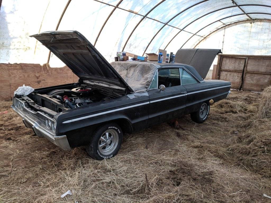

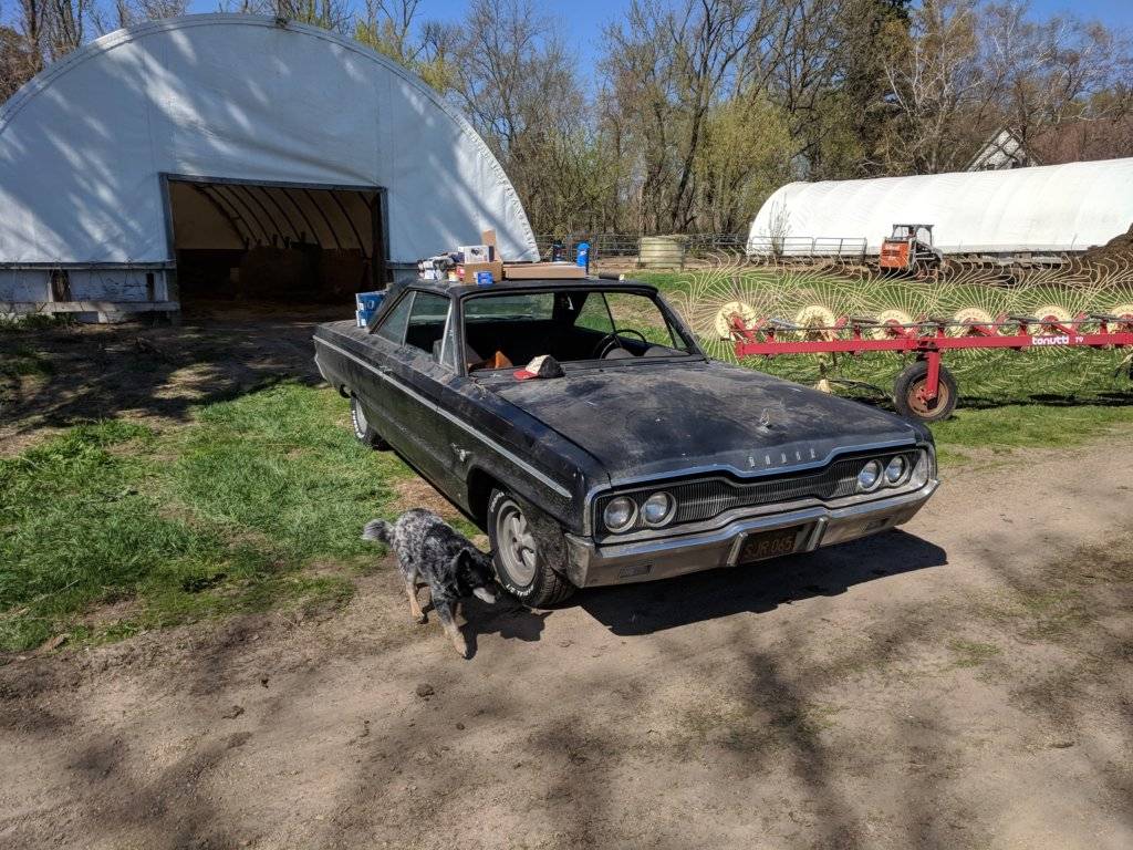

It's at the stepson's place, he's got 10 acres and a couple buildings. I thought it was going to be worse, the straw has kinda sucked, but it was used for animals before he bought the place. I had to push the car out of it's hole so I could jack up the rear. The ground isn't even and it was quite fun, I worked rather quickly and got the back end down right away.

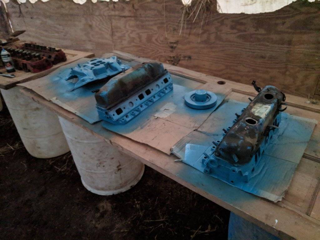

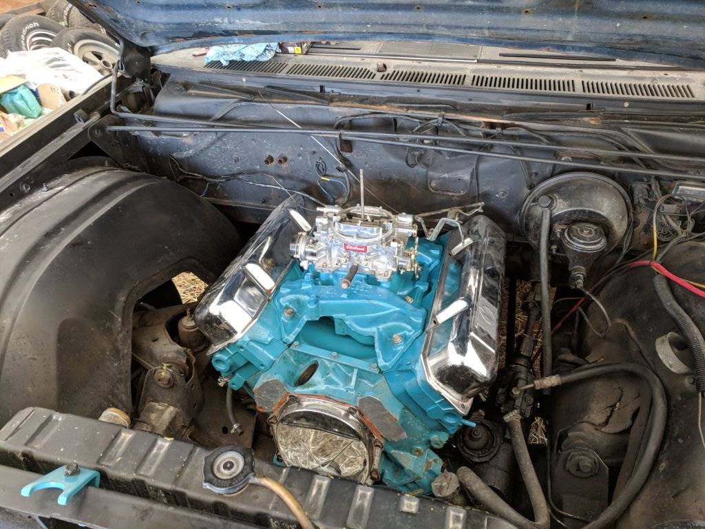

Got a little painting done today. Sanded and scrubbed the heads, intake and balancer just as it was getting dark. I put on a coat, and then Jared, my stepson, took over and gave them a couple more coats. Probably going to have to touch them up tomorrow, but they are blue now instead of orange.
We pushed the car outside to pull the straw out of th way and give us a cleaner dirt surface. This space is becoming Jared's shop. He helped out a lot in the tedious sanding and said he enjoyed it. It was nice to work with him and have him helping out, definitely not used to having help, and it was awesome.

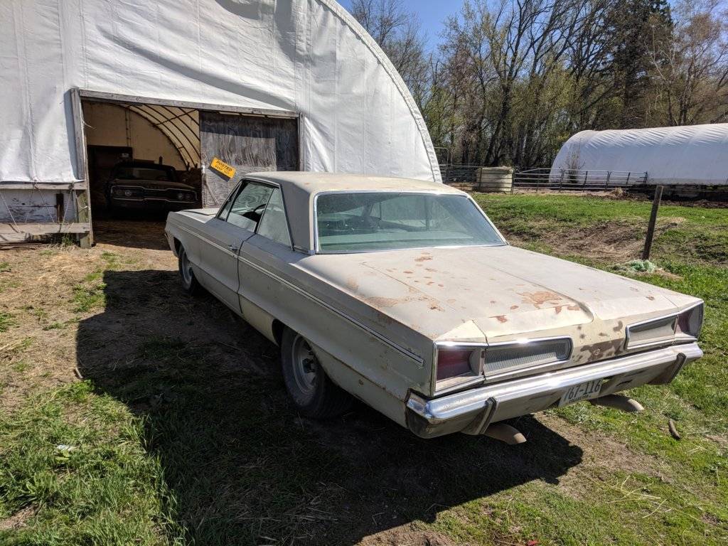

The Gray car met the Black car. They Gray car met it's new shop and soon to be it's new home. The garage is off to the right, but it's tight, only good for parking.

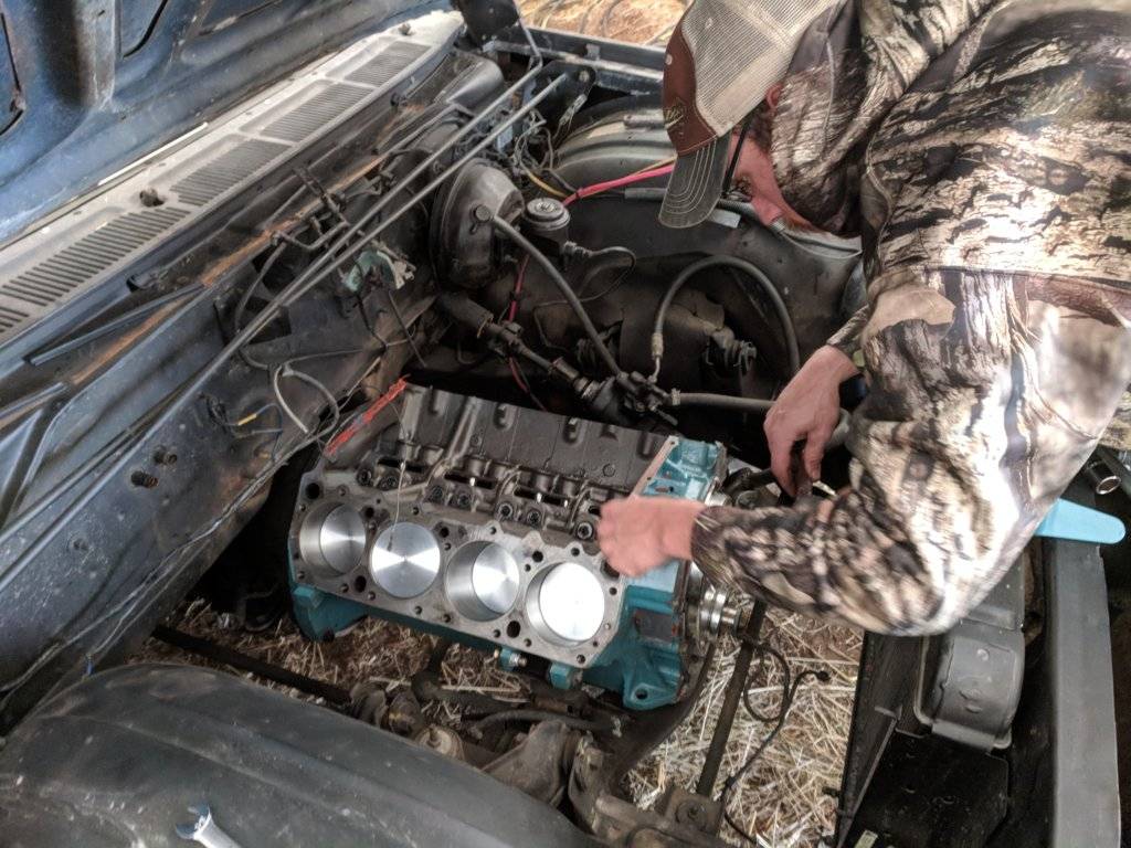

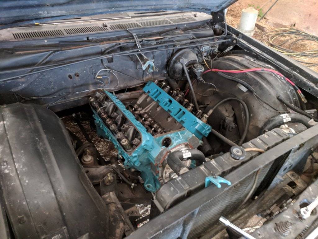

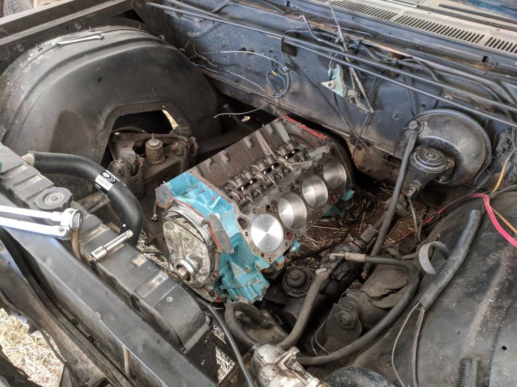

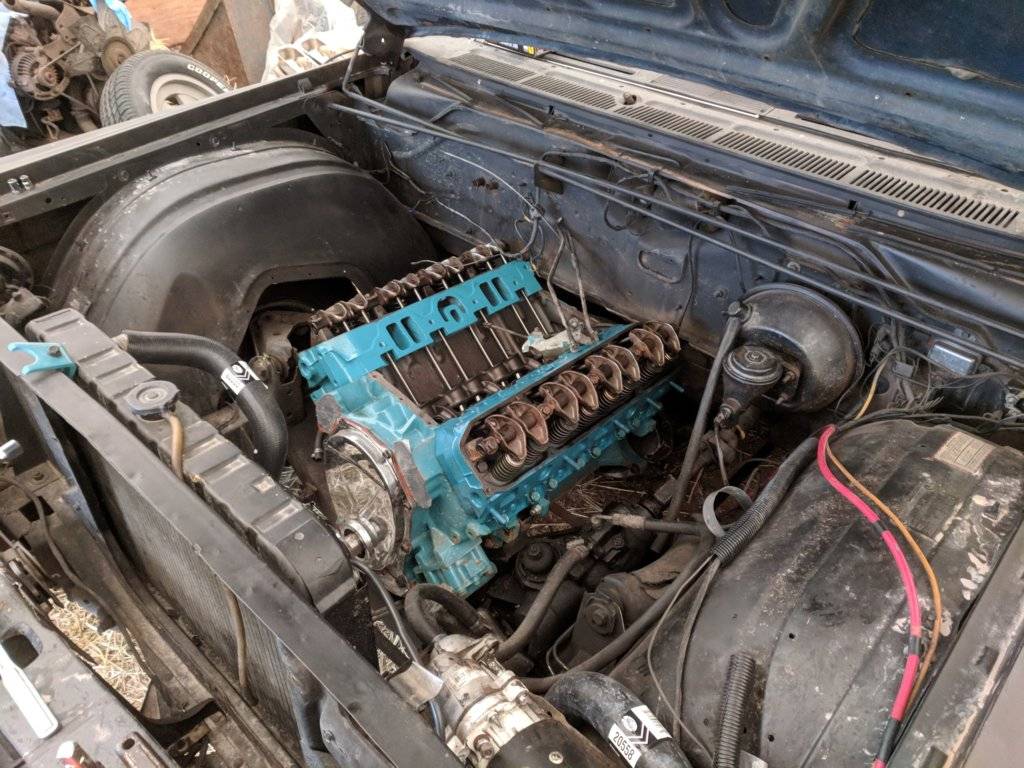

Top end swap is done, delayed due to wrong paint color. :BangHead: Didn't check.the color.before laying down the color. Whoops. :BangHead::BangHead::BangHead: Got the De1619 ordered last night and got it this morning. I wasn't able to even get to the car til 1:45 this afternoon, I got to do other things. :wtf: Dropped off the paint and Jared sprayed the parts again. I got there and started taking the intake and heads off. We tore it down and cleaned it up and then I was ony own. I installed the heads and intake, with the help of my phones flashlight. Ill come back in the morning and insta the fuel pump, water pump and thermostat. I still have to clean and paint the brackets for the P/S pump and alternator, but I have couple days to get that done. Clean and paint the pulleys, convert to electronic ignition and put in all the missing bolts. We will see how close to the 14th I get to staring the car. Getting there.

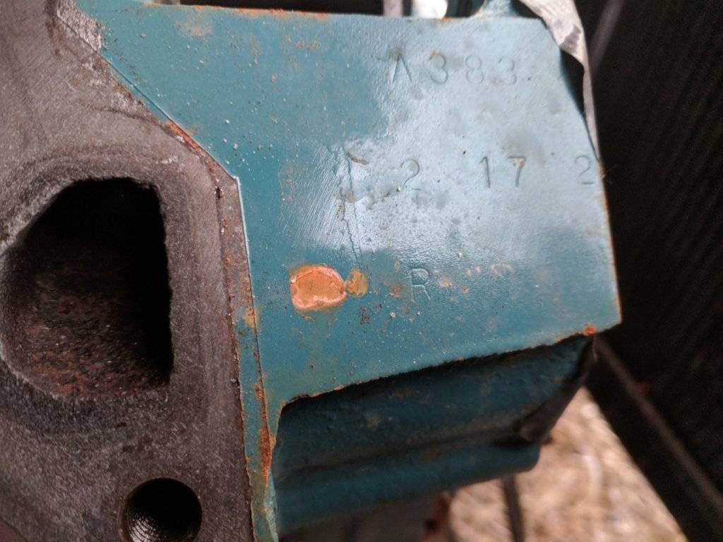

Engine ID pad.
Back to basics. They just slapped a set of heads in this rebuilt bottom end, so I don't feel bad doing the same thing. I know more about the heads I put on than the ones I took off. 1% more comfort.
Heads on.
Rockers and pushrods installed.
Intake insalled.
Looking like an engine.

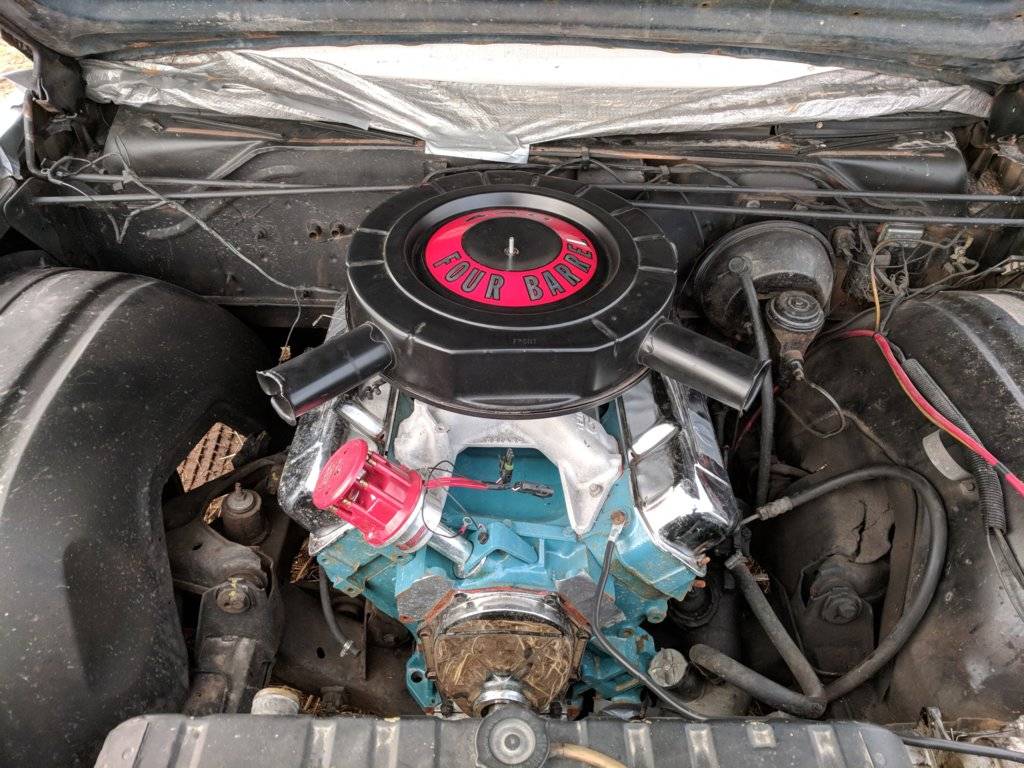

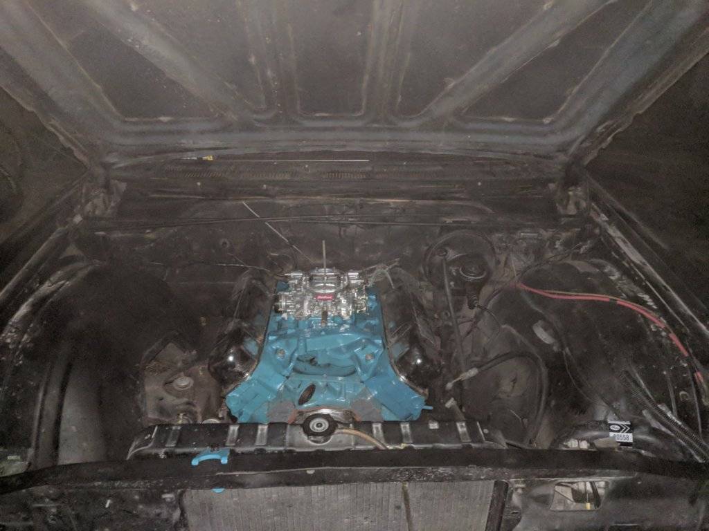

It's not going to make any vroom vroom noises with the starter sitting on the battery tray:poke:
Always gonna have critics. :stop: :rofl: I was going to put it in but I'll do so when I put the G/T rim on. But thanks for noticing. :thumbsup:

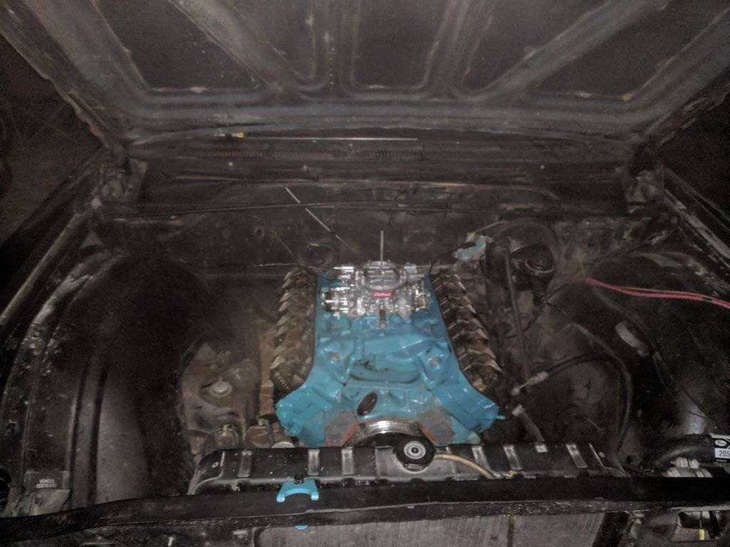

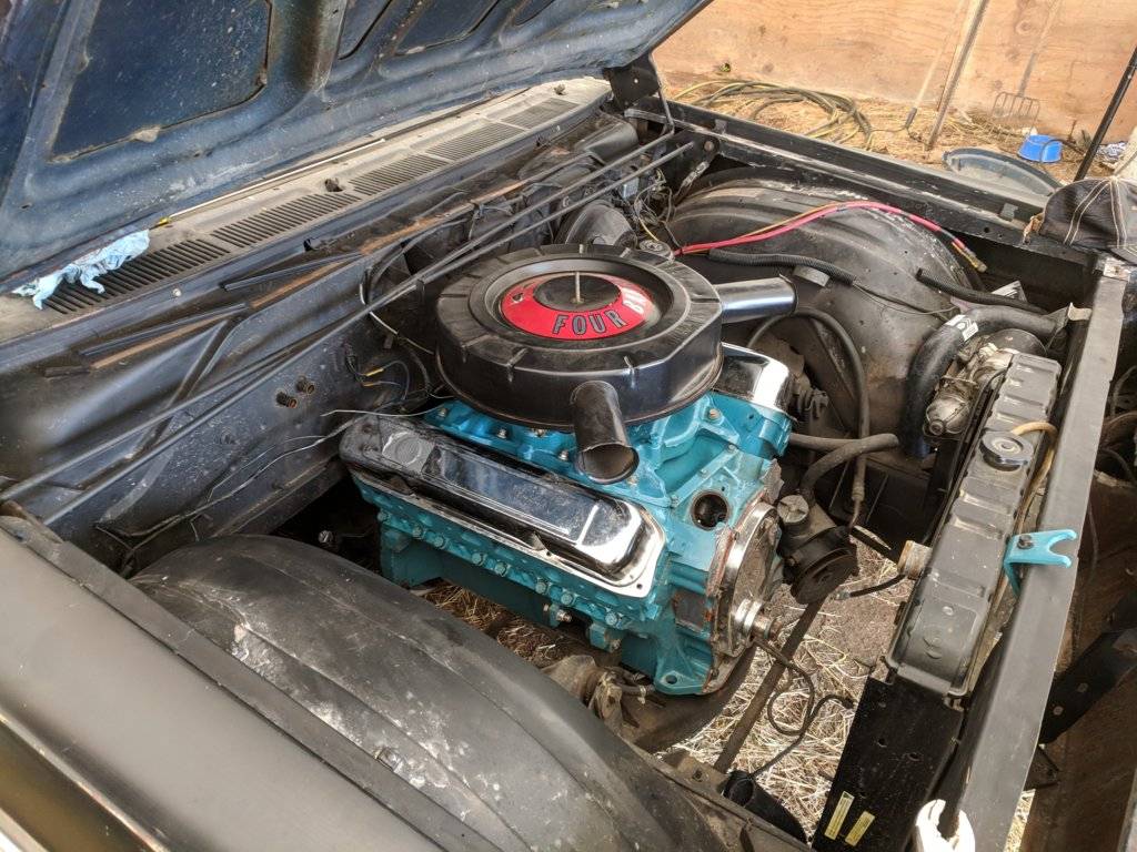

Looks a little clearer in the daylight.

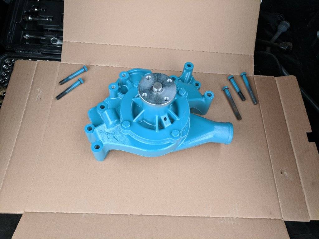

Not a perfect match. I don't know about the block, but the heads were orange under the green paint, and we used the blue as a base, could explain the difference. This place has obviously rubbed off on me, as I painted the aluminum water pump and housing. What has become of me?
I'll get valve covers off the parts car and clean them up, paint them and install them, probably in a week or two, the chrome ones will have to do. Exhaust still on track for install this weekend. Clean and paint pulleys, and finish painting brackets. Still need to hook up a battery and check all electrical goodies.
