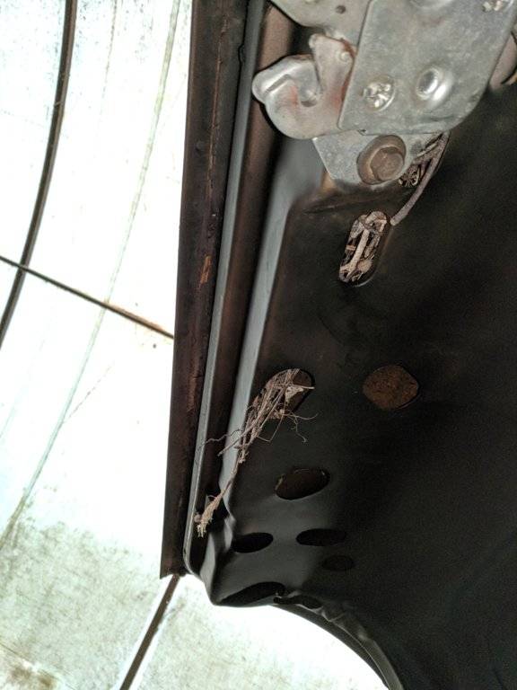

Had to have been hard to swallow .. ha .. hhaha ahhahh ahhhhh ..Another fun bit from yesterday, I found the swallows we're building a nest in the trunk! Little buggers. Right behind the trunk latch mechanism.
I took it out Monday, but forgot to close the trunk, so I got to do it again today. I wouldn't have even known had it not been for a bird flying away when I went to grab a toolfrom the trunk. Looked around and found the nest.I thought they were just flying through the trunk and dropping twigs. Makes more sense they'd drop crap while building something. Shows you where my mind was. An unusual distraction.
