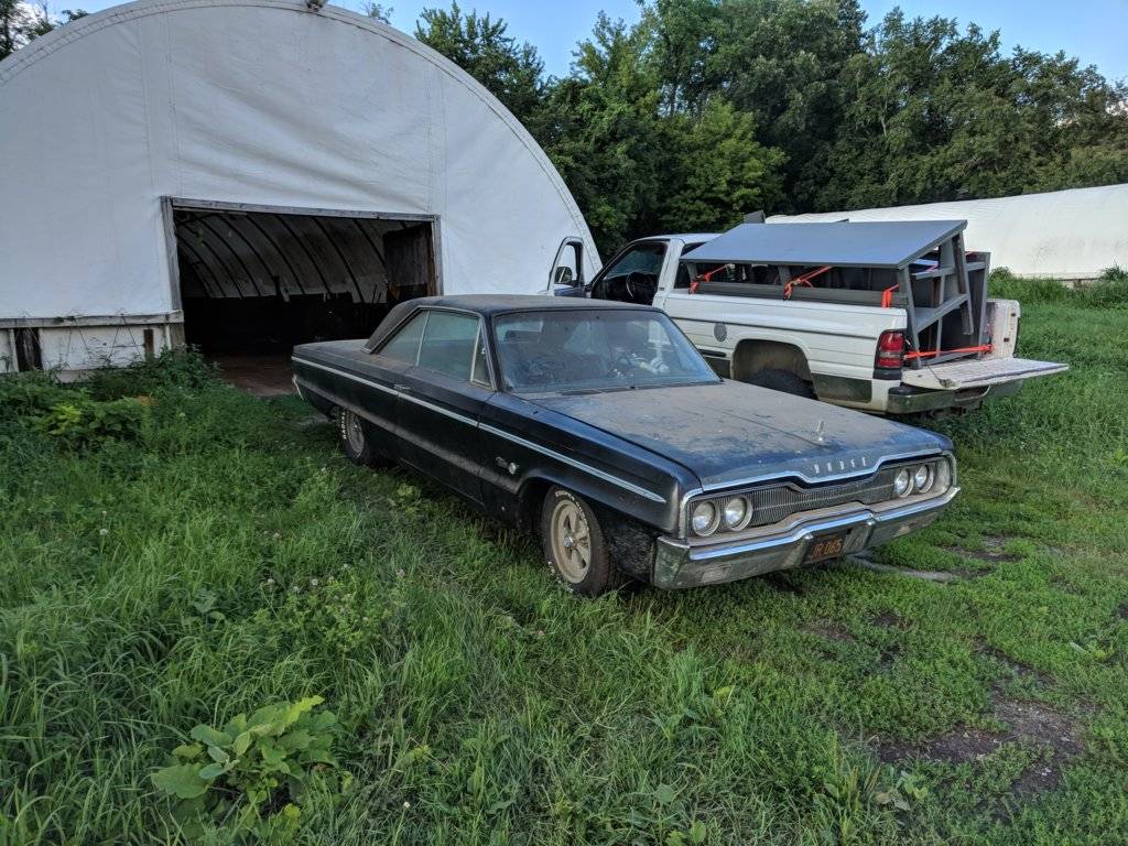

She moves!
She made the whole 40-50', whatever, out the door. I'm gonna in to let it cool down, then drive it the 5 miles home. Got all my tools loaded, leaving that sweet truck behind.
I got it to idle around 750, has nice throttle response, sounds nice. The brakes are touchy! Gonna have to back them off a bit as they grab right away, and I mean yesterday! No proper taillights, so my turn signals work as hazards, as I jumped the brake switch to have something. Good enough for the small town, alright!
I just hopped around like a high school cheerleader! I'm a happy camper!
Made it home fine, the temp.gauge was pegged, but the car ran fine. It fires right up, pulls nice. The trans slips. Could be fluid level, as I filled it with what I had. Right now don't care, it's home. I'll let it cool down and see if the thermostat opens, which I doubt it will do. Cheap part, easy repacement, and l'll swap radiators anyway.

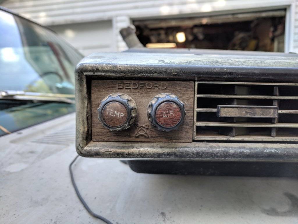

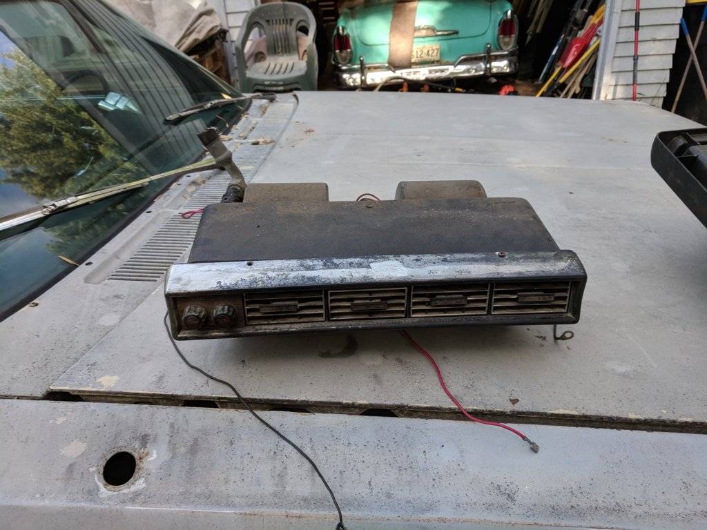

Here's that sweet A/C unit, real bummer I couldn't use it. :bs_flag:
A Bedford unit. Haven't googled it yet, don't know if I will. (I will!)

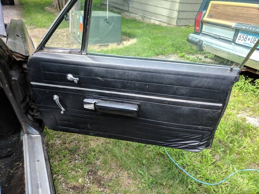

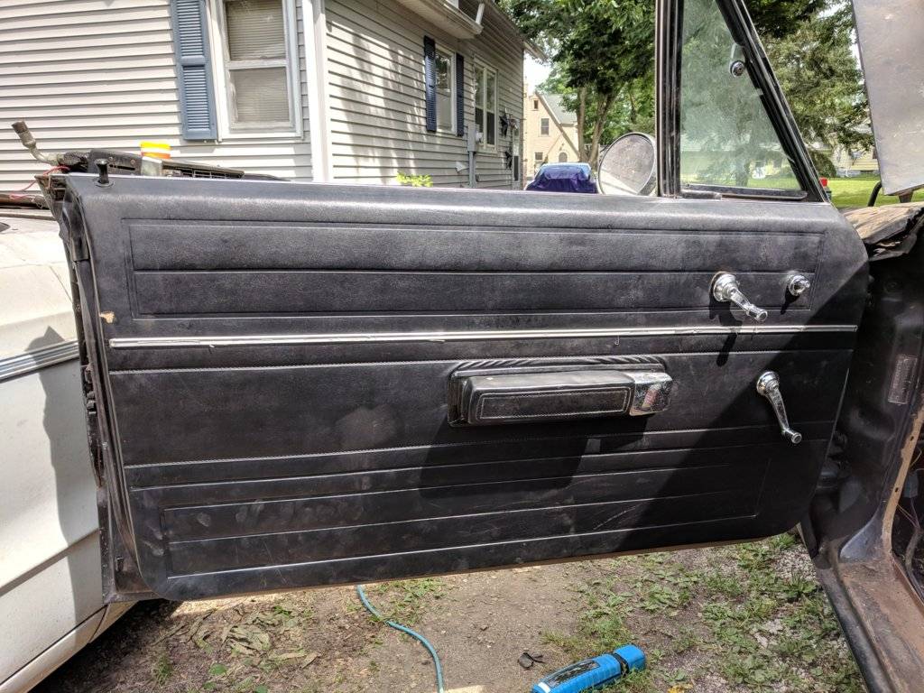

Swapped door panels for ones without speakers cutouts.
Not perfect, but no holes either.
