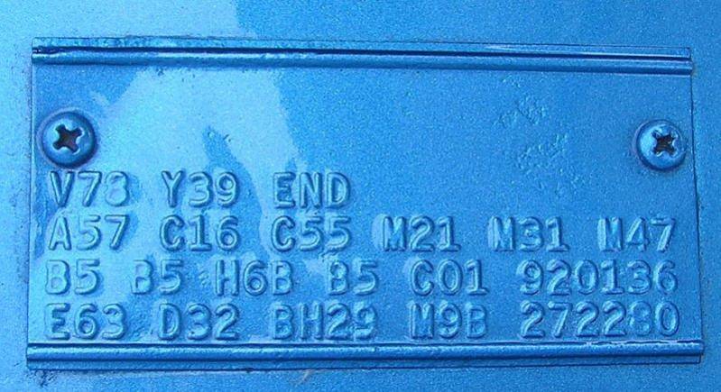

920 VONs on Barracudas. 900 VONs on Darts.
Now that's what I'm talking about. That's a start :D
Now let's talk about torque boxes and the good stuff.
