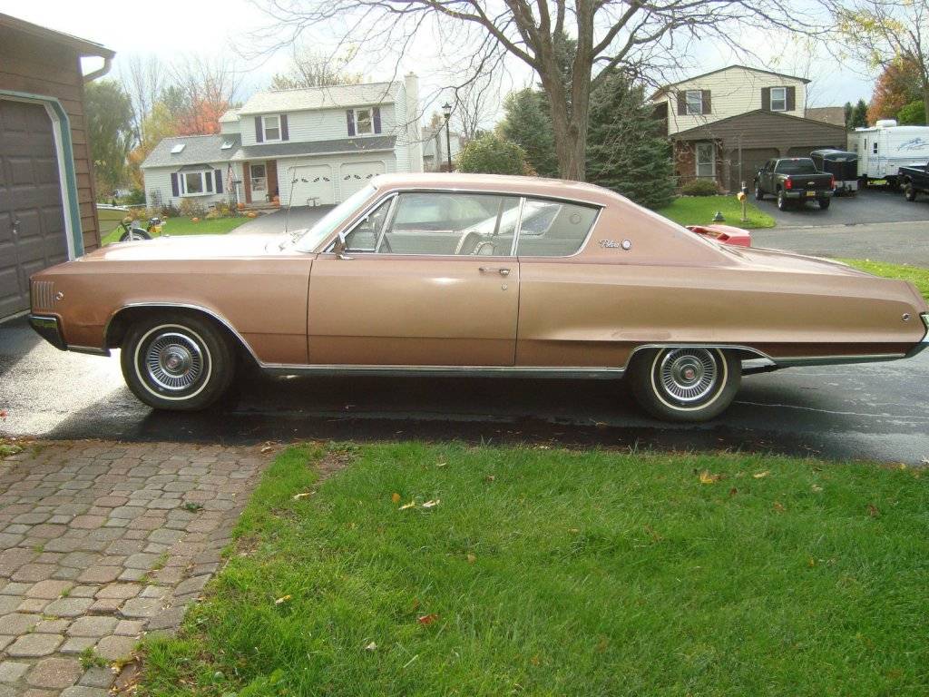

1967 Monaco 500 with what engine?
Were side marker lights an option in '67? Does the car have shoulder belts?
Looks like something leaking under the rad?
No shoulder belts. The side marker lights are a mystery. I was hoping that someone on this thread would know if they were offered in 1967 model year Monacos.
Side marker lights became manditory in '68, and I think detachable shoulder belts also. Sales litterature indicates that the belts were an option in '67 so the lights could have been also. The front disk brakes were I think manditory (at least in Canada?) on 440 cars.
The 15" wheels and larger tires were probably standard (not optional) because of the extra weight of the A/C and maybe the 440 is heavier than the 383? (bigger rad also?)
15" wheels and tires were part of the front power disc brake option. Had to have the 15" wheels to clear the brake calipers. Only one wheel cover for 15" wheels.
The normal 8.55x14 tires had plenty of weight capacity to handle a 440, as that's what the New Yorkers had as standard equipment in 1966 and later. A 440 is not much heavier than a 383, anyway.

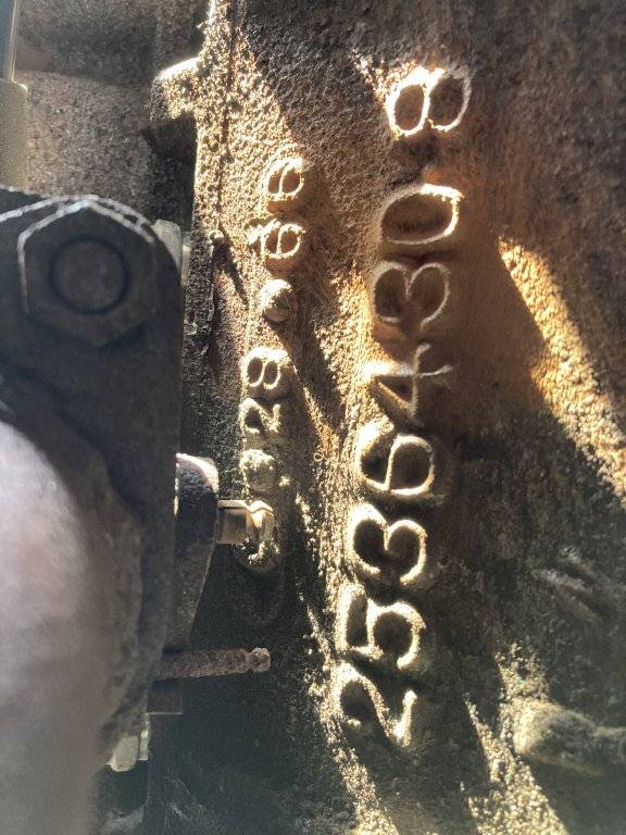

In November I purchased a 1967 Dodge Marco 500 at the Palm Springs auction. This car has appeared on this forum in the past. It is the one that came out of the Vanderblink auction in SD in July 2020.

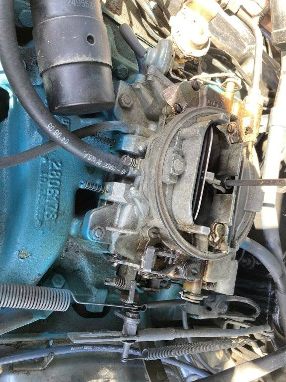

I am trying to figure out what engine is in my car. This is my first 60s MoPar. As a result, I am not familiar with Chrysler product engines of the era. My car was advertised as having a 440. I took that at face value, which was probably foolish.
Looking at the VIN, I now know that I have a true Monaco 500, but it was delivered with an “L” code engine. My research suggests that that is a 383 with a two barrel. The engine currently under the hood is a big block with a four barrel.
One can see a code on the intake manifold in the below photos. Also shown is the code on the engine block itself. If I’m reading it correctly, the engine was manufactured in the 28rd week of 1966. That suggests to me that this is not the original engine to the car.
Is my my car running a 440 taken from a 1966 Chrysler product?

Welcome to the L code club!!
You sir, have a very rare beast!

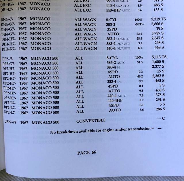

VIN starting with DP states US built car (Canadian 500's start with DH).
How rare?
Just looky here... 286!!
Only 5 came with the stick!!
Side marker lamps became mandatory in 1968 in the US. I've never seen an earlier model so equipped from the factory.
It is not unreasonable that a previous owner would have had them added, and thankfully they used the correct '68 lights, positioned properly.
Having the lights made a great difference in visibility at crossroads, etc., particularly in vehicles like your Monaco, where neither the head nor the tail lamps were directly visible from a side view.
The gov't required lights in 1968, reflectors in 1969, and a combination of the two in 1970 and later.

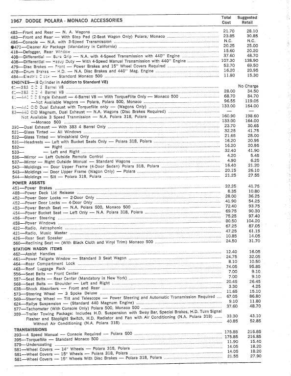

If you were wondering, the L code 440 got the chrome valve covers on top of bigger valved 915 closed combustion chamber heads, HP manifolds with dual exhaust, AFB carburetor and a factiry lumpy cam.
3.23 gears with sure grip was part of the package as well. Along for the ride is the HD 727 and HD cooling with or without AC.
Bigger front sway bar and HD torsion bars abd rear leaf springs.
Hope this helps.

Thank you. So the car was properly represented at the auction where I bought it. If I am reading the image above correctly, I see a total of 5,113 Monacos built in 1967. That is more than double the number I see from other sources. Any idea what the correct number is?
Not sure exactly what the correct number is or the source I shared combined 4dr Monaco's.
The C body records are sketchy at best.
Not like the A B or E body cars' records.
My 67 500 is believed to be 1 of 153 built at the Windsor Ontario Canada plant with the L code 440. Break it down again based on options she could possibly be 1 of 1.
Again no concrete evidence to back that up.
Nigel Mills of National Moparts has a data base which he has about 50 U.S. L code 67 Monaco 500's.
My Canadian built car he says its the only one he has seen so far.

Also worth mentioning is that it was possible to get a K code 440 (non-magnum) without requiring disc brakes and 15" tires. I have such a car. From the way I am reading the option sheets, all of the K's are automatics.
The L code 440 magnum required disc brakes, and disc brakes required 15" wheels and power brakes. A 4 speed was possible with an L, but a 3 speed manual was not.
