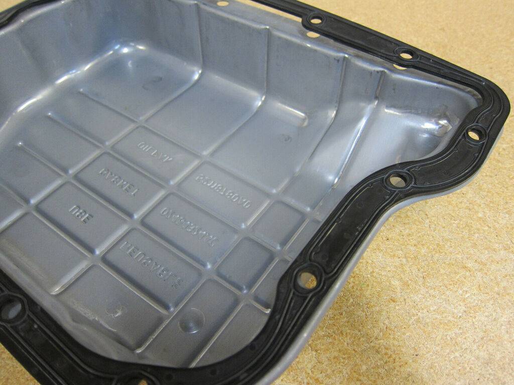

I used one on a 904 because I couldn't get the factory gasket. It's OK, but not anywhere as good as the late factory gasket in the pic. Actually no comparison. I'd use the Lubelocker again for a 904, but for a 727 I wouldn't consider it because I can get this factory piece that is soooooooo much better.
Mopar Part #2464324AC.
Hands down, the best trans gasket I've ever used. Google it and everybody and their brother sells it. And they are reusable!
That looks like the one that I advertised above. The easiest gasket I’ve ever installed hands down!
