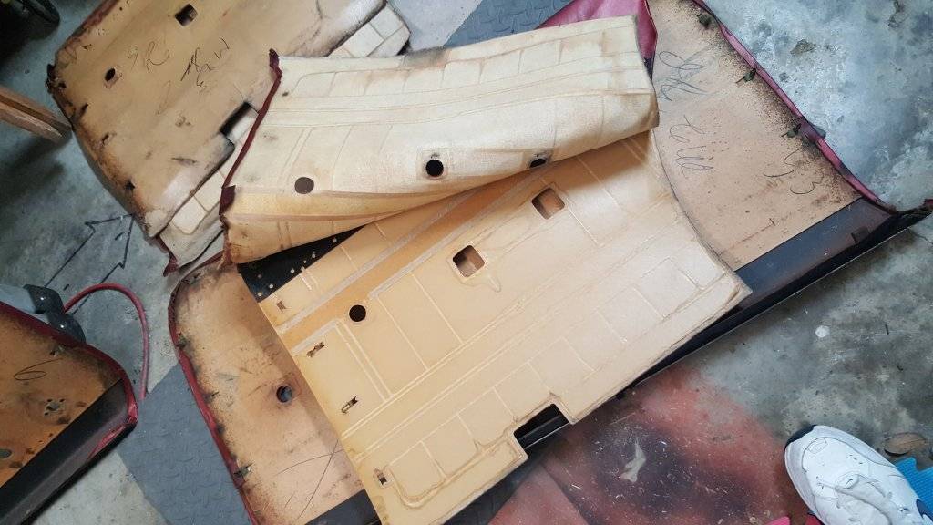

aight, welp, after pulling all 4 panels out, im pretty confident that the original panels were built using 2 different style of clips, as seen earlier. i would suspect even that the fronts and rears panels were made by 2 different suppliers.

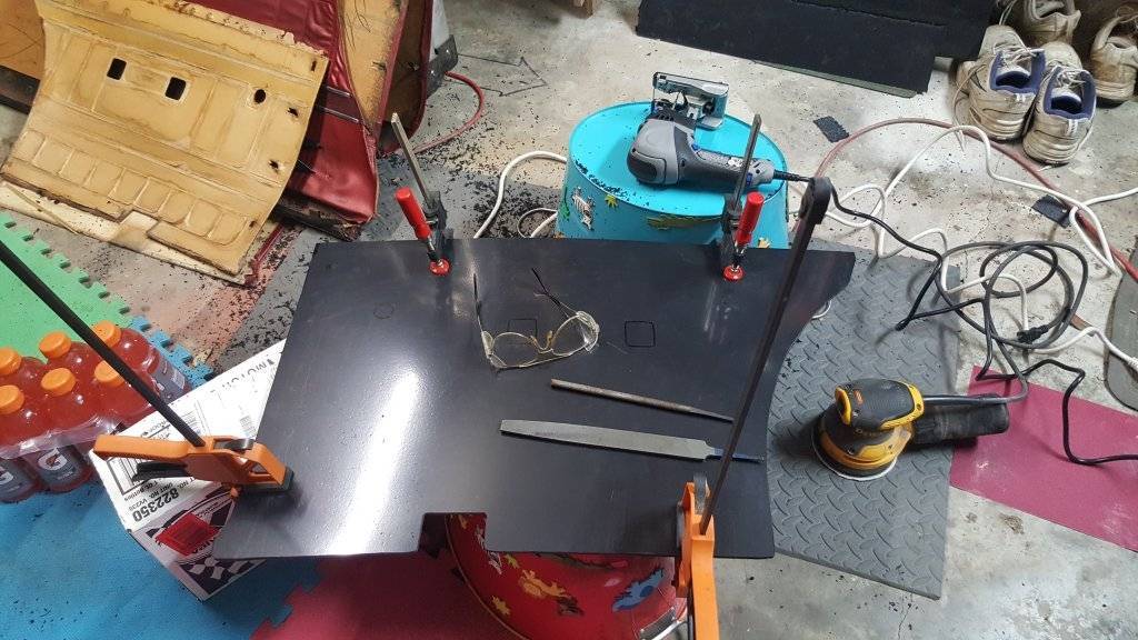

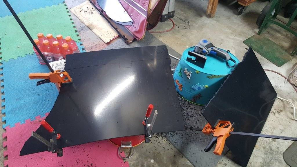

well, I got more time to hack on this. and a major change has happened. I'm going Velcro and not clips to attach the panels back into the car. welcome to the new century, mr. Plymouth.

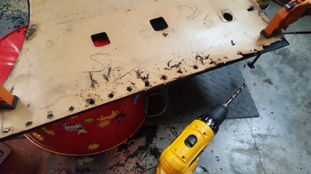

then laid the cardboard onto the ABS plastic sheet and traced the outline.
I had 2 ABS sheets together so both L and R side would be the same cut.
I tried this for the toothy peg cardboard holder things.. it didn't work out so well for me. hard to make all those line up when you are eyeballin everything.
