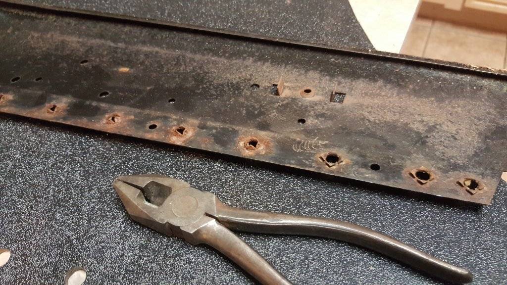

1968 - door panel trim clips sources

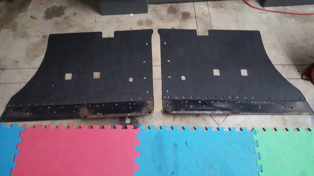

I ended up moshing them
test fitting

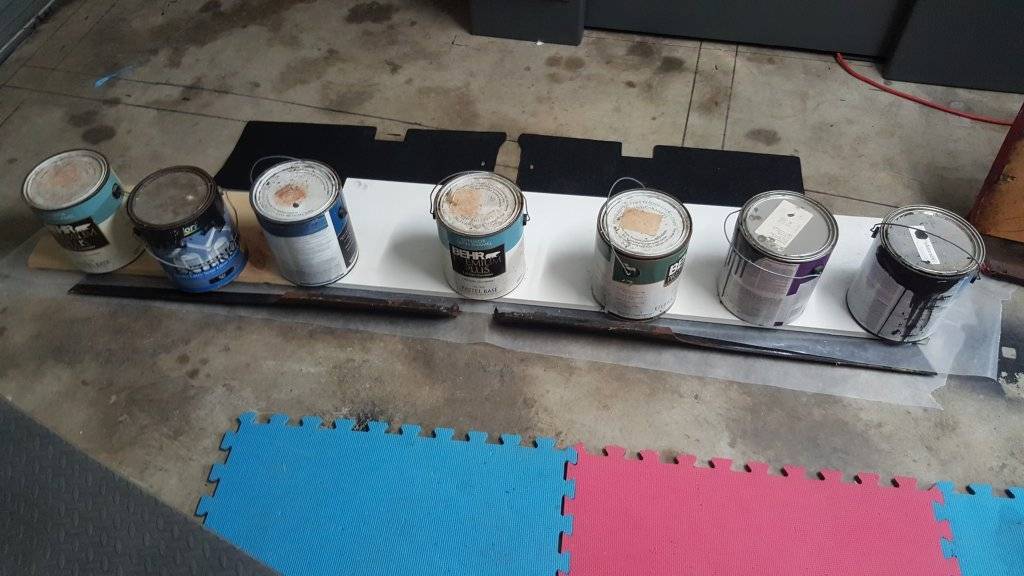

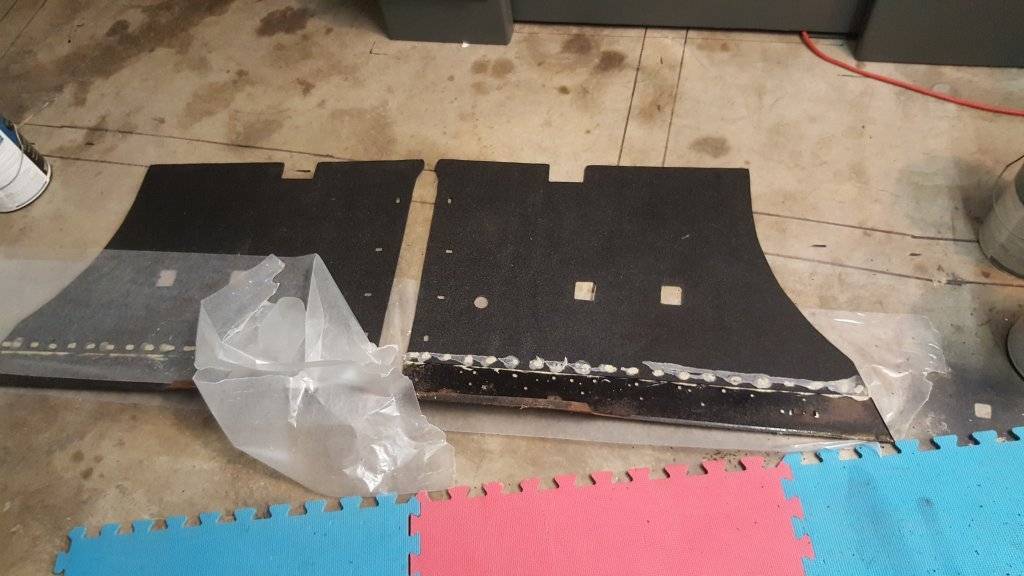

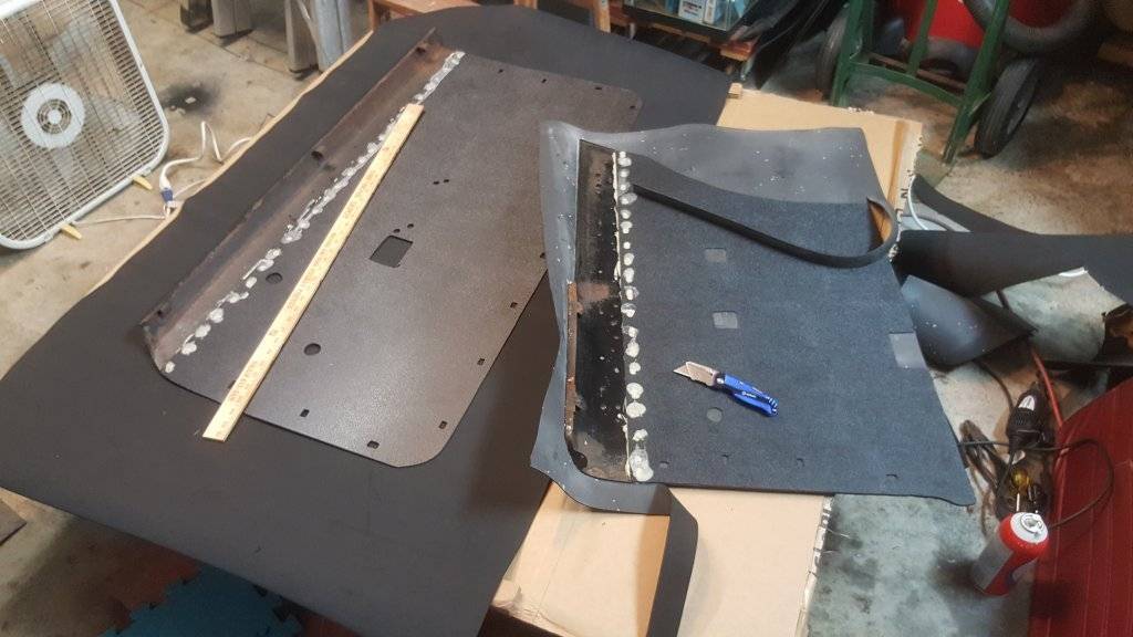

and blam! Loctite PL premium applied under pressurized conditions :)
there is wax paper on the floor, then the product, then wax paper, then board, then paint cans. I don't have pictures of the gluing process.. I'm a one man show and the **** was curing fast....

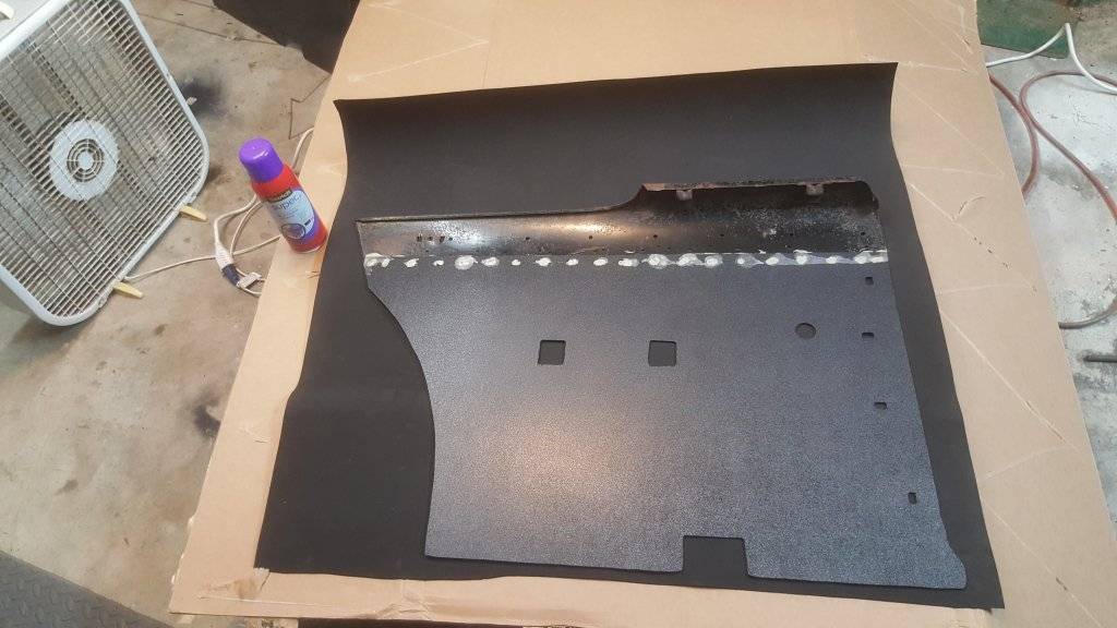

so I bought this foam... its 2mm some-kind-of-craft-foam. its not what I expected. I'm a computer guy not an upholstererer what the hell do I know. I went with it. I bought the good glue so this is gonna stick the first time, get it flat.
oh. the fan. please wear long sleeves and have a fan on hi pulling air AWAY from your work area to outside when you are spraying glue. you will thank me later just do it.

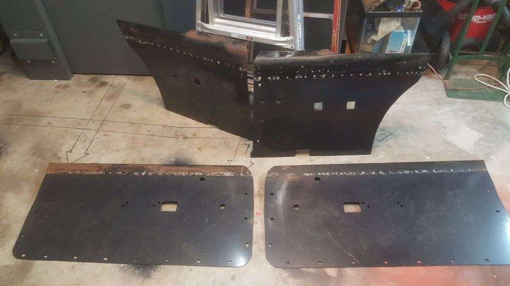

see that cut in the bottom edge of the rear quarter panel? no idea why its there. unless its for like a convertible or something. the outer vinyl was not cut like that, but the cardboard was... I didn't notice it while drawing the pattern, so it got cut out. but I didn't need to.
anyways, trimming excess foam off after gluing

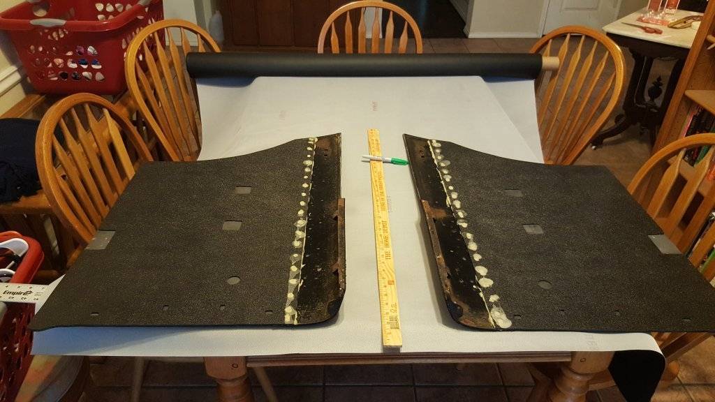

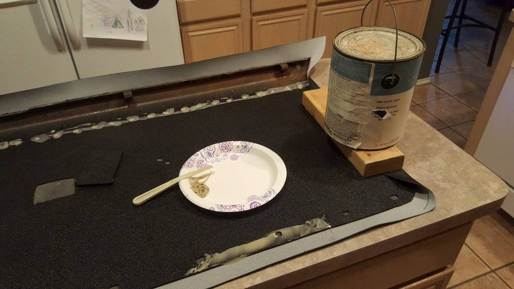

here is a shot of using PL Premium to attach the vinyl to the backside of the panel. there may be better stuff than PL premium for this. it did not want to stay without help. the PL comes in a grease gun tube, so i shot some onto a paper plate and used a plastic knife to spread it.
today ill be able to see if this is gonna work or not.
oh - a pro tip - the wife says stick the middles first, so left side middle, right side middle, bottom middle. then half that distance and do it again. hope that makes sense...
try not to glue yourself to the door panel -
