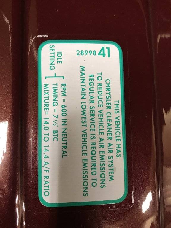

I'm not in a hurry at all, still have quite a lot of work to do..... So if you (or somebody else) are able to check some time what kind of sticker belongs there I would appreciate that. I just really like it if all the stickers are there so I'm going to buy it (if possible) or get it reprinted.

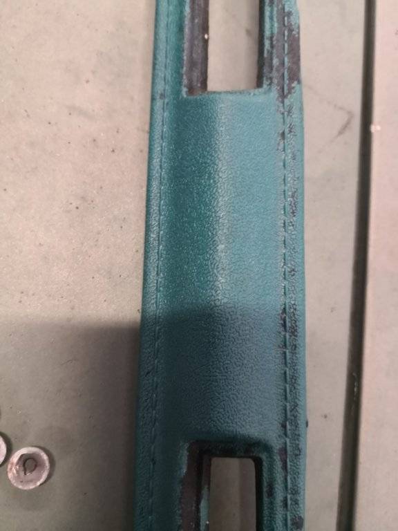

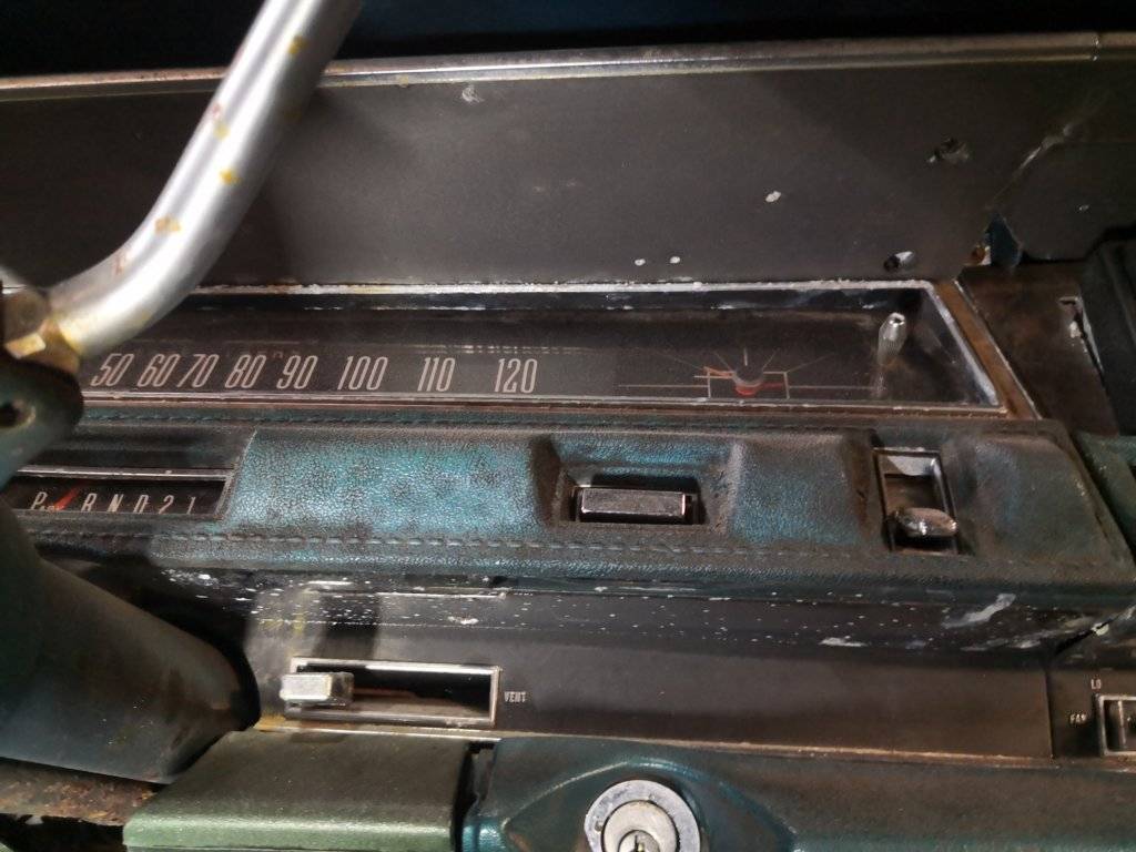

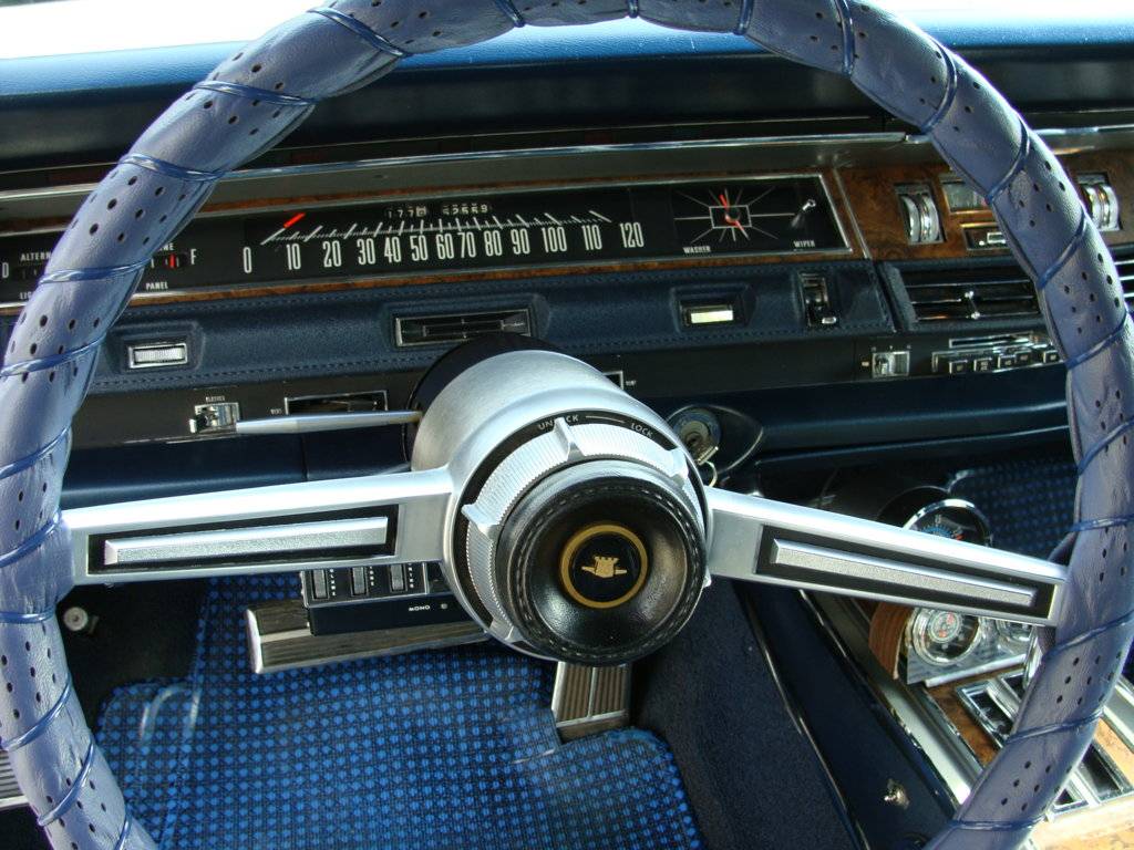

I started yesterday with taking the dash apart. All the parts are in a good shape, just very dirty and need a good cleaning and some detailing.
I want to take everything out before I start with the bodywork so that I don't damage anything and it makes it easier to clean and restore al the parts.
In the picture I've attached you can see how dirty the dash is. But I've already tried cleaning a few parts fast and they come out like new!

Looks very goodView attachment 320840

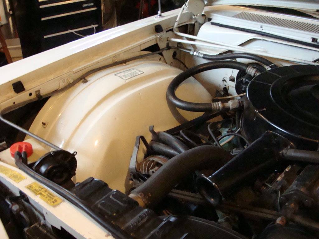

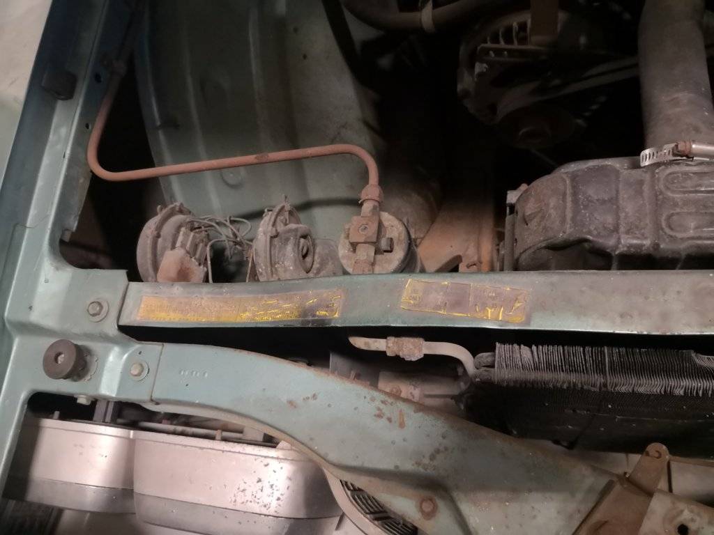

The sticker you are referring to is the emissions sticker. If I recall correctly the last to digits of the part number should match the emissions number on your broadcast sheet. Mine is for 383 2bbl. Automatic. Reproductions are available.

Thank you for the info on the sticker, that's great. I'm going to search and buy that one. And also going to check out you thread.

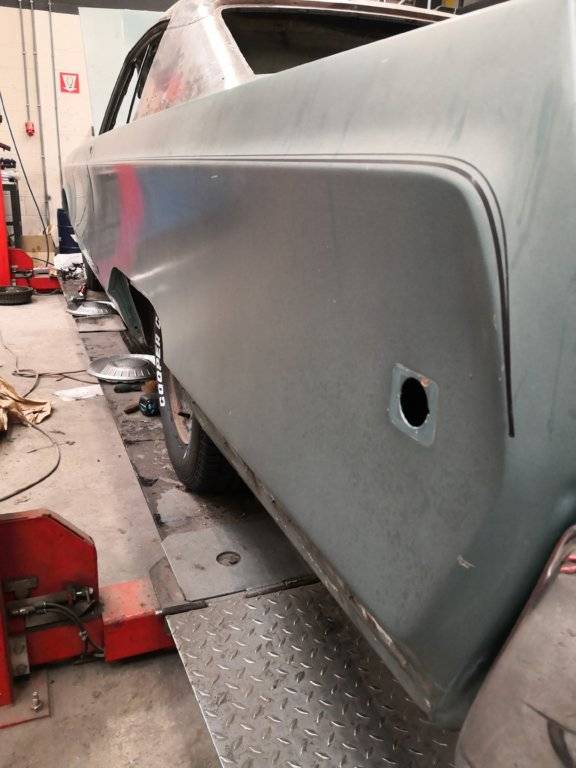

I'm still amazed at how straight the old lady is, the sides are incredible, the doors fit perfect and when you close them they make that nice solid sound. Also the trunk and hood fit really nice. I just have a soft spot for details like that.

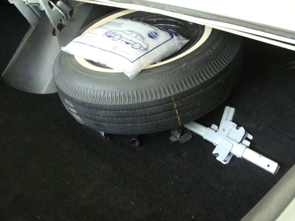

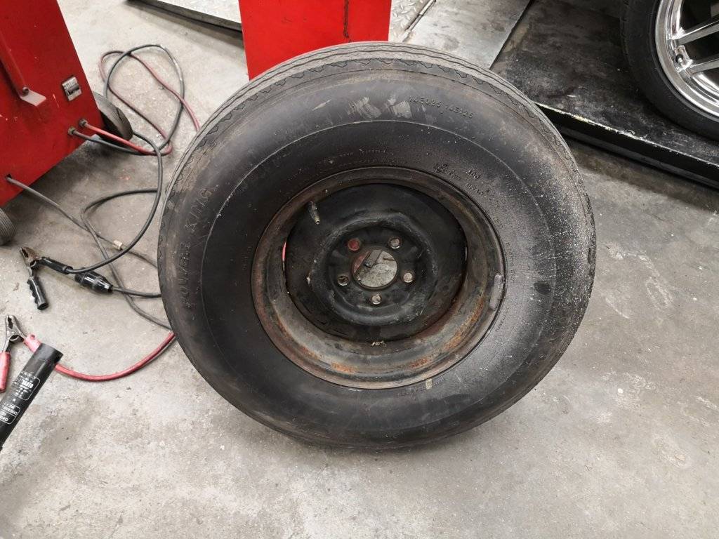

I've replaced the tires today, the ones that where on the car where really old and dried out, one of them was blown apart standing still. The other 3 did keep the air inside, but that was the only positive thing you could say about them.... Just feels a bit saver with new tires. The spare tire is even older, wouldn't surprise me if it might be original.....

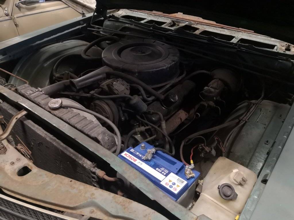

I couldn't find the numbers on the engine at first, but with a bit of googling I did find them. Somebody fitted an ac pump over them.... The engine code says D440 6 7. So if I'm correct that means the engine is from the seventh of June 1968. I'm not sure what the production date of the car is (where can you find it?). But according to the invoice it was sold on 30 July 1968 and according to the title (original pink slip) it was first registered on the first of August 1968. So it must have been a car that was already in stock. Sounds like the engine could definitely be original to me.
For 68 the scheduled build date is on your fender tag. Bottom row 607. June 7 1968.
May or may not have been built on that date. But when it was originally scheduled to be built.
I already thought so, but I wasn't sure. The engine has the same date stamp (June 7), so I'm pretty sure that it must be original.

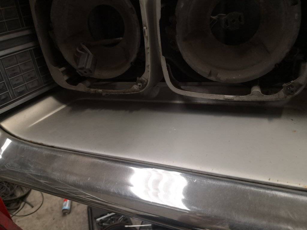

First, does anyone know the color code of the light grey parts (taillight panel and panel below the headlights?).

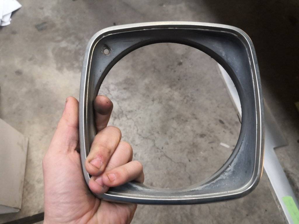

And I guess the center of the trim that goes on the side of the Chrysler was originally painted black, was it matt black or more like a satin finish? Same question for the headlight rings (I'm amazed by the weight of these) and the trim that sits next to the headlights in the front fenders.
At the classic car dealer I work we have a 1968 Imperial that also has a blacked out center in the side trim and that is more in a satin finish (I redid it on that car, but it clearly was a satin finish). I'm not really sure with the New Yorker because almost all the black is gone, that's why I'm asking.

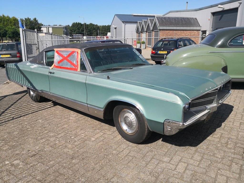

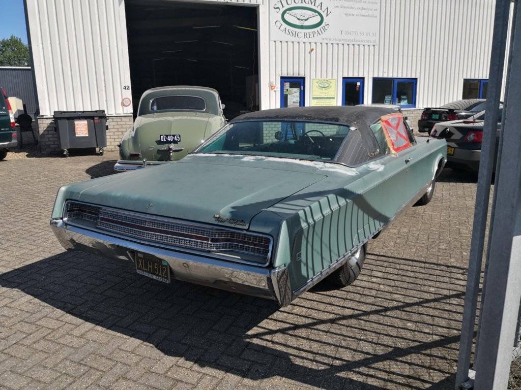

I own a 1968 Chrysler New Yorker since a while that I am restoring. Beside driving a 1969 Dodge D100 sweptline as a daily driver I'm not that familiar with Mopars, so that is why I'm posting this thread. To give some updates on the restoration, but also maybe getting some info and help.

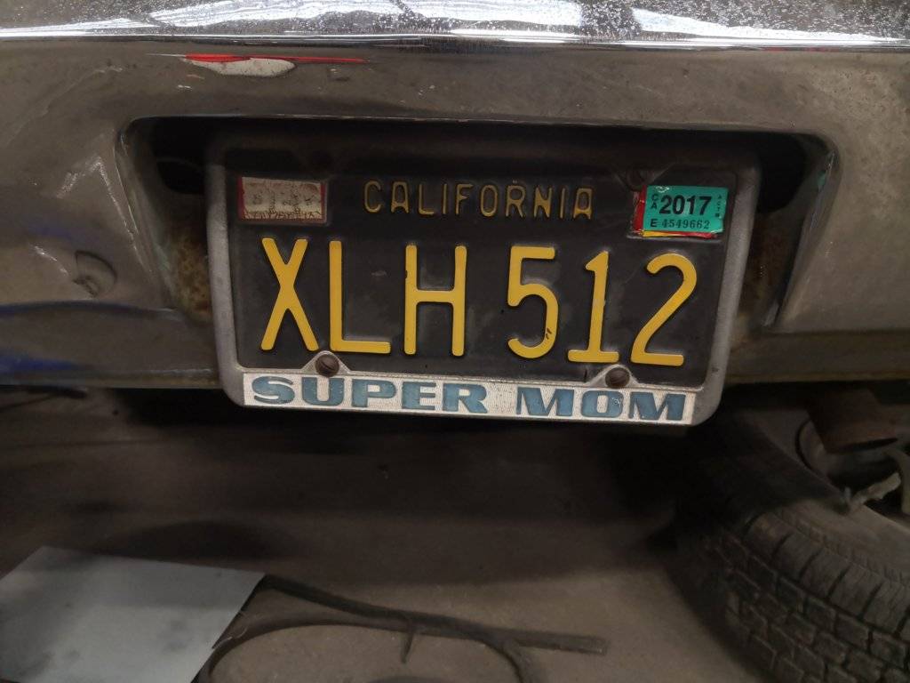

The New Yorker I'm restoring is a 1968 model and was sold new in California. It is an original one owner black plate car and it even has the original invoice and insurance papers.
I've bought the car off course because I liked the model, but also because of the history. The body is incredibly straight and original and that was what made me fell for this car. Although it is a California car, it does have some rust issues. A bit more than I was expecting, but that's normal with a older car.

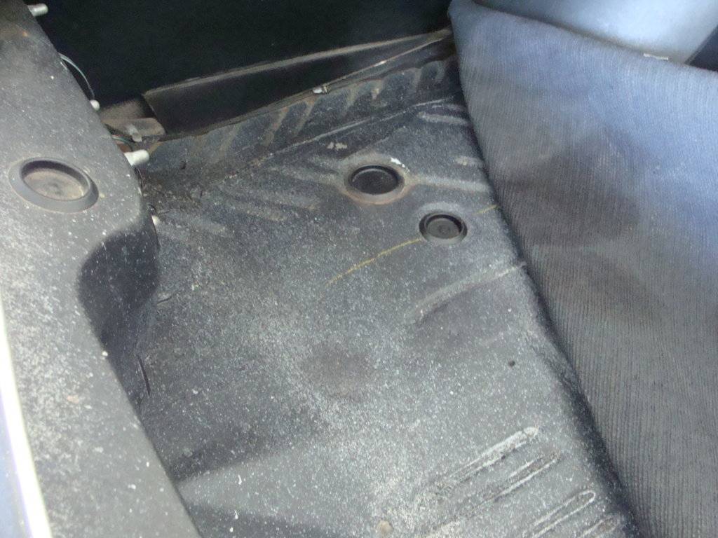

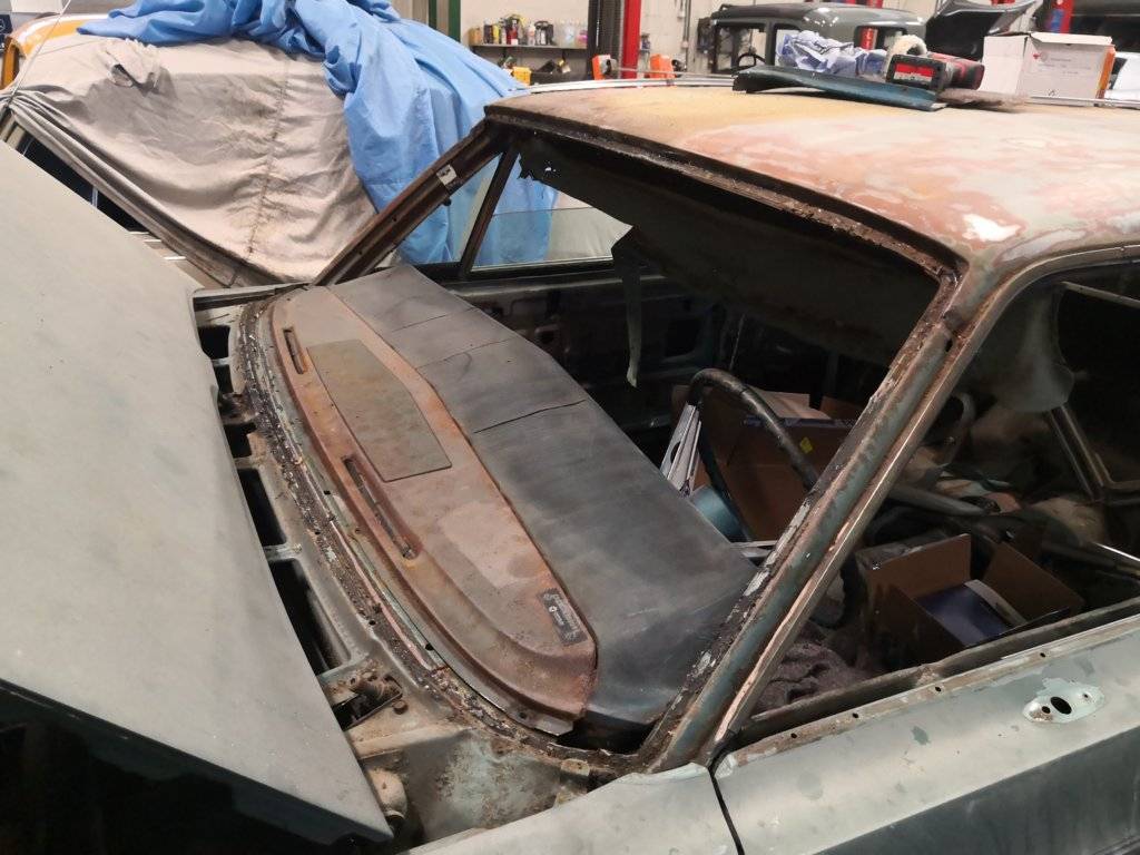

The left front floor pan is one of the issues, but that is easy to fix. A bit worse is the roof and underside of the rear window. It obviously had some moisture issues because of the vinyl roof and I do believe that is also the reason why the left front floor pan is rusted. I removed the vinyl roof (it had seen better days) and found a few small holes in the roof. The biggest problem is that the underside off the rear window molding has rusted away. It is quite complex shaped, so that is going to be a challenge to repair. The rest of the car looks like a California car should (luckily).
All the chrome and stainless look perfect, except for the rear bumper. So if anyone has a good one, I might be interested.

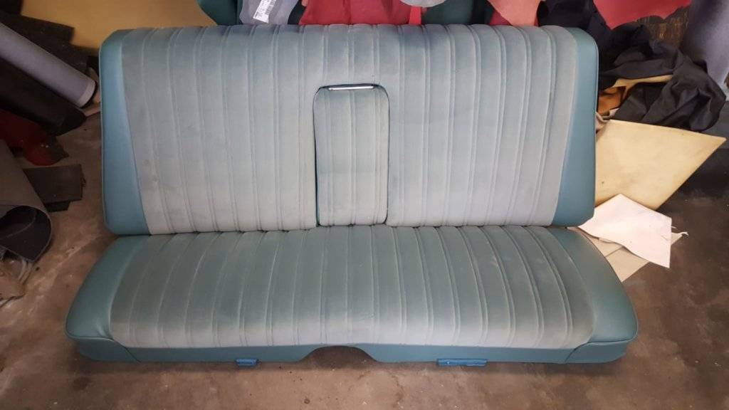

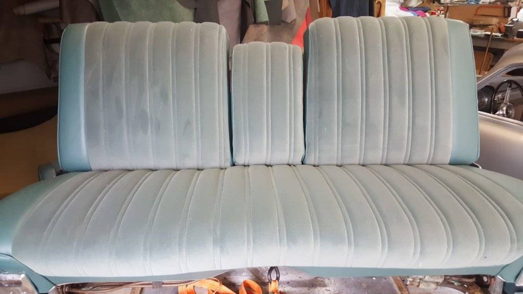

The interior was a bit tired and very dirty. The seats have already been reupholstered, but haven't done anything to the rest of the interior yet. Body first.

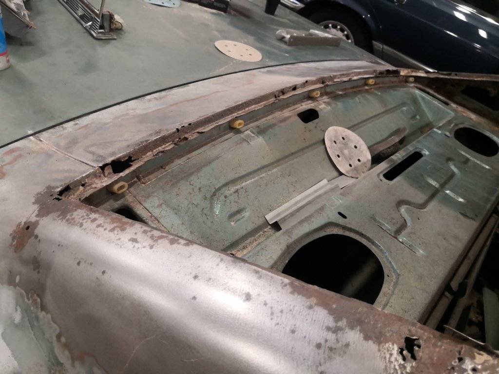

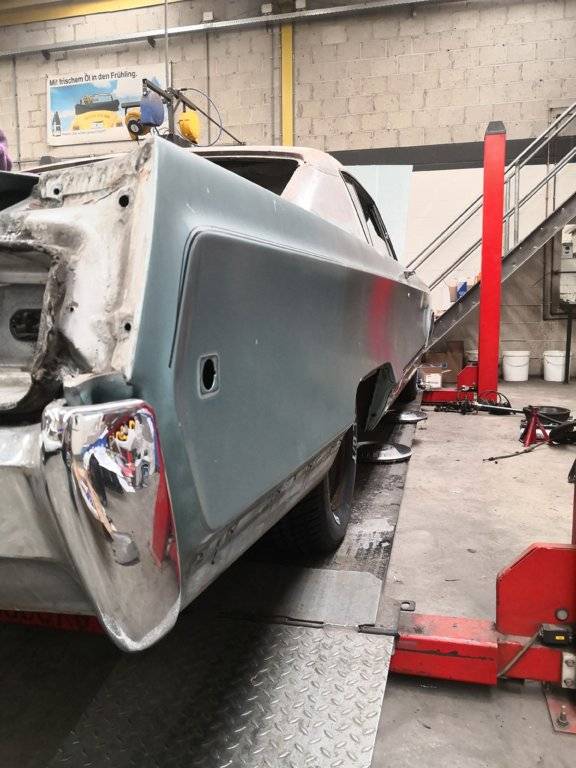

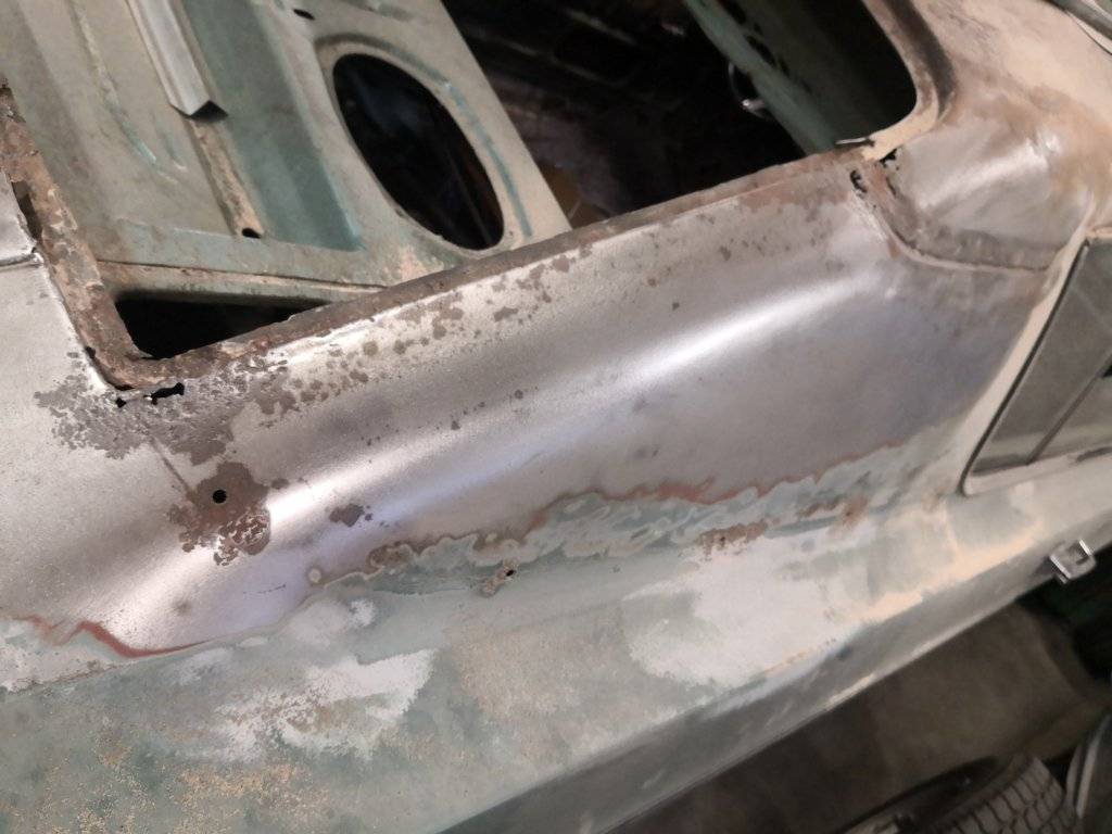

Unfortunately I haven't been able to do a lot of work to the New Yorker. I have been welding on the lower side of the rear window, starts to look good, but not finished yet.
