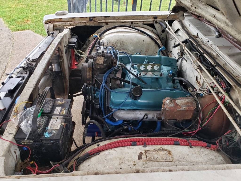

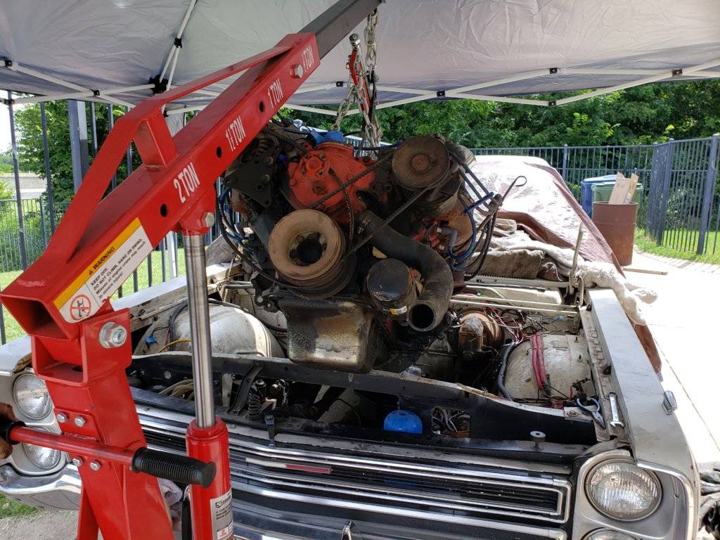

swapped out the 383 and put in the 440 from the humphreys car from b. brown in OR

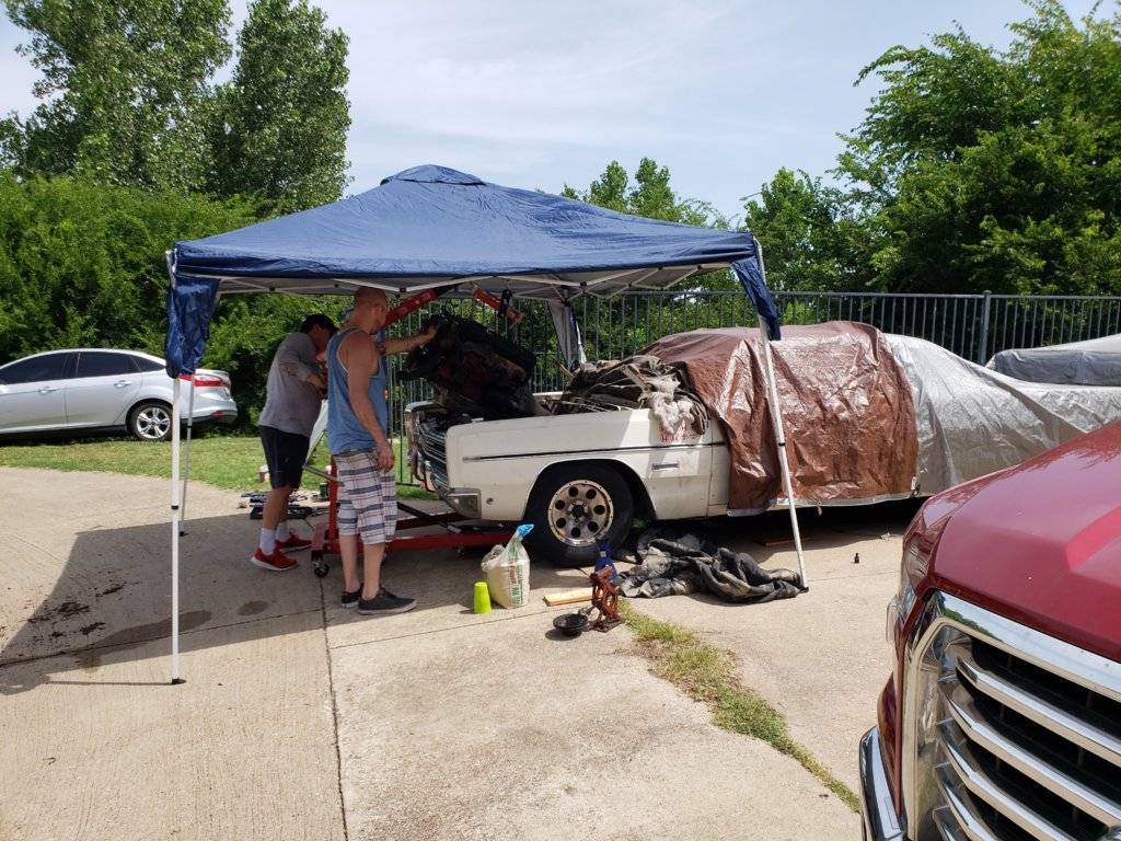

the work area:
my son and son in law helped. none of my friends did. i have good sons.

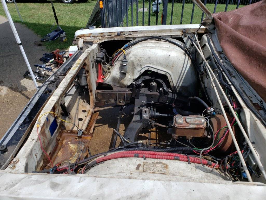

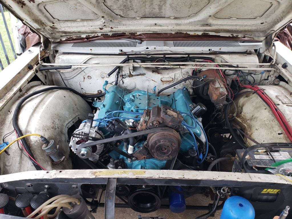

i forgot to take pics of the new motor in we wanted to put the hood on and get wrapped up and get inside it was freaking hot today. we stuck the motor mounts and transmission crossmember but the hood is just sort of on there not good yet. and i have to hook up every.thing.

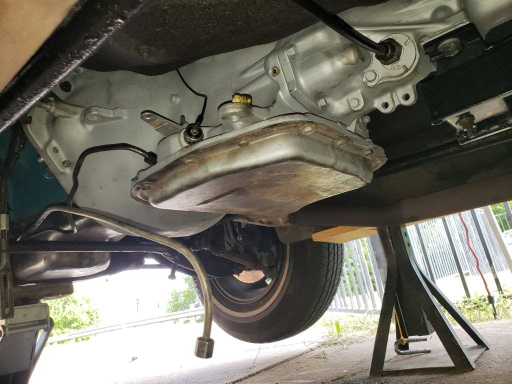

so i barely got 5 minutes in, didnt even have tools out yet ,routed the transmission cooler lines and started hand tightening them...

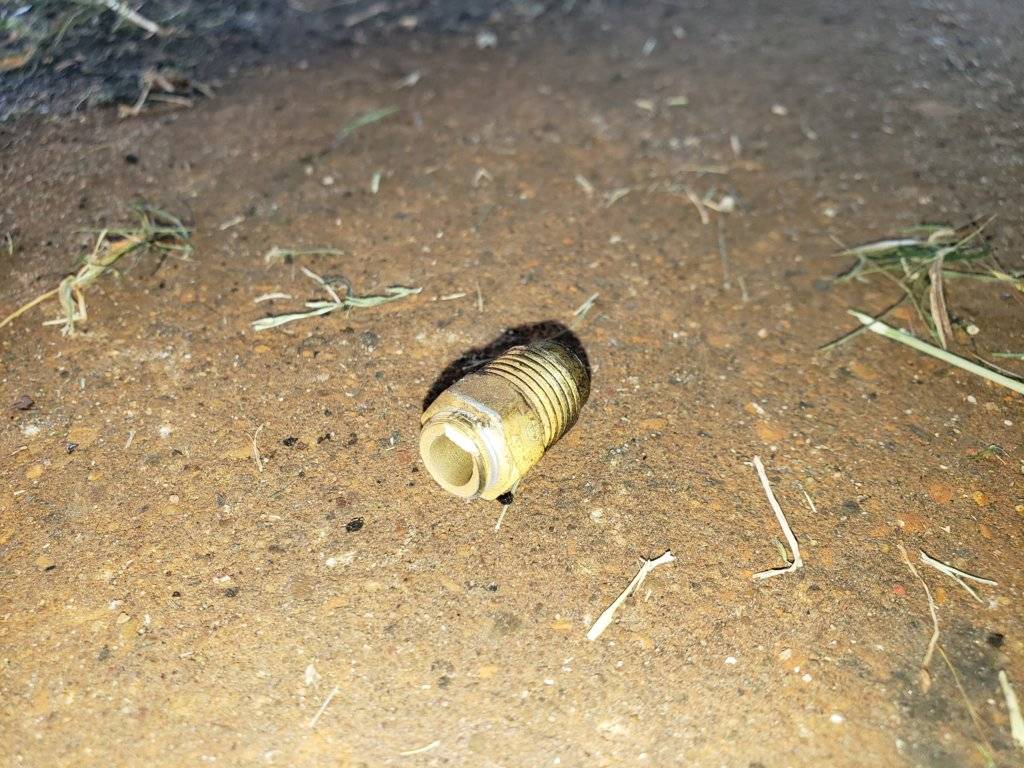

broke off on the transmission side, from hand tightening the line attached to it. gonna have to reach out to plano transmission tomorrow... grumble grumble

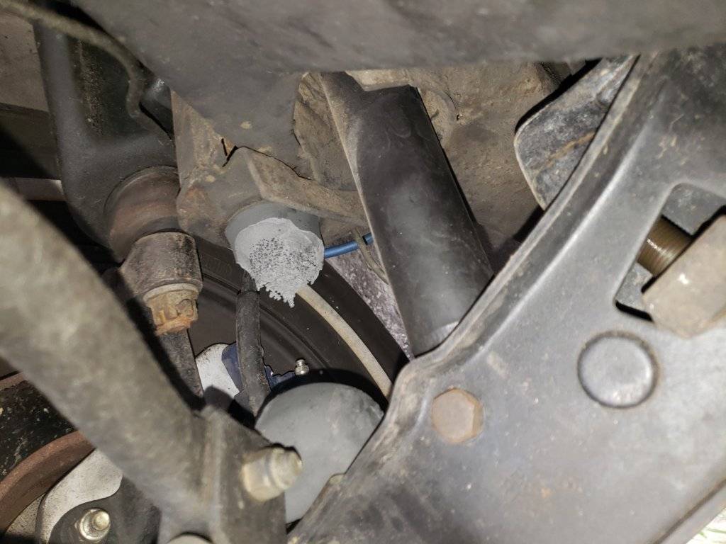

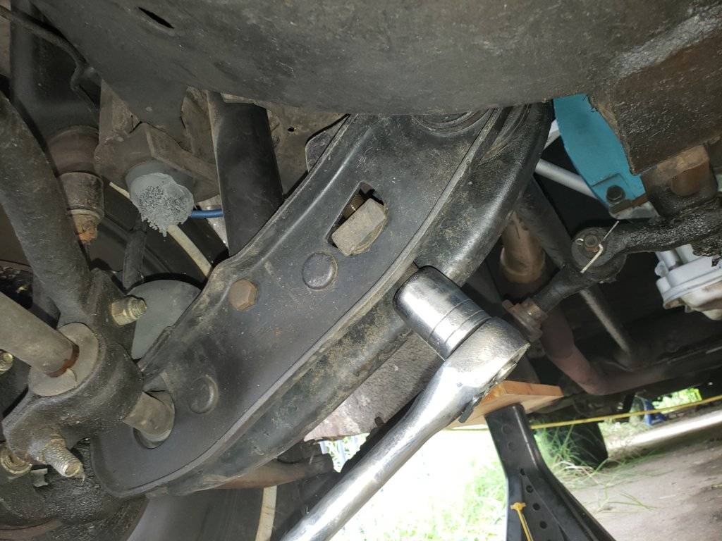

so, right. a bunch of fuckfuckfuckfuckfucking fuckfuckfuckfuck fuckfuckfuckfuckinghell shitdamnfuck fucks later, i moved onto the 10,000 other things to reattach. putting some spring back in the torsion bars and i see this...
w.t.f ******* fuckfuckinghellfuck shite is this

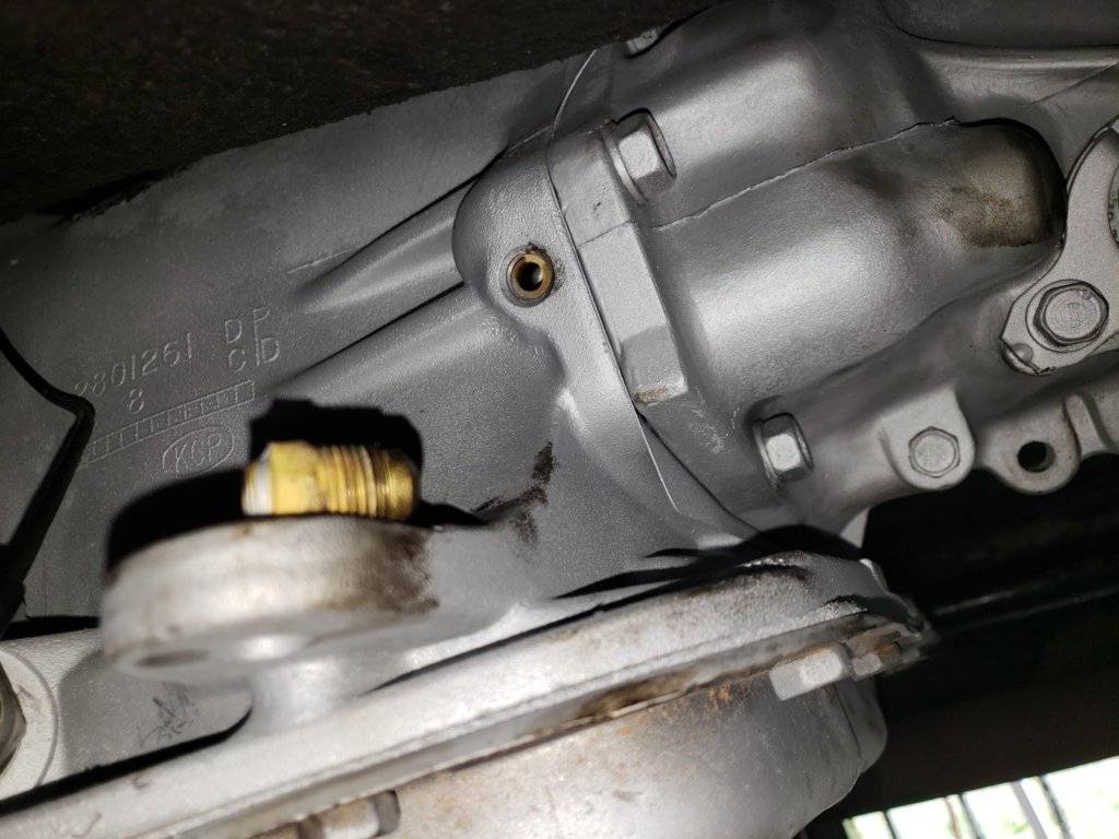

so i stopped by the transmission guy on the way home and showed him the broken fitting. just like the engine rebuilder did me with exhaust bolts, he says they dont take those fittings out when they r&r a transmission, and the fitting whats there is what was there when i brung it to him.. he carriers me over to the steam booth and opens it up - he had a 727 cooking right then and it still had whatever fittings still in there. sigh.
ill start soaking it with pb blaster and then try to easy out it this weekend i guess.
so it didnt come out yet. i read that brass and aluminum bind really well together. awesome.

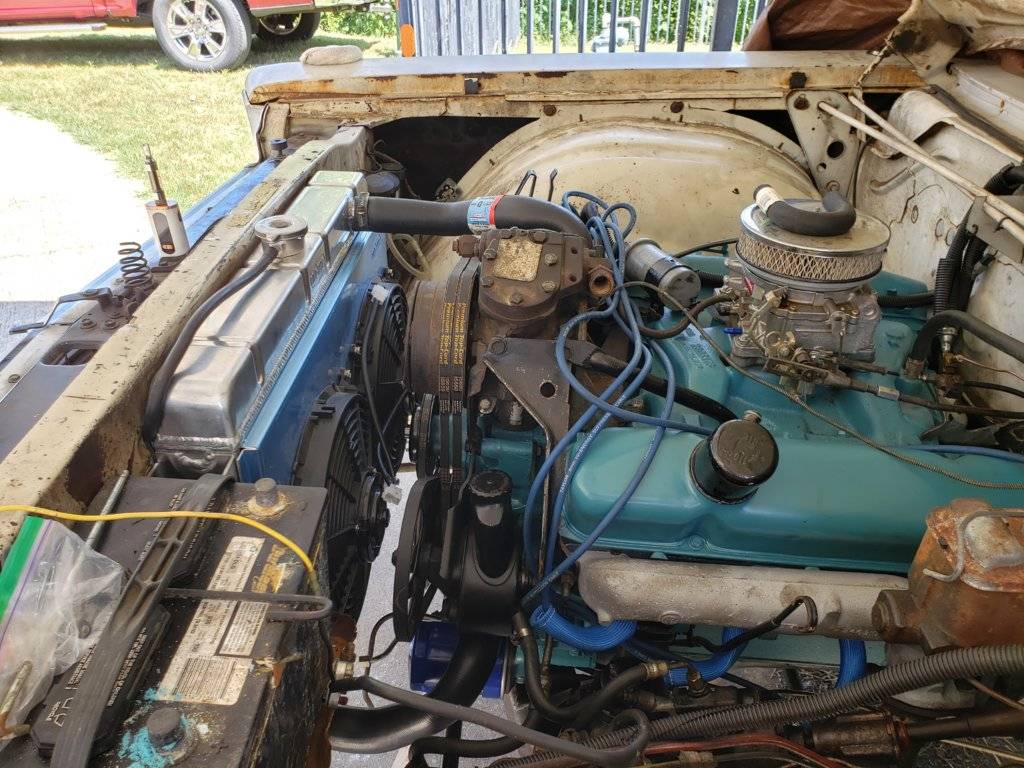

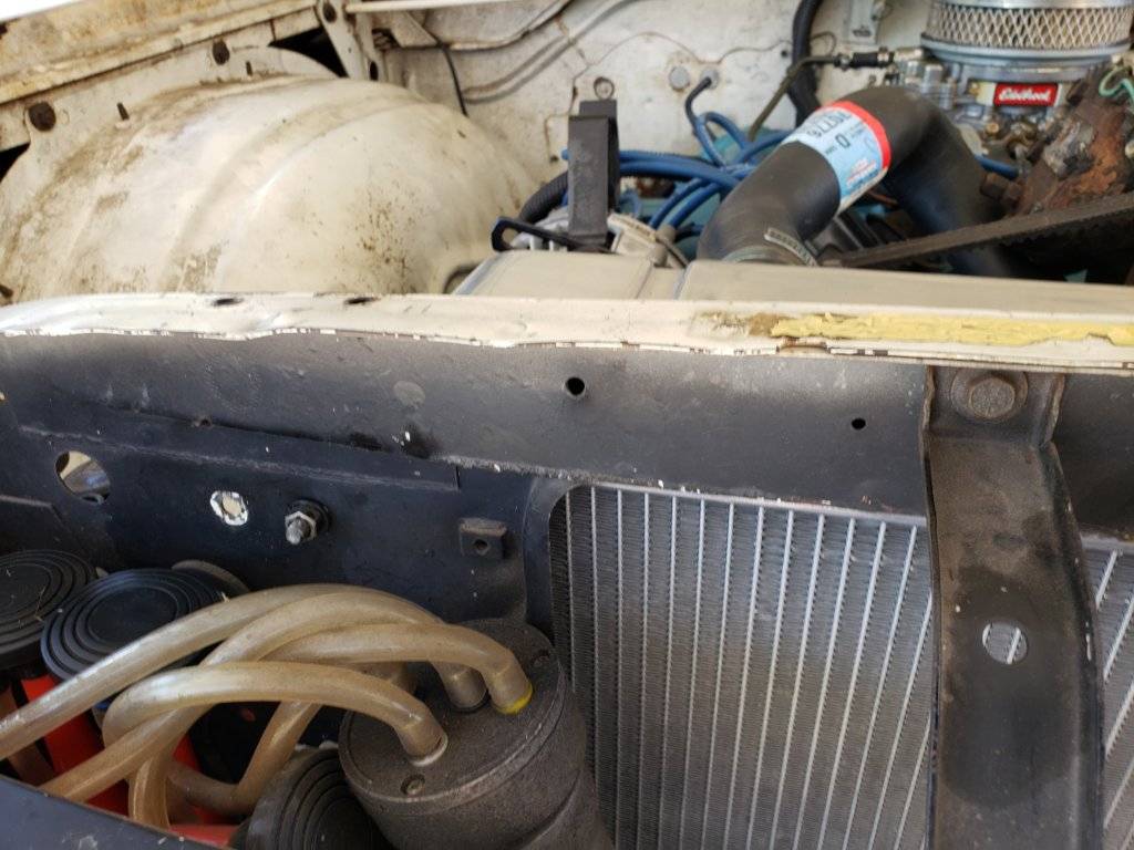

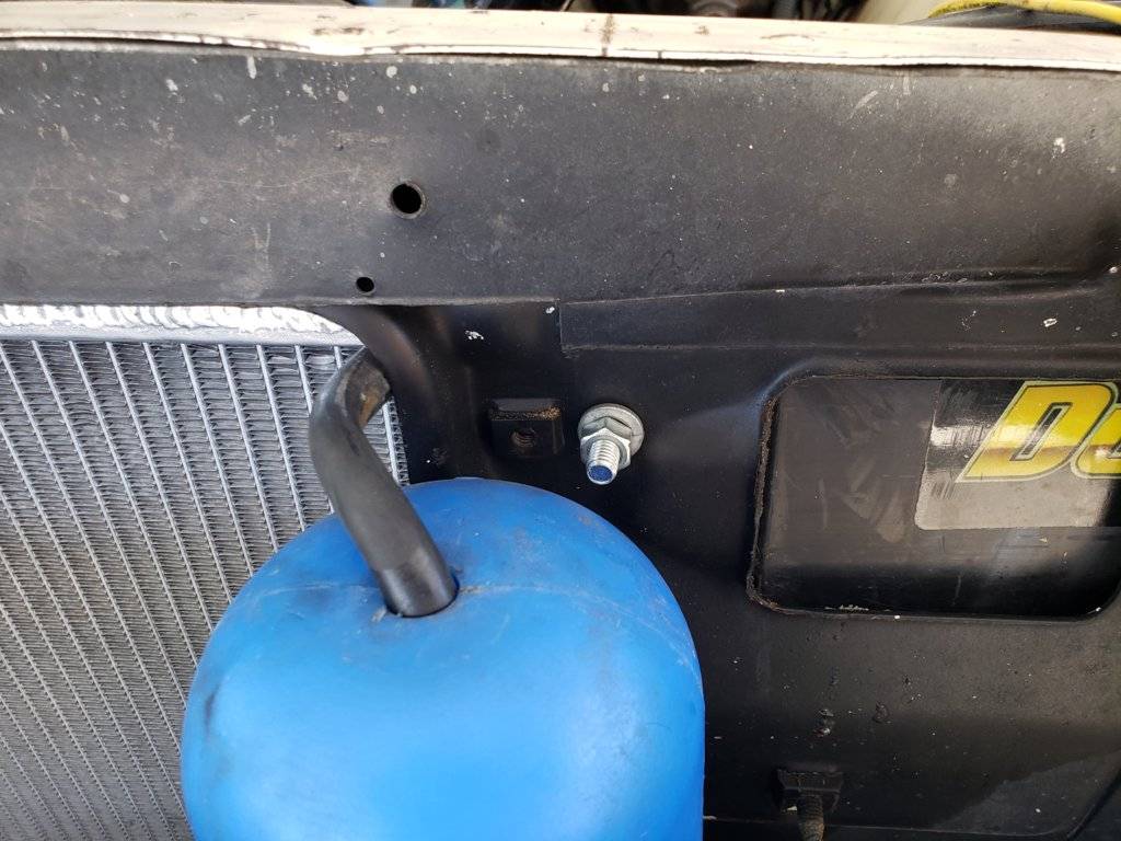

had to adapt it. old radiator was slammed in pretty caliwhumpus, this is really slammed in there too. i pushed it as far as it would go to driver side, it hits the battery tray.
how far i had to move it. the rad was about 28 1/2" across. the airway square in the front steel is 22" across. the stock mount holes are at 24 1/2" apart.
