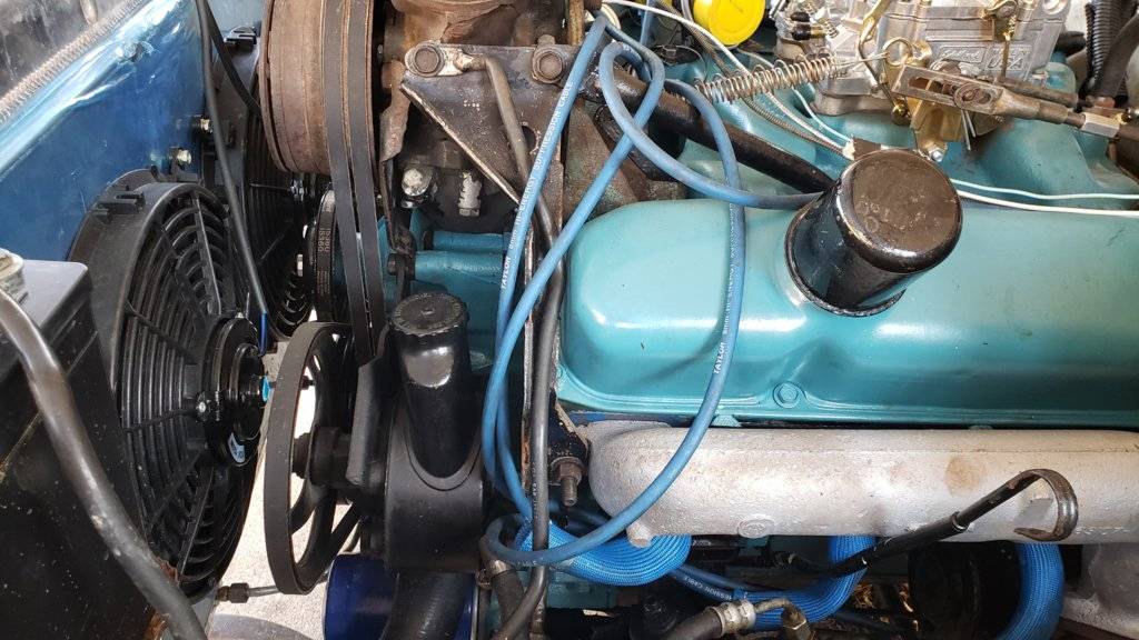

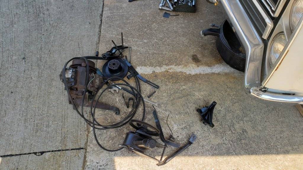

i took all the A/C stuff and the orig leaky p/s pump and the dual belt setup
and reinstalled it here
then i took all the stuff off the front of the 383 non A/C engine
and installed it here
notice the leak around the water neck that i couldnt see b/c of the A/C head..
so i removed it and regooped it with copious amounts of rtv blue. i had red on there previously, but tbh it looks like the paper gasket disintegrated already.
the ALT is rigged in there, but its as-was on the 383 and it worked for me for years and is how i got the car so we shall see.
o BTW for the kids trying this at home - the big drive pulley on the crank / balancer is different A/C to non-A/C, or 383 to 440 not sure which (both conditions?) but the pulley arrangement is different for sure.

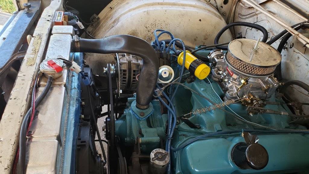

came out to the car today and saw muh hoses collapsed top and bottom.
took the stant cap off and put the o.e. cap back on.
got all the wiring cleaned up from changing from points to orange box.
realized i forgot to finish filling up the transmission - i had filled it but forgotten to install the driveshaft so it leaked out. then i put the driveshaft in, but never came back and refilled...
i ran maybe 15 minutes before it got too hot and i shut it down again.

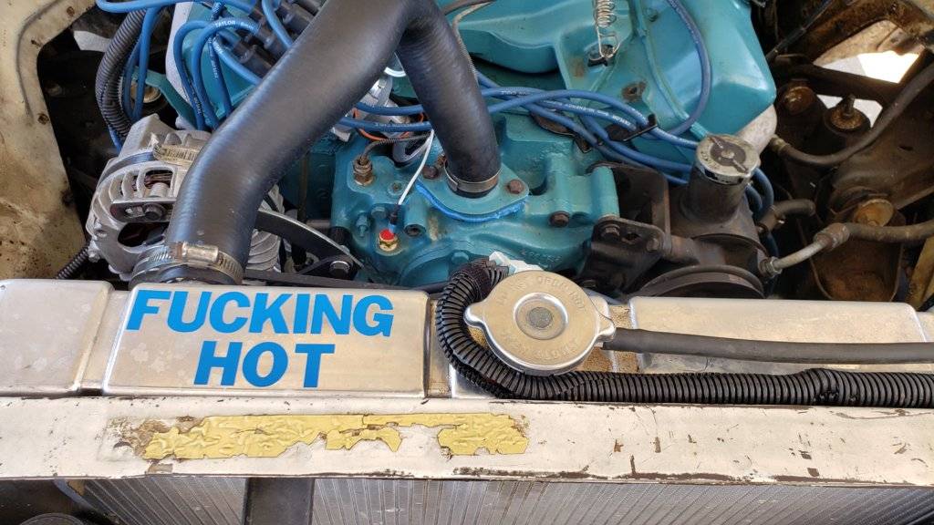

burned my arm on top of the radiator again, so i did this

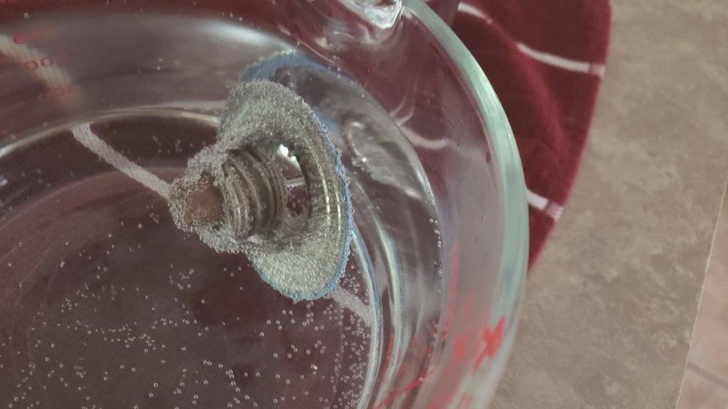

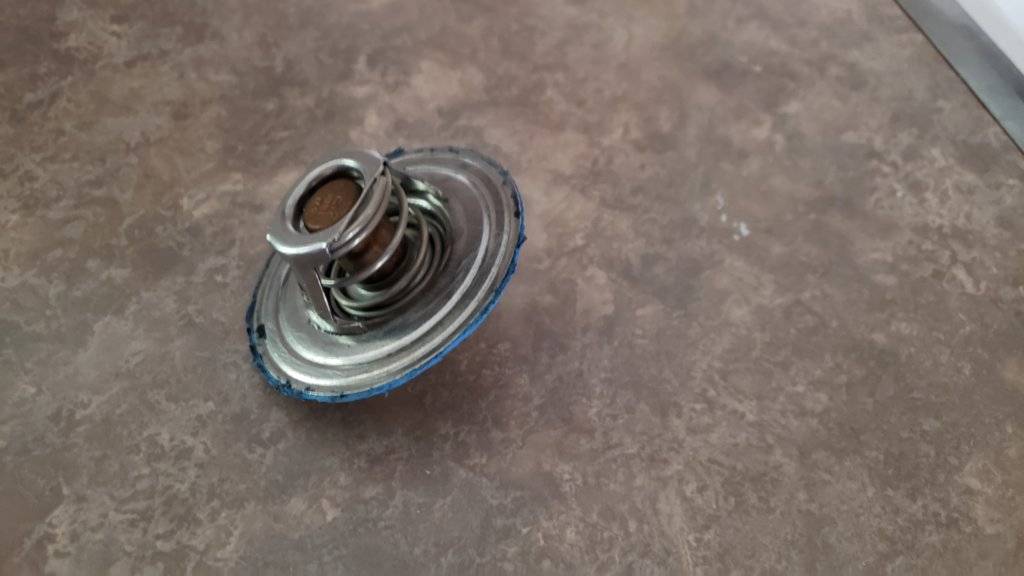

put 180 t-stat back in and re-test ( i drilled a 1/8" hole in it - it had none 1st test around)
take 180 t-stat out of known good 383 motor and re-test in the 440 ( this t-stat has the little 1/8" bleeder hole in it with the wiggle tab)

im thinkin about trying the stock rad and/or stock fan. i dunno what else to do. right now i have a 180* t-stat with a hole in it and that let me run a good long time, but eventually it climbed up to too hot. the previous t-stat didnt have a hole in it.

It looks like no one commented on the collapsed rad hoses.
This is caused by a defective Radiator cap.
The hoses will collapse if the cap doesn't allow air or coolant from the over flow bottle to re-enter the system when cooling down
Your comment of putting the OE cap back on was a good step to take.

1/8" hole in the t-stat seemed to get me way farther in run time but still ended up on the hot side. but if you buy a t-stat with no bleeder drill a 1/8" hole into that puppy.
