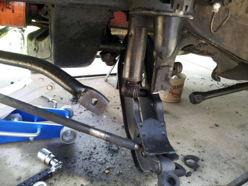

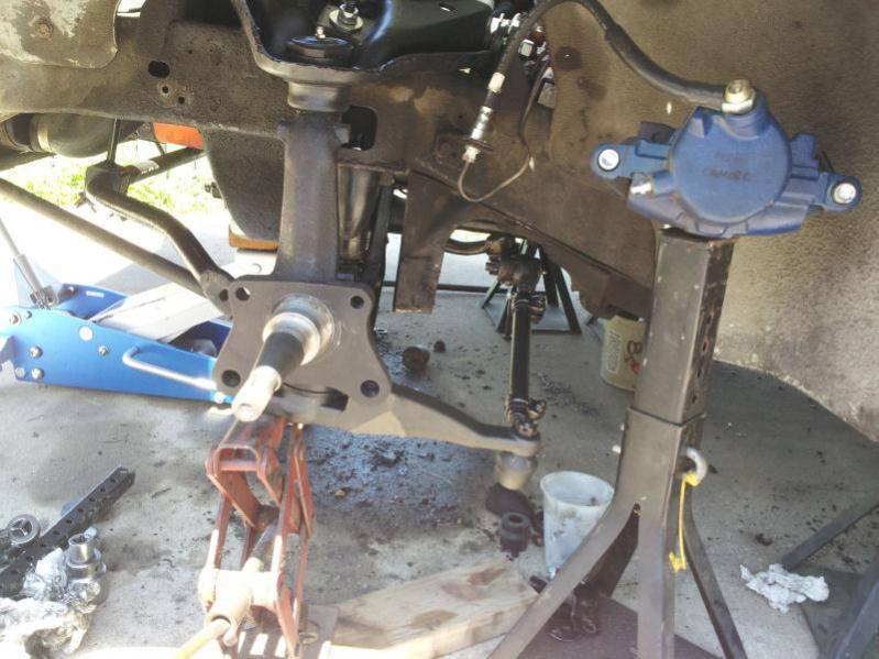

I took one pic of the LCA and strut going together so dude could see how you have to take the torsion bar and LCA loose to get the strut out.

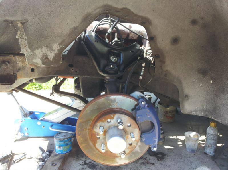

one pic the raising the lbj up to the spindle.

Looks great. Looks like an older GM caliper there. What set up did you use for the front brakes? Thanks John.

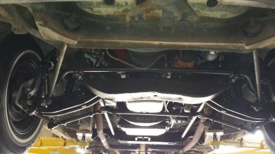

aight so today, im at the exhaust shop - mcswain garage @ 121 Austin st garland in case anyone needs it - and my car is up on the lift, and im crawling around under there. they fixed my manifold leak for $50 - vs doing it myself in the driveway and braking header bolts and a half day and all that it was a done deal.

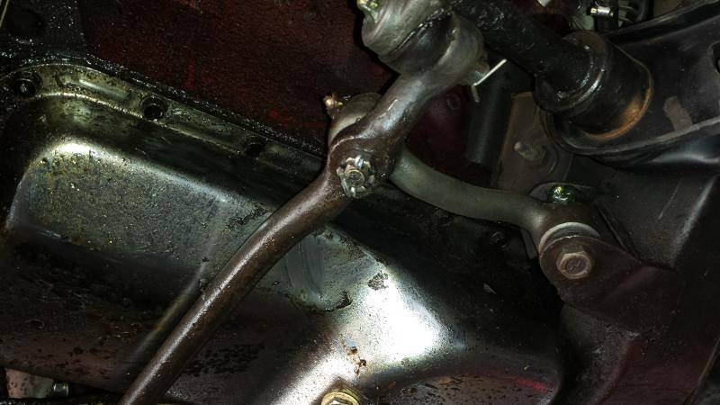

anyways so im looking around. I noticed that my steering idler arm has knockered the oil pan.
I show it to dude and we talk about it. we figure the oil pan is aftermarket and deeper than a stock one?
no sharp right turns for me until I work this out. what do you think?

Snap judgement .. aftermarket
Not too many stock chrome oil pans on Mopars that I can recall ;)
