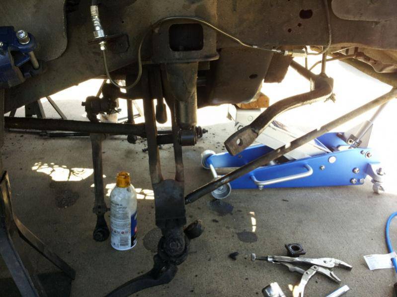

ok for those of you following along:
the torsion bar tool screw holes were not perfect - i had to take the 1/4-20 bolts that came with it and work them in with oil, then back out, then in some more, until it threaded pretty well.
the snap clip rings at the back end of the torsion bar is INSIDE the hole, not OUTSIDE. spray lube in there and then dig around with a screwdriver and you will find them.
the tool made it very easy to pop the bars loose.

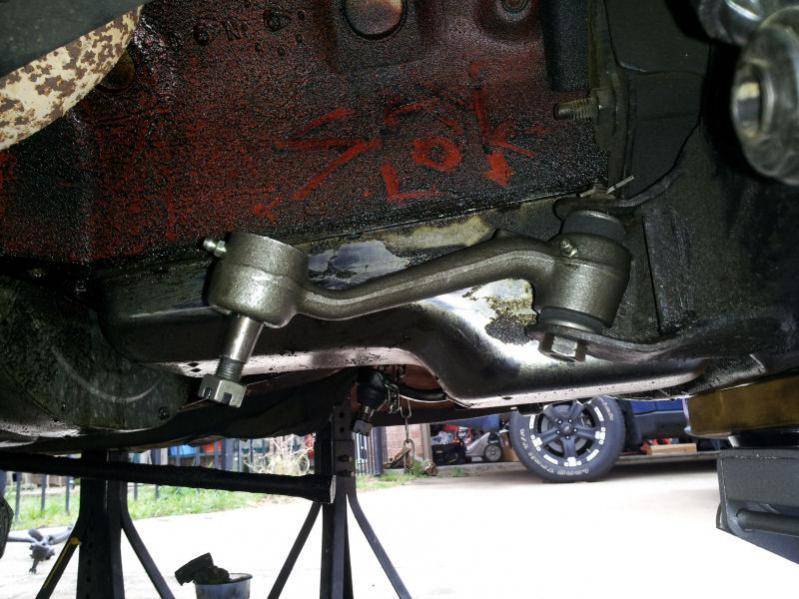

so now im down to the pitman arm. its like a 1 5/16 nut or something equally stupidly large.
i cant get enough huevos on it to get it to break loose. anyone know any secrets?
i get this steering arm off, and that will be it - the whole thing will be undone and i can carry it to the shop to get the stuff pressed in.
let me know how you did it!
- saylor
I use large large socket,1/2 inch breaker bar and extension pipe on the bar. You will need a special tool to pull the pitman off the shaft.
I know you all need pictures... heres the passenger side explode-o-view

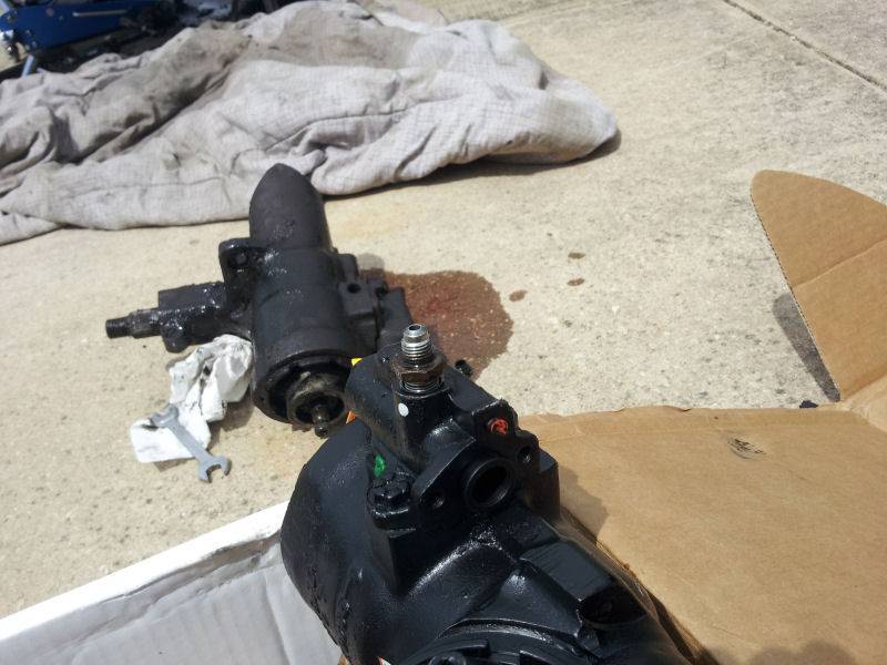

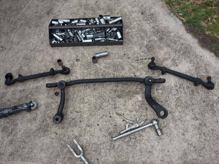

aight the arms are at the shop getting vat cleaned then bushings and ball joints installed. I don't get them back til next week - the guy is going to a swap meet this weekend. hopefully not with my arms and spindles :)
some pics for ya. on the steering box - you have to take your old return connecto valve and move it to the new box, don't exchange your core w/o pulling this off first...
