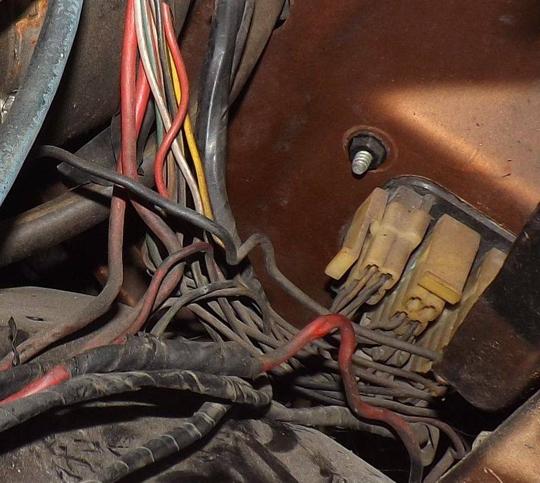

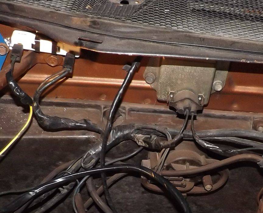

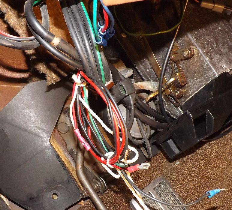

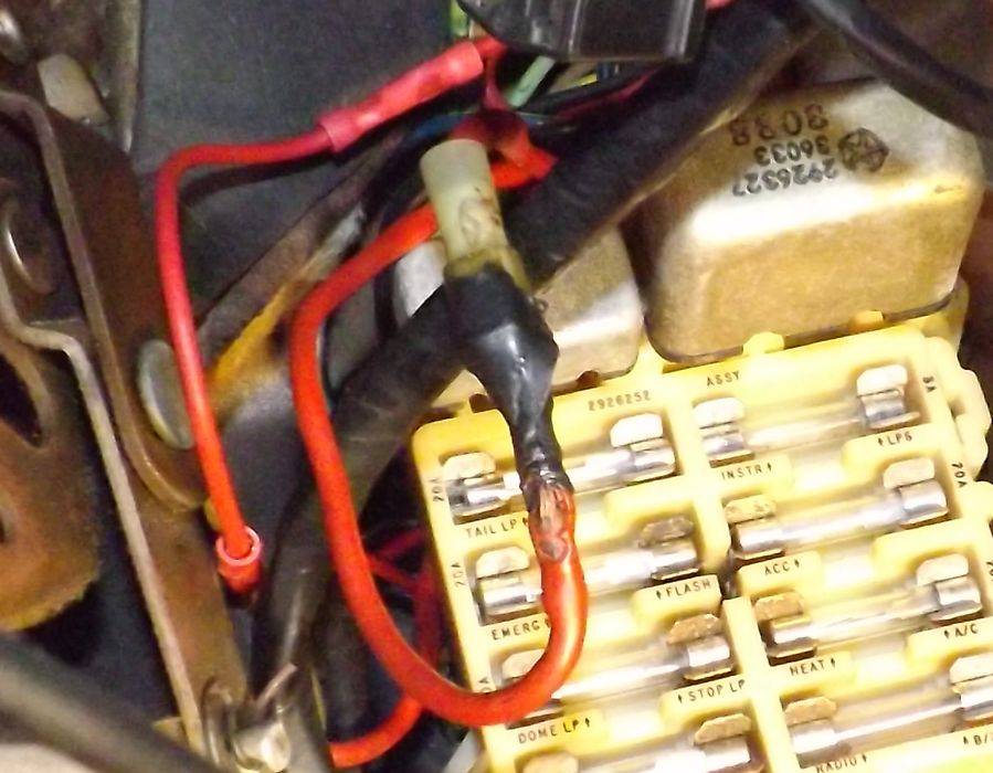

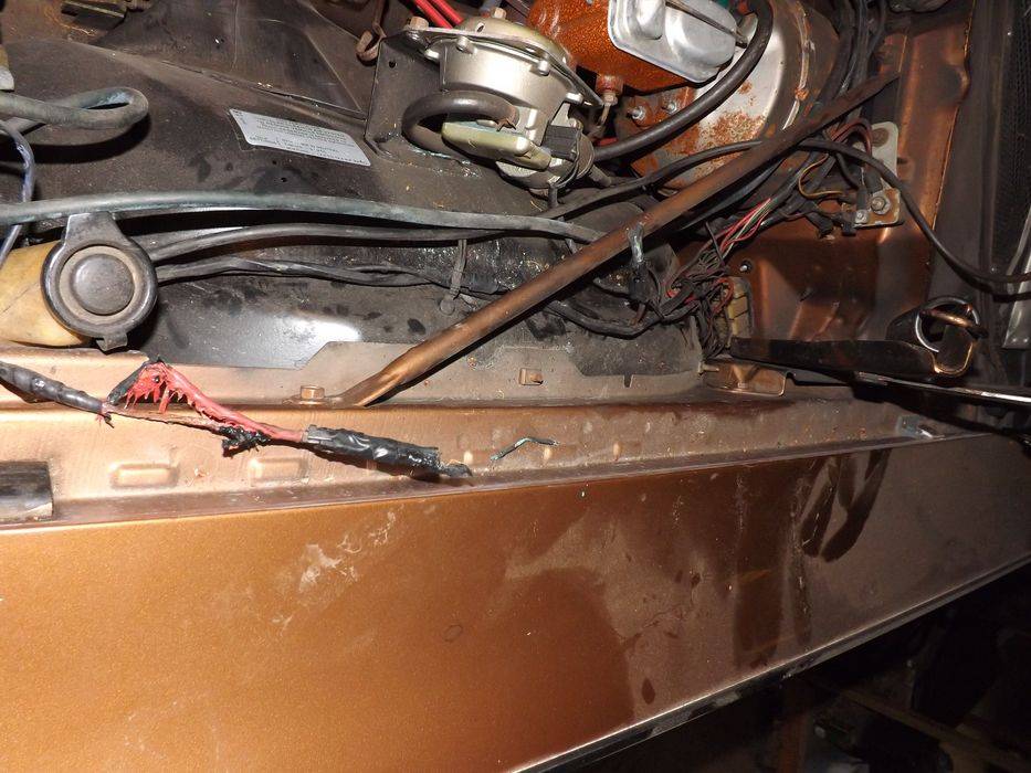

I think I have a few systemic problems here, I decided to go over the wiring a bit more and under the dash to get a feel of what Im dealing with in this car. I have a suspicion I may need to go through it more closely and maybe even replace the engine bay wiring harness. Check the pics for what I am seeing.
View attachment 203470 View attachment 203471 View attachment 203472 View attachment 203473 View attachment 203474
That's pretty ugly and a fire waiting to happen.
Since you bypassed this mess and you have spark, I'd say it isn't your problem, but it still needs to be replaced.
