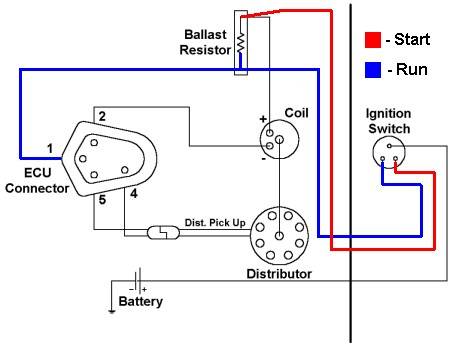

Yes this is the convo I had with DaveLux with regards the run/start circuits which I checked and found are correct, the new wiring is so very simple, there are four wires, two that end in a plug that goes on the distributor, no way to get that wrong, then the black wire goes to the neg coil terminal and the blue goes to the ballast, and that's all of it. I put the blue wire to the side that was hot with ignition on. The other side was cold until you hit crank, which is what it is doing. So, the way I wired it, yup it's right.

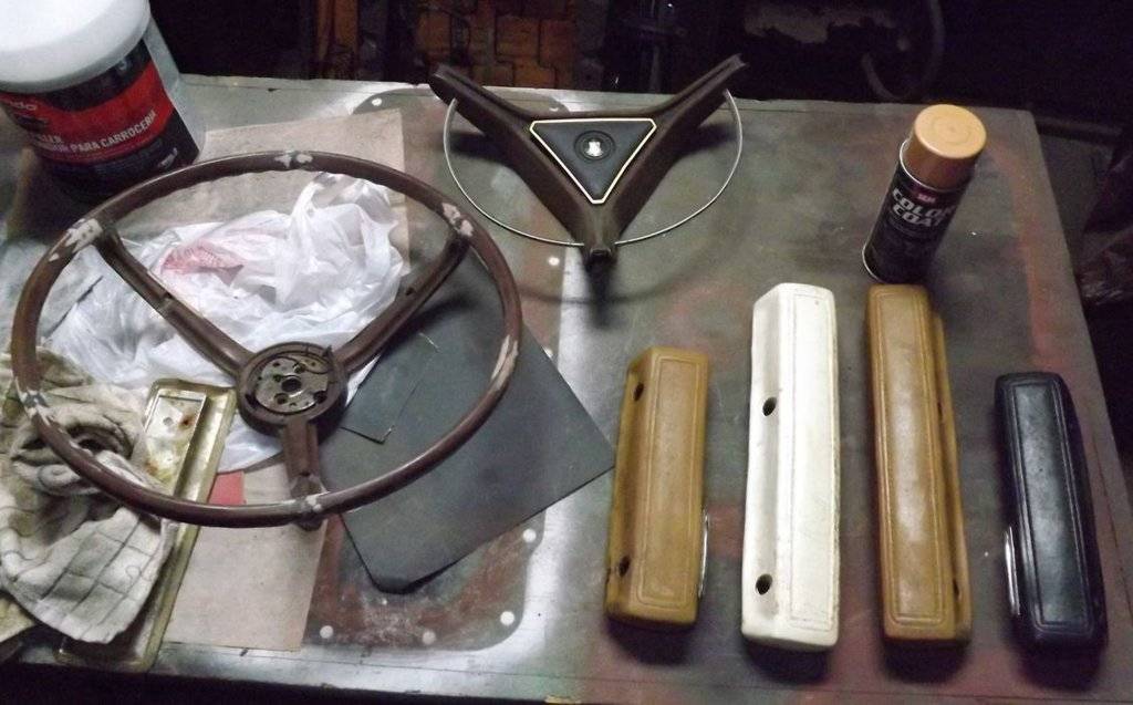

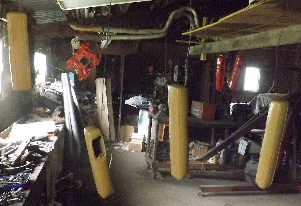

Anyhoo, I have not touched the engine today preferring to walk away for awhile. I kept myself occupied with other parts of the car, the pics are self explanatory. The orange painted rockers and inlet manifold in the background will eventually go on the car too.
