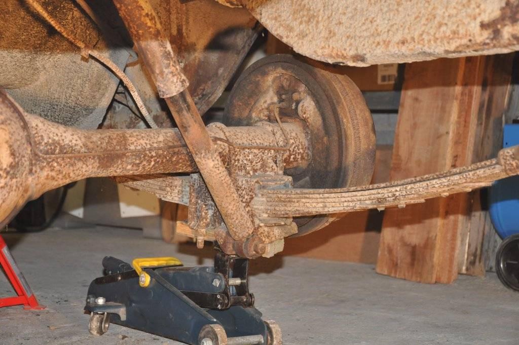

For example: I'm using mostly original nuts, bolts, clips and so on, which were rusty after 50+ years. Sandblasting them just to have them flash rust again even before reinstalling them doesen't make sense to me at all. So for me, plating them is the only logical solution to that problem.

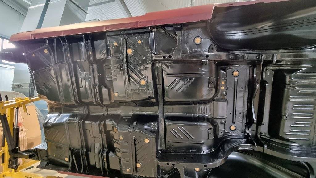

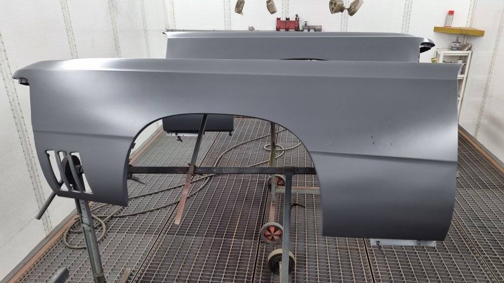

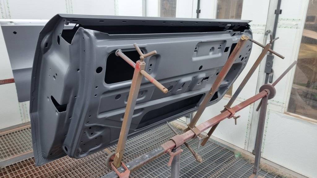

As for panel fitment, my metal guy did a lot of the fitting and forming before CDC, so I think/hope the Doors, Fenders, Hood and Trunk Lid will fit properly. But as I said, we will attach every part to the body before final paint just to check fitment, uniformity of the body lines and such things.
I hope that's enough preparation to be able to assemble the car properly when it's time.

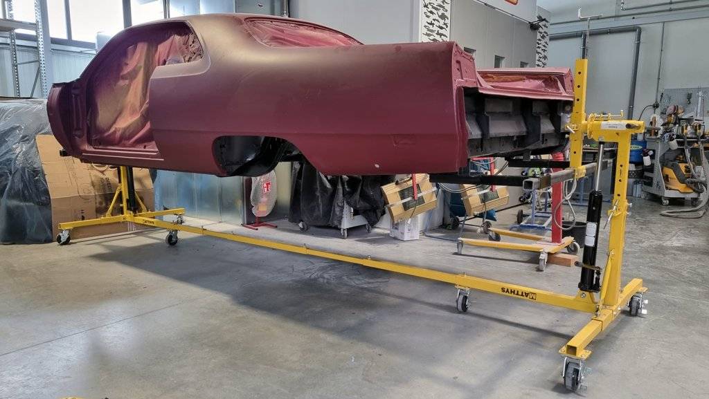

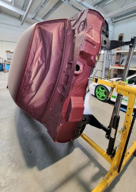

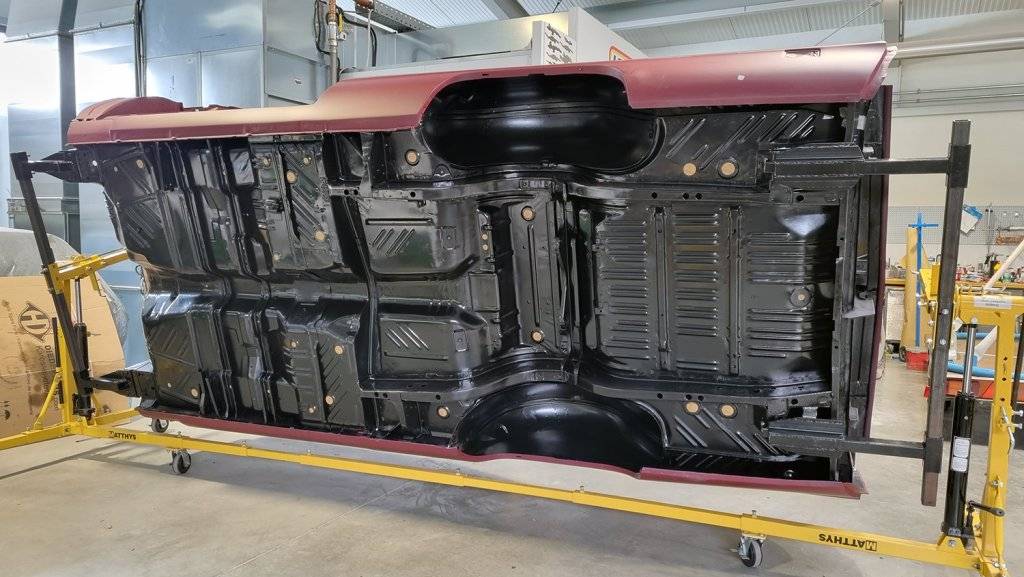

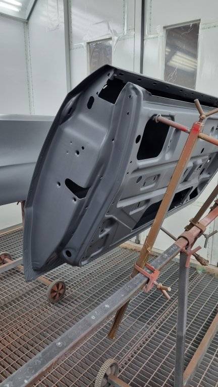

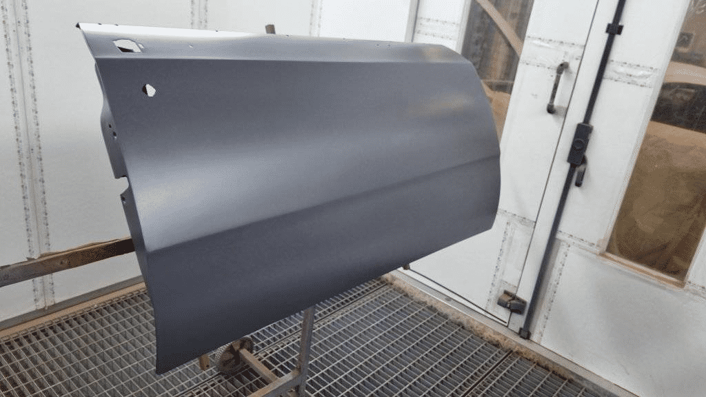

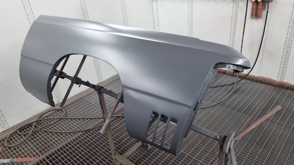

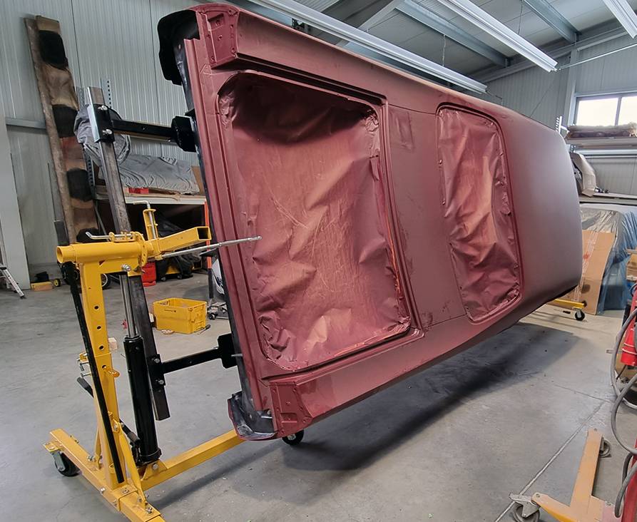

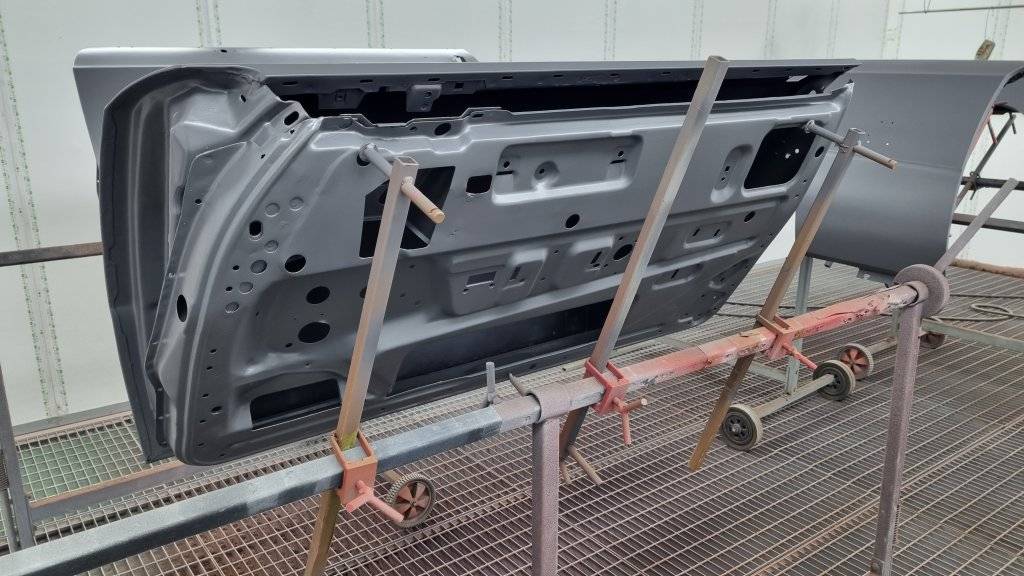

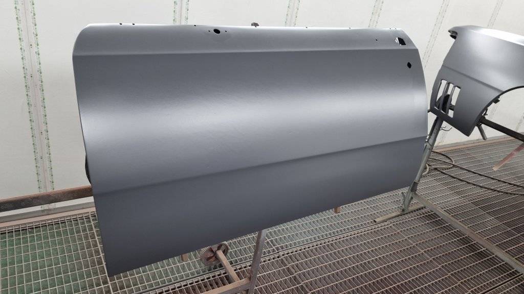

The 8 layers applied were: (recapitulated from memory. I hope I've understood everything correctly when my body man explained it to me. ;))
1. a special primer to adhere to the CDC (e-coat) without the need of scuffing it.
2. a layer of filler in some areas, not the entire car, to cover some "bigger" unevennesses.
3.-6. multiple layers of a very thick sprayable filler, guide coated and mostly sanded down again to get everything streight. Also included in these layers were some aditional filler on some parts like the duchman panel since they were still not perfect.
7. a very fine sprayable filler, again mostly sanded down, to achieve a very smooth surface
8. is the purple tinted primer to seal everything since some spots were sanded through in the previous step and as the last prep for the base color.
