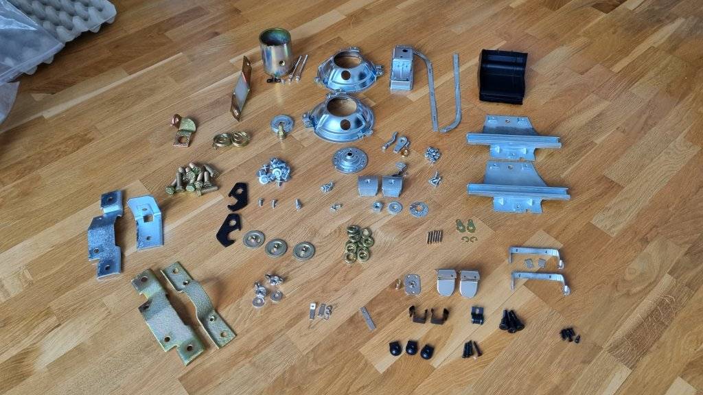

Another batch of freshly plated parts are in :)

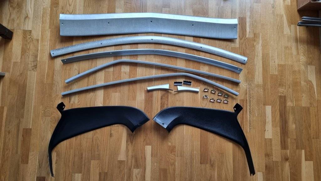

After Laser paint and rust removal, all the interior trim parts are freshly zinc plated now and ready for black paint.
And with the repro fiberglass side trim panels from ABC Moparts, the bigger rear Window I bought from Wyatt and a nice set of stainless trim I bought from @Pontiac Man , I now have all the parts I need for the Vinylroof deletion!

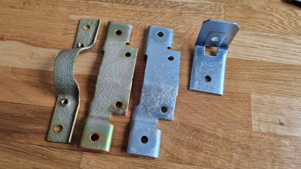

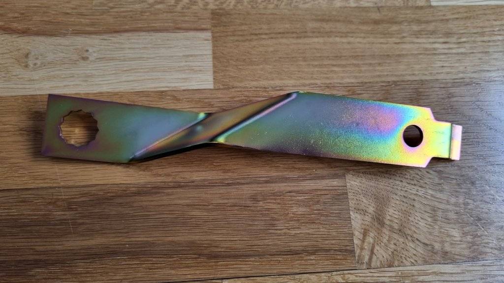

Next to the set of freshly Revulcanized Torsion Bar Brackets I've got back from Then&Now, ...
... I now also have a good set of metal parts to maybe cast my own Poly mounts. I'm not sure yet if that's necessary...

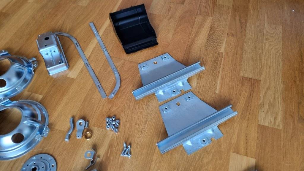

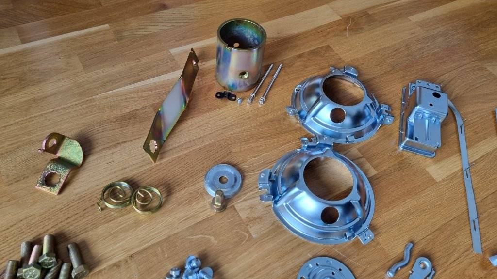

Since it's mandatory in Germany to have parking lights separate from the turn signals, I had to use the parking light sockets build into the H4 conversion lights I'm gonna use anyway. No big deal, but I had to drill holes into the Headlight Buckets for them to pass through.
Because I didn't want to do that to my original buckets, I bought new repros from OER for that, drilled the holes and got them zinc plated again.

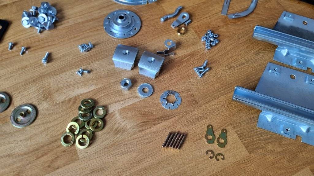

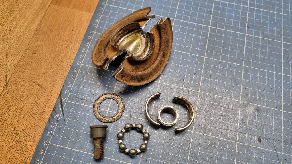

The new Idler Pulley I bought did not come with the mounting hardware and the special bolt were nowhere to be found, so I cut up the old idler pulley to get the original hardware from it.

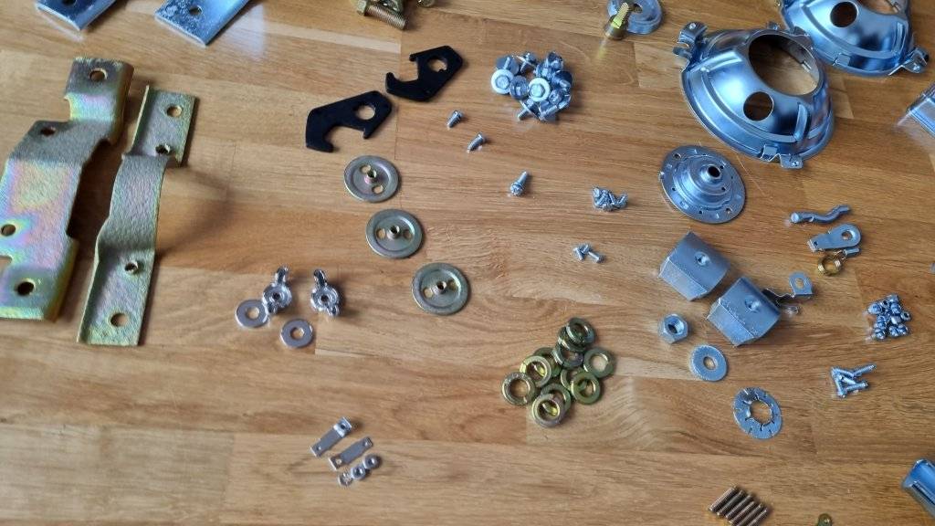

These were then sandblasted and zinc plated...

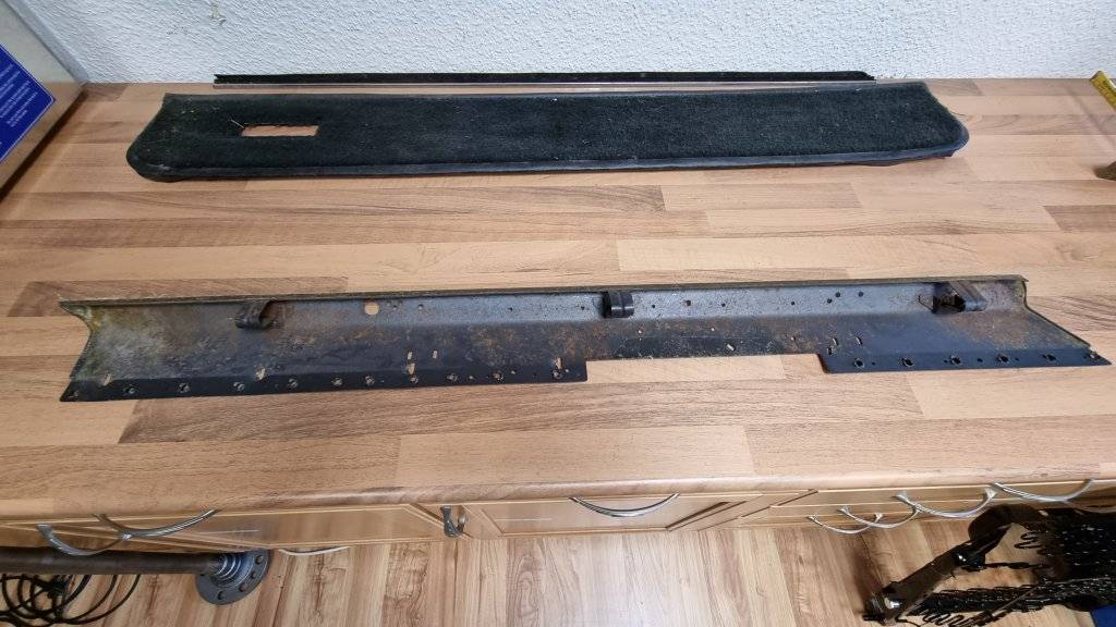

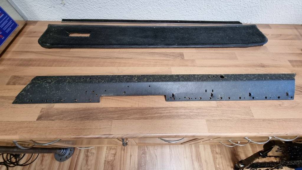

The upper metal parts of the door panels were dry ice blasted to get the old glue off, then got the immersion paint and rust removal treatment and are now zinc plated and ready to get bolted back onto the new door panels I made.
Since my first attempt to rebuild my headlight door motor failed because it shorted out internally, I took it back apart and since I never did that before, I cleaned the parts again and now zinc and nickel plated all the metal parts. Next I will rebuild the motor again... Hopefully successful this time!

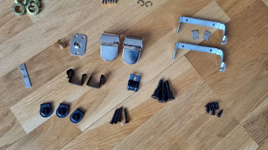

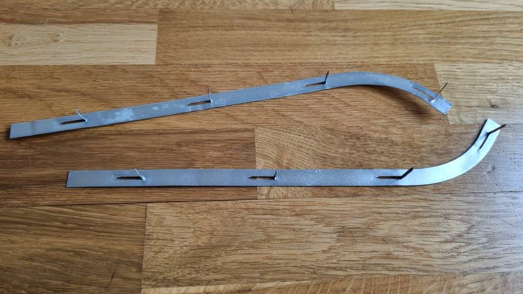

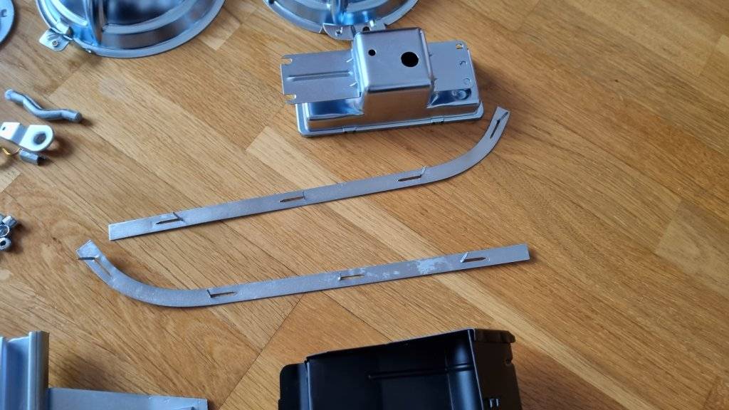

Some Metal reinforcements strips from the kick panel carpet...

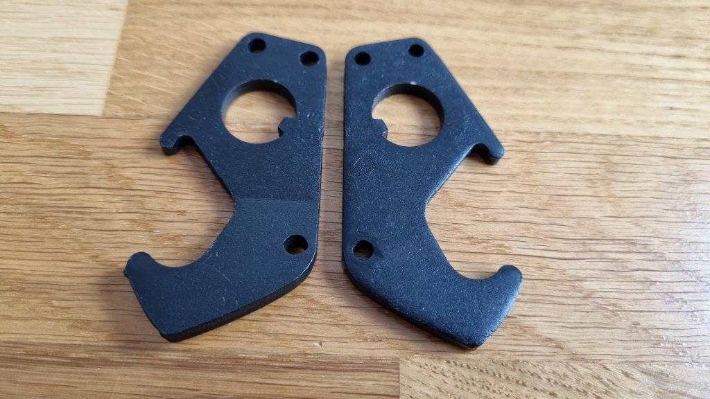

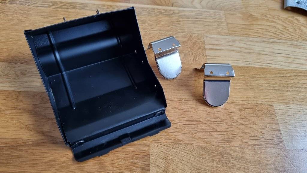

One more ashtray, black zinc plated, and the retaining tabs nickel plated...

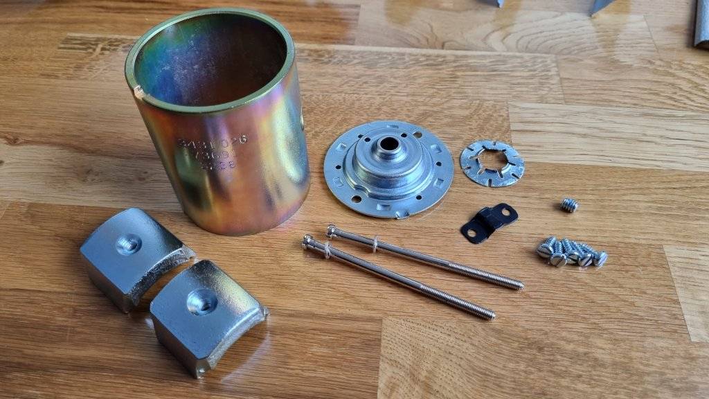

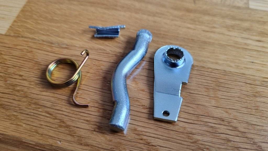

Some parts from the spring seat recliner tube thingy...
Seat back hooks, black zinc plated...
Brake and exhaust hanger parts...
