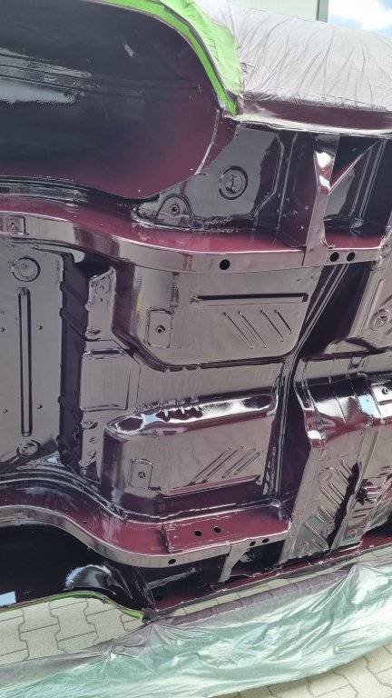

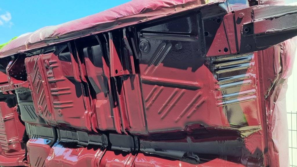

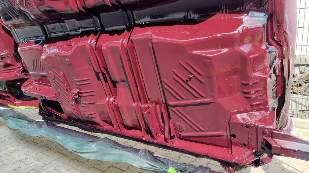

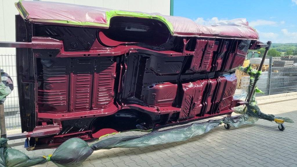

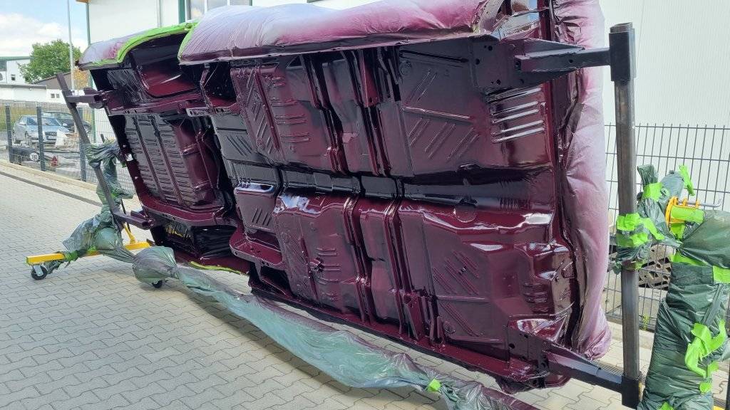

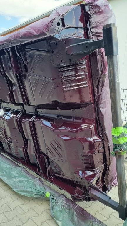

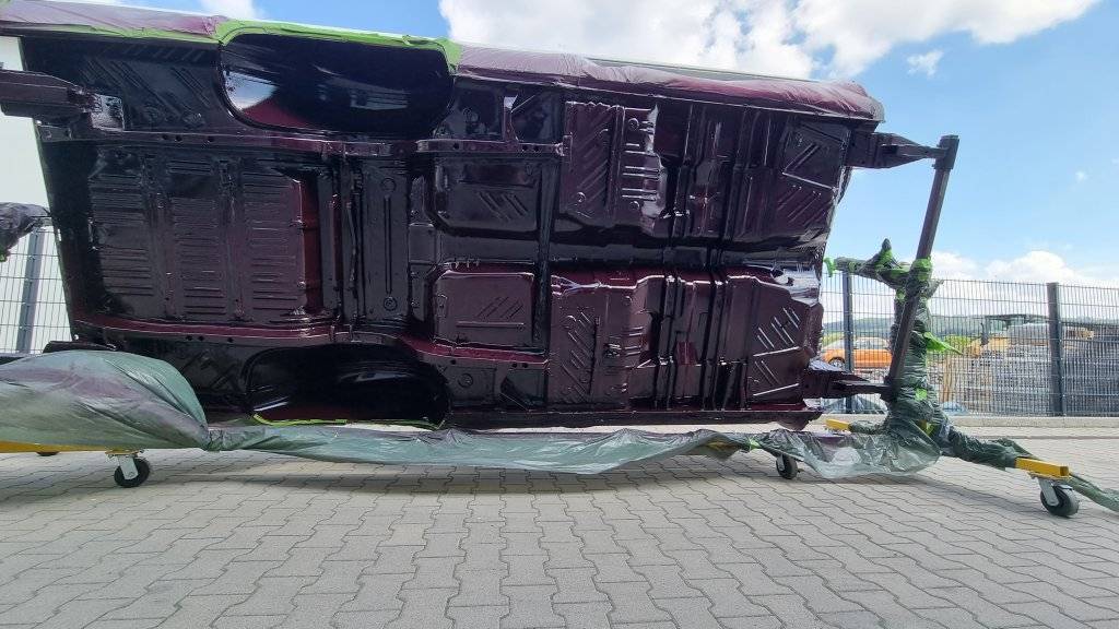

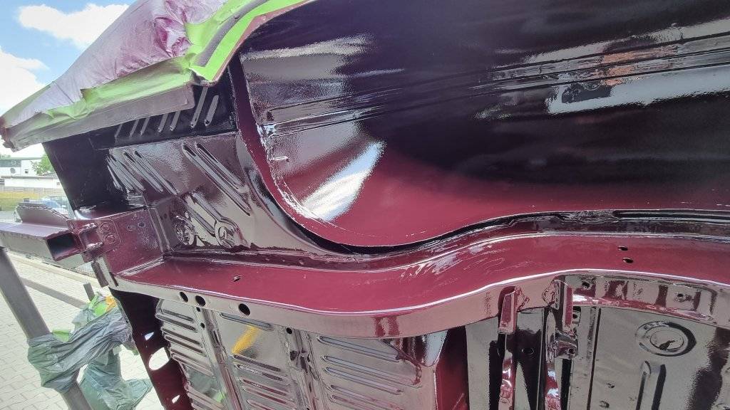

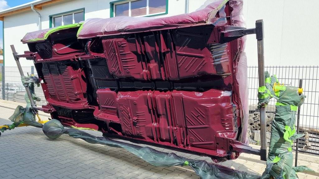

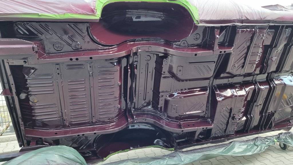

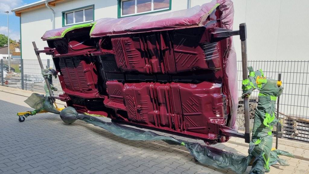

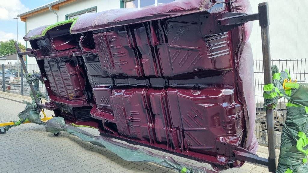

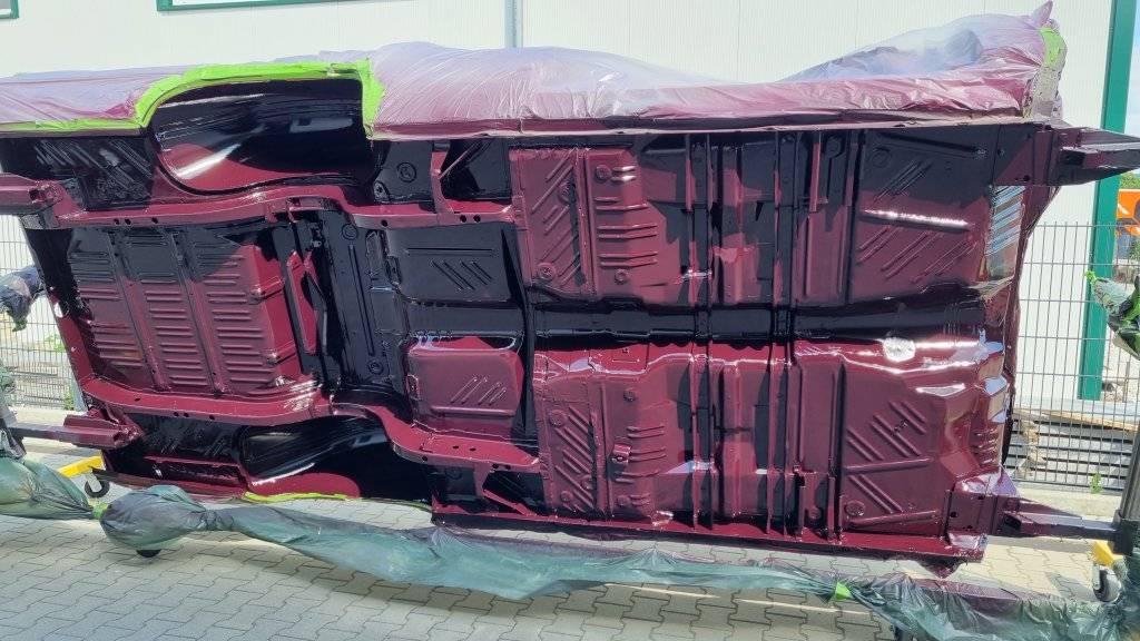

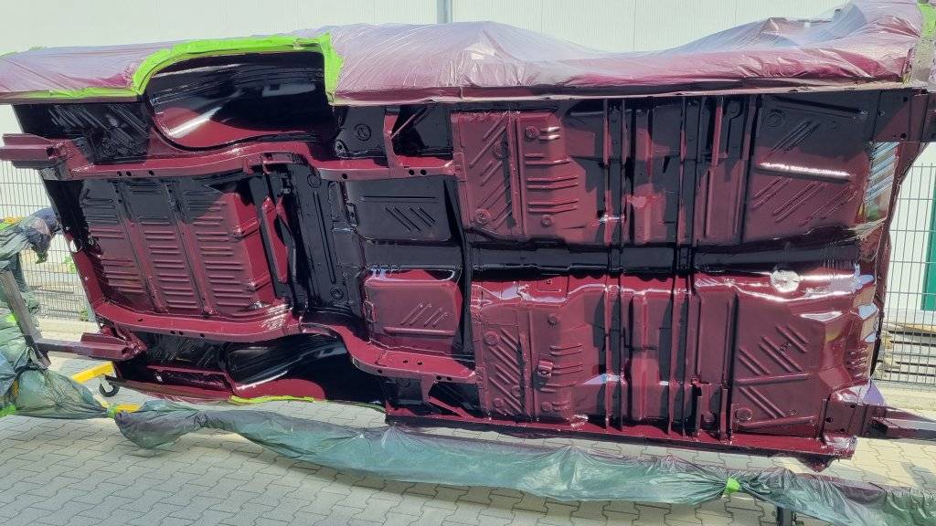

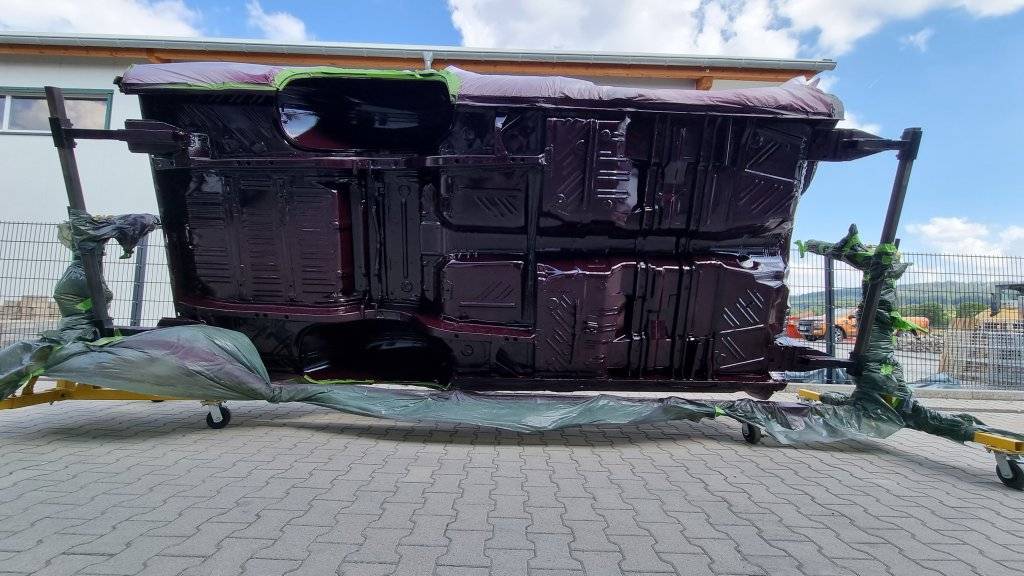

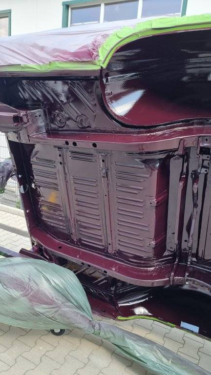

I'm sooooo unsure about the color again. I had the car out in the Sun today and in every light the paint looks totally different.....
But in the sun, the paint looks a little bit "dull?" "feeble?" (I don't know how to descript what I mean exactly) in my opinion. But maybe it looks completely different when perfectly slooth and mirror like on the top of the car...?!
I'm taking the trunk lid to the painter again tomorrow to get a part of it polished and check the paint AGAIN.... :mad::elmer::mob::BangHead::wtf::soapbox::eek:

In one of those pictures I saw the footprints of a fly that must have walked across the underside.
I might be wrong as I was not wearing my glasses and I was standing 20 feet from my computer.
Otherwise it looks nice ............
You are right. But I killed that sob!
Actually....
If it's showing properly on my monitor, I ❤️ the color.
No it's not. The camera can't catch the color correctly. But it looks even better in person!
Every picture of the color looks completely different. And the color on the car looks completely different in any light also... It's a difficult color, but I love it.

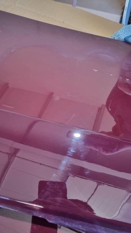

We polished part of the trunk lid this morning and the color is 99% correct!
Even on this picture is looks much more different than it actually is.
It's the slightest amount more bluish (purple), but only if you lay the two pieces on top of each other. Holding them 5 inches away from each other you can't tell the difference.

So the color stays as is! I'm just a little nervous before finishing this huge chapter of the restoration.

What is the paint code? It just doesn't look like a Mopar paint chart color. Looks like it will change appearance in bright sunlight.
It is factory M9 Deep Plum! At least as close as it can be mixed these days since the original paint contains lead, which is not possible to get anymore.
The change of color in bright sunlight you mentioned is what this color does, Bob.

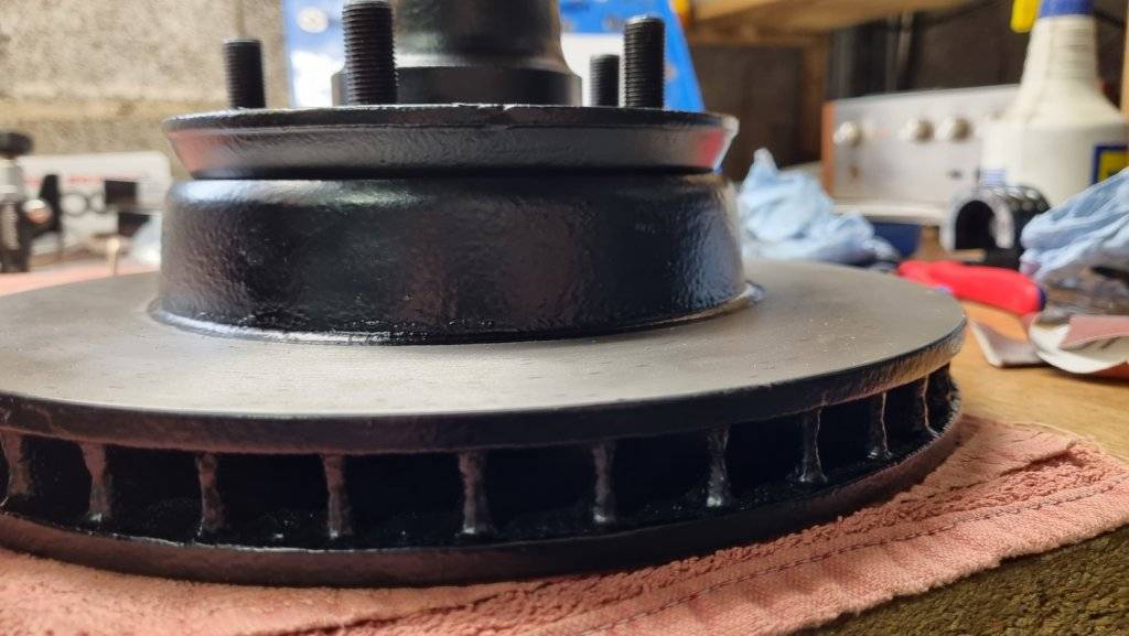

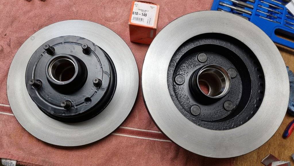

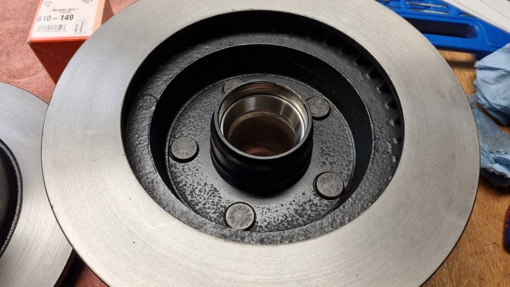

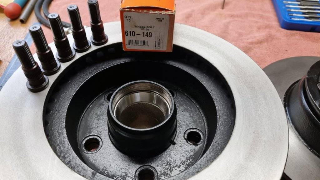

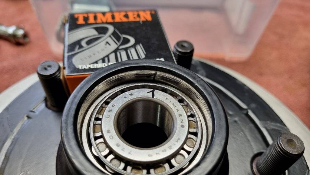

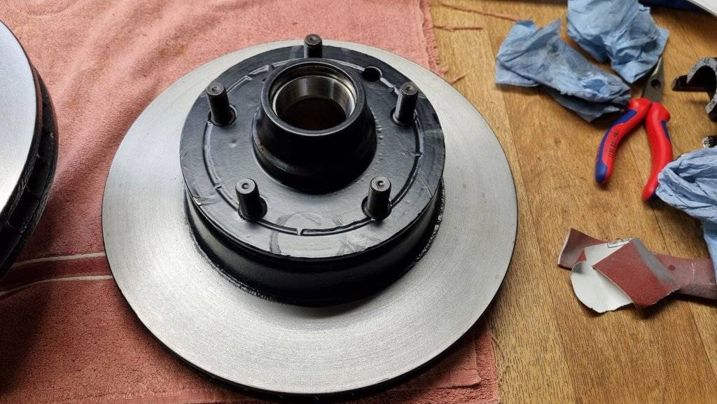

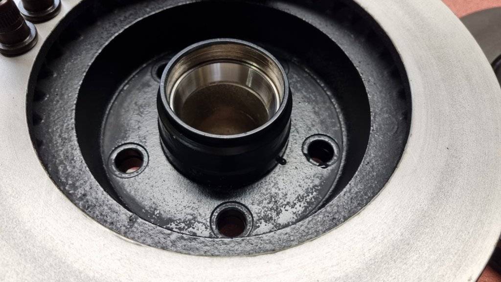

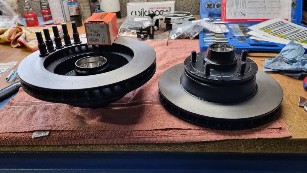

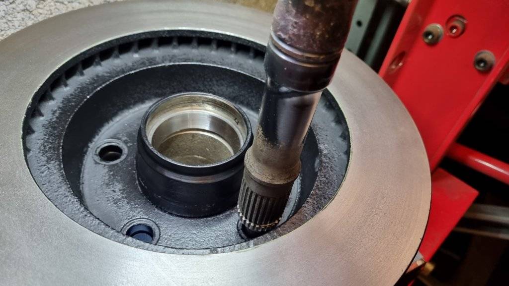

The original Brake Rotors from the '72 Imperial parts car still have plenty of life left in them. So I removed the old wheel studs to separate the Hubs from the Rotors.
The Rotors were immersion derusted, turned, and then painted.

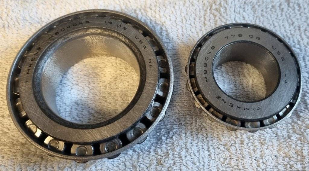

The Hubs were freed from all the old grease packed into them, the old bearing races were punched out, then they were media blasted, zinc plated and then painted and new bearing races were pressed in.

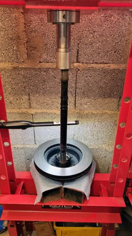

After that, Rotors and Hubs were pressed together again using brand new wheel studs. It took 4400 PSI to press them back together..!
Combines with new Timken bearings, new seals and new dust caps, they are ready to go back onto the car!

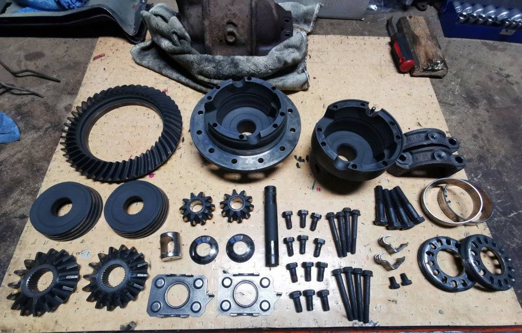

8-3/4 rear Axle 489 Casing Sure Grip Center Section.
PART 1/2
I'm not particularly happy with my knowledge about adjusting the center section correctly.
I have a few Questions and hope someone can answer them.
I bought a book to help me, but I have to say it's not very helpful. :(
Here is my current status:
I've cleaned all the parts, inspected them, painted the case etc.

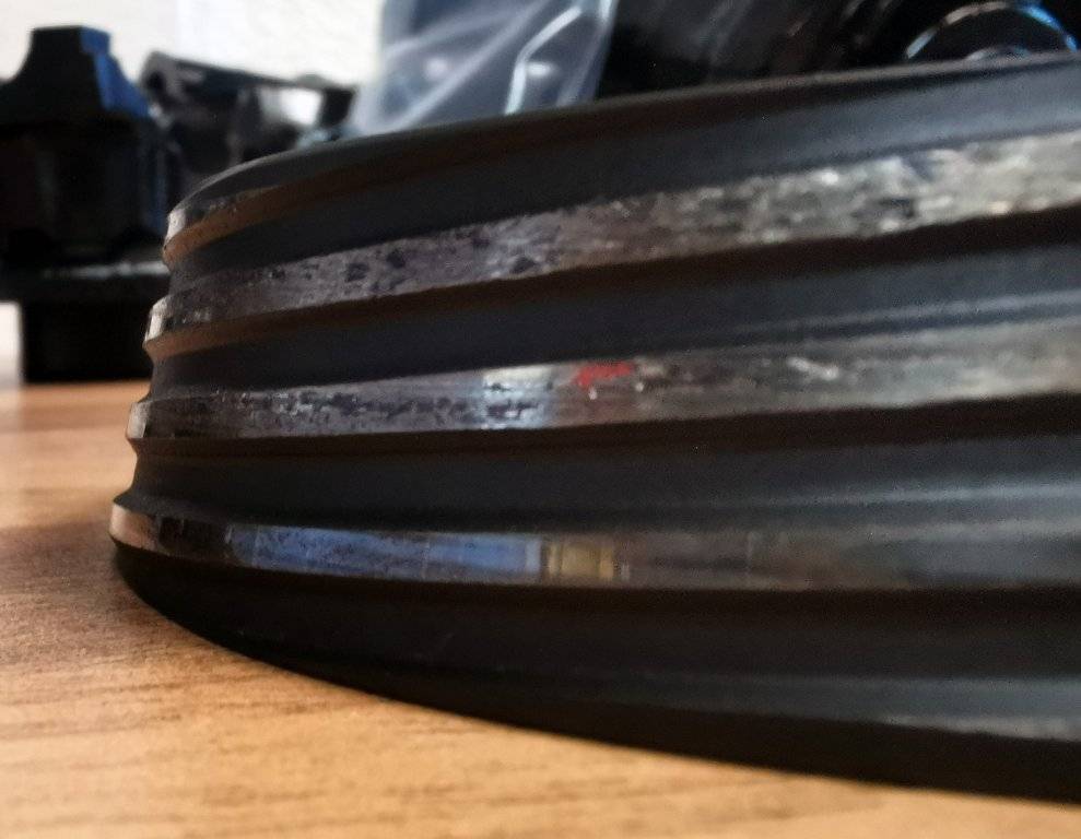

First, I reassembled the sure grip unit without bigger problems.
The cones are in great condition and have plenty of live in them, so I decided to not get them turned and shim them.

I’m going to use Green Bearings when assembling the Axle.
Just recently I've read, that when I do that, I don’t have to use the thrust block in the middle of the sure grip.
Now, my question is, do I HAVE to remove it or is it optional?
If so, I must disassemble the Sure Grip again to remove it…

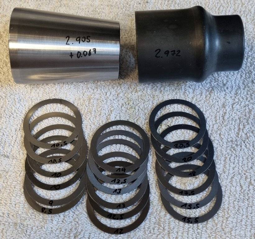

Next was the Crush Sleeve Eliminator’s turn. I measured the old Crush Sleeve and added shims to the Eliminator to get a good starting point for setting up the correct Pinion Depth.
