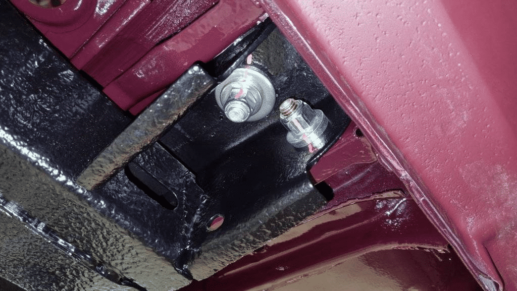

Ok, no, jokes aside. I had one hell of a time adjusting all the sheet metal. What a nightmare...!
The last 4 weeks were hard times for my inner monk! ;)
It's still not perfect, but as good as I could get it on such an old car. Knowing what I know today, I would have made things way differently to achieve a perfect result. But it is what it is now.
I was aiming for a 3mm (.12") gap all around, but hat to go with a 4mm (.16") gap around the doors and to the fenders and a 6mm (.24") gap between the hood and fenders...
The hood is wavey compared to the edge of the fenders as well...
The passender door on the other hand is beyond acceptable. It's crooked in all directions and needs replaced.
My body man and painter did what they could to fix it, but I'm not satisfied with the outcome, so I'm searching for a passenger side door right now..!
But now she is back at the paint shop for the preparation on all parts to get the final paint..!
Driver Side Alignment Pictures:
Interestingly, there were 4 thick shims under the core support on the passenger side and 2 on the driver side from the factory.
Now there is 1 on the passenger side and none on the driver side.
