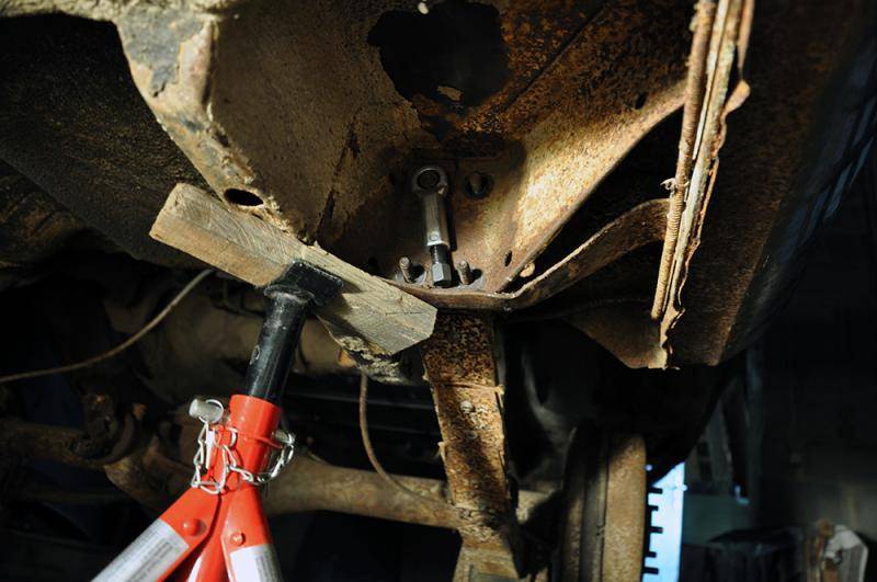

Regarding the best place for jack stands, you can put one under the differential, or two under the springs at the axle.

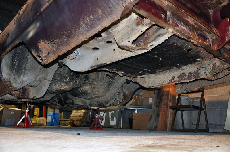

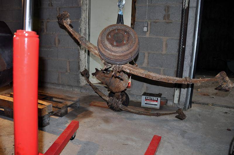

Next going out is the complete rear axle/spring combination ;) Maybe that's enought weight lost on the tail to get the front back down onto the jack stands!
Thanks guys! Found the tool for sale in germany, will buy and try it again!
It definitely will.
It definitely is!

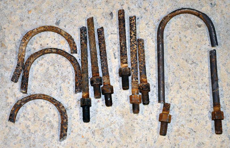

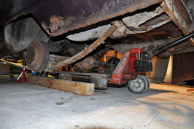

And everything worked out very well. Almost...
Of course, the last bolt slipped. But just one new tool further, the axle came out.
I lifted the axle to remove the nuts on the u bolts. But the first broke instantly. Because of this and because I'm planing to put in lowering blocks anyway, I cut the u bolts off.
