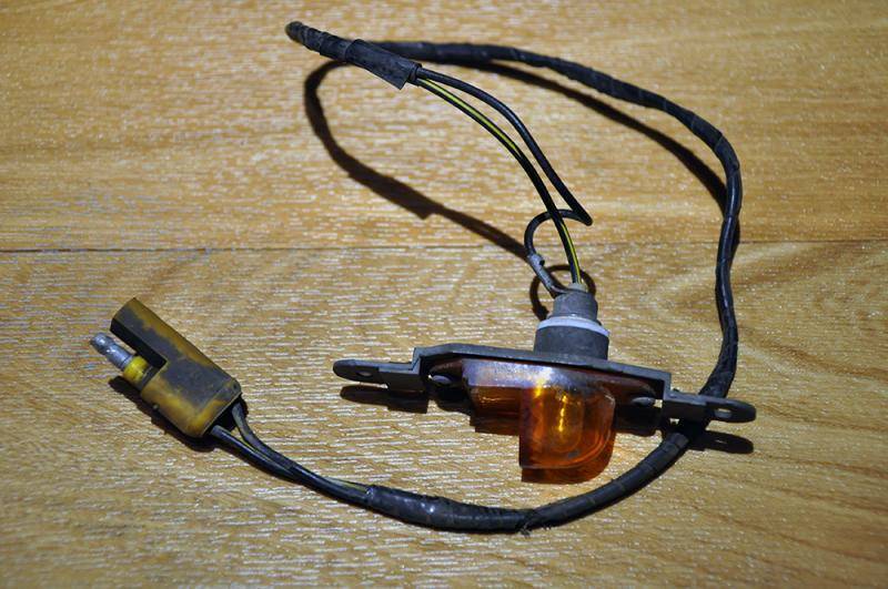

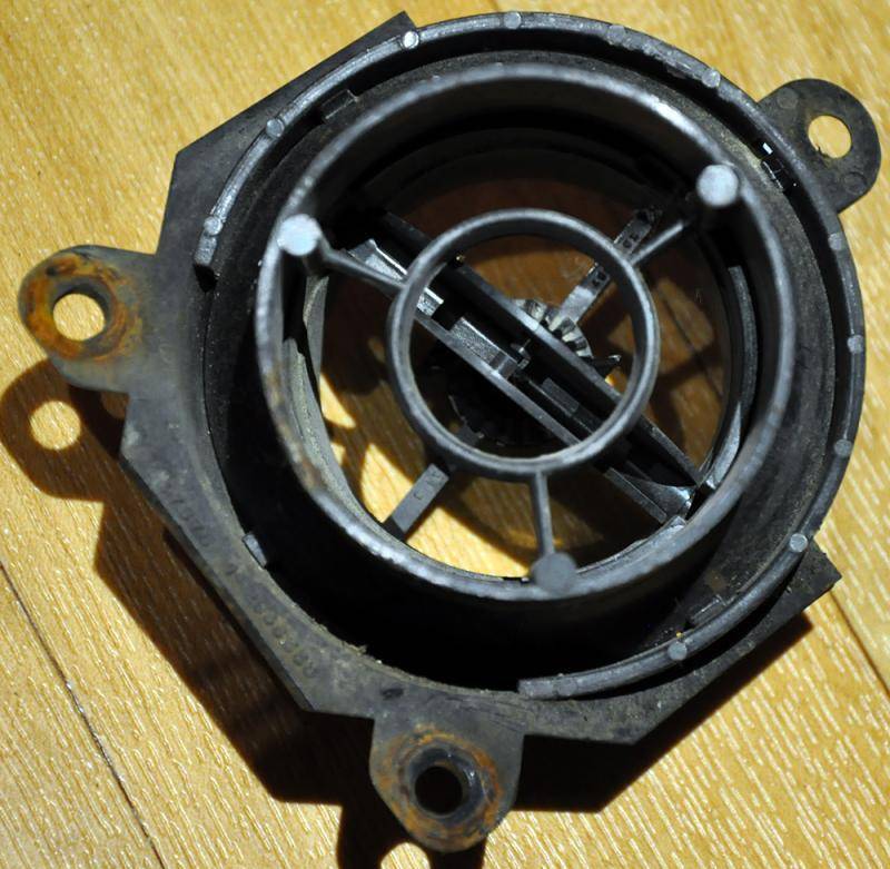

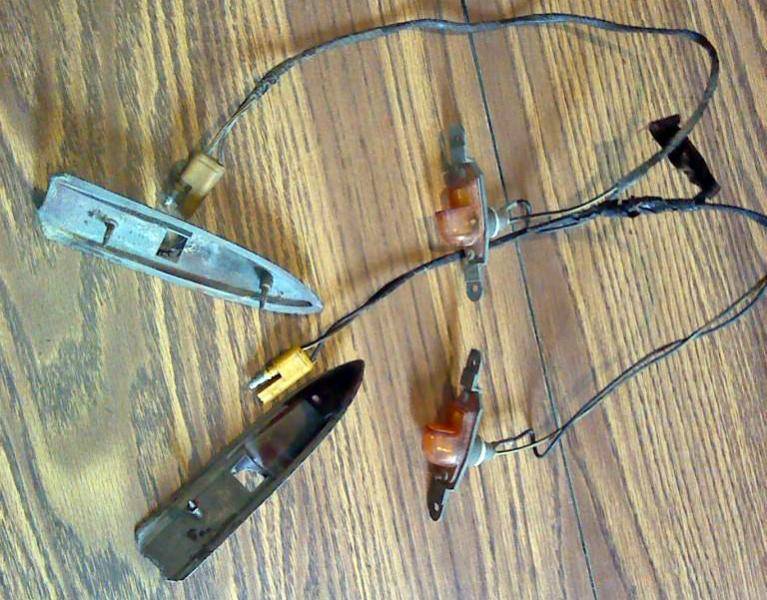

I got a package with spare parts from a 70 Imp from sublime 68rr (thanks again for the parts). The outer dash vents and two fender mounted turn signals.

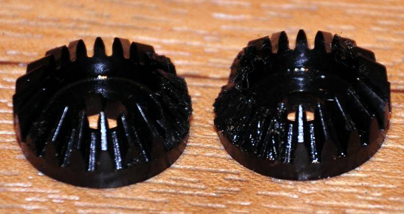

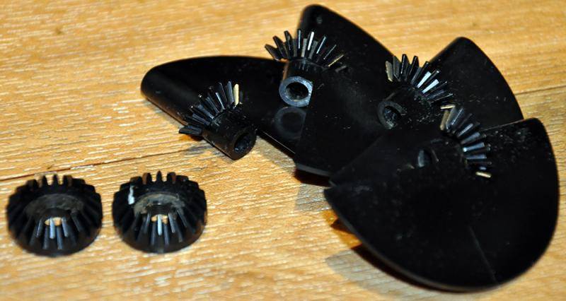

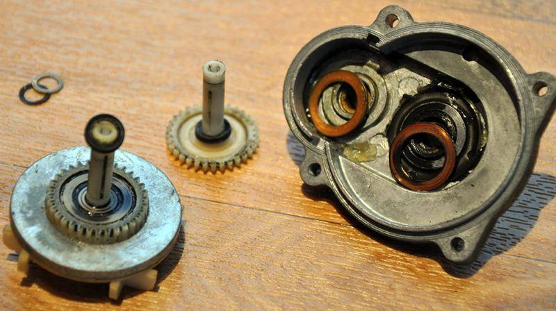

On my vents, the little gears to open and shut the doors were eaten by rodents:
All I needed from the spare vents to repair mine:
Assembly pending because I'm searching for the right felt to go around the rotating sphere...
(Thanks to sublime 68rr)

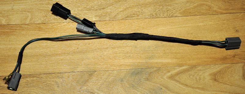

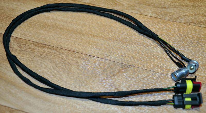

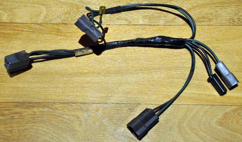

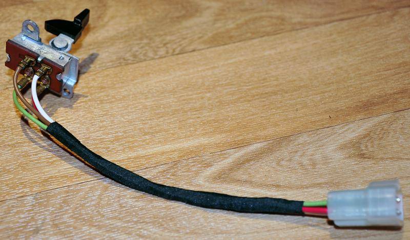

All of the wires on them were rotten and eaten, so I had to renew them. I cant find new connectors so I used the old ones, cleaned them, removed the old wires and soldered new ones to the old connectors. I'm going to replace all old, outdated connectors in the engine bay with modern weather pack connectors.
fendermountedturnsignals02.jpgfendermountedturnsignals03.jpgfendermountedturnsignals04.jpgfendermountedturnsignals05.jpg

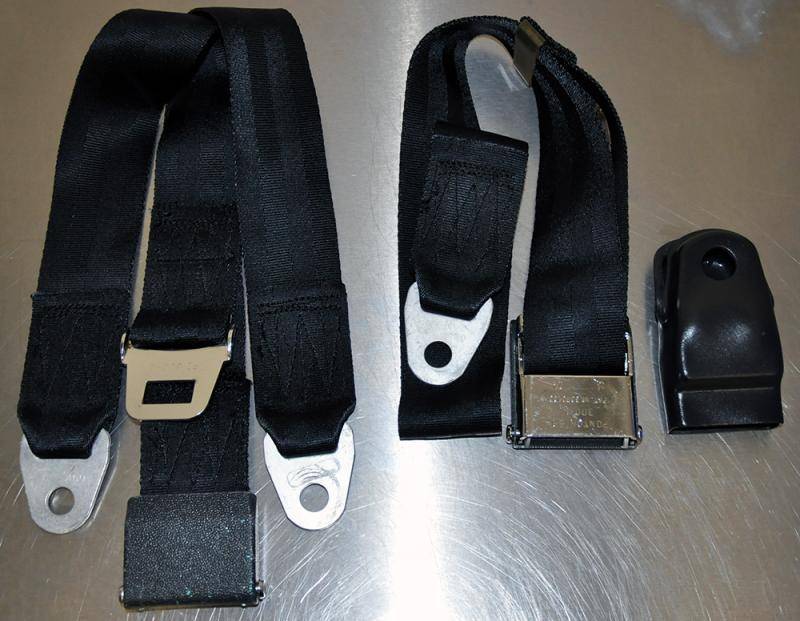

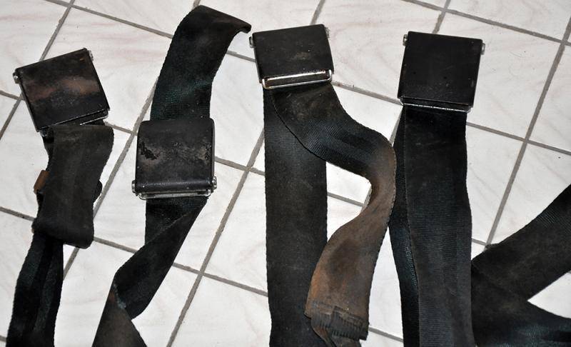

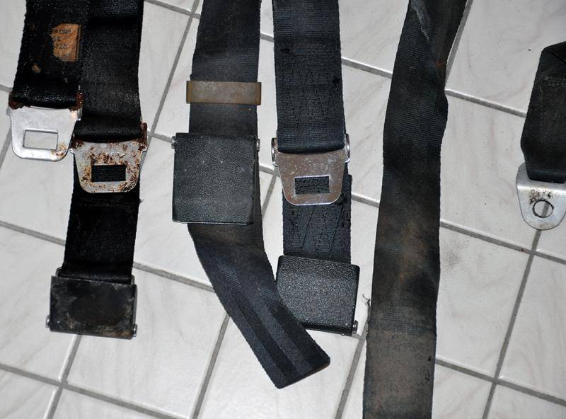

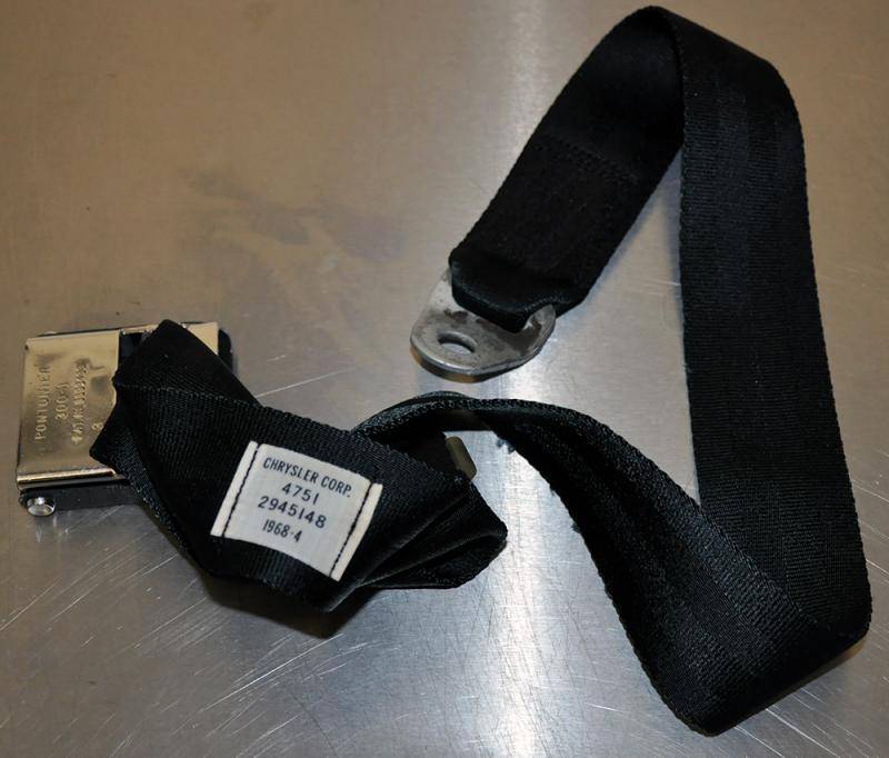

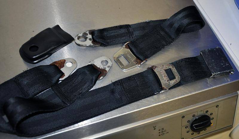

I bought laundry net bags to separate the seat belts in order to wash them in the washing machine.
They were nasty, moldy and very stinky but came out pretty awesome and are now smelling like a flower field ;)
Next step is to remove the rust on some of 'em. Hopefully this will work!
seatbelts01.jpgseatbelts02.jpgseatbelts03.jpgseatbelts04.jpgseatbelts05.jpgseatbelts06.jpgseatbelts07.jpg

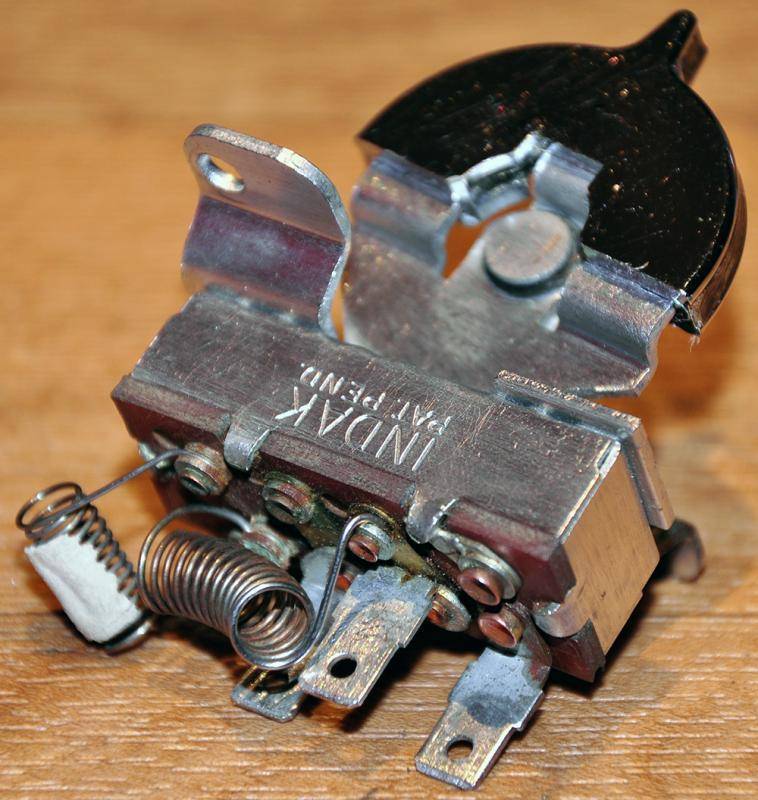

Meanwhile in the livingroom, I cleaned up and rebuild lots of small parts, swiches and cables...

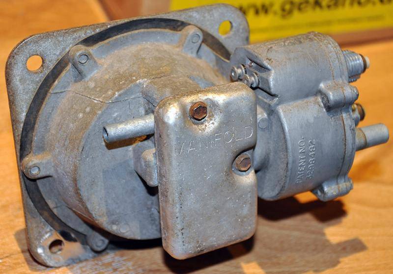

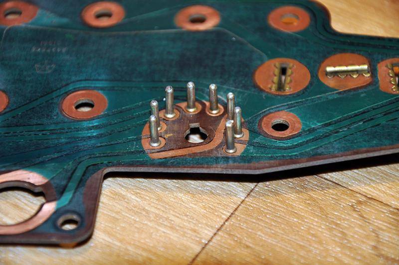

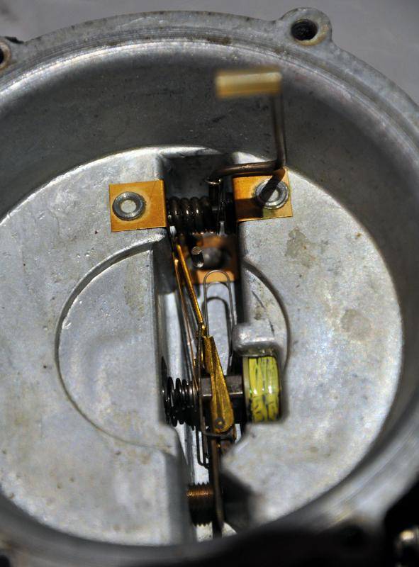

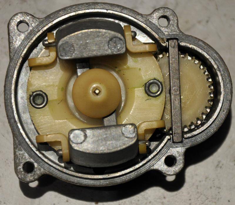

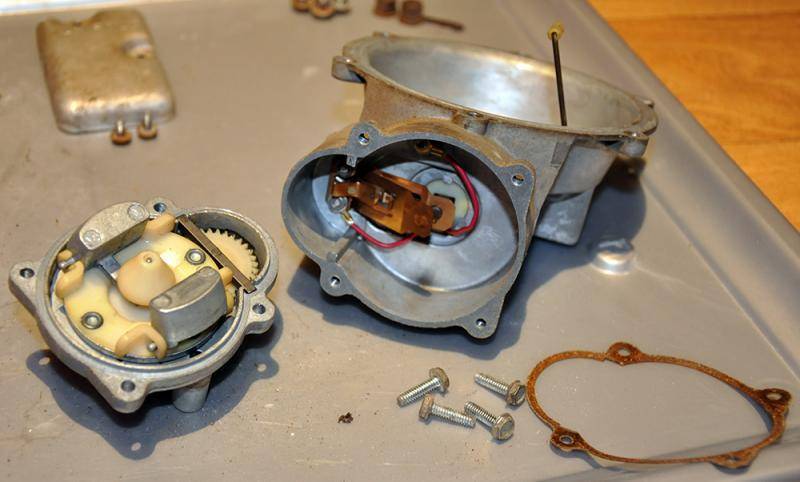

I disassambled the cruise control unit in order to derust and clean it.
Assembly pending becasue I ordered the right grease (I hope) to grease the gears.

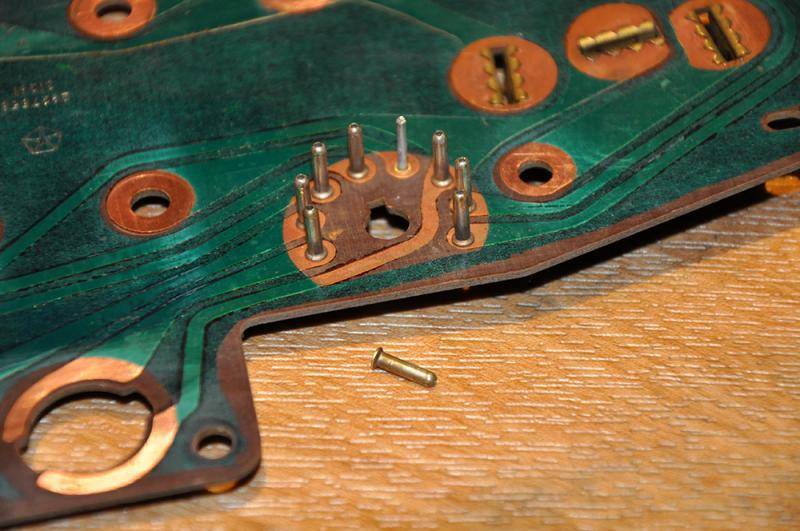

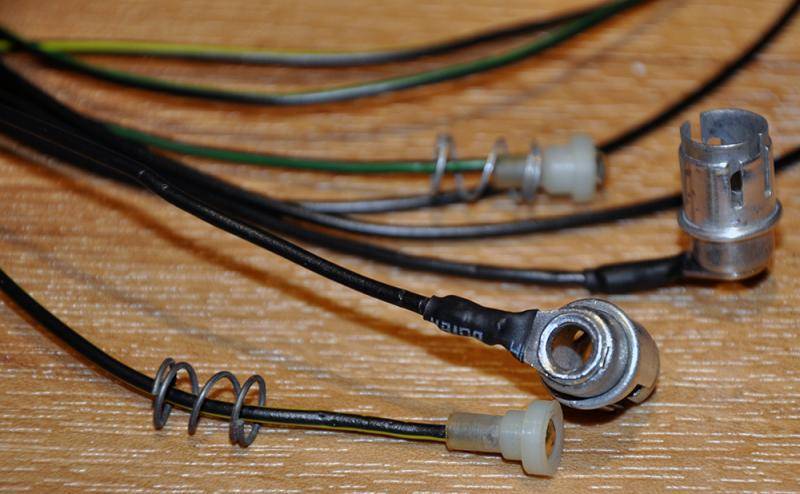

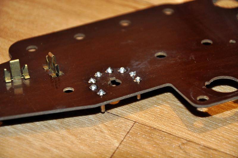

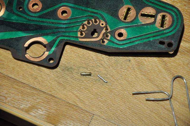

One last thing. I had a broken off pin on the circuit board... I fixed and enforced all of them with a paper clip.

I have a couple boards like that with busted pins and never knew how to fix them. Is that aluminum wire that you soldered into the open hole first then slid over the pin?
