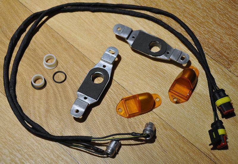

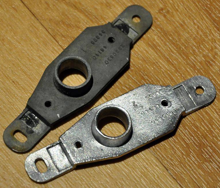

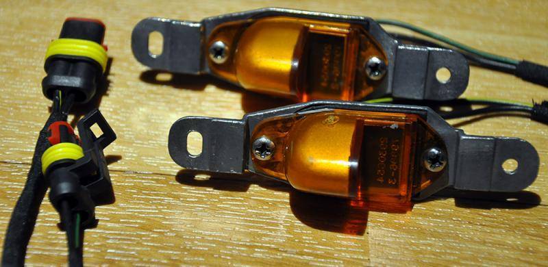

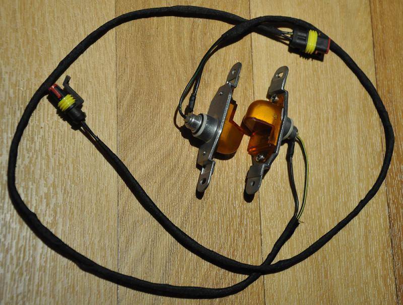

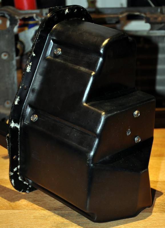

With making seals by myself, I finished the fender mounted turn signals.
I had the different senses from the 70 spare parts, but decided to keep the original 69 ones.

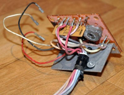

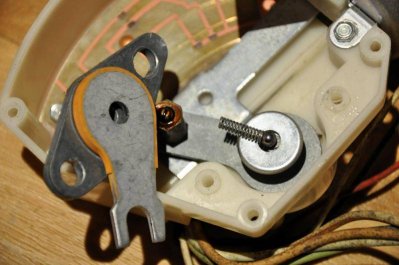

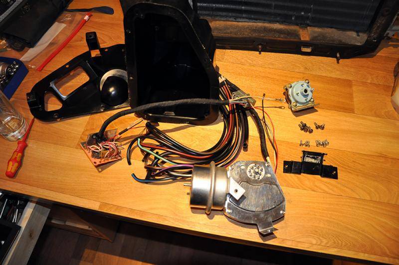

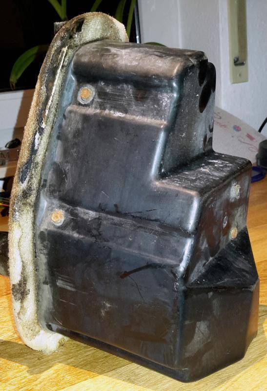

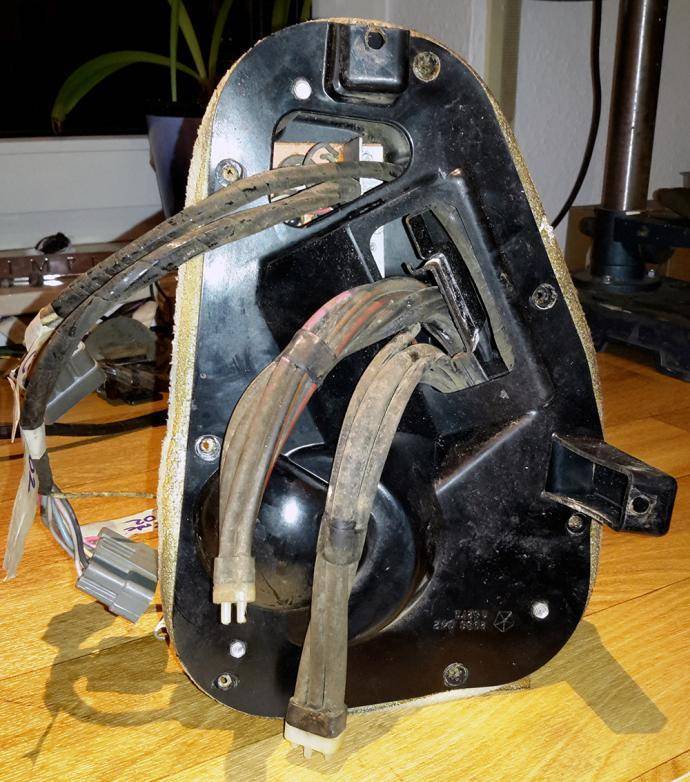

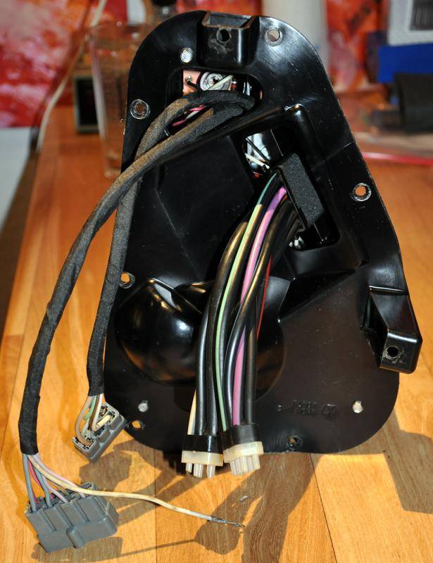

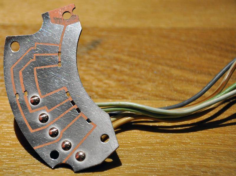

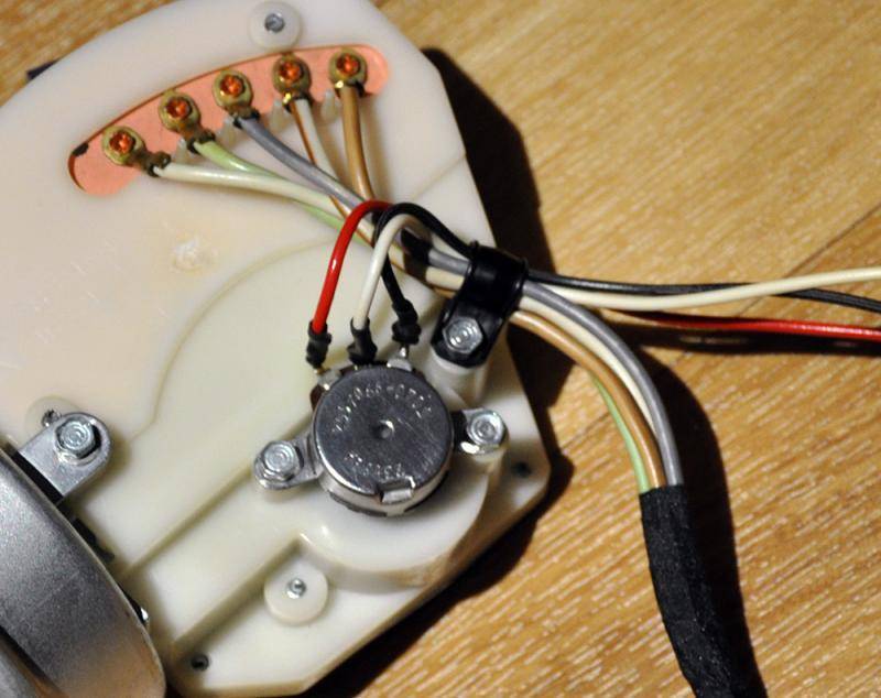

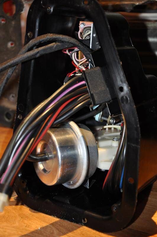

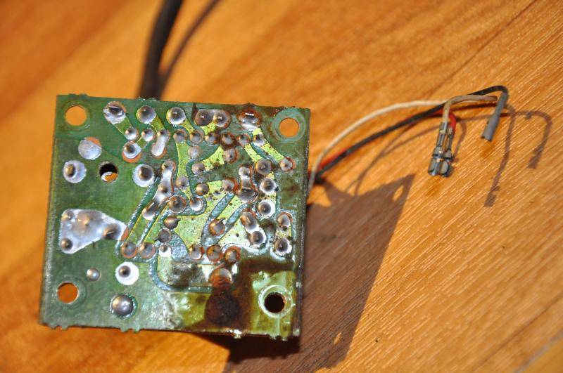

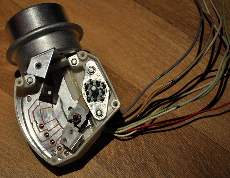

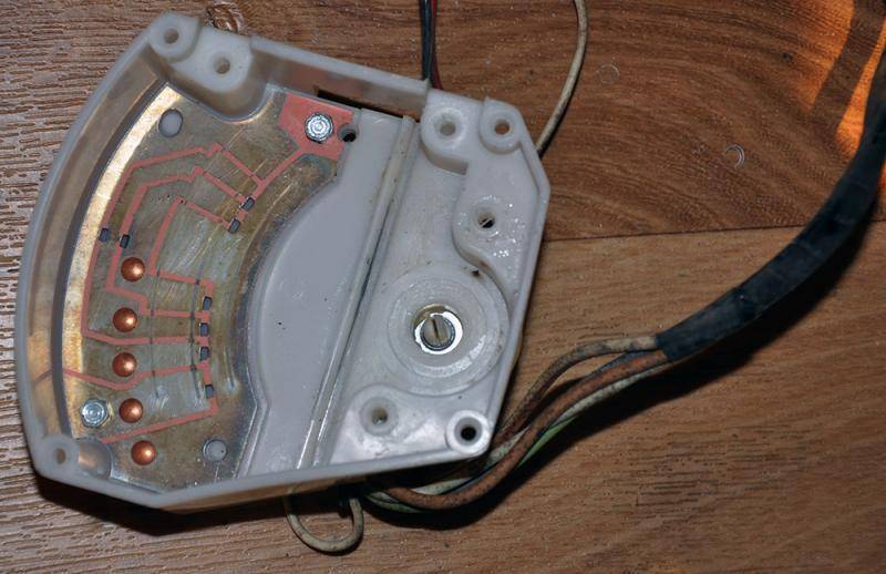

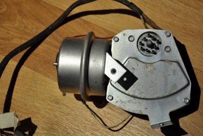

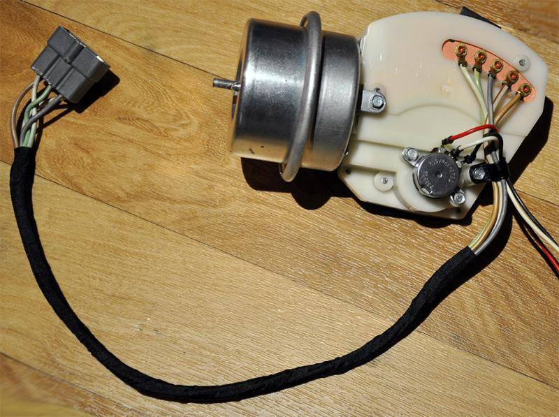

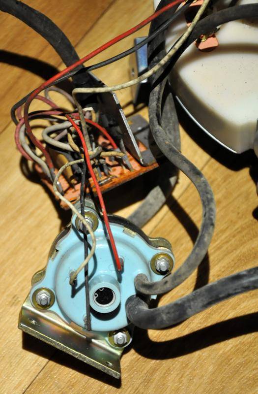

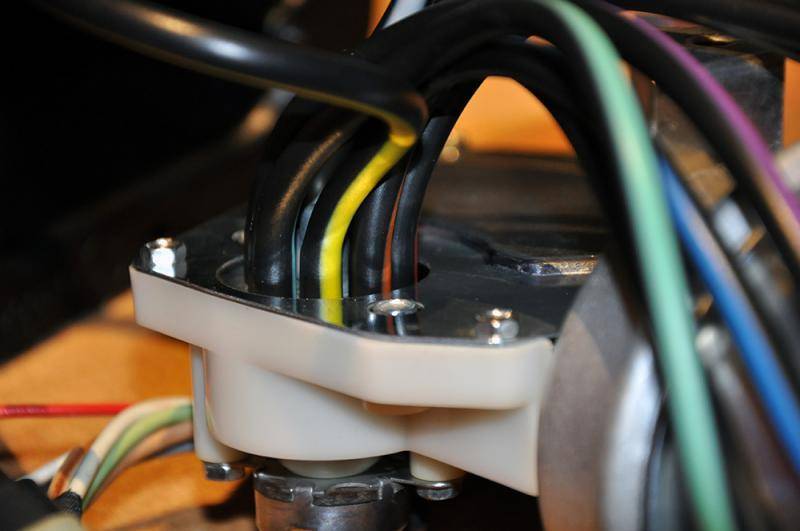

And I started overhaulin the HVAC. First part of it done is the Auto Temp Confrol Unit Assembly.
That thing was hasty and stinky... There was a rodent nest inside the box...
Pretty interesting "technology" Chrysler build there. Confusing, but interesting!

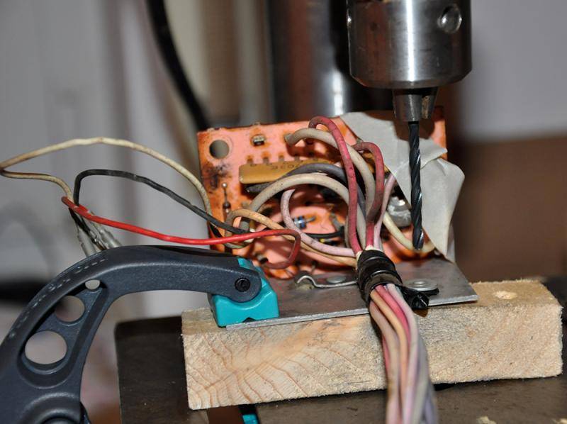

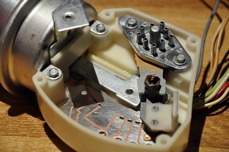

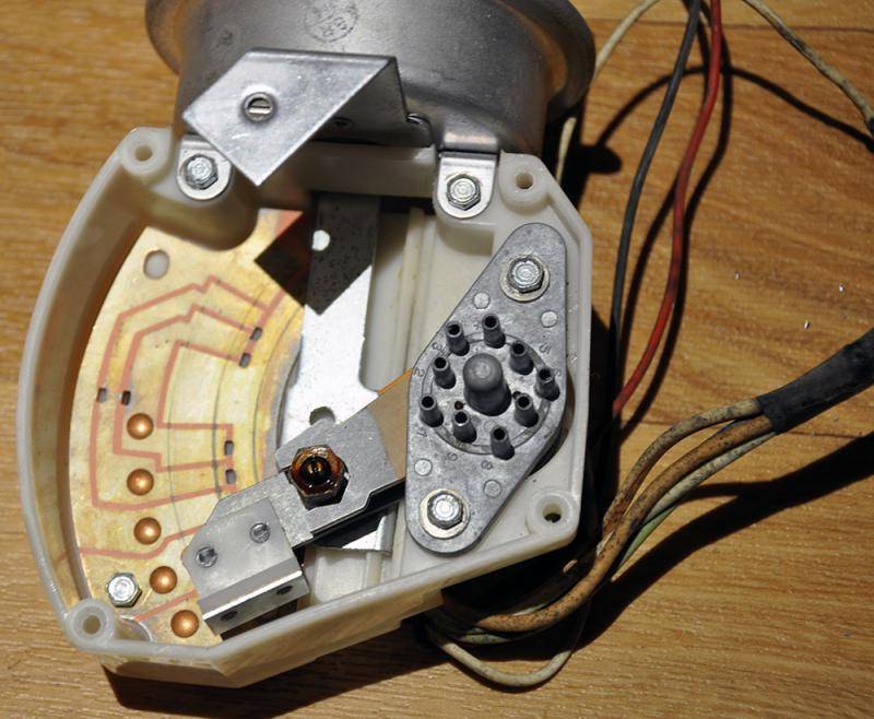

The circuit board was bad... But I tried the best without removing all the single components soldered onto the board.
