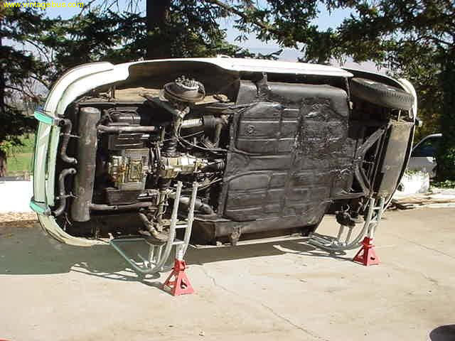

Here is something a friend of mine came across that you could build yourself. This is one variation, I've seen others:
That's kool, I'd like to have me one of those^^^^^.
I've seen all the alternatives, but most of them I don't trust and the one in the pictures requires the suspension parts.
In the german mopar board, a member have build a wooden structure bolted to the seatbolts from the inside. But on a dart... I'm not happy with the risk of my car laying on the roof. Would complicate the whole project...
A '70 Challenger hood is only 60 lbs so I can't see an Imperial hood being a heck of a lot more than that.
Good point. I plan on doing this one side at a time. I bought the largest jack I could afford with a 20 inch lift. I will use a series of stands to lift it on edge. if I sit on the ground with my legs crossed I should be able to reach to the center of the car.
That was my first idea as well, but since the car is on 4 jack stands, I realized it will not work zhat way. Besides the fact that I'm not willing to climb around in the car just sitting on stands. Especially in the trunk.
