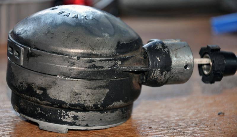

Ok, I can't access to the drive assambly on this motor, the cover is pressed on and "bent" together. For a good reason I guess...
Thanks to the shipping company, the mast is bent on every step, means this power antenna is junk, because you can't remove the nylon cable from the drive to replace the mast.
But I decided not to put a power antenna back on the car anyway. I prefer the clean look without an antenna. I will remove the hole in the fender and install a hidden antenna under the headliner.

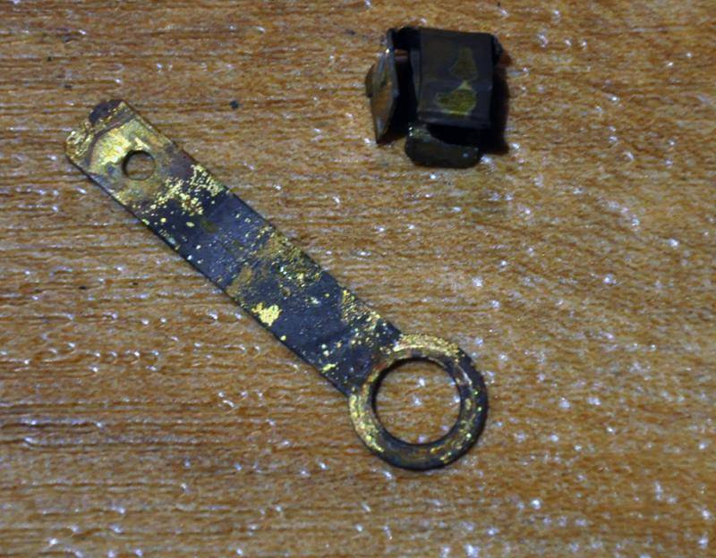

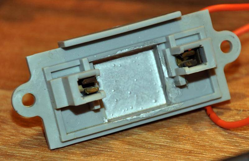

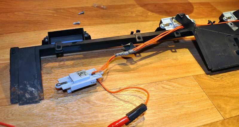

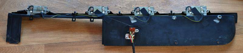

Here is a smaller update. First I just wanted to keep the original Dash illumination. I initially thought all bulbs were just shot, but I found out that the 2 piece sockets were to coroded to lead current anymore.
Dashboard - Illumination 01.jpgDashboard - Illumination 04.jpgDashboard - Illumination 08.jpg

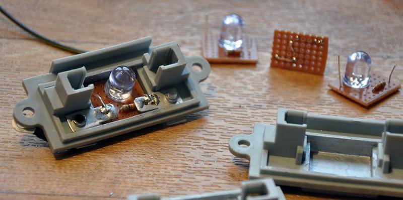

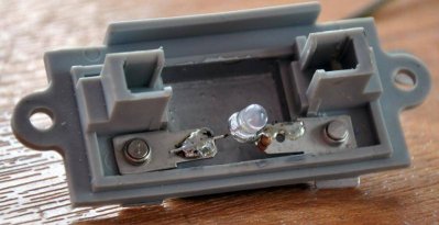

It was not possible to separate the two pieces without breaking them. So I decided to switch to LEDs. I modified the plastic holders by drilling holes into them and used rivets and new connectors to make new contacts.
Dashboard - Illumination 20.jpgDashboard - Illumination 40.jpgDashboard - Illumination 17.jpg

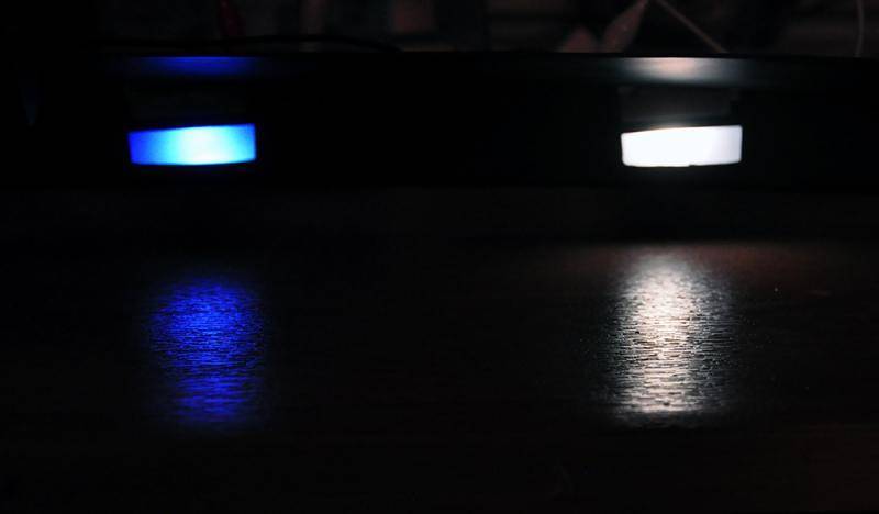

This 5mm LED was my first attempt, but is was ugly and cold white (6500°K). The color temperature of the LED throught the filters made it look blue.

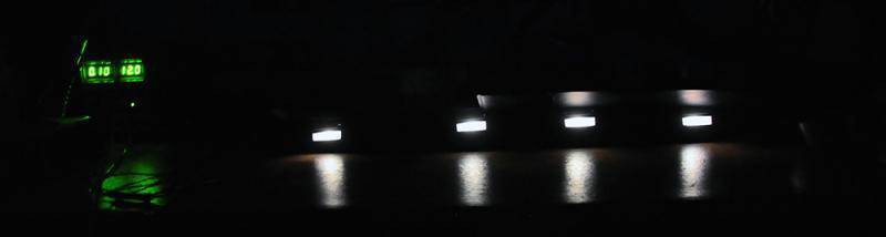

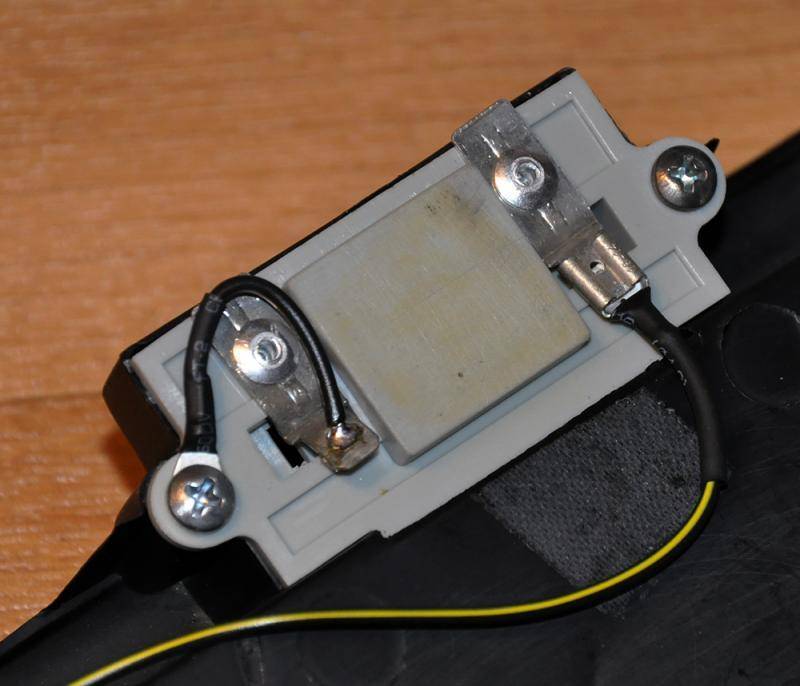

So I bought a perfboard and used neutral white (4000°K) 10mm LEDs instead.

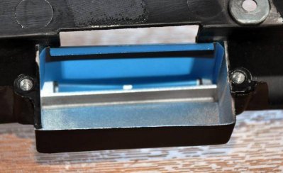

Because the new lights were a little bit darker then the originals, I sprayed the housings silver to brighten them up.

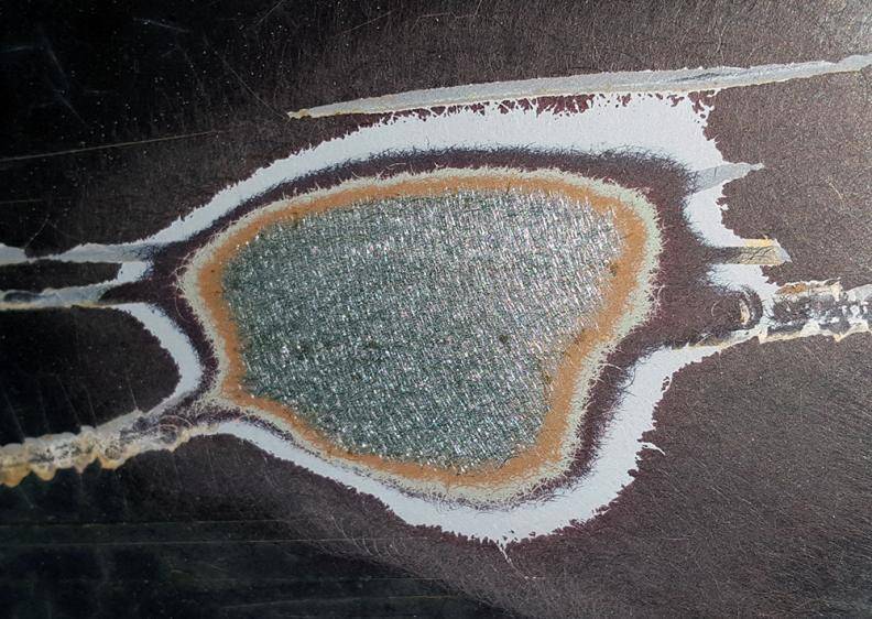

Today I started sanding and found more layers then I've expected.
I'm counting 5 layers of paint. Is this the factory amount of layers?
I also found a lot of bondo, but no welding seams so far. Could that be factory? I've read about Chrysler using bondo from the factory on some of the big panels?!

The car should have originally had three layers of paint so it looks like it was primered and painted again sometime in its life. Maybe the bondo was done then.
