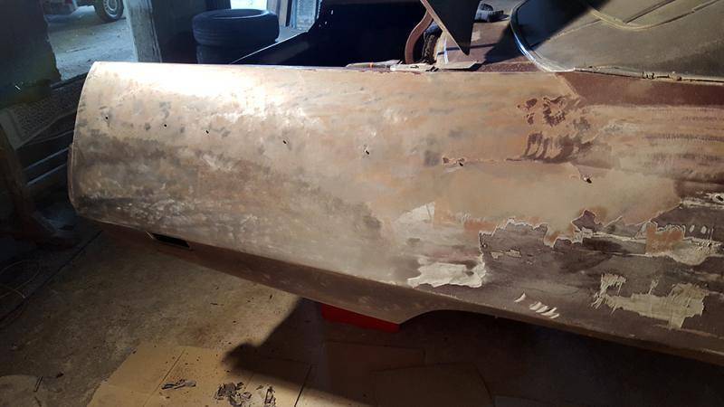

I have cracks with white layers shining through all over the right door and quarter panel and white "bondo worms" coming through tiny holes inside the door skin that would indicate a repaired passenger side damage!

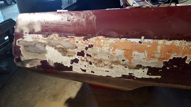

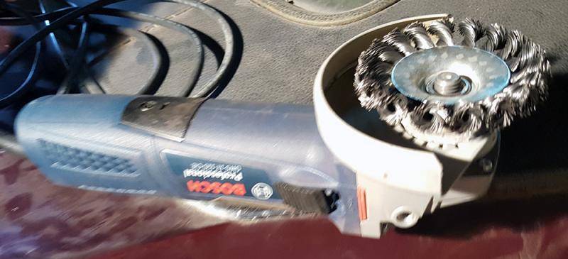

That's exactly what I did today! I bought 3 twisted wire wheels for my angle grinder on Ebay for just 12€ (http://r.ebay.com/E6WGw5)
It doesn't have two directions but it worked very well all the time!
I started with an untouched area and it was harder to do than on the areas where I put the stripper yesterday. It's not a good paint stripper as a single solution, but softened the paint so that I could remove the paint much easier.
That's what happens when you try to scratch down the paint stripper with a blade.

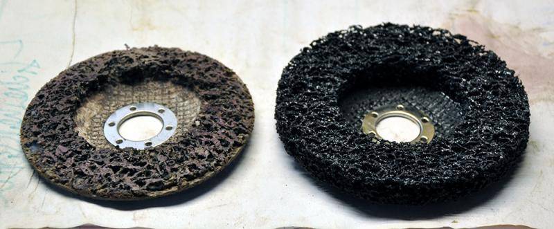

The wire wheel is time consuming, but at least it works!
I ordered the black cookies today and will try them as well but I'm pretty happy with my first days result!

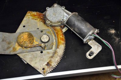

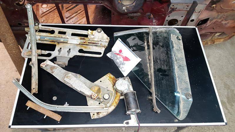

Man, removing the rear quarter window, the guides and the regulator is a bi*ch...! I finally made it but I have absolutely no clue how to get everything back in there and assembled again!
How do I remove the motor from the regulator without killing me?
Something like that should do the trick. Just clamp down the two levers of the regulator connected and under pressure by the spring, then remove the motor.
I thought so too, but after removing the motor, I still have two pieces under spring pressure I need separate.
The most obvious way was the easiest..! I just removed the spring carefully from the holdback pin with a pair of pliers. Safe 'n' easy ;)
About paint removal. I'm absolutely amazed about these "cookies". It took halt the time then with the wire wheel!
They consume up pretty quickly tho.
For us guys near a Garbage Freight, these cookies are also $4.00 each like the ebay listing.
But no shipping. The ebay guy wants 18 bucks.

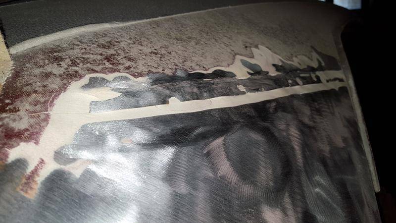

The normal paint is really easy to remove, but the finger thick bondo eats up the cookies pretty quick. But I made good progress today, at least until I had to learn that the protective cover on an angle grinder is there for a reason... The cut is, lets say bad to the bone... -_-

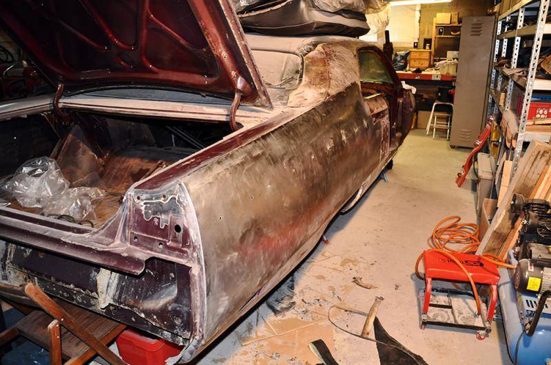

Is this messy butchering job on the roof seam factory work?
