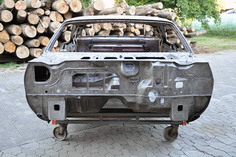

Don't sandblast again. You remove good metal every time you media blast. After the compressor is fixed, use a decent dual action sander, strip the rest of that crap off, then metal prep and use a good primer sealer. Too much thinking is going into preventing rust that will never happen in your lifetime.

I feel your pain Julian. But your gaining on it. The body looks pretty solid, no surprises. The time will come when you look back and all that sanding and prep will just be a memory. (This is a time when a lot of guys just give up and lose motivation). Your perseverance is inspireing. That Imperial WILL live again.
As I said, I'm no painter, but I've never seen a good shop put anything like that on before priming.
We can all give you our half-assed advice, but we do have a painter/bodyman here... Ask Azblackhemi (Chris) what to do. I'm sure he can guide you.
Yep!
Use the "brunex" product over the light surface rust. (if it's truly like a POR 15 designed to act as a sealer.) Don't sand/sandblast again. You're thinning the metal each time.
In the PPG product line, DP 40, 50, etc. Would be your first step on bare metal. I'm sure there is a German eqivilant.
"PRODUCT DESCRIPTION Chromate-Free 2K Epoxy Surfacer DP40 Surfacer D834 DP402 Hardener D835 DP40 is a versatile 2K Epoxy Surfacer. It is light grey in colour, chromate-free and has good corrosion resistance over bare metal.
DP40 has good adhesion to a wide variety of suitably prepared substrates. These include bare and galvanised steel, aluminium, GRP and fibreglass, painted surfaces and fillers, and a wide range of plastic substrates"
Por type paints are not too good on any sanded/blasted steel. Etching primer is what needs put on bare metal after a wax and grease remover then the epoxy primer or at least a sealer to keep any of that weird crap from surfacing later. UPOL makes a good etching primer and it is made in Europe. My 2 cents FWIW if Chris chimes in and says my info no good listen to him.
Thanks Guys for your suggestions! It would be great if Chris could add his two cents! I will pm him and ask if he would do that! But you missed the point that the damn Fertan stuff had to go first, so I sanded it off as far as I could, but in the tight spots I can't reach with the excenter, I mediablasted it with glass bead abrasive. No harm to the metal at all! It just removed the old paint and loose surface rust, but nothing else.
