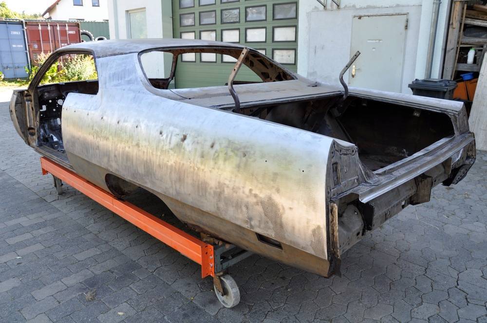

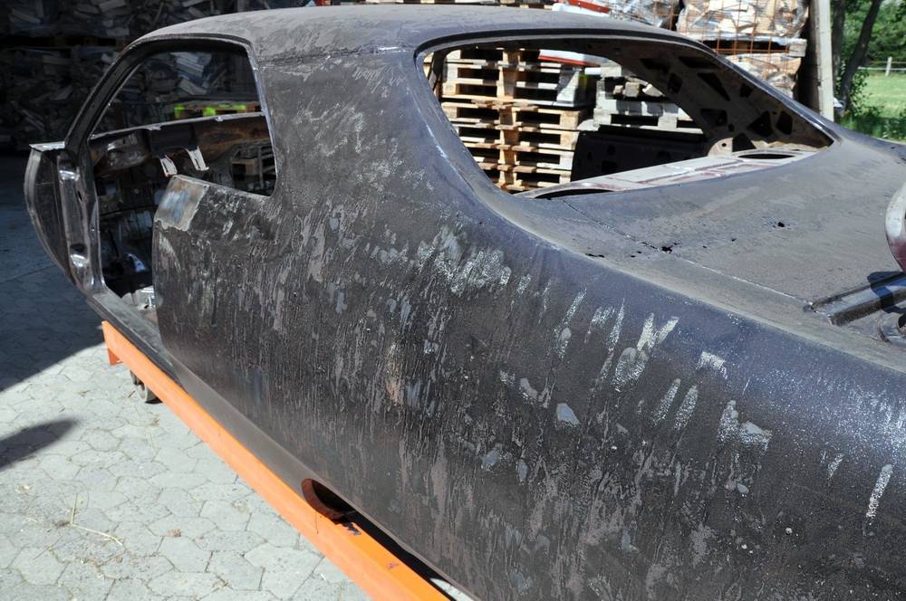

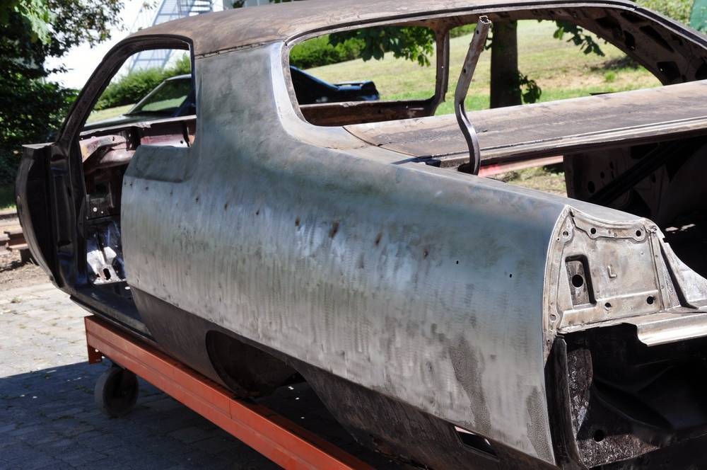

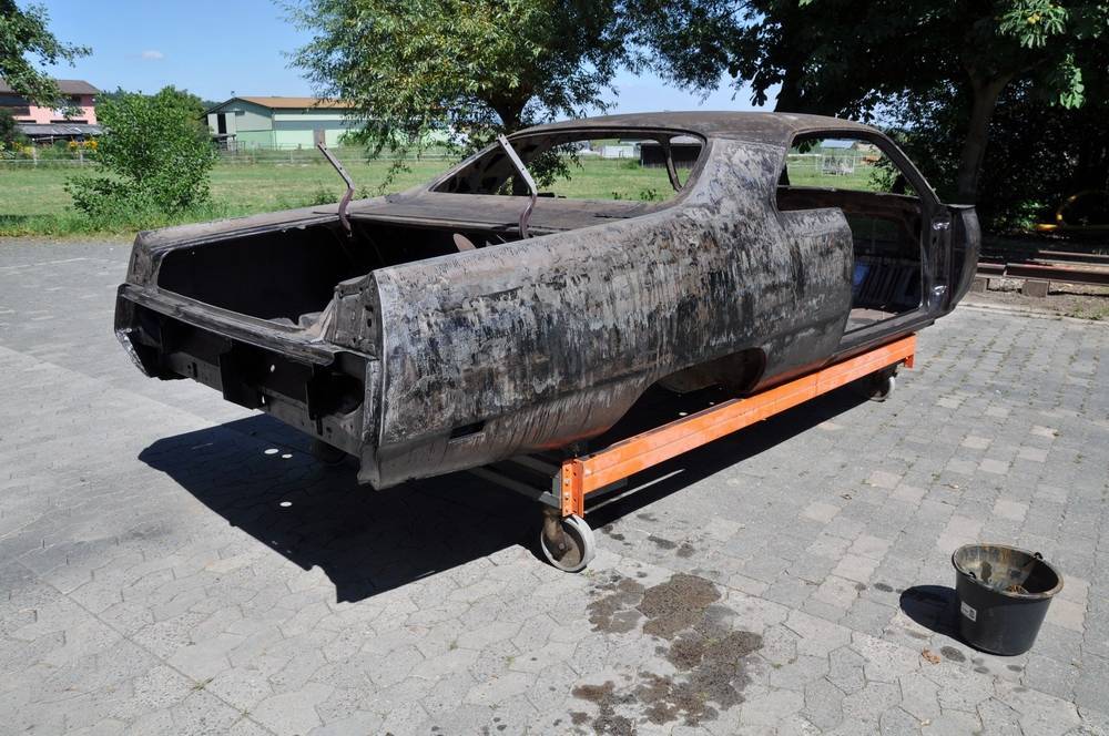

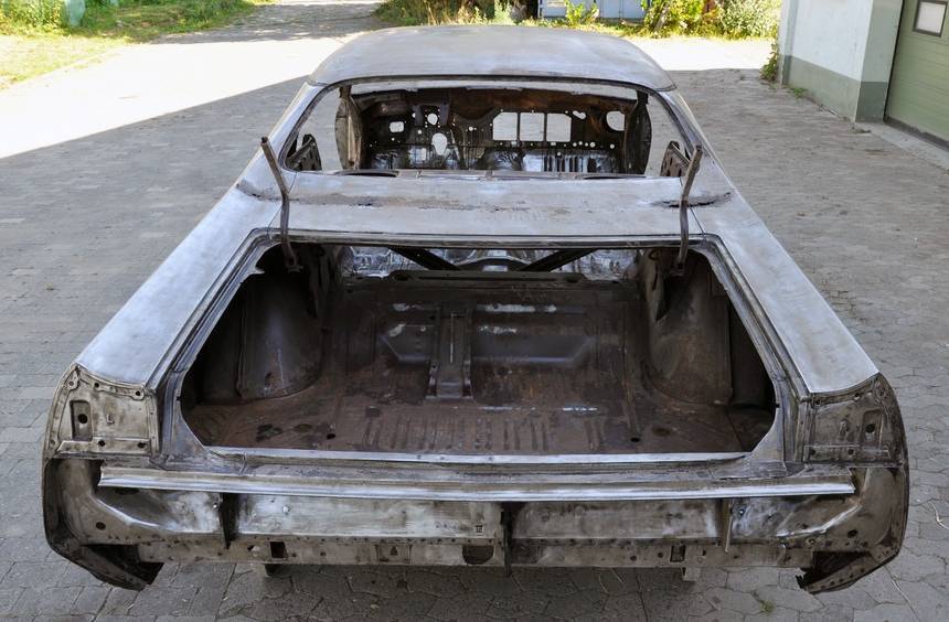

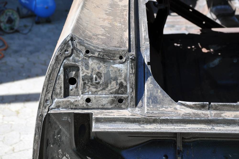

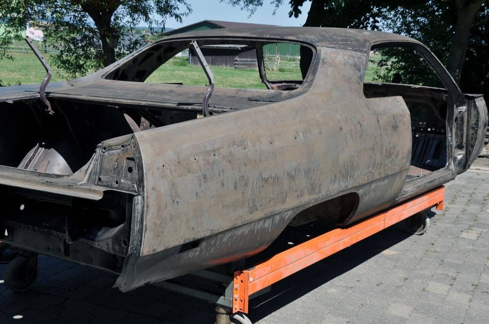

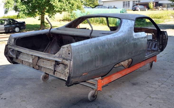

Ok Guys, long time since the last update. I was way to frustrated this summer and decided to let it sit for a while and start all over again with new motivation instead of working on the body with too much frustration...
Here's the reason why:
The rust converting, pretoctive coating failed completely... The whole body had surface rust or even worst underneath the Fertan coating.
Instead, the unprotected sheet metal inside the car had no rust at all... I had better left the car in bare metal over the winter instead of using the Fertan stuff... What a bummer this was when I saw the car in spring.
But enought time passed without working on the car so I started sanding and grinding the whole car AGAIN last week. At least until my air compressor blow up and I had to order parts for it...
As soon as the air compressor is fixed, I will sandblast everything AGAIN and when the car is in bare metal again, I will use the next coating and hope this will be it this time. It's called Brunox and is similar to POR15, but designed to be the first layer of paint underneath the spray filler. So it stays on forever.
Man, sanding sucks...
That's it for now. More when the air compressor is working again and I do make more progress.
