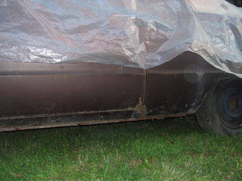

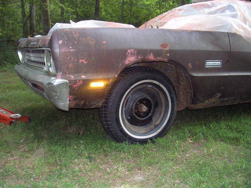

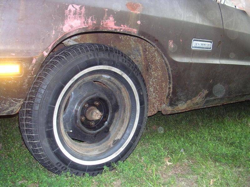

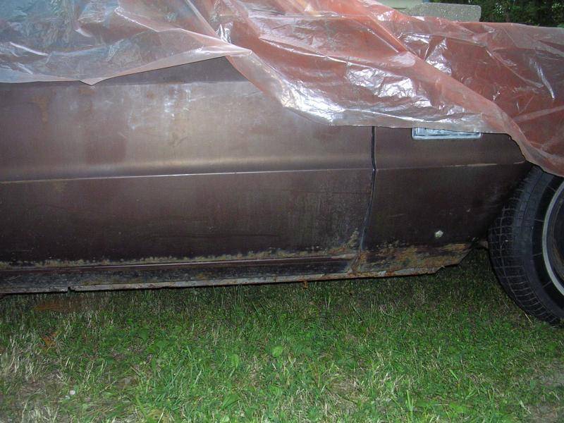

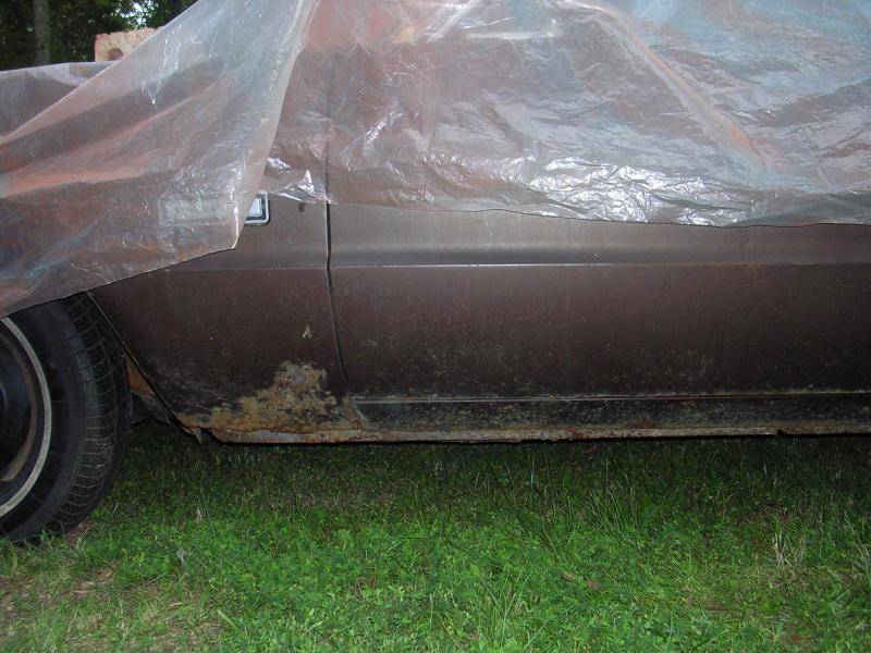

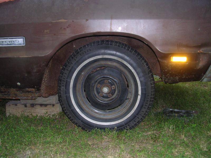

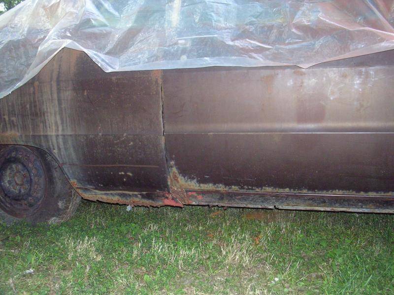

Aidan, firstly congrats. You have a VERY, VERY rare and desirable car. From the last photo the rubber mat looks wonderful. Save it at all costs!
I understand why some on this board are afraid of a car with rust, which this car has. The talk of a "re-body" is a joke. There is absolutely no need for that. If you have to pay someone by the hour ($ 75-125) to do the metal work it can become costly. Learn how to weld, fab and replace. Easier said than done, but you can do it. The car looks very restoreable, and a worthy car to do so.
BTW the VON of the car , and it's SPD is "in line" with the other two known special order examples.
Good luck, keep posting.
BTW, I have some of the parts you may need.
Best regards,
FP

I think the car is restorable, because the 2 sub frames look OK. Given the statistics from other members of 30 PK21K9 cars made and three known to exist, the car is certainly worth doing. Someone here with a body book can tell you whether 41 model c-pillars, under rear windshield area, and quarters can be used as patch panels. If so, there are plenty of cars out there that could be donors, even if your aussie cars don't have the right parts. I have dealt with a guy in Summerville Georgia named Frank Parks 706-857-2832. He is a commercial vendor and very knowledgeable on c-bodies. He can tell you what fits and he has lots of parts cars, if you're missing something.
My book shows 132,565 total PE41, PL41, and PM41 cars made in 1969 (Fury 1, 2, and 3 models). If they're donors, you certainly can find a car to donate parts. Even if 21 model cars are unique, my book still shows 4971 PE21 Fury 1 and 3268 PL21 Fury 2 cars made in 1969 (Fury 3 didn't come as a 21). It'll take a lot more digging, but somebody's got one of those cars for parts. In addition, if 1970 and 71 PE21 and PL21 cars can donate parts, you may find the needed parts from one of them in somebody's bone yard.
Overall, glad to have the car at my home in Virginia and glad to help you get it to Australia for restoration. Cheers, Ben
So what do you do?? Remove all the unique cop items only and transfer them over to an look alike donor car?
I think I wasn't clear.
What I meant was the only alternative to tackling the job was to rebody and I find that unacceptable myself. I'm against it.
GODSPEED in your efforts.
