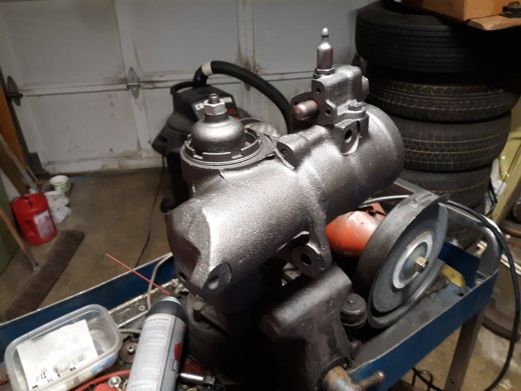

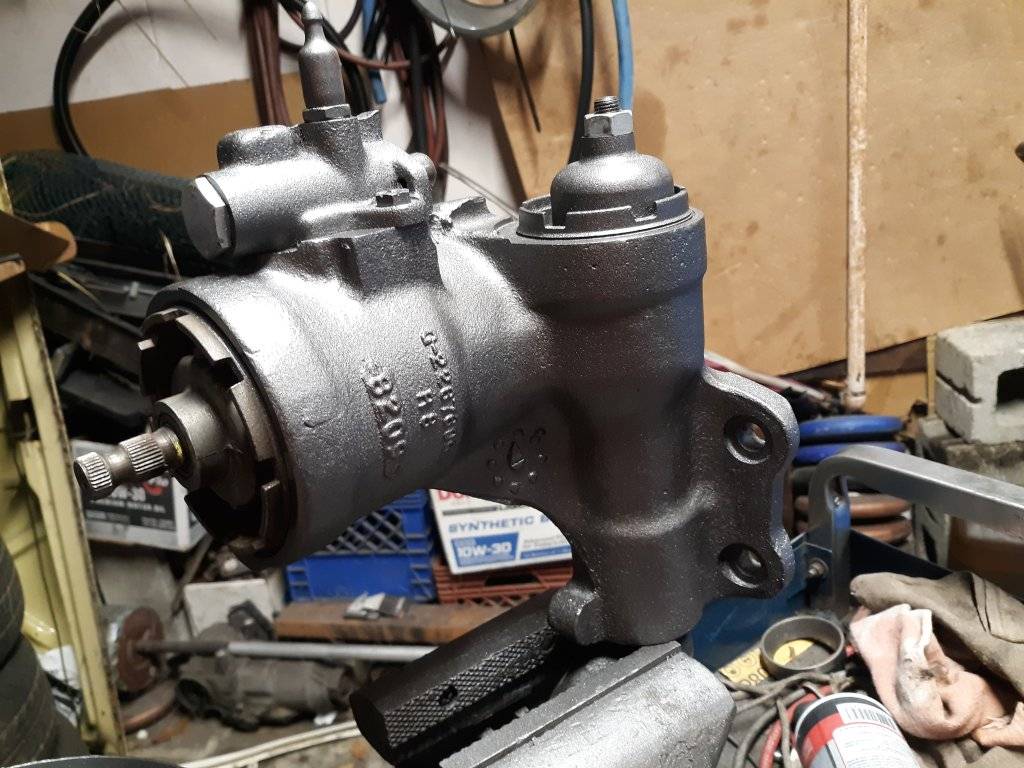

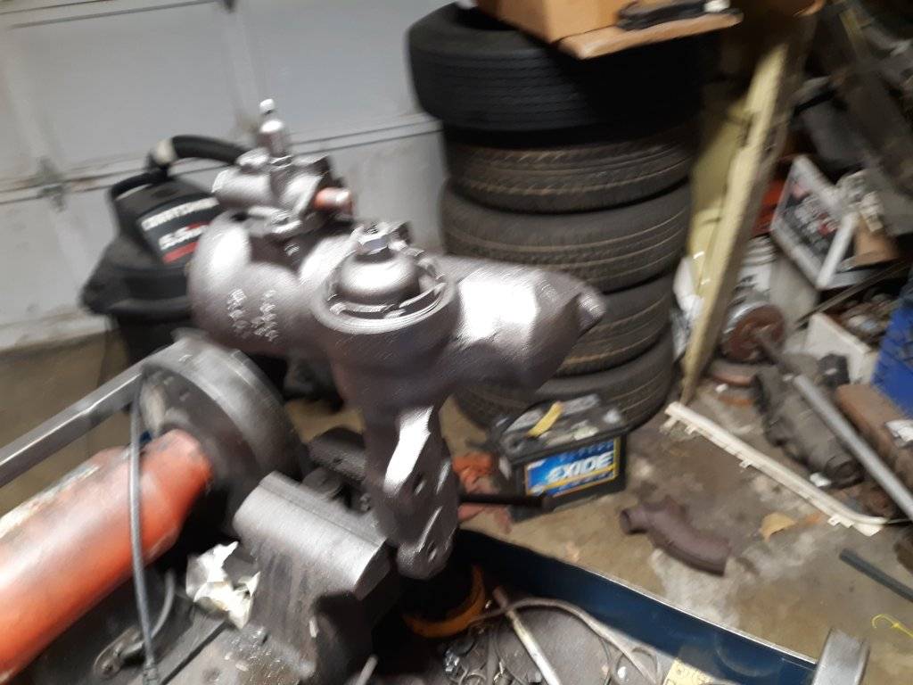

Here is the final product. I chose Rust-oleum Color Universal Advanced Formula Flat Soft Iron. I liked the low gloss color. Check the pics.
