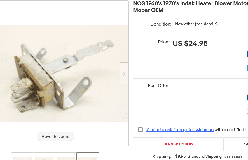

I really appreciate the info guys. So the blower resistor block is on the blower switch as in pic below? I have the huge OEM 8 track deluxe stereo beneath the heater/ac controls, so I can't get a hand on the heater control or even see it. I'm sure I'll break a bunch of things removing the stereo. The wiring is pretty bad from previous owners splicing and overloading circuits which I fixed back to OEM, but probably didn't get all of them since I don't know much about circuitry.

View attachment 495377 View attachment 495378

Pretty sure your second picture is just the switch and the blower motor resistor is located on the heater box

Well I finally tried it. Jumped a wire directly to battery and lots of air and no noise. So blower is fine. Thanjk you John for saving me time and work. So I think Davea is correct and its the switch. Anyone know the easiest way to get the switch out? If not, how do you get the switch out?
You will need to pull the heater control out of the dash, it is held in by two bolts on the back side. Once that is done, the switch can be unbolted from the unit.
