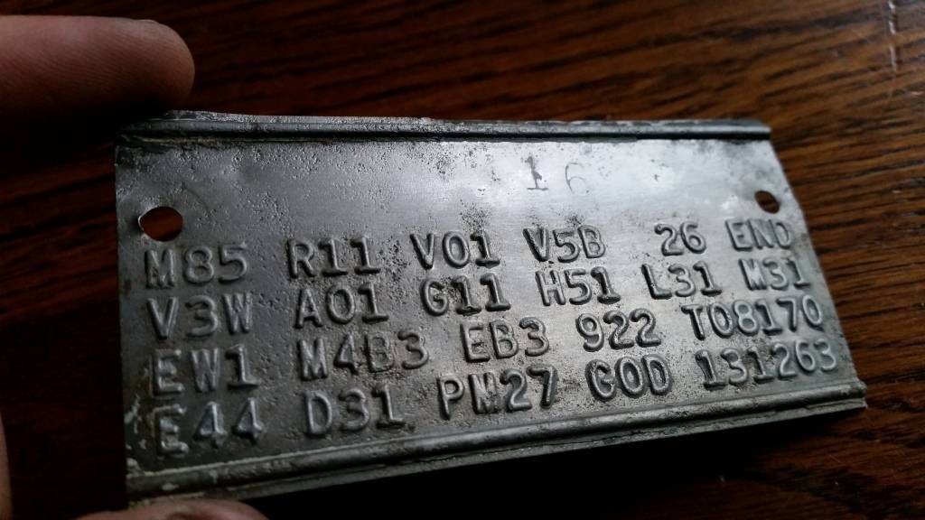

I also cleaned the fender tag. First go with a little media blaster gun.
I can read it without glasses or flipping it over now! Anyone know what the 16 at the top means?

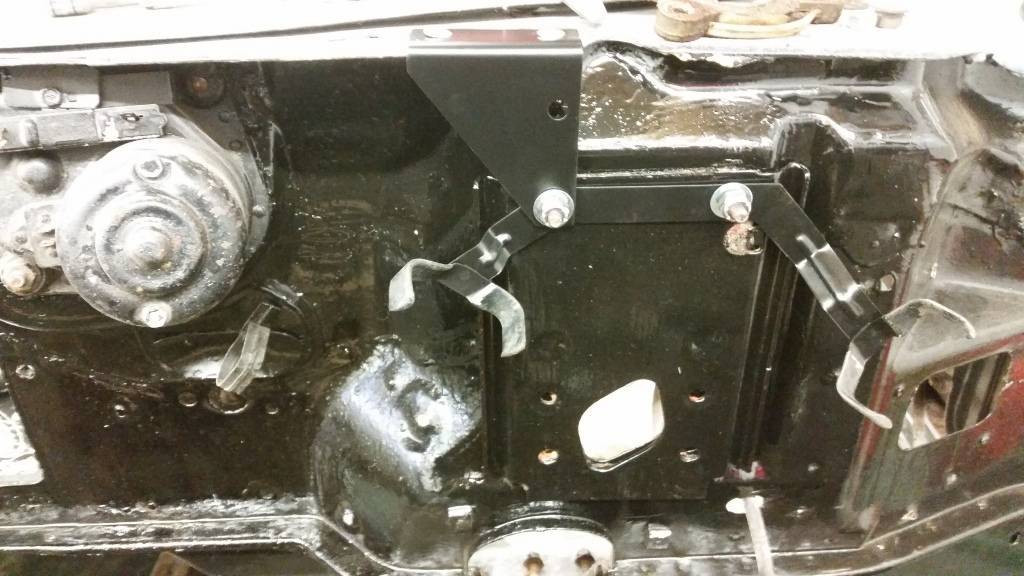

So partly I've been rust removing and painting, this time behind the servo:

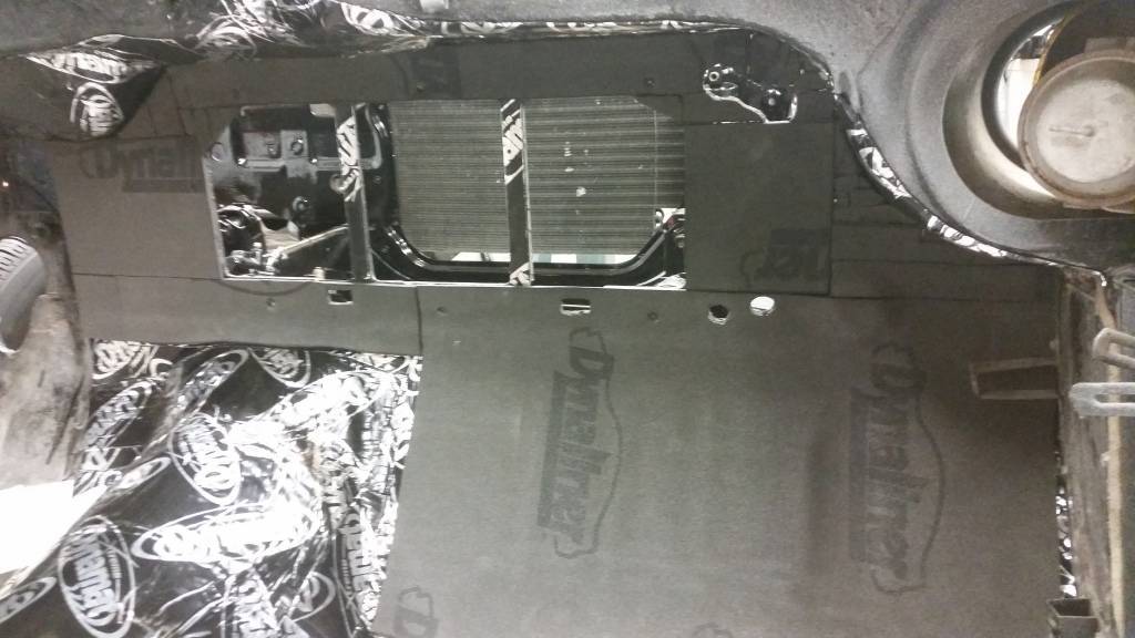

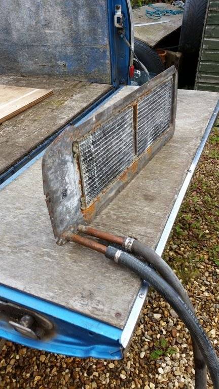

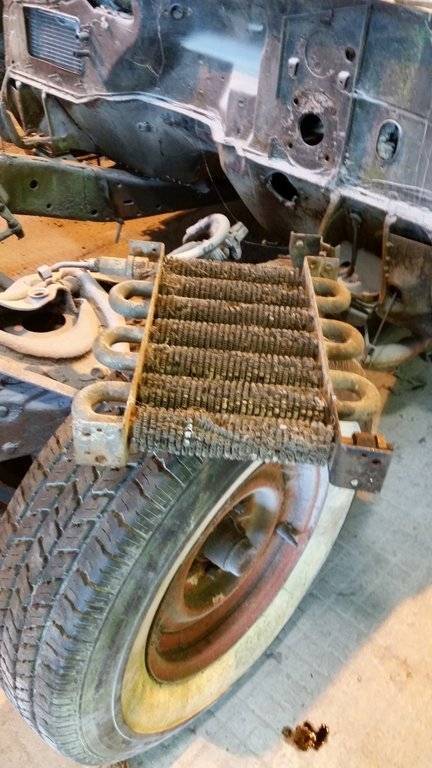

At this point I'm eyeing up the various bits of heater and A/C that I've been tripping over for the last few months and wondering if they could go back on at this point. Before the rainy season started, I did connect the heater matrix up to a garden hosepipe and it didn't leak. I know that may change when it gets hot, but something has to go easily, right?
What's holding me back is uncertainty about whether I leave that dynaliner as it is or whether something needs to go over the top of it. It's a foam that looks like it might hold water - maybe I should stick something smooth, black and waterproof over it? I'm also wondering how high the carpet goes?

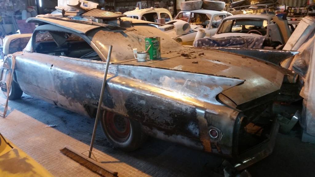

Been on this for a few days, too. (Dig Swamp's coffee mug/paint stripper container!)

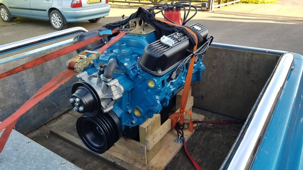

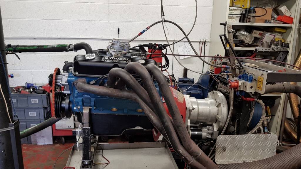

On to more fun things: the engine is ready! So on Friday I loaded it up and headed to the dyno.
This might be an ordinary occurrence for some, but this is the first time I’ve ever been to an engine dyno. Really enjoyed it.

And the results? Well, we didn’t quite make it to 300hp. Bit disappointed, but it’s the torque that counts in a cruiser like this and it’s a nice flat curve, staying over 300lb-ft from 3000 to 5000 rpm. Doesn’t appear in the figures, but it wasn’t much short of that at 2000 rpm. Ultimately, I think it’s the heads that are holding it back. The engine builder suspects they’re early heads carried over from the 273. Here's the dyno sheet:
Didn't get much reaction to changing ignition timing and the carb didn't need any rejetting - it was fine across the whole range straight from the box, with only the idle mixture needing to be changed.
Two leaks on the dyno: small one from the oil filter and coolant coming up one of the thermostat housing bolts. We ran it without a thermostat so both will be coming off anyway. Any tricks with the bolts in the thermostat housing?
At this point I realise I never ordered engine mounts! Soon as they arrive, I’ll have a load of work to do.
